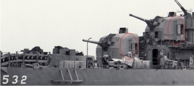

It appears that 1943 the 5" gun housings had the ladder in the back where as in 1944/45 they were on the side.
What might be the reason for that? The door is still at the same location.
Ladder July 1943.jpg (19.26 KiB) Viewed 1914 times
ladder 1945.jpg (15.69 KiB) Viewed 1914 times

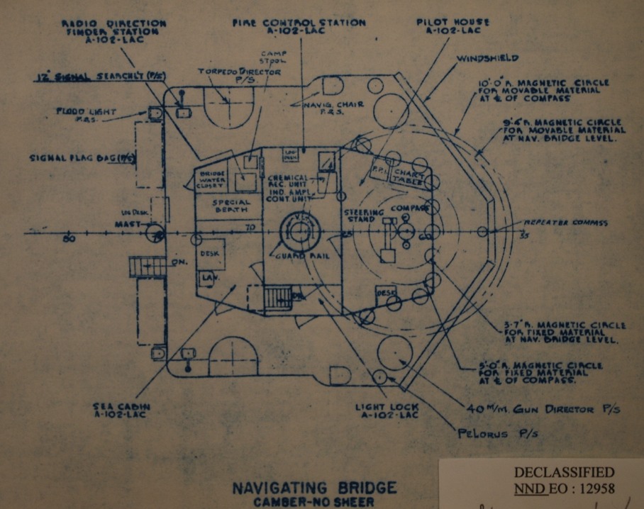

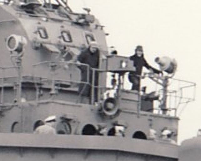

.. and what might this be?

1. Yes the cams/stops would be built into the stand. The cutout at the outboard sides of 20-mm gun bulwarks was a common feature made necessary to depress the guns lower. The new tripod stands didn't elevate to allow depressing the guns at those low angles. Experience in the Philippines and elsewhere in late 1944 showed the need to fire at suicide boats and mines close-in to the ship.
2. The image I uploaded to Photobucket is as good as that photo can provide. The original wasn't the best to start with.
3. Moving the ladder on 5-in mounts was a standard modification and I don't know why.
4. The items atop the pilothouse show 12-in search/signal lights and other misc equipment ... Loudspeaker amplifier, chart table, etc.
(Or it could be the robot from "I Robot" ... :big_grin: )

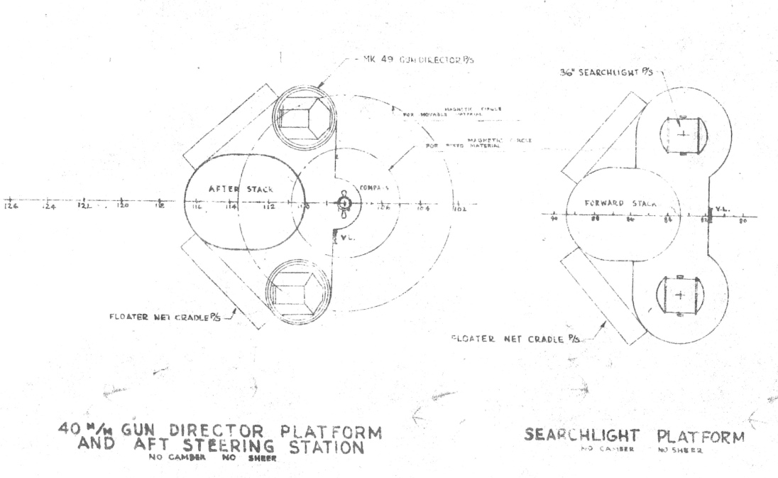

Rick, do you have a plan view (top view) drawing of the searchlight platform (#1 Stuck) & gun director platform (#2 Stuck), by any chance?
Year: 1944, Bethlehem Steel Company, San Francisco, CA (DD459-DD684, or Hull# 5366-5398), assuming the ship yard built the platforms in the same way. I did noticed that the platforms from BIW are different.
Again, I am building the USS Heermann, Hull # 5374, DD532
I do have a side view, but for some reasons, I don't find a plan view of the platforms.
BTW, shouldn't have the USS The Sullivans DD537 the same configuration?
Hermann
Posts: 3869
Re: Calling all USS Fletcher class (DD) fans
Post by Rick E Davis »
Hermann,
Hopefully the image below of the plan views from sister DD-534 McCORD will help. They are pretty plain even for Booklet of General Plans drawings. Finding surviving WWII era BGP drawings at NARA for FLETCHERS is rare, McCORD is one.
Yes USS THE SULLIVANS (DD-537) should be close to HERMANN (DD-532). But, there are differences, HERMANN had Mk 51 directors near all twin 40-mm mounts and McCORD and THE SULLIVANS had Mk 49 directors installed near the aft three 40-mm mounts. So the bulwarks on the #2 stack director platform may be different. Also, the life raft arrangements are different at least between HERMANN and THE SULLIVANS. HERMANN and McCORD were completed to the six 40-mm configuration and modified post-shakedown to the ten 40-mm configuration. THE SULLIVANS was completed to the ten 40-mm configuration and several refinements were made by then.

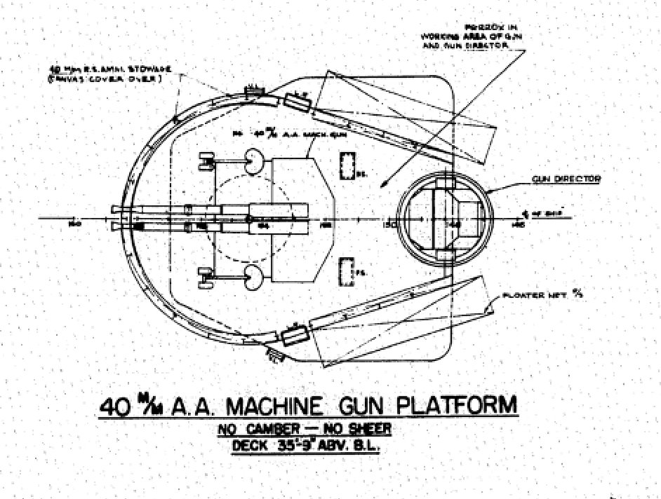

1/700 Murdertorpedoboat Ooi
Posts: 3869

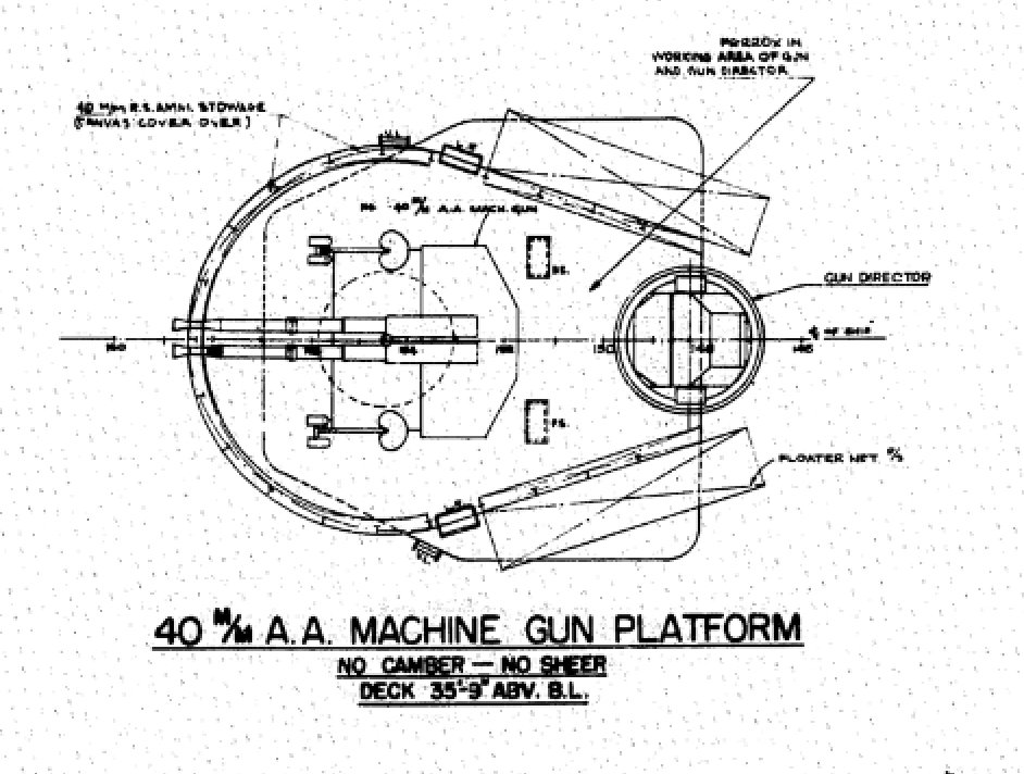

I have posted images of the "standard" tub shape in this thread before, but here is a smaller drawing version. The original "tub" as built shape was a sort of teardrop shape. You need to look at photos to figure out variations on the director "tower/platform". How the bulwark was or wasn't carried around the forward end of the director platform varies. The tub version Trumpeter included with the kit is the "Mare Island" version that they modified FLETCHERS to, in many cases but not all, when they repaired or modified those units during the war. As far as I can tell, no other yard did this modification to the tub. I think Trumpeter should have provided both versions as part of the kit. They provided different versions of other components, but not this which was the standard shape on about 165 of the 175 FLETCHERS as built. Units completed with the original elevated platform (DD445-451, plus a couple of others) were updated to the ten 40-mm configuration mid-war ... some got the tear-drop tub and some the "D-shaped" Mare Island tub.
Post by PetrolGator »
That doesn't look TOO hard... I hope...
Thanks, Rick.
Wait. This looks suspiciously like the aft deckhouse on a Buckley-class.... coincidence?
- Chris
Posts: 3869
You will find they are different. :big_grin:
I wouldn't be surprised if the working circle for the 3-in gun and a twin 40-mm mount weren't close or even the same.
Making a new bulwark (or using part of the existing one) shouldn't be too hard ... curving strip stock (thin plastic or brass) with straight sections should get you there.
