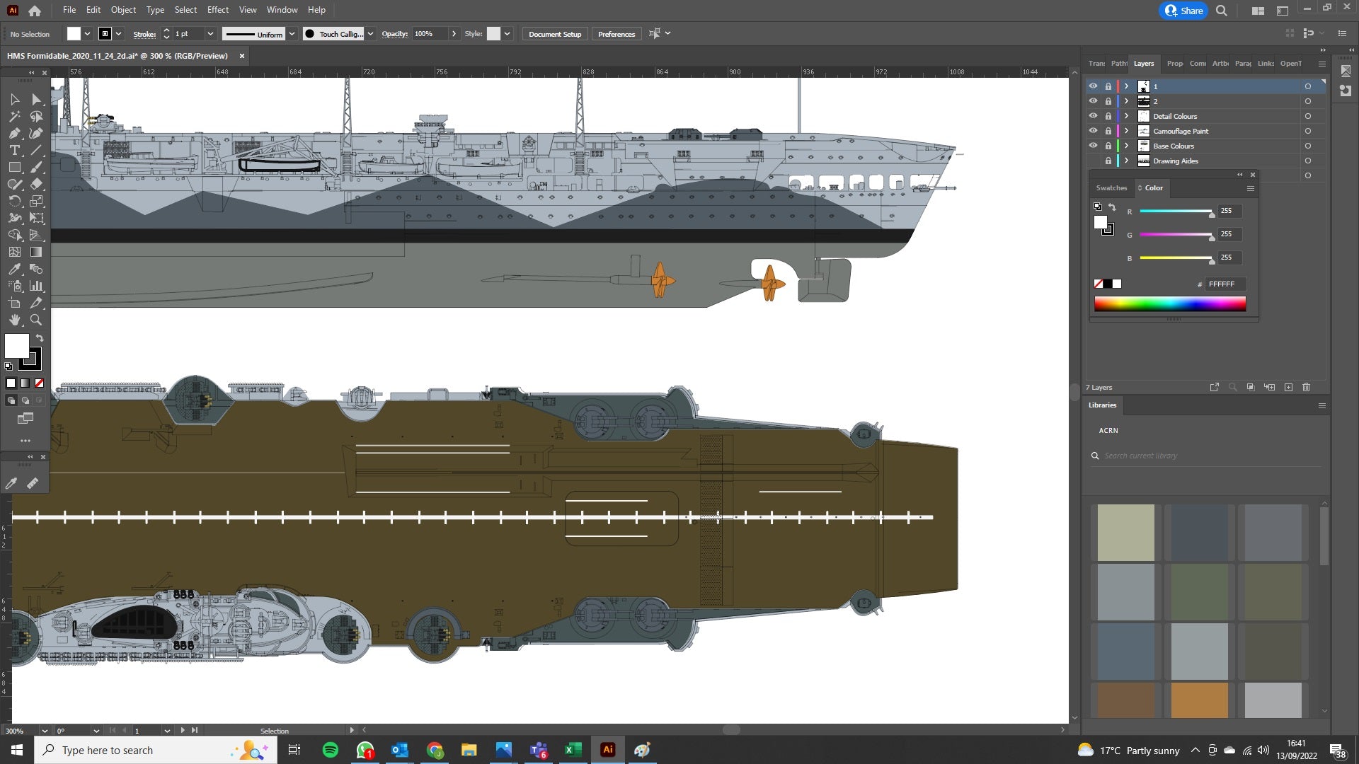

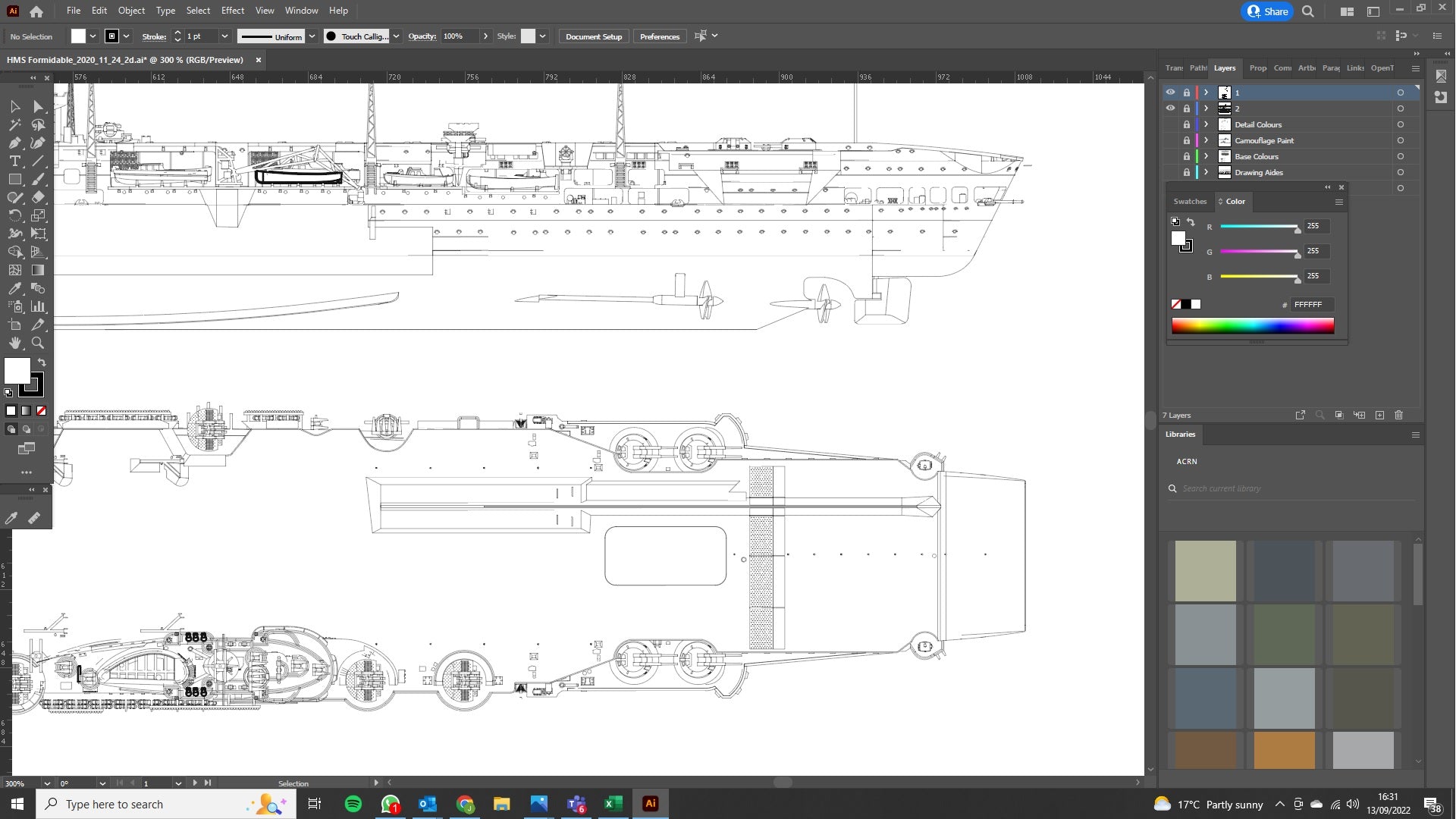

When this one hit our inbox we announced our intention to poor Ian Gazeley :big_grin: to burn his time too and I got started on the colouring and didn't trouble myself with the structural details. I've opened the original set of line drawings exported from Flyhawk's 3D model and this is what we have:
We laid out the deck markings correctly although curiously enough they border where the catapult should have been not where it actually was.
The image Richard shared above was the last we saw of this where the 3D model was corrected and Flyhawk wanted to know whether to reorientate the forward most white line by a couple of degrees to match the catapult, to which I agreed they should.
It's a bit of a mystery how it went backwards again to be honest.

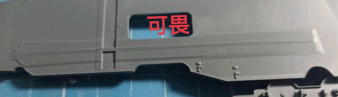

A week ago, a modeler in China also posted in Tieba about the mystery of the flight deck of the Flyhawk Formidable (link attached).
https://tieba.baidu.com/p/8005432138?pi ... 5377912999
He noted that the catapult part of his kit on hand is different from his friend's kit. One with full width with flares out slightly at the forward end, one with reduced width in the forward side. After doing some research as demonstrated in the post, he suspects that the wrong deck was in fact correct for Victorious.
So, an odd packaging problem?

On Teiba.Baidu there is a guy who compared many pictures of Illustrious class carrier and concluded :
????????????�??�???????????????????????????FH??????????????????????,
that is :
I suddenly realized that the "fearful" deck I had was actually the Victorious deck, and went back to the photos to verify. As expected, FH had quietly made a big news and had already opened the Victorious deck.
An error in selectioning the part to be manufactured?
A Victorious comming soon?

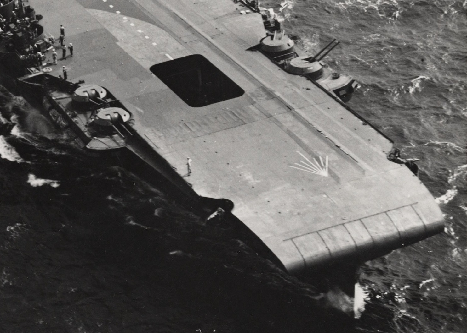

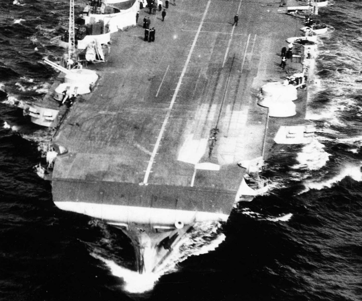

I remain doubtful that the flare was the same on all three after the 1941 USA repairs.
It's the forward end that may have varied.
This is Formidable:
This is Victorious:
What we need is a clear photo of Illustrious 1942-1945 from a similar sort of angle to see how hers was.
This therefore would seem to be wrong for Victorious (and I suspect wrong for any if those are vertical rather than angled/chamfered edges either side at the forward edges of the flare):
(I will e-mail Flyhawk and ask.)

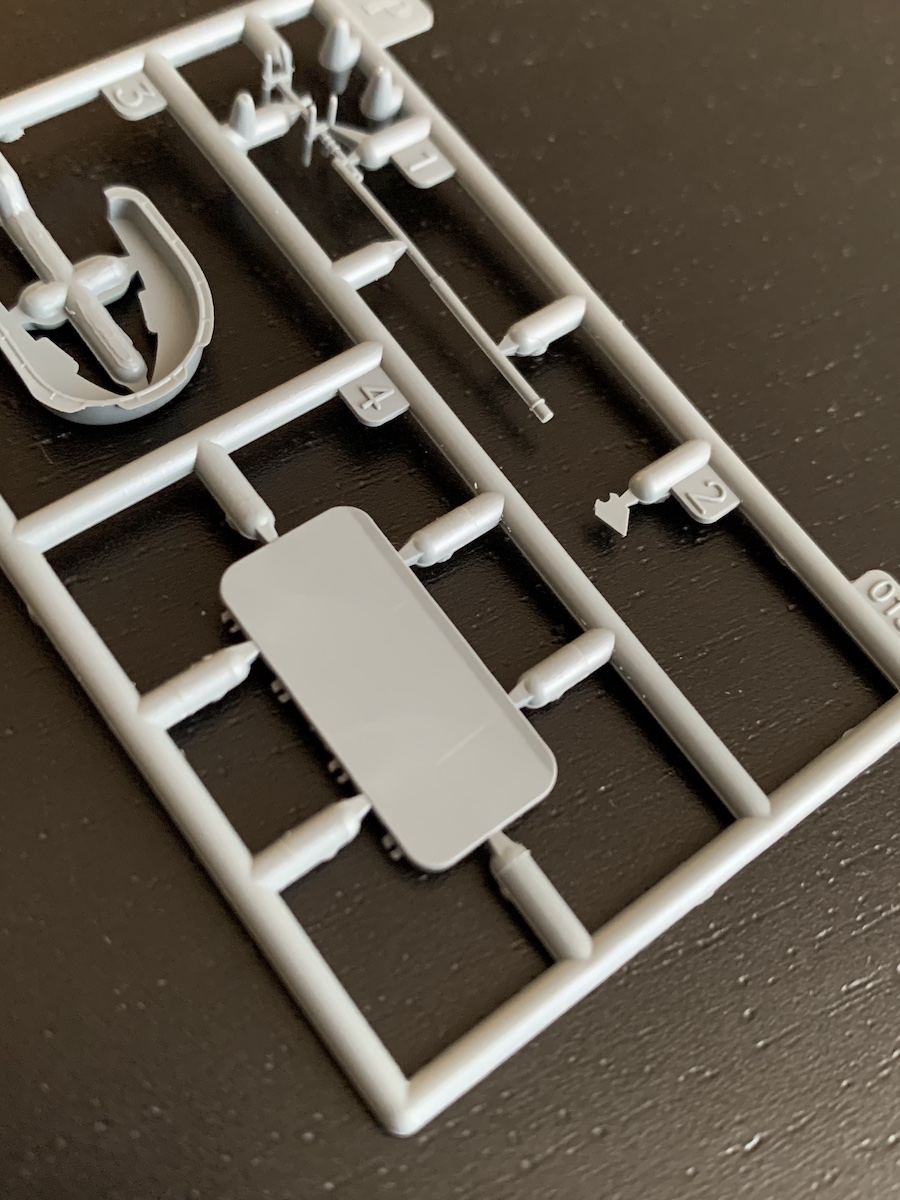

Photos of the wrong parts below.
Deck (A-1) vs mask.
Elevator with beveled edge still there (P-4).
The plans are correct.

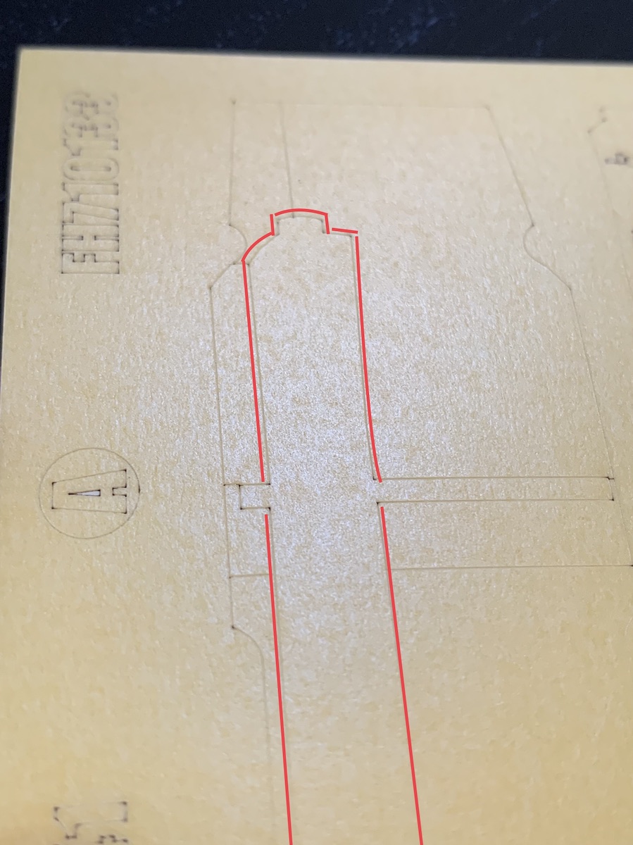

Re the mask, it is a bit unclear from your photo's angle, but can you say if the yellow line, the port edge of the raised catapult area, is depicted as a straight line running parallel to the green line, the deck edge, or is it a bit curved getting closer to the deck edge at its forward end?

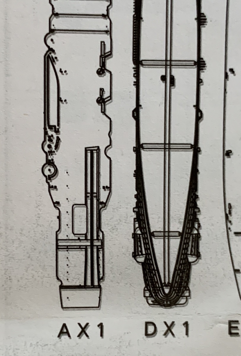

Re the plans I'd be really grateful if you could rephoto AX1 concentrating on the forward end of the flight deck as I cannot see how they have depicted the forward end of the raised catapult area.
IMG_7715 - Copy.jpg (12.64 KiB) Viewed 19995 times
pascalemod
Posts: 2016
Location: Stockholm, Sweden
Re: Flyhawk's 1/700 HMS Formidable: a flawed masterpiece...
Post by pascalemod »
dick wrote:Thanks for those photos.
The attachment IMG_7714 - Copy.jpg is no longer available
The attachment IMG_7715 - Copy.jpg is no longer available
Dick, to first - looks like straight, but the curve is on the other side, see photo. Tough to photograph well, i dont wanna yet rip it out and try it on... May be I will later..
Again, hard to say from the angle, but - in reality the catapult is flaring out at the bow. Wider. Very slight but noticeable.
The close up of the instructions as asked. They are super tiny, this is typical flyhawk tiny fold out - I really wish someone can tell them to increase the size of their instructions and quality of printing (too thick lines).
