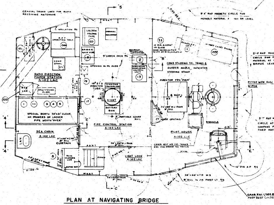

Steve wrote:
There is an interesting gray box fixed at an angle. Any idea what it is?
Of course :cool_2:
The angled box to the left of the ship's wheel is the Compass - it shows the silhouette of the ship on a 360 deg. compass and as the ship's wheel is turned, the silhouette reacts and shows the helmsman what his heading is. The compass is also graduated in degrees and quadrants. A cam can be placed on the compass and the ship steered thru various maneuvers depending on the cam selected and put in place. This was very common during WWII when the task forces did zig-zagging to avoid the pesky Nazi & Jap UBoats. We only once did that sort of practice during Underway Training and it almost wrecked a couple of the DD's in our squadron. Not everyone follows orders.... :doh_1: We got thru it, however!
The large rectangular box to the right of the wheel and below the round brass Engine Order Telegraph, is the rpm indicator - when the Engine Order Telegraph is set to particular setting (on the orange end of the equipment) the rpms desired can be set by the Lee Helmsman (man to the right of the Helmsman) and it will show the adjusted rpm in the three square windows when the Engine room has responded and the ship is maintaining the speed desired (in rpms, not knots). There is an adjustment handle on both ends of the EOT - one for each screw (stbd/port). Typical commands are: Ahead 1/3rd, All Stop, Back 1/3rd, etc.
If this isn't correct, I'm sure one of the landlubbers on the forum will correct me! :thumbs_up_1:

Excellent description! Even an old Army guy like me can understand it. Of course, Army compasses are much smaller. And if you weren't careful, it would always point toward your M-16.
And now the square-bridge Fletcher pilot house I'm designing for 3D printing has a compass.
Since these items aren't fixed to the pilot house structurally, I'll be including an EOT, combination steering/rudder angle indicator, binnacle, chart board and remote unit separately.

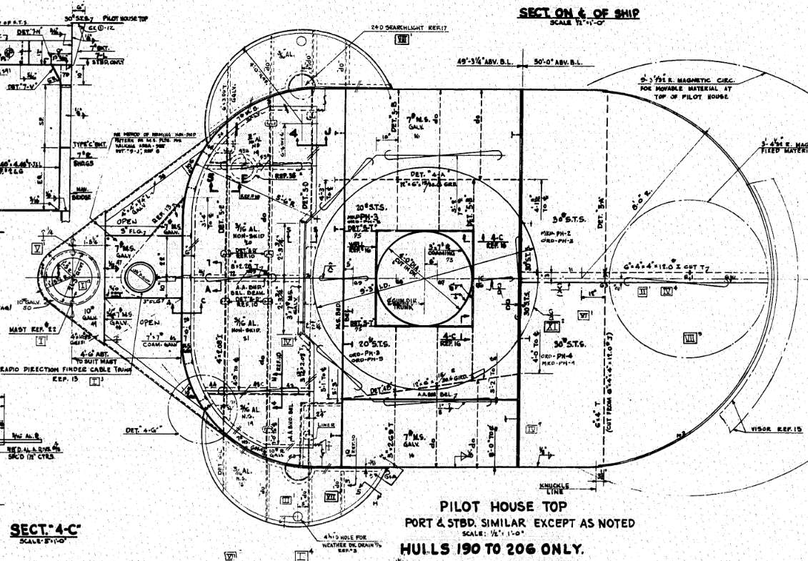

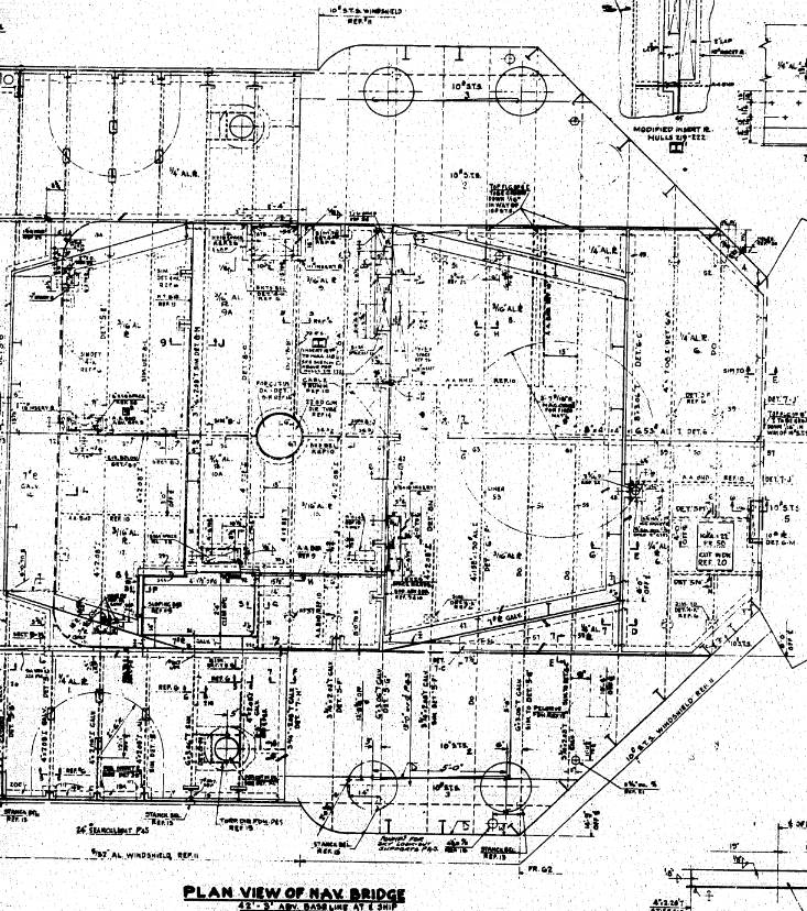

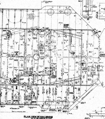

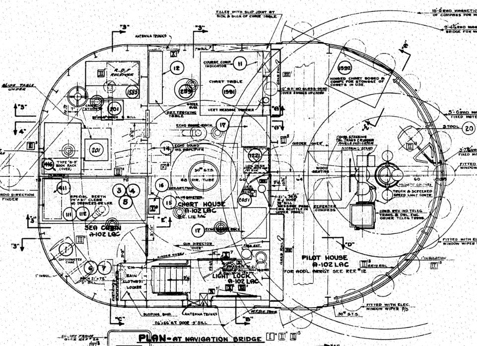

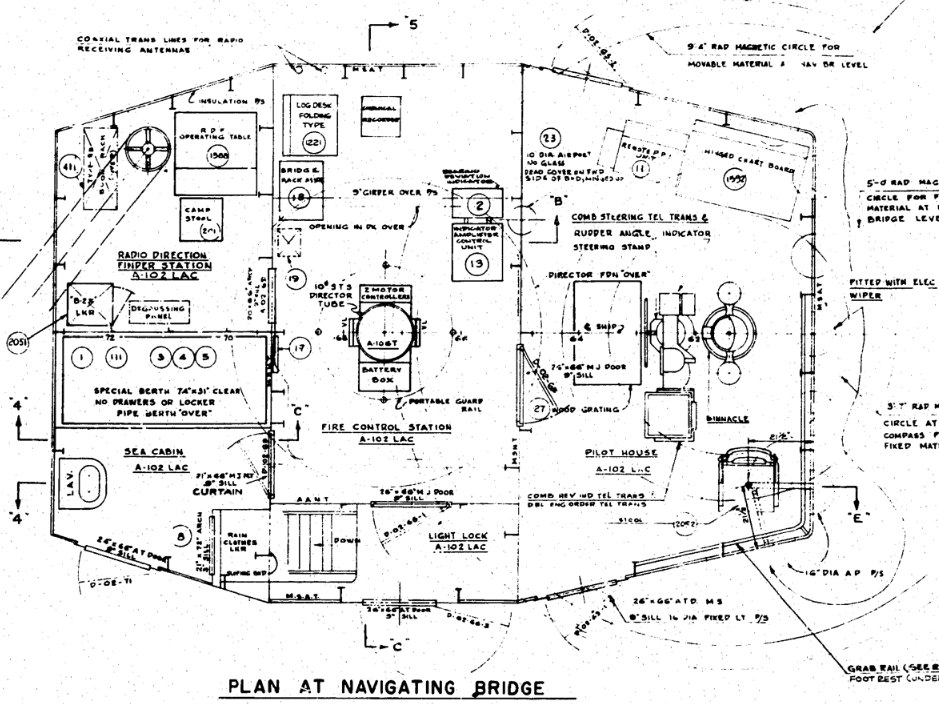

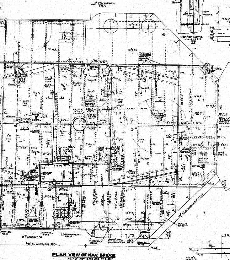

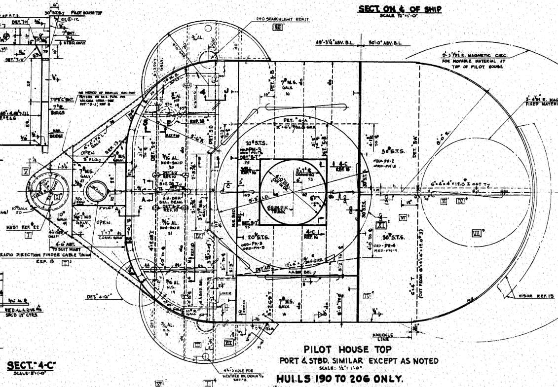

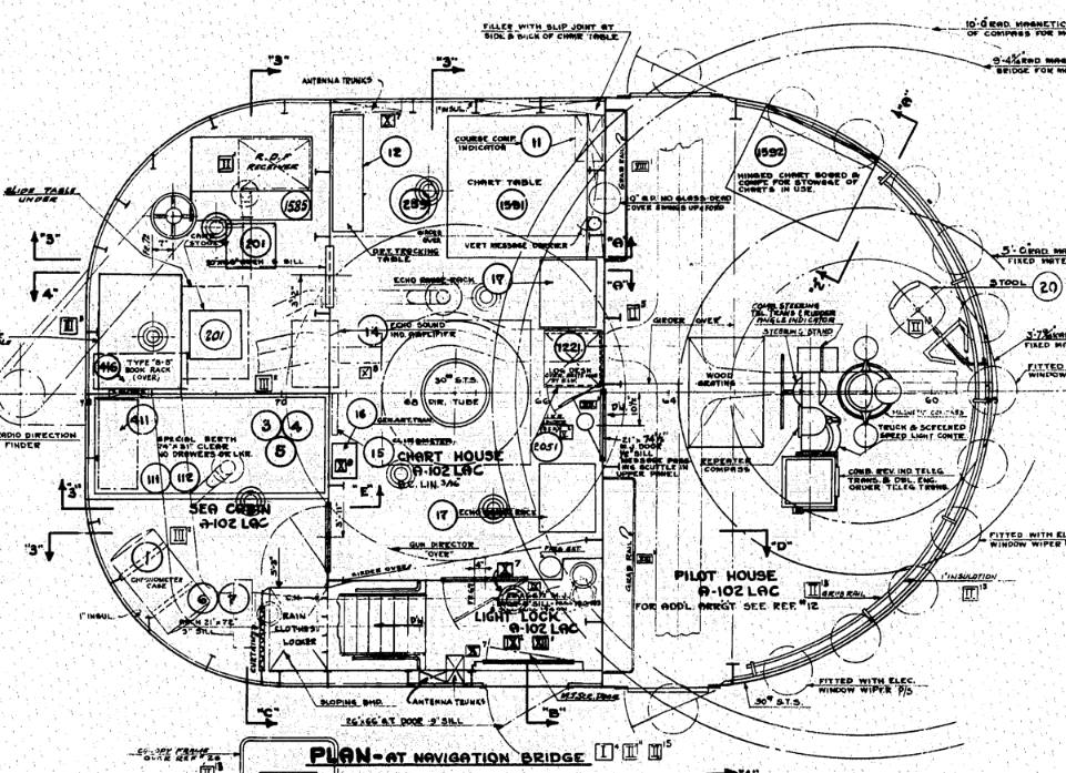

Hopefully this helps, I don't have time to track down every detail from the BIW FLETCHER Class Engineering Drawings DVD.
The Round Bridge drawing shows a main beam down the center off-set from the centerline to port over the pilothouse. But, I don't see any cross beams supporting the roof being shown. Not sure what did, but assume they were there likely in the same spacing as seen on the rest of the deckhouse on that level.
The Square Bridge drawing is clearer that there was a main beam down the center of the pilothouse and cross beams spaced equally across the whole top deck.
The layout I have "should" be fairly accurate, like everything else some equipment layouts were changed throughout the career of these ships.
In general the overhead of the pilothouse of WWII and particularly post-WWII would be cluttered with cables and piping (with a "healthy" coverage of spray-on installation). The attached view shows a 1950s FLETCHER pilothouse. It shows the supports to the bridge face and you get a hint of how cluttered the overhead was.
Round Bridge structural drawing and layout;
Square Bridge structural drawing and layout;

Brilliant! The drawings and photo are extremely helpful. Thanks!

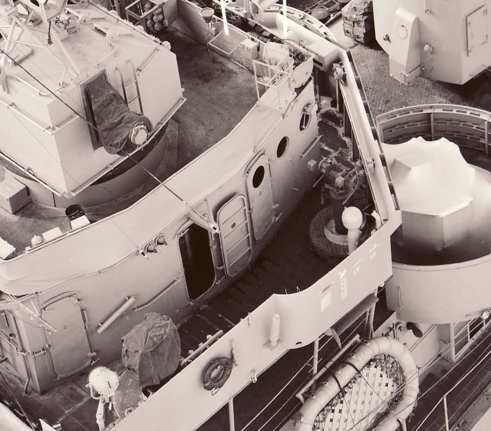

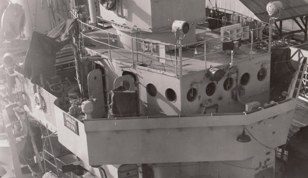

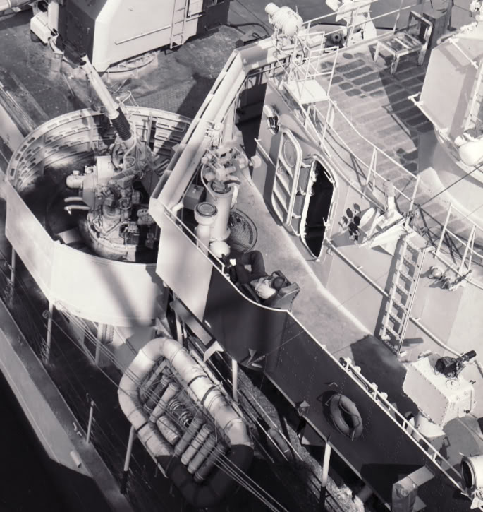

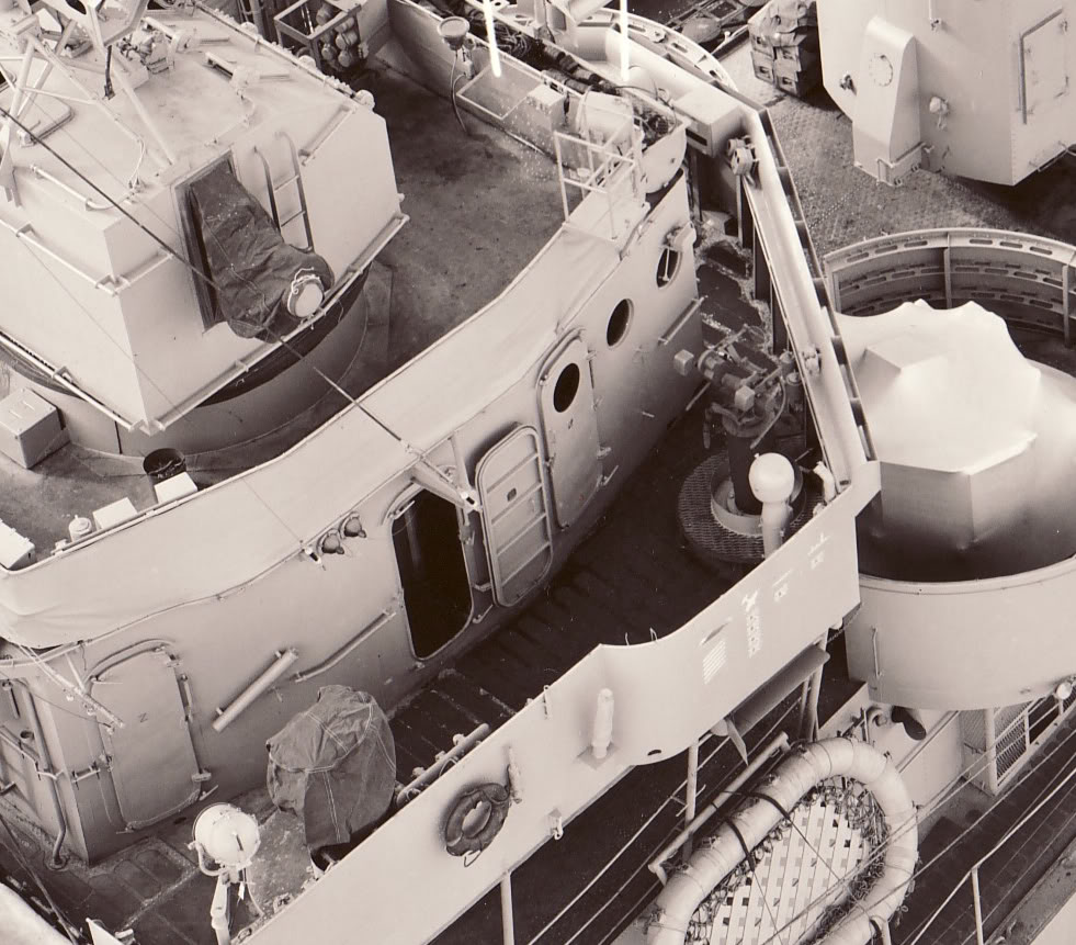

I've noticed the design for the type of square bridge as seen on seen on some Bethlehem Steel-built Fletchers is different than those built by Bath.
The most significant visible difference is the location of doors. It appears that at least some, if not all, Bethlehem-built square-bridge Fletchers had a door on the aft bulkhead, port side, and did not have an exterior door to the captain's sea cabin.

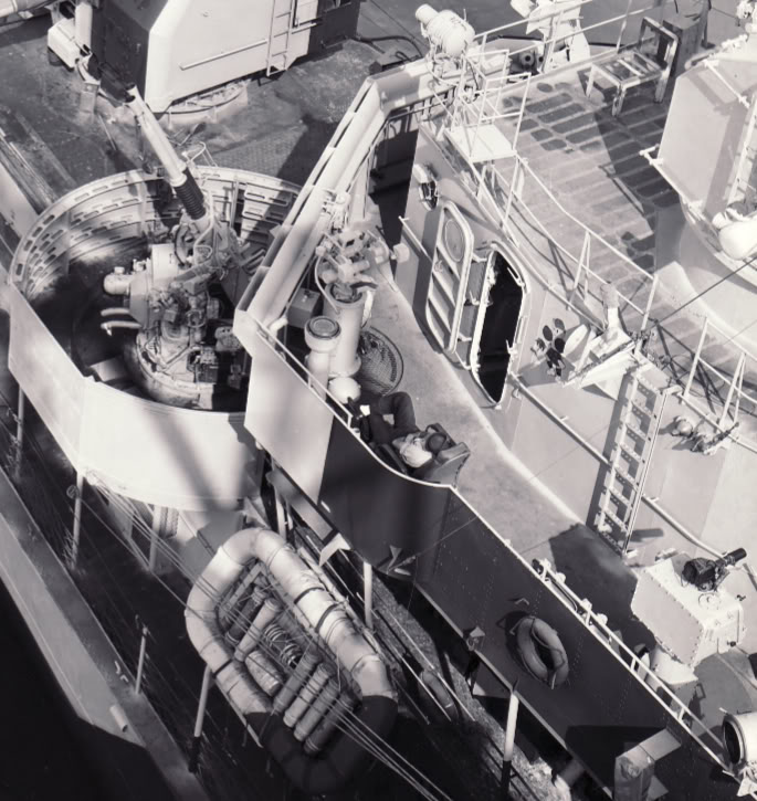

The designs of the 5-inch mounts appears to have changed over time with respect to the location of stiffeners and the number of fasteners on the front of the access panels.

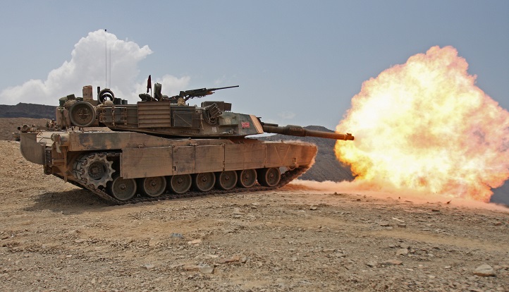

For example, an M1A1 Abrams main battle tank has a 120mm gun. As you know, the USN 5-inch mounts were 127mm. See the blast in the photo below (note the blast effects on the ground) and that suggests what the Fletcher crews endured. I can easily imagine a cooked, crushed gun captain in Mounts 51 and 55.
