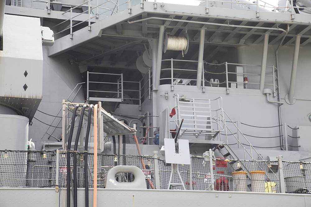

Some photos showing the "bead" at the top of the shell plating. Not a good photo of the waterway, unfortunately the kid barrier placed inboard most places obscures it. It appears to be about a hand span wide, about 8". Note the rubber fenders and storage!
Looking at some large 1948 photos the bead is there at the hull lip.

T, thanks much for your BB63 deck photos. I will find a way to add the lip (0.020" brass wire, maybe, or 0.020" styrene rod). In your second photo, the wood decking doesn't look quite as wide as a b&w photo I saw the other day of Iowa (early 1950s?). I was surprised at how wide the boards appeared, based on the width of the sailors' boots (term?). And, during 1980s renovations, was the rotten decking replaced according to a plan?
