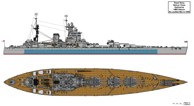

I have a question:
Nelson's 1944/45 state carried 6x Octuple Pom-Poms:
- On top of the 2nd turret
- A pair next to the funnel above and forward of the 2nd pair of 4,7" guns
- A pair behind the tripod above and behind of the 3rd pair of 6" turrets
- On the Fantail
Where were the Pom-Pom directors located at?
I've only found 4 on the drawings and photos and all of them are located on the aft part of the superstructure, close to the aft pair of Pom-Pom guns, one pair behind the aft rangefinder side by side and another pair just forward of said Pom-Pom on the boat equipment storage room. But were the two centreline mounts had their own directors?

Hi TZoli
I have looked at all my photos/drawing and books I cant find any 2PDr Directors fitted for the fwd and aft 2pdr mountings, I happy enough with photos that I have looked through that they were never fitted
Graham

Interesting. Does this suggest they are locally directed? For the fantail one I an imagine the aft pair of directors would be used for that mounting but the turret-top one is very forward for the funnel ones! Though there should be enough space on top of the what I only guess is the Pom-Pom ammo storage structure on top of the 2nd 16" turret and behind the Pom-Pom mounting.graham wrote:Hi TZoli

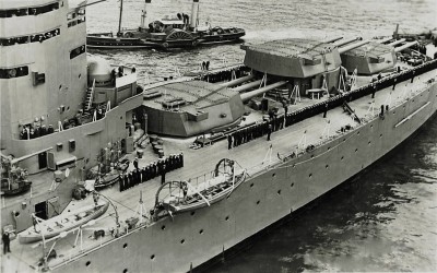

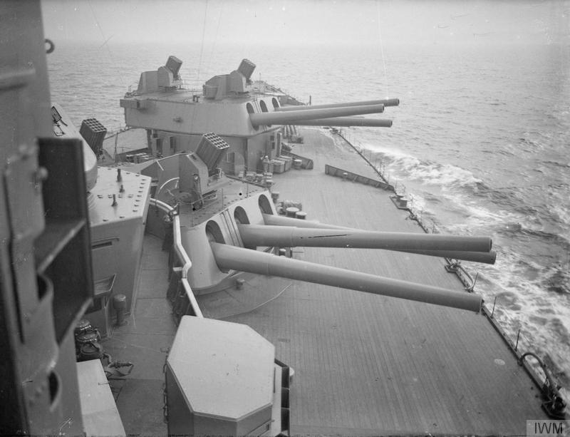

Another question:
What is the accepted deck colour for around the conning tower? the level where the 40mm Single Pompoms, later the 12,7mm MG's were located pre-AA refit?
Is it just darker grey metal or some wood or even Linoleum?
This photo shows that level I think it was called the Conning Tower Platform:

If you ask me: I would say Dark Grey painted metal. No Linoleum (Corticene!) for sure, then you would see brass strips to hold these down.TZoli wrote:Another question:
In theory also Semtex could be used, but I never read anything about Semtex on Rodney or Nelson.

Thank you, I will fix my drawing than.

Hi TZoliI suspect that both Fwd & Aft where locally directed but I couldn't total count out that they weren't, I suspect Paralex errors may have made them bit inaccurate, with the 2ppr 8 barrel PP principal of operation (throwing as much stuff in the general location of a enemy ac as quickly as possible ) it wasn't through worthwhile fitting a director.
I may have to re-read Norman Friedman. - Naval Anti-Aircraft Guns and Gunnery to see if there any indication

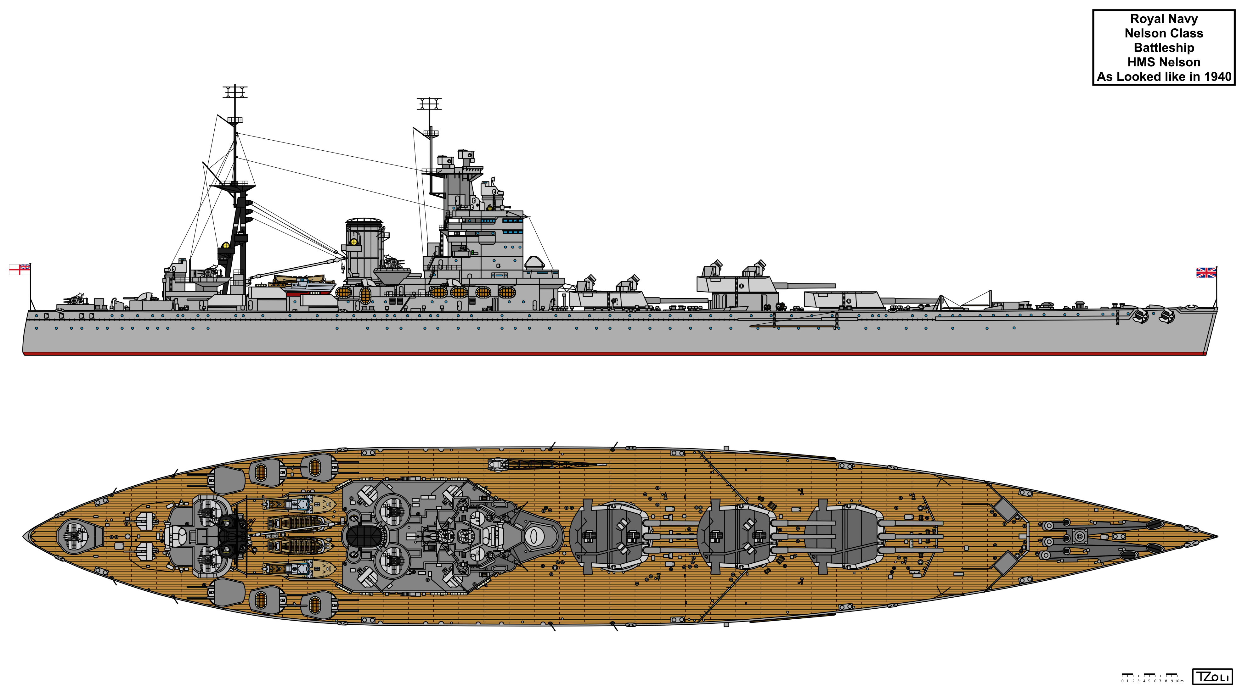

I think I've found the missing Pom-Pom director positions:
In 1933-34 two octuple Pom-Poms were fitted in place of the Torpedo Director Towers abreast the funnels.
It does not state where did directors for these mounts were placed but I think it was on top of the bridge behind the 6" Director Control Towers
In 1940 an octuple Pom-Pom mounting was installed on the quartedeck and two in place of the aft 6" Director Control Towers. Again no statement for their directors placement
In 1941-42, an octuple Pom-Pom mounting was fitted on top of B turret
3 Mark III directors were also fitted: two on the mainmast and one on the aft end of the shelter deck I presume either on the platform just aft of the main director where the later aft 20mm Oerlikon will be. Also apparently 4 barrage directors were also added at the aft end of the superstructure, abreast and abaft of the mainmast, I think this was the location on top of boat storage structure and the aft platforms on the mainmast.
In 1944-45 refit at the Philadelphia Naval Yard, Pom-Pom directors were removed to provide space for Oerlikons so I presume the bridge superstructure ones the centreline aft one and the ones on the mainmast

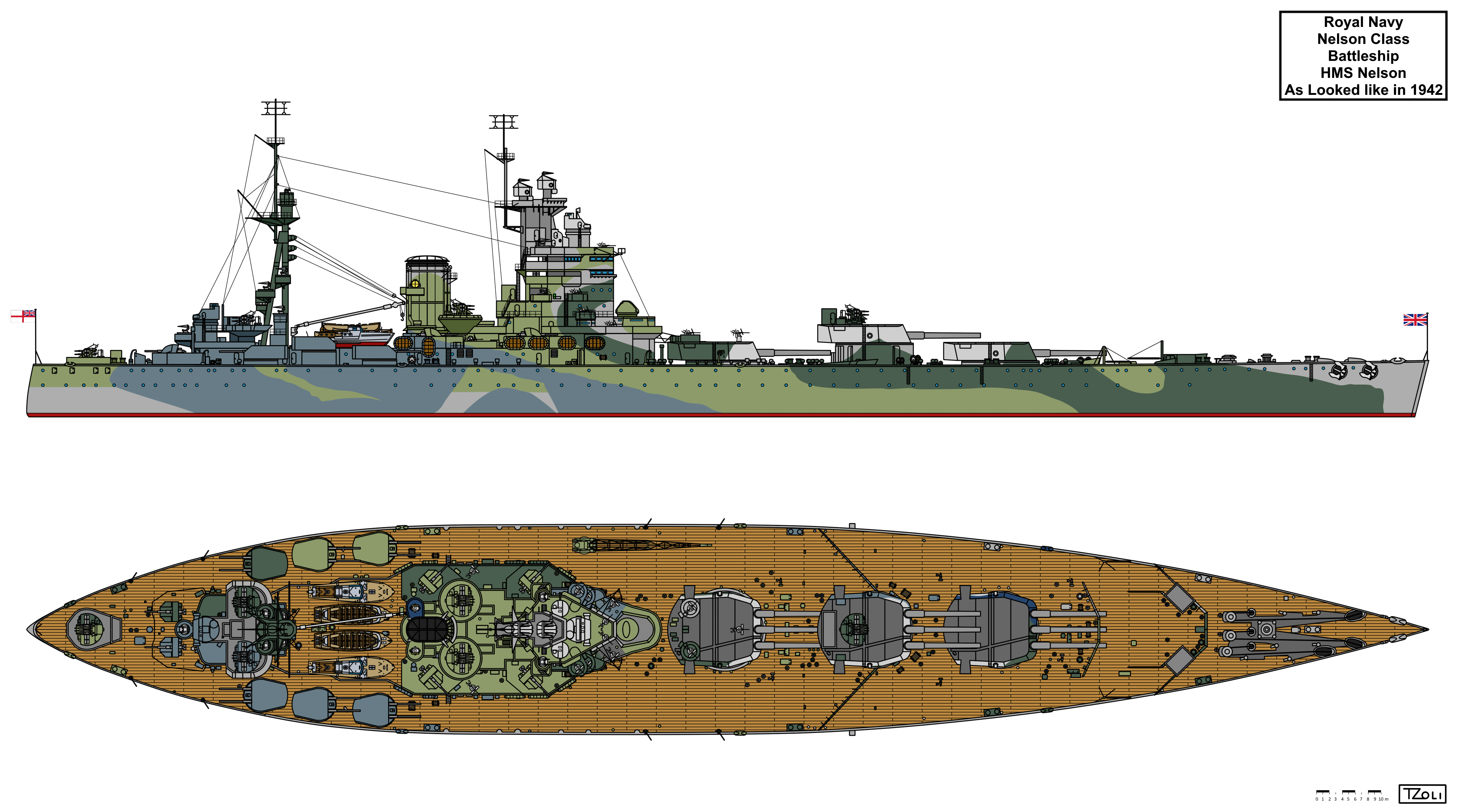

Also I've made drawings of Nelson's 1945 and 1942 state I hope the colour scheme is correct:
1942: 1945:

For the camouflage pattern I'd like to refer you to the latest versions using the paints available at that time.

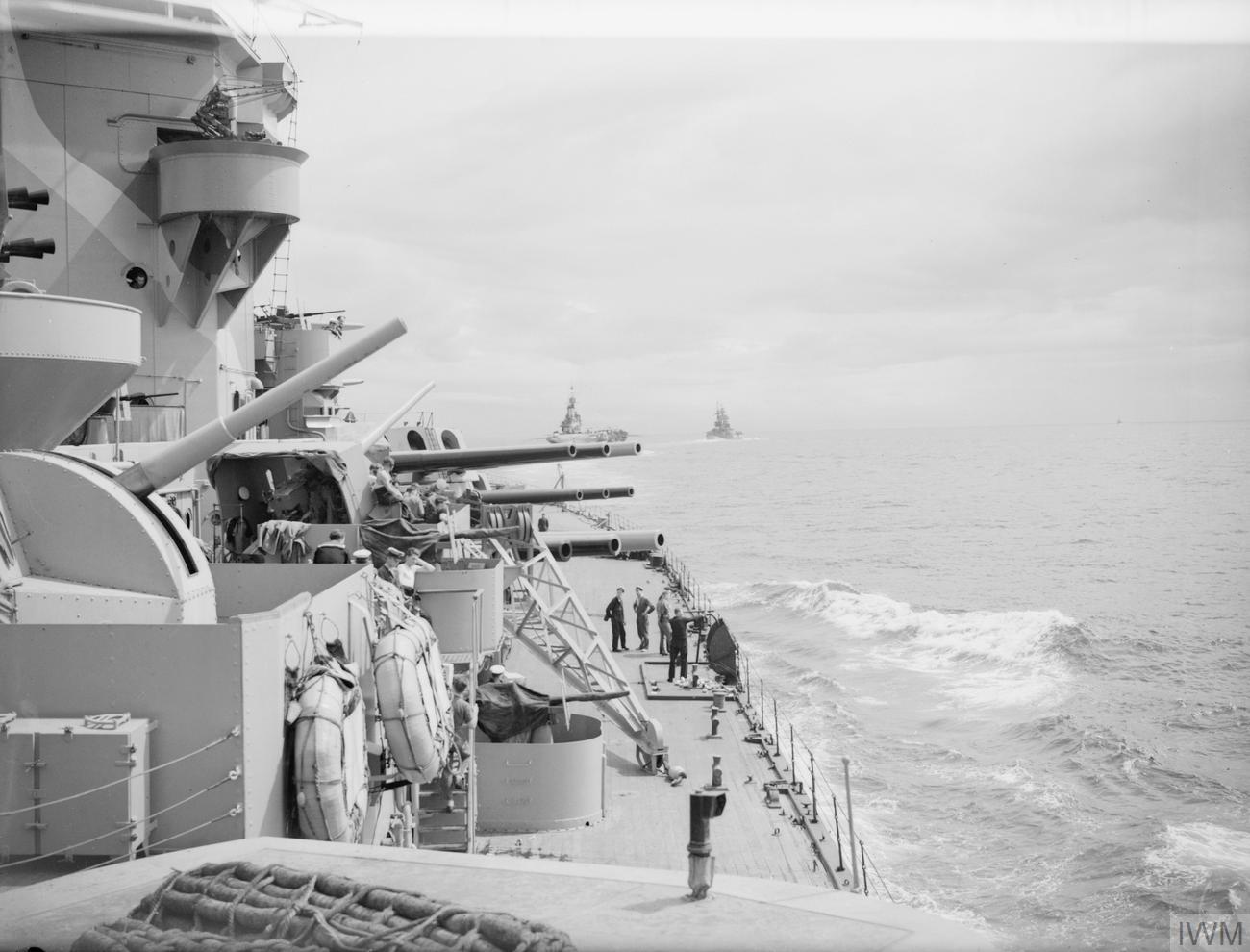

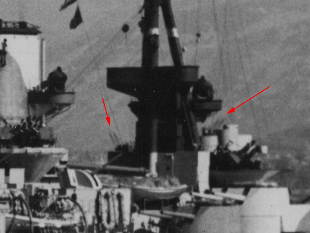

Now, both Hood and Nelson were originally fitted with two Mk I pompom directors and these are very small; Hood's director was high up in the main structure and nearly impossible to spot in any photograph, so early photographs are not of much help. One source also mentioned Nelson was later fitted with 5 Mk IIs, however, my radar book in indicates that 4 type 282's were fitted in March 1942 (and these are fitted on pompom directors).
This image (April 1942) shows two of these radars, just in front and just aft of the main mast?
I find two just aft of the main mast, in front of the aft DCT, see type 282 antenna
For Rodney: in the main superstructure
It's not uncommon that a pompom did not have a director; for the KGV-class the logical location for the fwd pompom in B turret was between the fwd HACS directors but were not always placed.

So instead of green oriented was the colour scheme it was blue/dark grey oriented?

I'm afraid some people were mixing up Rodney and Nelson. Indeed Rodney had some greenish teint in his camo scheme, Nelson didn't.TZoli wrote:So instead of green oriented was the colour scheme it was blue/dark grey oriented?

Indeed, Rodney has a few patches of MS3 that are greenish (not green though). In the above link she's in full colour at the 11 minute mark.
This was the movie I was acutally trying the link
https://www.iwm.org.uk/collections/item ... 1060015143
Nelson in full colour around 45s. The patterns have been matched with the currently best available data on what the official colours were.

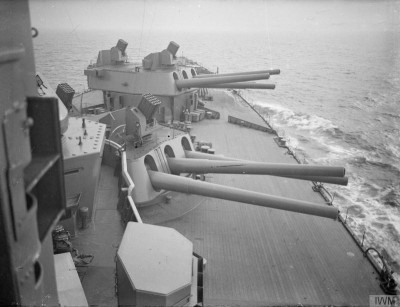

Image that was up for sale on Ebay, however, Brexit; preview is the best I can do. Keels do not follow the shell expansion plan outline but seem to be little more than a regular bilgekeel 'trimmed' at the bounding box of the hull.
