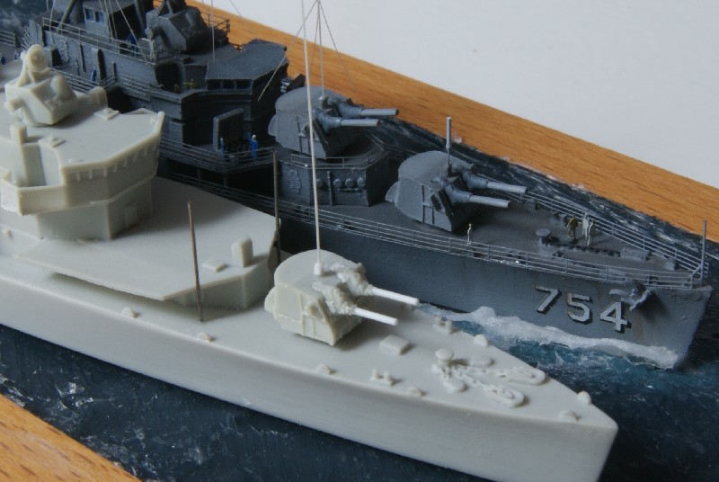

NukeMM wrote:I know what you mean about the 5" barrels. They have been bothering me, too. Can I leave the blast bags and just snip off the barrels? I may use brass rod instead of styrene, but not sure yet.

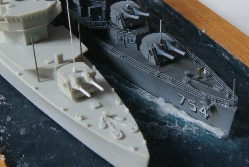

Hi Carl,
attached are two photos to show the contrast between the kit barrels and the modification with 0.5mm plastic rod.
Mhh, but it seems to me, that 0.5mm is still too thick, 0.3mm could be a good choice, but then you should use brass as mentioned.
As you can see I left the blast bags on my F.E. Evans. I cut of the resin barrels and glued the plastic rod directly to the blast bags, without drilling a hole into them. If you will use thinner brass rod, you should drill a hole into the blast bags.
Hope that helps so far?!

Thanks for the pictures, Christian!
Your eyes must have been playing tricks on you. There is hardly a difference to the nake eye between the barrels on the two ships. Maybe you "did" change the barrels on the Evans and forgot that you did.
That looks like the Gearing FRAM I, right? That one is on my list to complete, too. Is that antenna on the turret permanent or just for the picture? Something like that, I always leave until the end of the model. I'm prone to bust antennas, masts, etc. off while working on the rest of the model. You must have more confidence in yourself, than I do.
I'll probably change the barrels on my Sumner sometime in the future. I'll definately change them on future JAG models with the same problem. I should add that small antenna to turret #1, like you have on the Evans, though.
Did you study the Sumner FRAM II by Brett Marrow on the JAG Gallery? Wow! He added some almost impossible details to his. Super nice!
Thanks again, Christian!

5" is 127mm, so in 1/700 that would be .18mm - if you include the thickness of the barrel, you can probably go with 0.2mm.

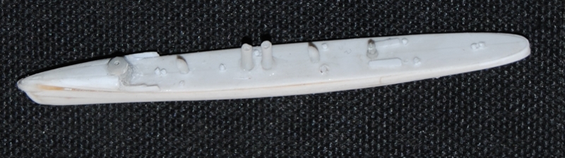

Spent a few days building up manhole covers in .64mm rod. There's 12 of them and they refused to stay in place off course! Total time in project: about 16hrs.

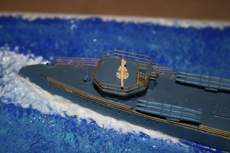

Post by taskforce48 »

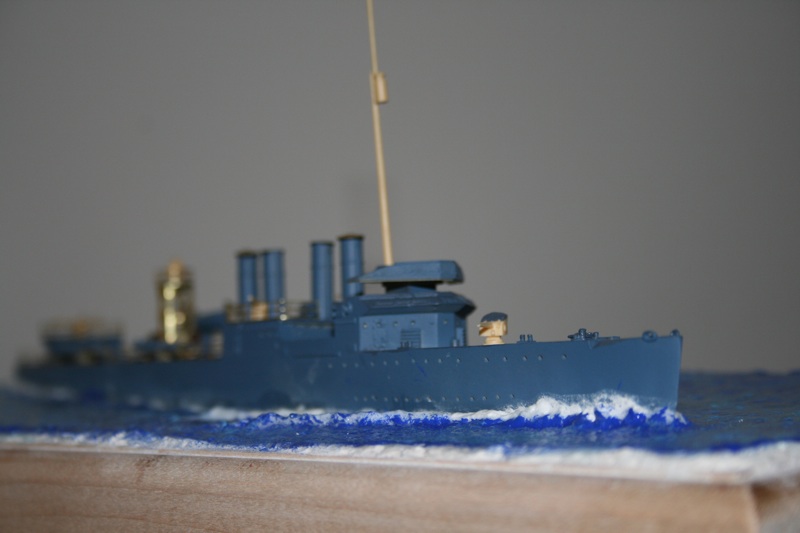

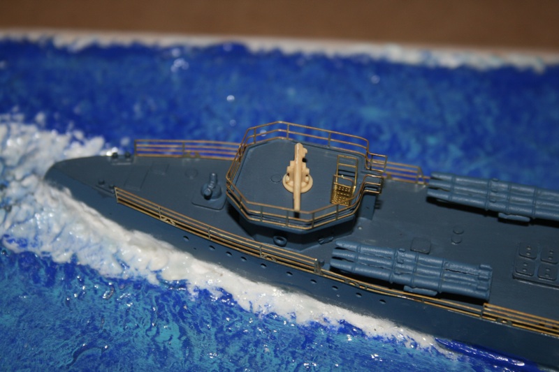

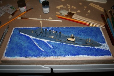

Here is a quick update for the Ward, at this time most of the major PE has been either placed or shaped, really just down to the bow and bridge now and then the final detailing of paint and such. I am aiming to have her done this weekend.

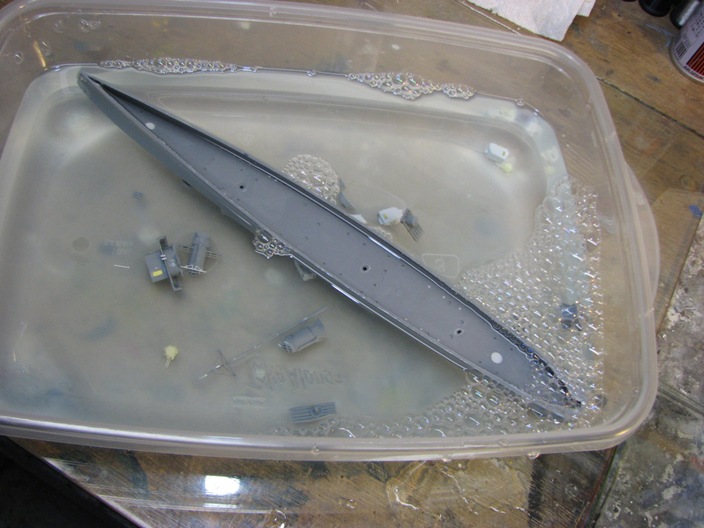

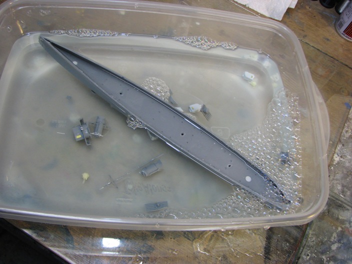

My Fletcher build is moving along. I had it soaking in Dawn dishwashing soap earlier this week. If Dawn can remove the crude oil off of the Pelicans in the Gulf, it should be able to remove finger print oils off of the plastic pieces. I then got all the major pieces primed and ready for some paint.

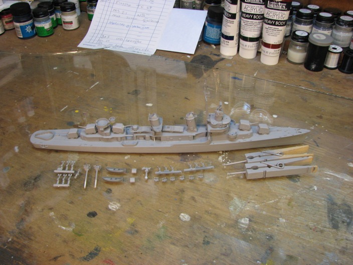

The Tamiya Fletcher kit doesn't come with flag bags, so I made them using .100x.188 plastic strip, cut and sanded to shape. The tops of which will be covered by tarps made out of tea bags.
Fletcher soaking in Dawn.

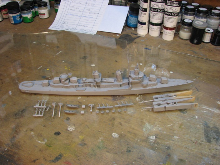

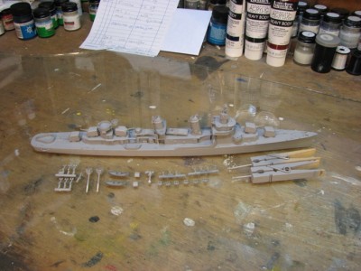

Fletcher primed and ready for some paint.

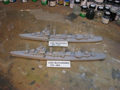

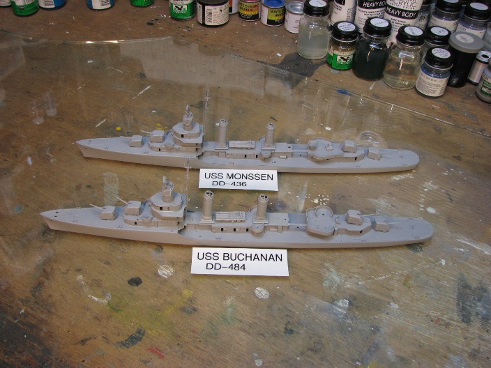

I was able to get my Monssen primed and ready for paint along with my Buchanan ready for it's turn in a Dawn bath.
Thay both have primer on them now. (6-19-10)
Monssen and Buchanan in primer.

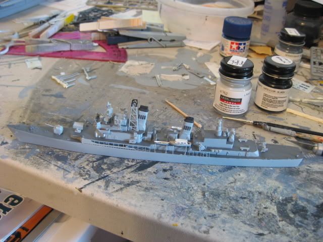

My first weekend home in awhile has produced a few results. This is what I have on Niko's 1/700 scale USS Coontz DDG-40. This is one of the best kits I have seen as far as build quality goes. I am looking forward to building the line of post war cruisers thay have .

No way, Mark! These are some beautiful shots. Even though it's not finished, could you post some more close ups?
