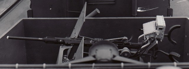

As with most things related to "configuration" layout ... it depends. You didn't indicate which FLETCHER(S) you are trying to model. The Trumpeter 1/350 scale kit can be built as a "Five twin 40-mm mounts" or the "Anti-Kamikaze" configurations. Also, different yards and over time the layouts of the Open Square-Bridge FLETCHERS varied. In addition, there were three "unique" Open Square-bridge FLETCHERS that didn't modify the original Square-Bridge layout from the original configuration used prior to the forward twin 40-mm mounts being installed.
For overhead shots that provide views of the bridge layout, the Mare Island Navy Yard photos are the best. Most of the aerial shot photos dead overhead are just not that fine of resolution to make out details. In some of the views below, chairs and lookout stations have yet to be re-installed or for the mothballed shot, have been removed for storage below.
Five twin 40-mm mounts FLETCHERS bridge configuration mid-war.
DD-667 CHAUNCEY on 14 August 1943. Overhead shot, hard to make out details, but the locations of the forward Mk 51 directors can be seen, followed by the "Captain's" Chair, outlook chair, then the torpedo director.
DD-690 NORMAN SCOTT on 14 October 1944. I love this shot, sailor "Smith" is taking a break in the best chair on the ship.
Five twin 40-mm mount FLETCHERS bridge configuration late-war.
DD-631 ERBEN on 8 February 1945. You can see the relative position of the Pelorus to the Mk 51 director.
DD-649 ALBERT W. GRANT on 23 February 1945. A little bit dark, but between this view and the one of SHIELDS below, you can see the configuration of the "Lookout Chair".
DD-596 SHIELDS on 11 February 1945 as completed. She was one of the last two FLETCHERS completed.
DD-688 REMEY on 11 December 1945 in the process of being mothballed.
Anti-Kamikaze configured FLETCHERS at the end of the war.
DD-536 OWEN on 29 August 1945.
DD-531 HAZELWOOD on 27 September 1945. She has her lookout chairs on the pilothouse rather than on the navigation bridge.
