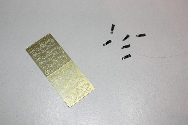

You get parts for 6 mounts, and they come in a little plastic box. The first thing you notice is that only the guns are resin. The mounts are PE, unlike the resin mounts that come with the Veterans set.
Guns and brass.
Guns and brass.
The resin is a very dark gray, and is very brittle. I assume this is to keep the guns from bending out of shape, but the barrels and magazines can be easily broken if not handled carefully. The casting block on the back is easily removed with some sharp sprue cutters.

The brass is .10 thick and is relief etched, and comes between two thin sheets of plastic. There are 2 frets, each with parts for 3 guns. The etching is very well done with nice fold lines on the mount and gun base. The traveler, trainer, and accompanying foot pedals are etched as part of the main mount, and can detach if bent too much.
Brass
Brass
There are 2 different kinds of bases: one with gun shields and one without. There are also two different types of gunsights: One with the round crosshair type (part 1) and one with front & rear sights (part 9).
