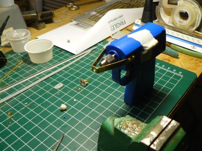

Last week I fashioned a drill bit stop from brass strip - the stop will work, it's the drill bit that causes problems. I'm using a 0.3mm bit for the size holes I need to drill - but this bit is WAY TOO FRAGILE to have any strength along it's length and therefore "bows" when any pressure is put on it at this length. So, removing the stop and only exposing about 3/32" of bit length will probably work. With larger diameter bits, this stop should work as planned.
Using scrap styrene I will practice seeng how the 0.3mm holes work using the Pontos pattern for hull hang rungs.
