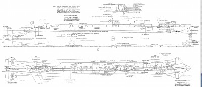

Does anybody have top view drawings for this class of submarines?
I only have side / inner view but for a drawing I could use better a top view one.

Re: Calling all Skate SSN-578 class fans
Here you go.
Also, as per above, two former Skate class sailors who saw one of the class in dry dock said that they were black below the waterline in 1965 and also one of the divers said black in the 1970-80's era.
