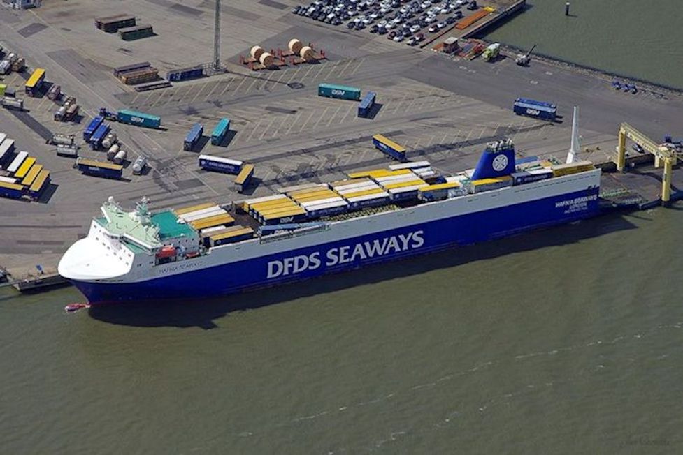

Hi :wave_1: I am interested in building a waterline model of the modern Truck RO,RO ferry, my main hobby is model trains and like adding other hobbies as well, since the ship play's a main part in railway's.
My ship is modelled on the Finnline Fin Breese RO,RO ship and Tor, line (DFDS seaways) bassed in London are of the same class, I like the low bridge design making perfect to fit into my layout. Bridge water line clearence is 18inches.
I only have a PDF side plan of the ship an dafter deck and bridg plans, can anyone help out with my project, got heaps of pics of the ship, need those extra plans, can you contack DFDS or Finnlines for info on the ship.
Here is a couple of pics of the ship
I hope these two pics be ok first time I have seen the pic name under the pic
Did try to post a new post earlier and couldn't find it in the forum, take a bit of time .
The ship be a interesting buid and learn along the way, be modelling a RORO port as well.

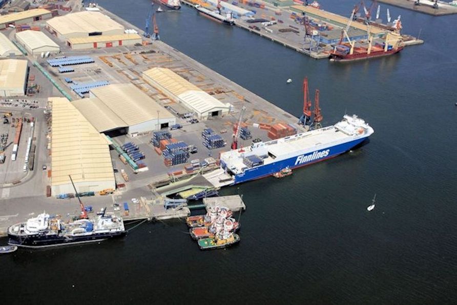

Found some pics of different port cranes they use other than the big container crane, opening up yet another project.
The middle pic I would like to model, you can see a rail line and in the middle of the pic a container ship being unloaded as well.

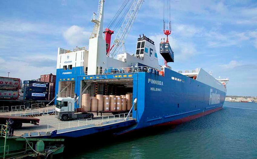

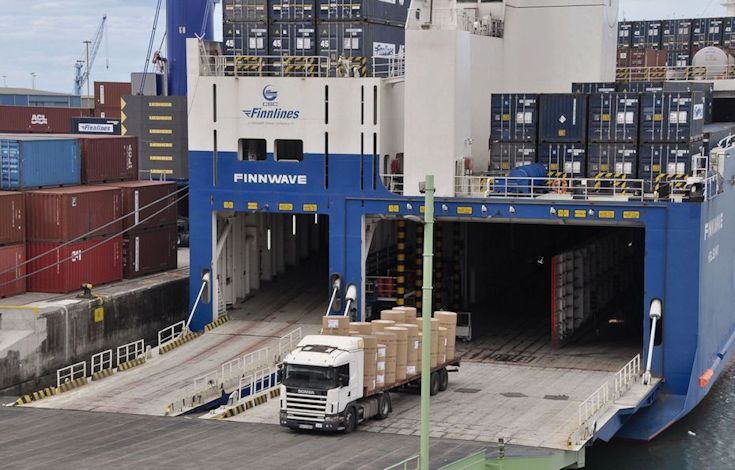

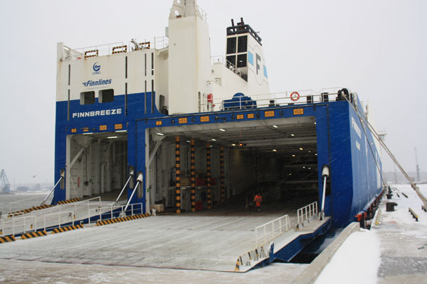

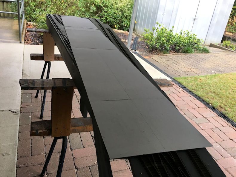

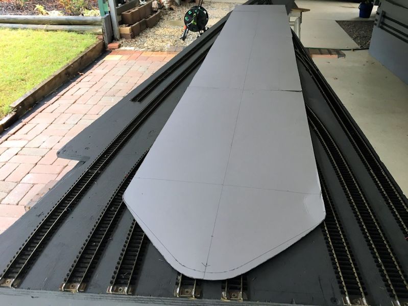

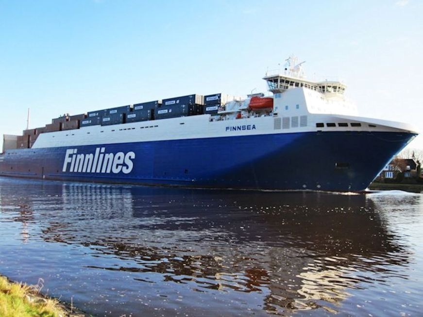

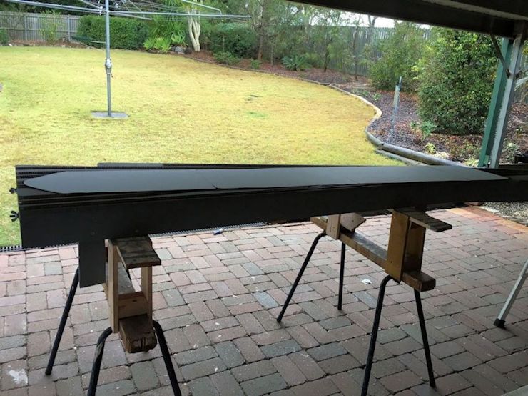

I am now under way with the marking out and cutting the top deck bow and stern, it took most of the day, not much but in a few months the ship will start taking shape, what I did was the 1,mm thick cardboard is 630, mm long so I worked out on the the ship side plan I have mark out the drawing to the scale size of the length of the cardboard.
All I have is a fairly good pic of the bow of the ship, so I hope I have the shape as close as I can get it and look like the ship when the bow starts taking shape, work on the bow first being the hardest, stern be the easiest, once I get the height worked out where I need some help in.
In pic two the stern has a lower deck and in pic four, pic three the line is where the bridge and upper decks start again only going by pics ans the side PDF drawing, fingers the ship will look as close as I can get it till one day get hold of proper ship plans.
The last two pics is what I am having trouble working out as you can see in the second last pic there is another deck not marked on the plan
, how is the best way to work the height out go by the bloke in the pic , will have to buy a HO scale figure, could I measure him to work out the height with using the picture.
Tony from down under.

Good to see you making progress. For scale height, I would find a photo with the back or front of a container right at the entrance, or near something else that you can used as a fixed point. The containers are standard heights (8'6" or 9'6") and width (8'), and make a good measuring stick.
Not sure what deck you are referring to inside the hull. At that scale, if it is more than an inch or two inside it really won't be seen from almost any perspective and can probably be left out. (This from a guy who in the past built interiors in 1:87 buildings that were barely visible to anyone-but I knew they were there!) Another thought would be to have scale containers loaded just about to the stern ramp (which would be quite common in real practice). This would shorten the visible interior to a very small area, giving you an even smaller area that "needs" to be modeled.

Hi kimmerWorth, many thanks, it is a pity the truck coming out didn't have containers on them but I have a go at working on the height of the crew member in the second last pic of my last post before this one.
The reason i posted the send last pic is you can see another ramp to another deck, i don't know a lot on Ro, Ro ships but on the info from PDF plan I have has deck info measurements.
Starting off with tank deck 5.57 meters high, main deck 5.57 meters high and upper deck 4.72 meters high, not sure what the tank deck is , would it be below the water line, or the deck with the crew member is standing, if that is the case, problem solved why the deck with the loading ramp is quite higher to the upper deck.

As to the decks, I would expect that the deck that the crew member is standing on is considered the main deck, and a cargo deck below that one is the tank deck (the ro-ro I sailed on for many years called them the same thing). There is a ramp from the main deck down to the tank deck, and normally a very larger watertight hatch cover that is flush with the main deck when closed (and cargo can be placed on top of it). You can see this hatch cover opened in the last picture that you posted on both September 2 and September 8. What looks like a bulkhead in the middle of the main deck cargo space is actually an open hatch to the tank deck. That's why you don't see the same structure in the photo with the crew member--it is closed.
Not sure about the upper decks on this ship. That is a ramp leading to an upper deck of some sort behind the crew member, and clearly there is another interior ramp leading to an upper deck in the smaller stern ramp to the port side, which seems steeper. If I had to guess, I would say that perhaps the steeper ramp with its own stern ramp leads to the exterior upper cargo decks, while the other interior ramp behind the crew member leads to some sort of interior upper deck or decks. I have not been able to find much of a description of these ships, so really can't say for certain. (As an aside, my son is sailing on a ro-ro as his very first ship as a cadet. That ship is one of the very boxy pure car and truck carriers, and has 13 decks, 5 of which are moveable!)

Hi all, could someone tell me the height of the tank ramp cover in the pic, will show the pic again to save having to go back to that post with the pic , I am so close to working out the height of the main deck to second deck,I do have a closer pic with a pulp truck coming onto the ramp main deck.
Going by the height be two prime movers high, what we all the trucks, could the second pic be a better one to work with will post that again as well, so close to making a start on the hull, I hope also I am on track with dividing 87 scale into the length and width of the ship to those scale measurements.

You might try to figure out the height of the life rails on the stern.
On US Navy ships the standard height of the top pipe was 42 inches above the deck. Knowing this, you have a built in height reference in almost every photo.
I have no idea what the top rail height is on commercial ships.

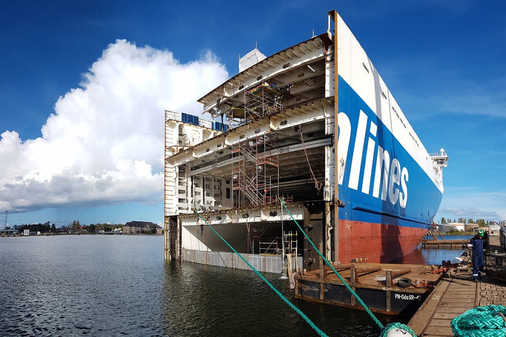

What a find, I said a few posts back that Finn Lines were planning to lengthen the Ro, Ro ship I am modelling , they have started cutting Finntide and adding a new piece mid-ship,crazy to an extra 30 meters in lengthen, can't wait to see some pics I keep on searching.
Will see in the pic the difference in the height of the main deck to the second deck where I was having trouble will working out, now I can make a start, will have to draw the ship in sections being so long, amazing what is out there and the link I found on the last post.
