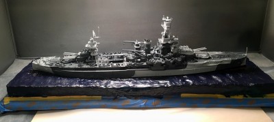

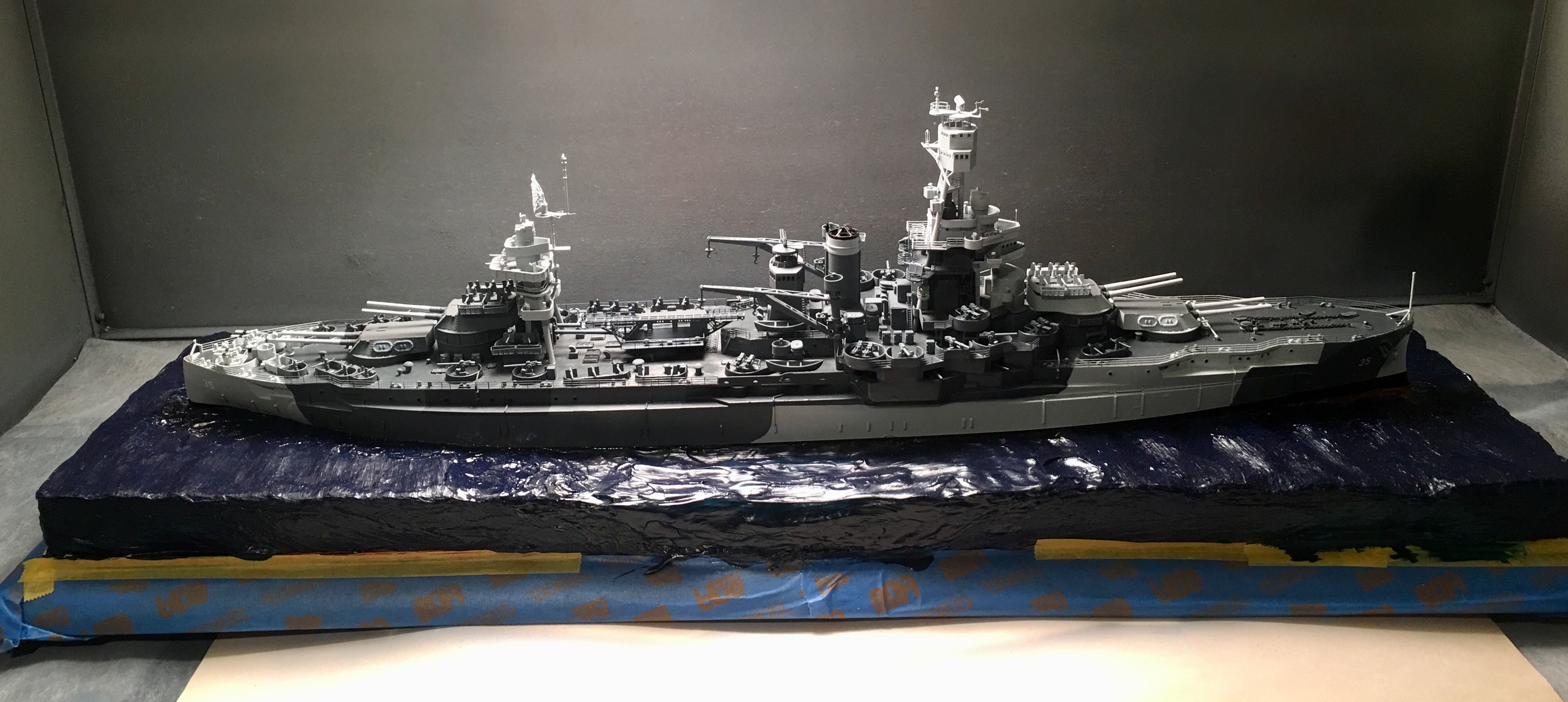

Getting close to the end of my most recent project, a 1/350 USS Texas:
Once I finish weathering and rigging her, she'll be ready for her little people. To that end, I picked up some NorthStar figures to crew her. I've used them before, on Z-17, but wasn't entirely happy with how they came out.
Anyone have any good tips for successfully painting these little f**kers?
