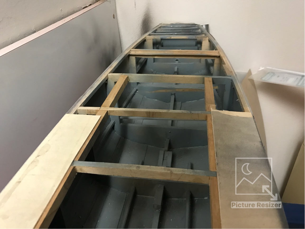

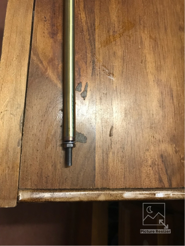

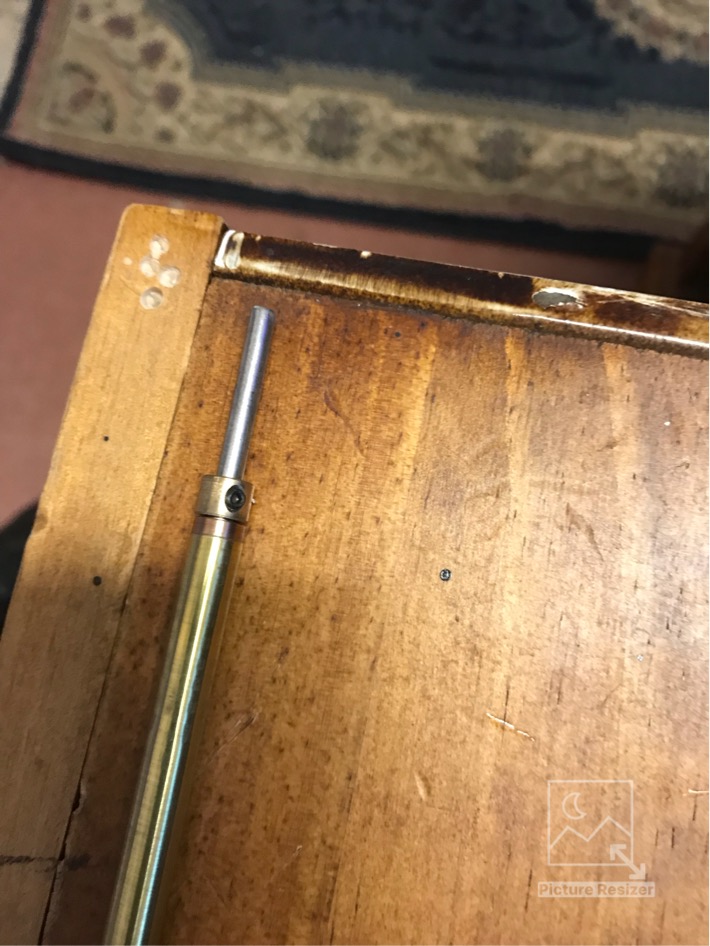

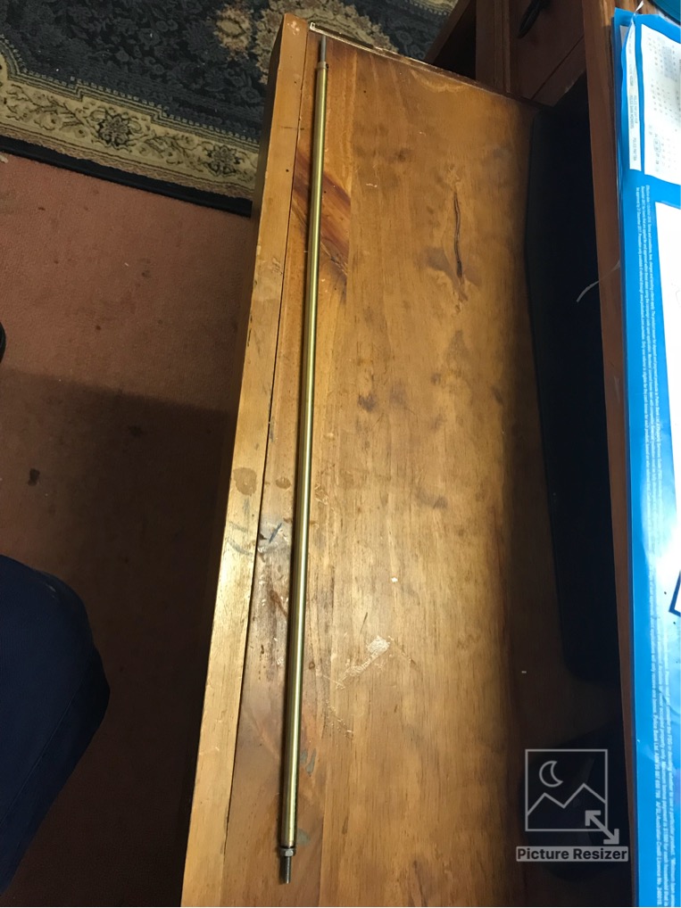

Hello all,
firstly my apologies if this question has probably already been asked a thousand times.

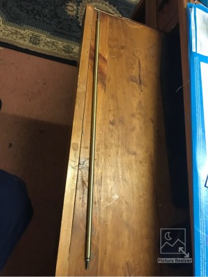

I am scratch building a 1/35 scale destroyer and am in the process of buying and fitting prop shafts. What do I need to get the job done. I have seen other scratch built ships with Hull tubes, Stern tubes and then the shaft. I have bought the shafts and tubes from a reputable model shop and they said that was all I need, apart from the A-frames. Just wanted to get a second opinion before I start the resin process. You can see the photos of what I have so far.
And could someone advise, as the shafts are just over 500mm long am I best to put any other sort of bracing in the middle of the shafts inside the hull, or will the A-frames, resin and then the motors provide enough to stop it vibrating around.
many thanks, Will

22cm of the shaft extends outside of the hull where they meet the A-frames and props, so I guess after it has gone through the hull where the resin will hold it in place there will be about 25cm before it meets the motors. Rough guess so far though but its fairly accurate

That's a very long shaft and I would definitely fit a brace in the middle, you are also going to need a flexible coupling between it and the motor, something like this https://www.ebay.co.uk/itm/Propshaft-Co ... 2624254565 and maybe an oiler for the shaft http://www.modelboatbits.com/OILER-CLAMP-SYSTEM

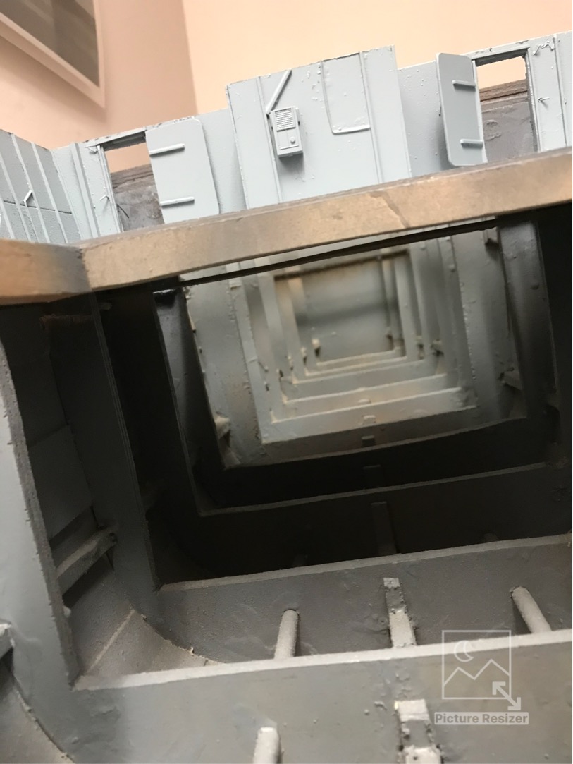

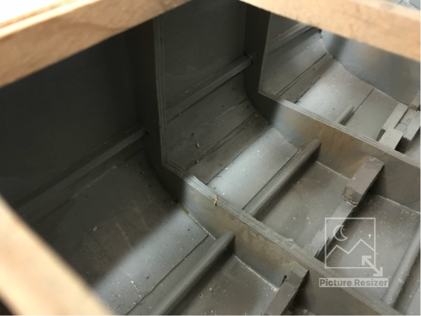

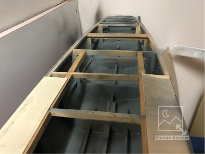

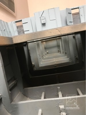

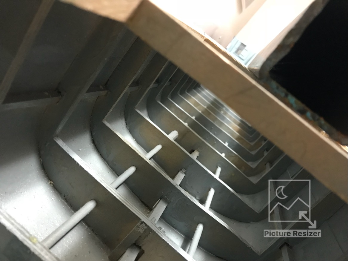

Here are some pics of the stern area. You can see in my thread other stages of the hull. So do I ballast the hull and then work out what motors to use. I will be getting them through "Float a Boat" RC shop in Victoria, Australia.
I was also thinking I could cut lower into the ribs, within reason, to get the ballast as low as possible.
cheers, Will

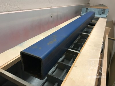

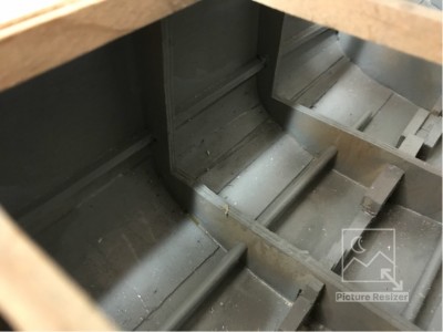

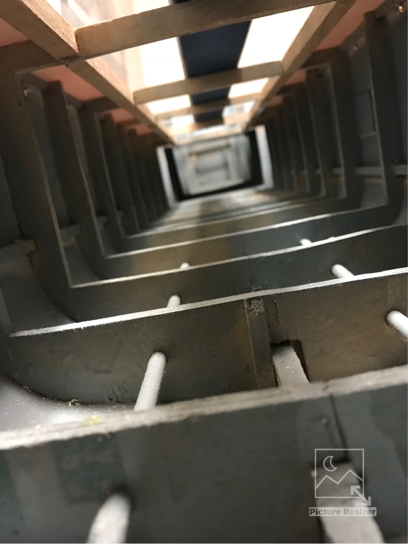

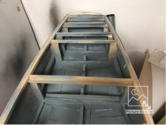

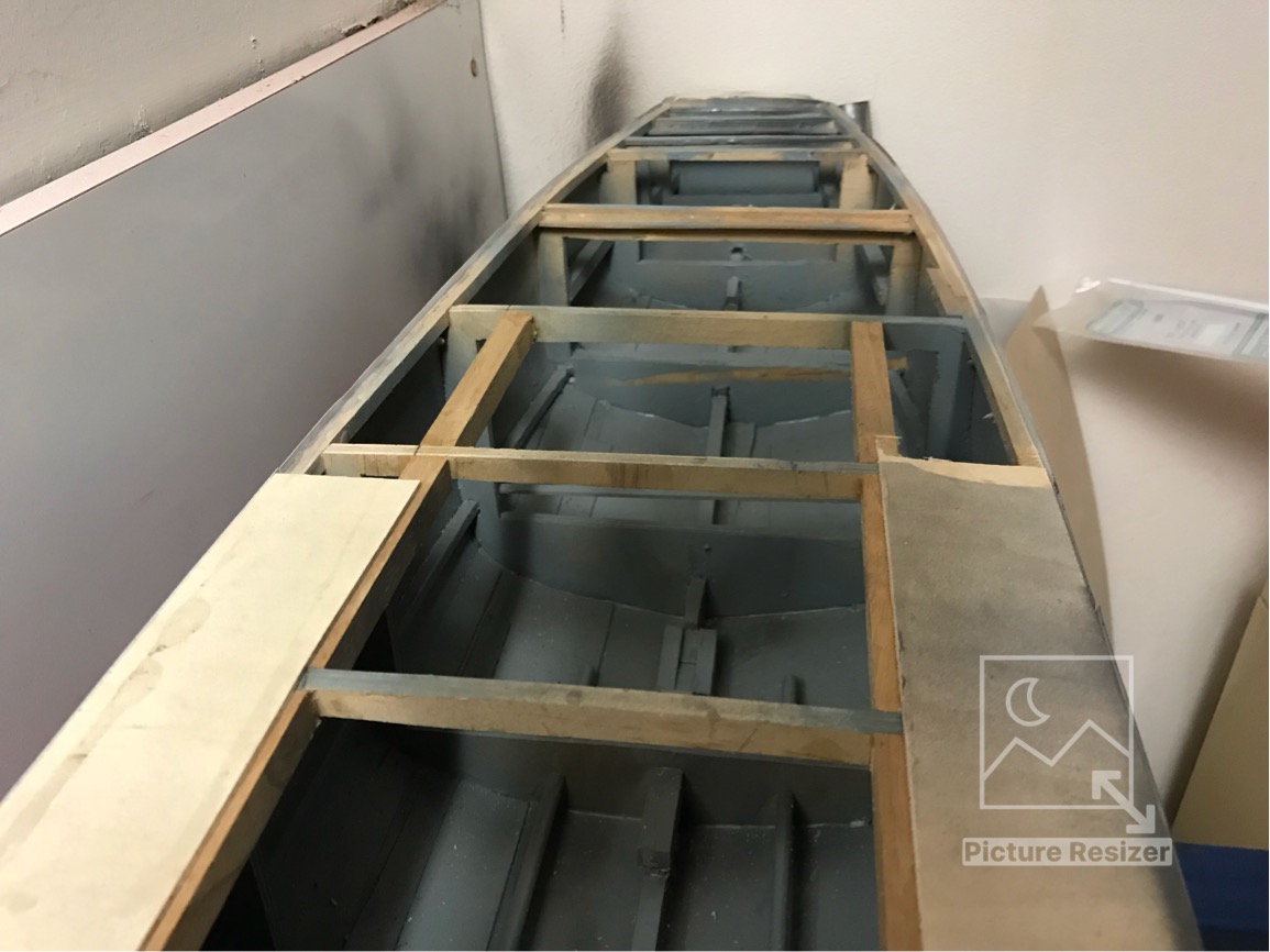

Post by englishgunner »

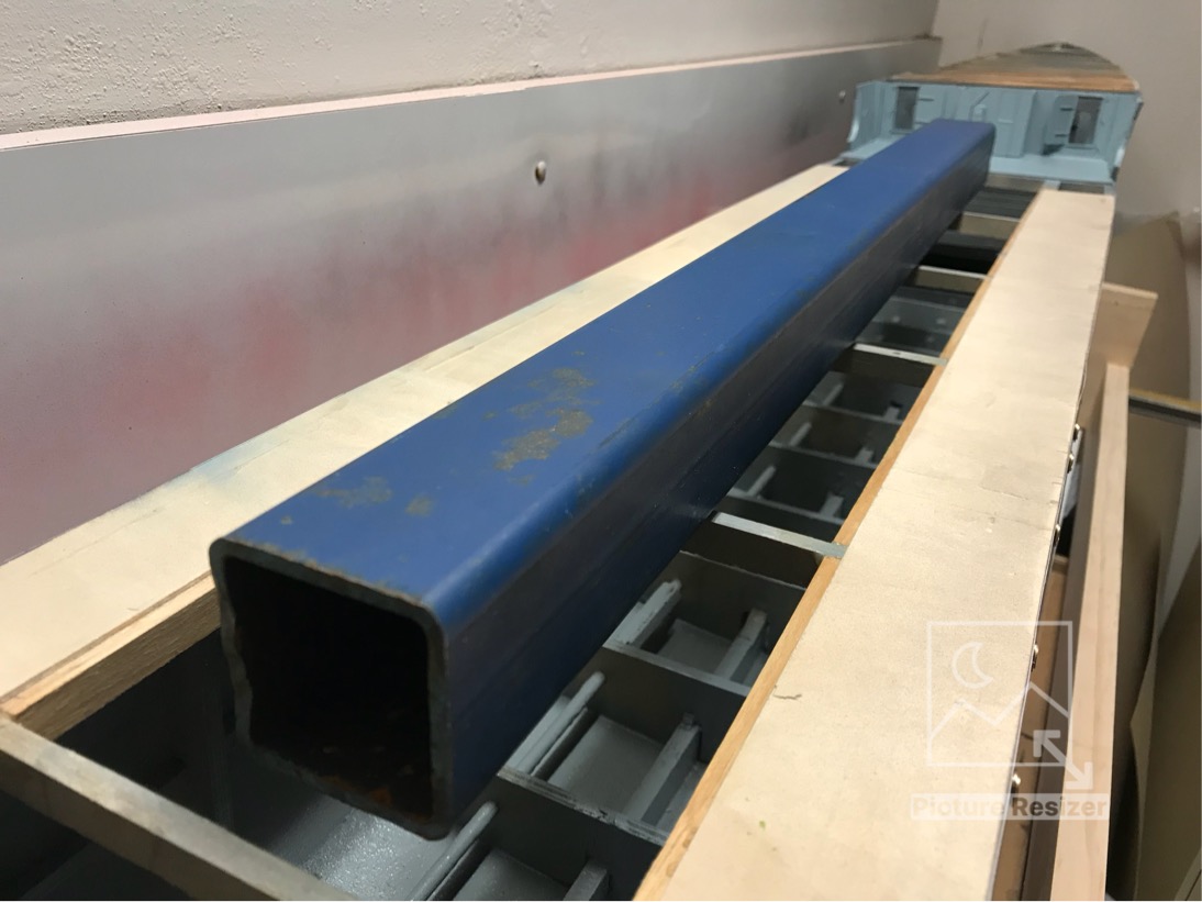

I have more pics of the hull interior, and the 40mm RHS steel I was thinking of using for ballast. I was thinking of installing it just above the keel, meaning cutting the frames 40mm wide down to the keel on the centreline. Does that make sense?. Is it best to concentrate the ballast as centrally as possible down the centre line - will it have the same effect as a keel (obviously not as it is higher in the hull), but is that better than spreading the ballast left to right.
I think it would help in that I could fix the forecastle deck in place and when about to get wet, all I would need to do is slide the right ballasted RHS up the centreline. Hope that makes sense,
cheers, Will

Thanks for the pictures Will
For me the whole starting point in getting the model to sit at the right waterline level and with adequate stability starts by knowing what the maximum weight the model can be and how much the main components are going take up of that. The shots of your initial hull work suggest that you have been quite frugal with the added weight for the bare hull which is definitely a good place to me. Have you weighed how much all your work to date takes up in total as I make a V&W typical figure at full displacement (c 1100 tons) in 1/35th scale 25-26kg max?
That will give you a measure of how much you have left for everything else which may well drive future decisions, particularly on battery and motor size to give you some margin for ballast if needed. Personally, I wouldn't use the 40mm RHS steel sections for ballast but rather would use sheet lead offcuts curved so that they lie flat in the bilge areas between the hull frames. The main way to get a level trim fore and aft would be to slide the battery forwards or backwards as required then put some restraining wood strips to seat the batteries there. This will give you the largest weight margin for any problems that come to light.
I have attached a shot of the 1/32nd Gloucester that gives some idea of how I did the shafts - I matched the arrangements on the original ship as much as possible. It does strike me that 500mmshaft length is not going to give you much clearance for full size props at one end and still allow room for motors and/or gears at the other end without angling it much more steeply than the 5 degrees or so that the V&Ws actually used. Having put so much good work into the above water detail, it seems important to follow the same realism for the under water areas!
