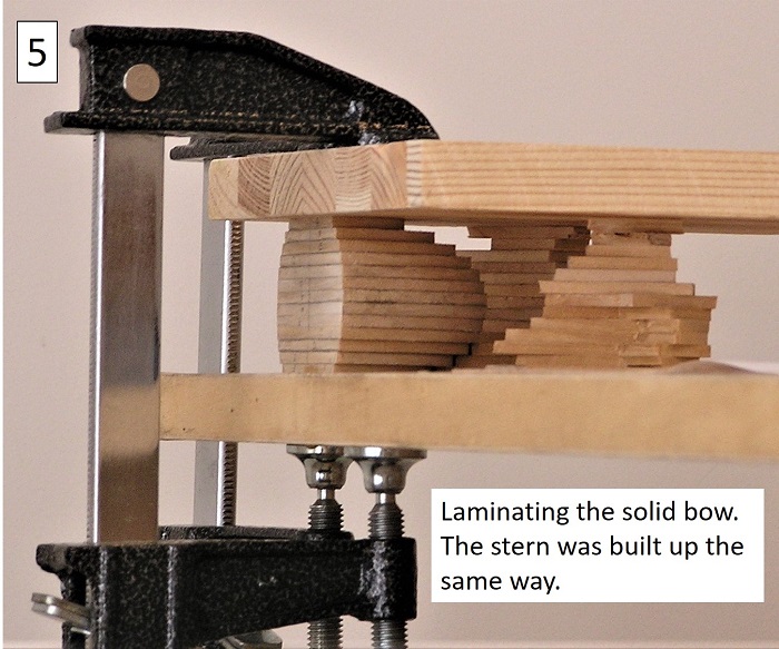

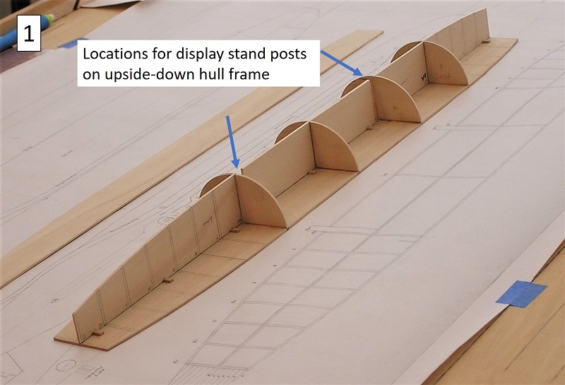

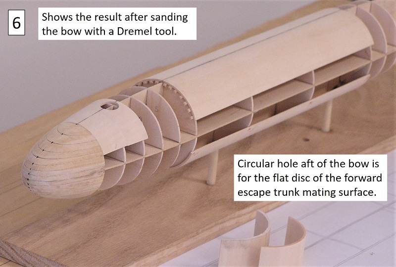

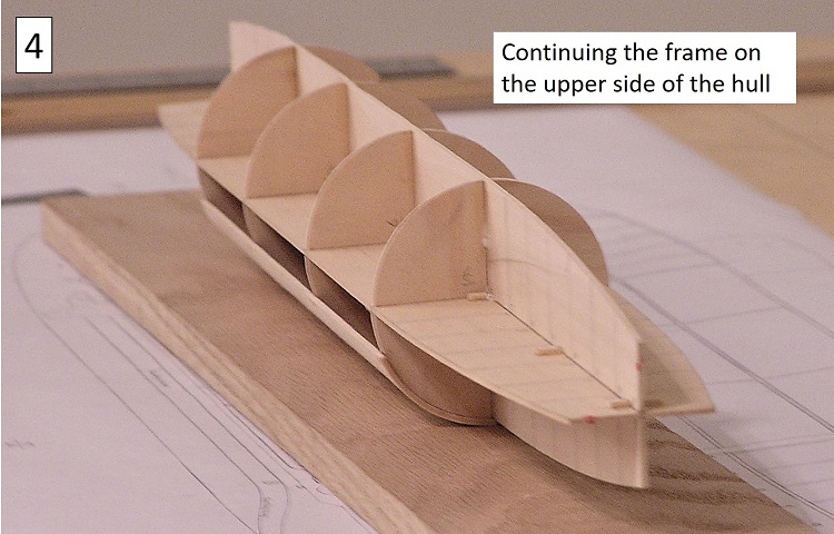

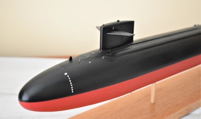

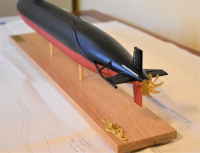

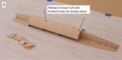

I made a scratch 1/192 model of the GATO in 2002 Then I made another model in 1/144 scale over 5 months in 2008. Both are made with 1/16-inch sheet basswood, except for the bow and stern areas that are solid from laminated 1/8 sheet. All the hull plating was curved in advance by bending them wet over a frame and allowing them to dry. That made final gluing easy.

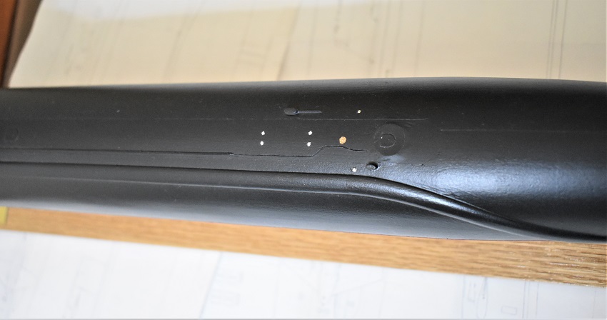

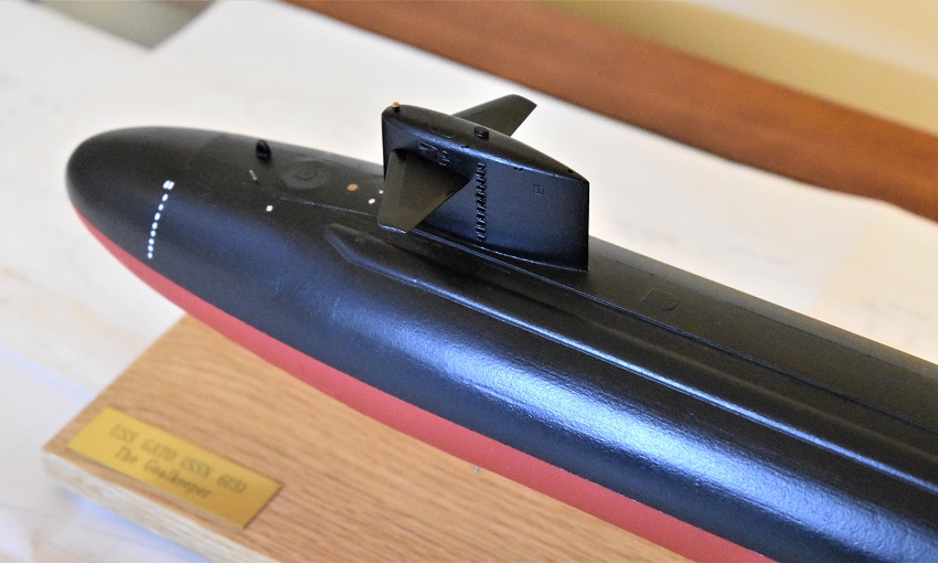

The pictures here are of the larger model made in 2008. I used index card for details such as hatches, torpedo tube muzzle shutters, ladder rungs, safety track, and the blades on the screw. The model is shown as if fully submerged, so the deck fittings are rigged for sea and all masts and antennas are lowered.
The first six images were taken during construction to show various stages of preparing the hull.
The remaining images are recent ones of the completed model.
