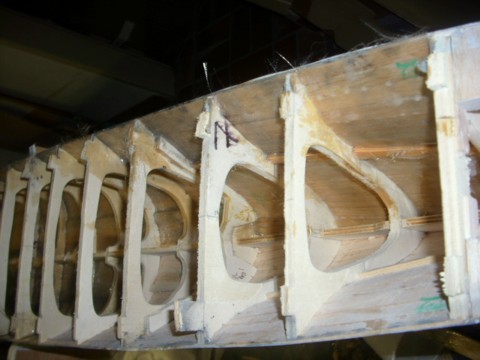

Meanwhile, the hull is existing, built from 8mm plywood (frames) and 2mm balsa planks, covered with glassfibre. I�ll post you some pictures tonight.

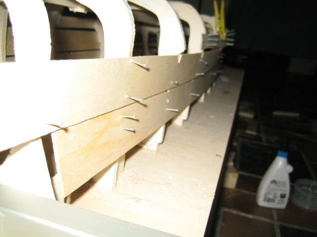

Hello!

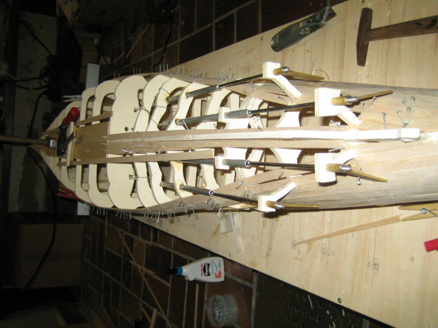

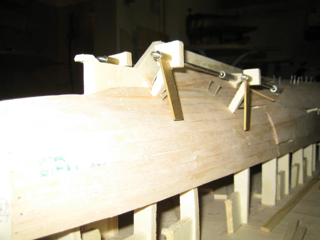

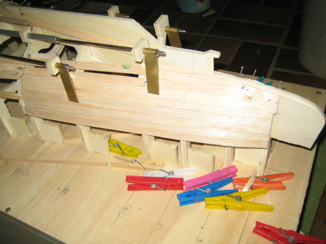

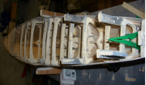

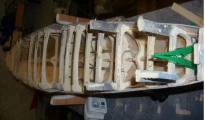

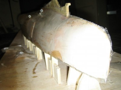

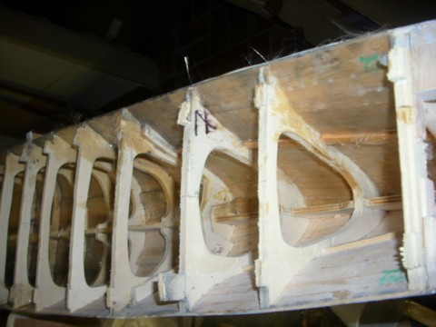

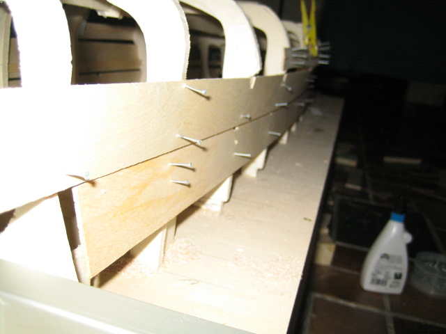

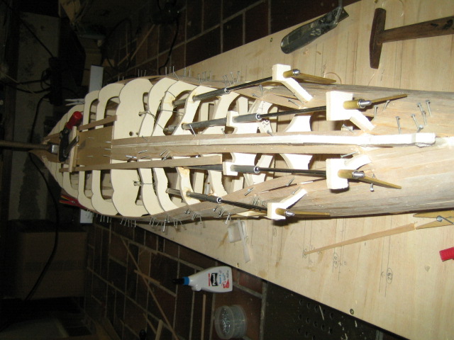

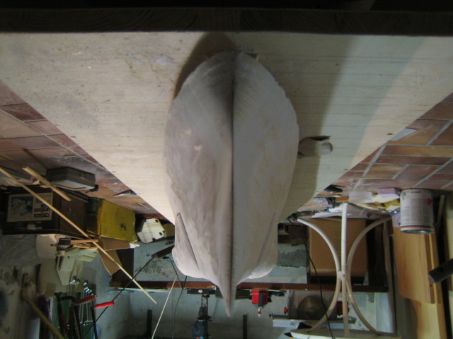

As promised, here are some photos of Renown building. I started in April last year, but inbetween my Granda died and so we had to some other things for a couple of months...
Now her flat is restyled and there is time to proceed. Take a look!
Best regards
Joachim

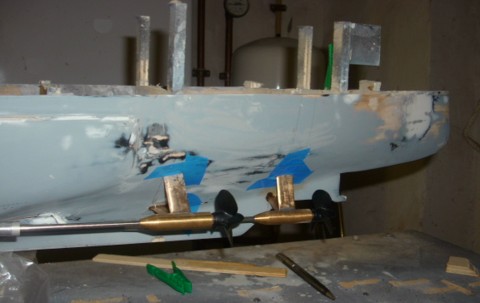

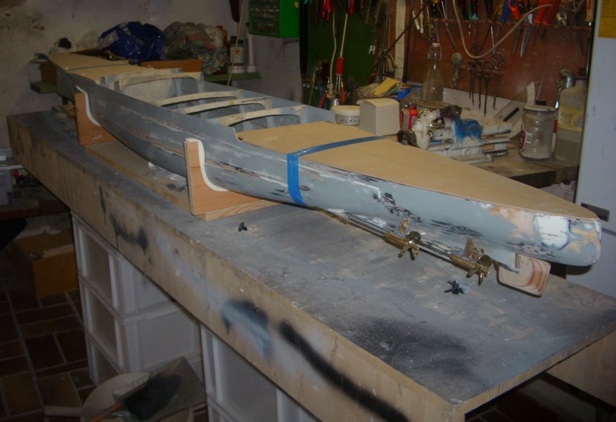

Re: Scratchbuilding HMS Renown 1942 in 1/100

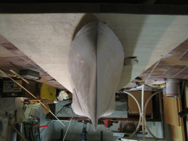

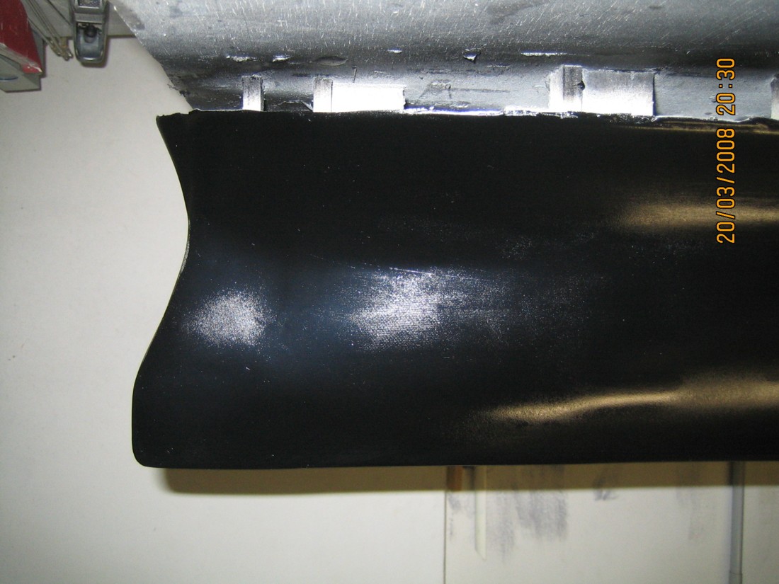

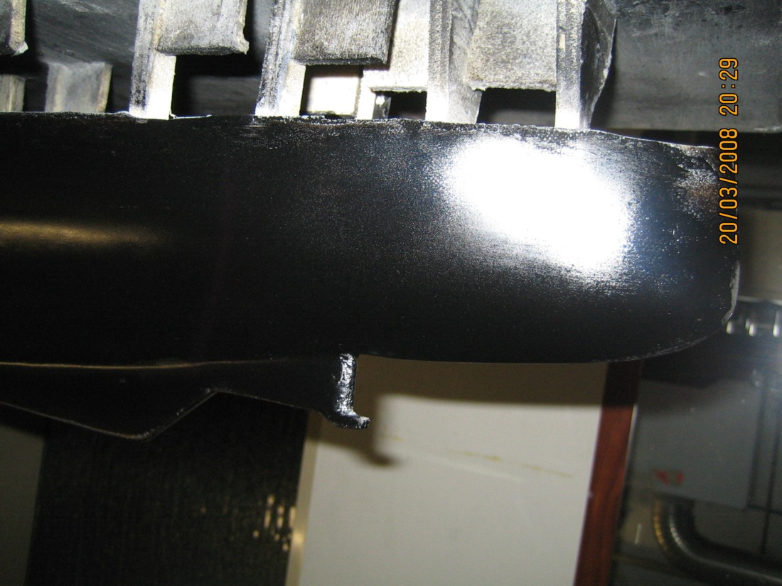

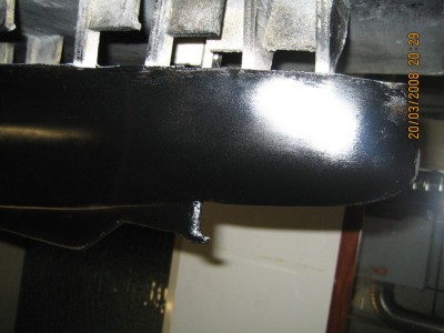

Hello!

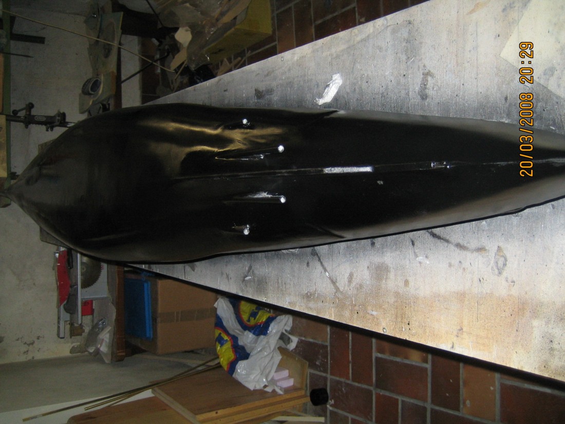

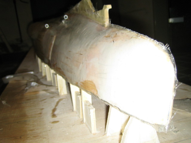

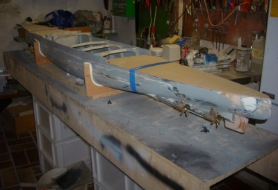

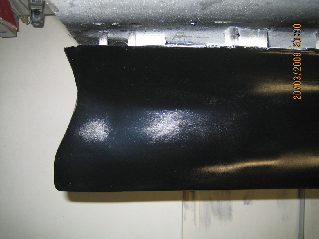

I can�t explain how I got it at last, but now I can show you some more photos:
Renown is black and still showing some ugly buckles and dents. But I�m armed with tons of resin filling compound and a week easter holiday, so say goodbye!!
Next big step will be the installation of the 4 A-frames, then I hope Renown can be removed from the slipway and touch the water for the first time (one reason for her giant size is my r/c plan).
So let�s go on sanding and smothing...
Best regards
Joachim

- kennylibben
- Posts: 1065
- Joined: Tue Jan 11, 2005 7:25 am
- Location: I live in Off-Topic...
A very sharp looking hull!

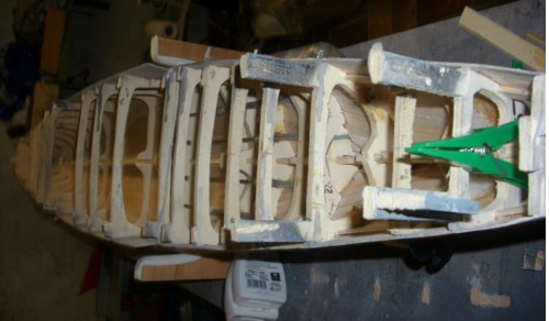

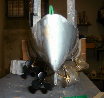

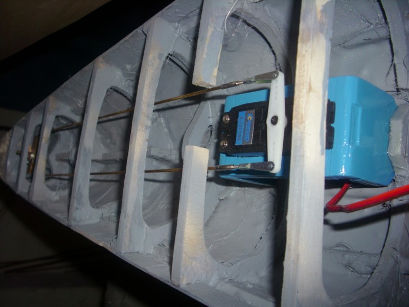

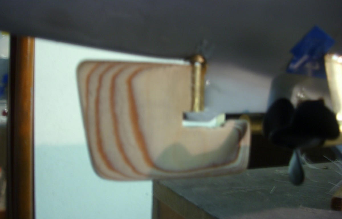

Dear friends,

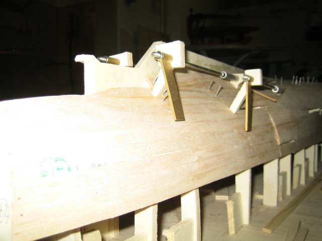

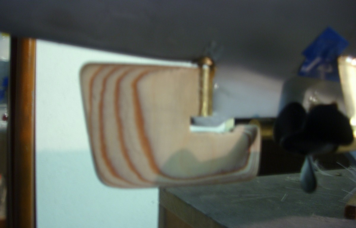

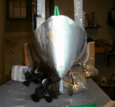

some days off brought progress at the dockyard, 4 shafts have been installed with wonderful brass a-frames but without props yet...
Today, there�s been the dangerous moment with the big question: will the hull survive the launch without distortion? She has!! Immediatly, I�ve started internal protection with a double layer of glassfiber. Look at the results, I hope I�ll be able to keep up a certain building speed now, want to see her being flooded out...
Best regards from Dortmund!
Joachim

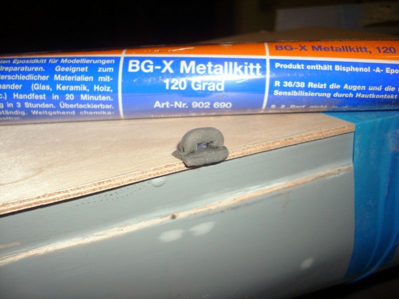

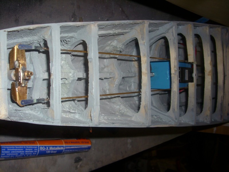

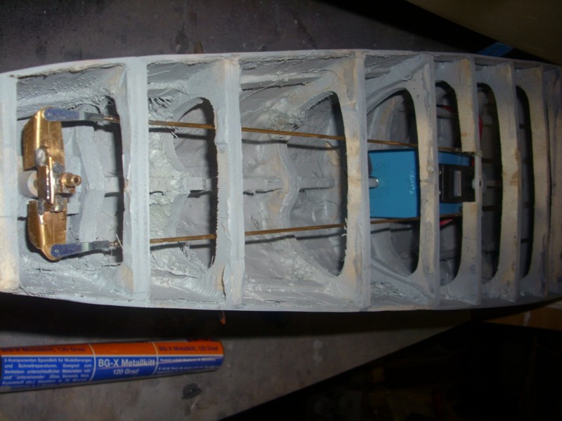

Dear friends,
at first: Alles Gute f�r das neue Jahr! Have a good new year!

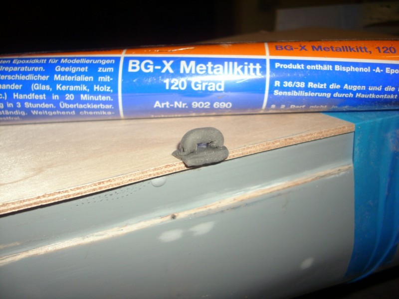

Last year�s new year resolution had failed: Renowns keel did not touch water except wet grinding:-( This year�s resolution is to reduce construction intervals!
So I cut Fore- and Quarterdeck and fixed them preliminarily onto the hull. So I hope they�might get used and bent to the camber.
I filled the gaps caused by attaching the a-frames to the hull with 2-Component metal putty, a wonderful stuff. It gets very hard and can be dealt with saw, rasp, drill and emery and is paintabel. For experminent I built a rough version of a fairlead (right vocable??) and still am astonished how robust that stuff becomes.
I suppose I will be using it area-wide for bollard, fairleads, hawses etc. because I don�t really can find these things ready to fix on Renown in the internet...
Look at the small progress and keep on reporting your models! It�s so instructing!!
Joachim
