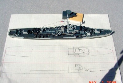

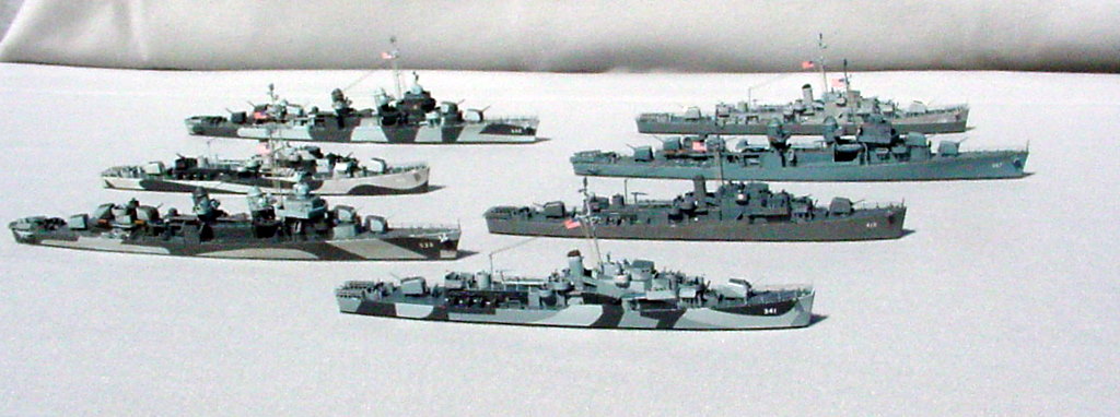

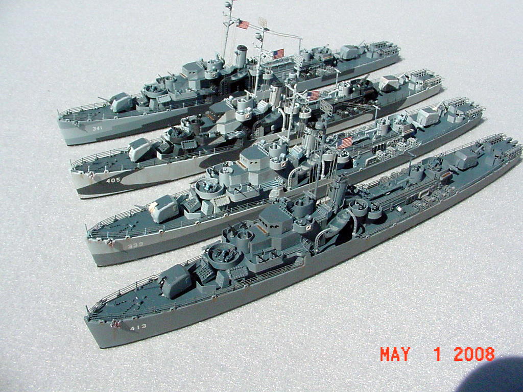

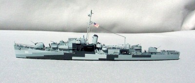

I have had a long standing ambition to build the seven escorts of Taffy Three. Some time ago, before Trumpeter released their square bridge Fletcher class, I converted three Tamiya Fletchers to the square bridge mid war fit (DD-532 Heerman, DD-533 Hoel and DD-557 Johnston). When Trumpeter released the 3" DE England I had hopes they would follow up with a 5" Butler/Rudderow (they have the same hull). In order to force the issue I finally gave up and converted four Englands to the four Taffy Three Butler class ships DE-339 John C. Butler, DE-341 Raymond, DE-405 Dennis and De-413 Samuel B. Roberts.
The conversion was fun. I removed detail / filled holes on the main deck with the exception of the extreme bow and stern, mooring bits and the mid ships deck house guide rails. Three wood pieces made up the forward superstructure (see the plan in the first picture). The mid ships deck house and funnel uptake had to be shortened at the forward end. Corsair Armada 5" gun houses were modified by beveling the rear top edge to provide clearance for projectiles fired from the hedgehog ASW weapon. Only the forward mount needed this modification but the aft mount was also modified to standardize construction. All other details were built using plans published in "Destroyer Escorts of WWII" (Floating Drydock) or Squadrons "Destroyer Escorts in Action".
Paint. My first step was to go to Snyder & Shorts camo database for the 1944 Butler class DE's
339 .... 32/11d ...and... 22
341 .... 32/2c
405 .... 32/22d
413 .... 32/22d ...and... 21
My first thought was "wow..maybe a 21, a22 and two dazzles". This thought was the seed of heresy. Further looking indicated that all for ships were in dazzle at the time of the "Battle off Samar" but by that time I was firmly in the camp of variety over accuracy.

Jim,
That's amazing work. I wondered if that Trumpeter kit could be modified in such a way. Now I know!

Fantastic work, What an awesome collection.

Devin, Cadman and Martin, thanks for the kind words. I find that I prefer the "look" of the low bridge 5" DE's when compared to their 3" high bridge cousins.

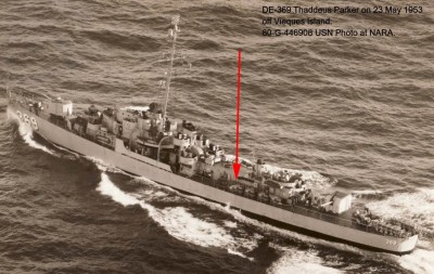

OK. Well I don't have many WWII era photos with the torpedo tubes, but here are a couple of BUTLER DE's with PORTSIDE views that may help.
The first two images are of DE-369 THADDEUS PARKER taken on 23 May 1952 after being recommisioned for the Korean War. But, she is basically in WWII rig without the Anti-Kamikaze MOD of an aft quad 40-mm mount and two amidships twin 40-mm mounts that all DE's were updated to if they were recommisioned for the KW. The torpedo tubes were removed, but you can see the foundation ring.
The next set of images are of DE-444 GOSS taken on 2 March 1945, the second two images are close-ups of the deckhouse area.
The last image is of GOSS in 1955 after getting the late war mod ... minus 20-mm guns ... and was typical of non-ASW special versions of the BUTLER DE's post-WWII.

These are fantastic, man!
I can't thank you enough.
Is this the an accomodation ladder or are these the projectors for the K gun?

I think you are asking about the vertical items behind the K-Guns and their reload racks. They appear to be the mortar projectors for throwing the depth charges stored on the bulkhead.
