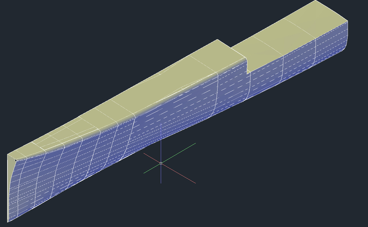

I find the best way is to create the sections of the ship frame by frame and loft them into a continuous hull form.
Note I am only doing half as the other side is mirrored to complete after the side is done.
