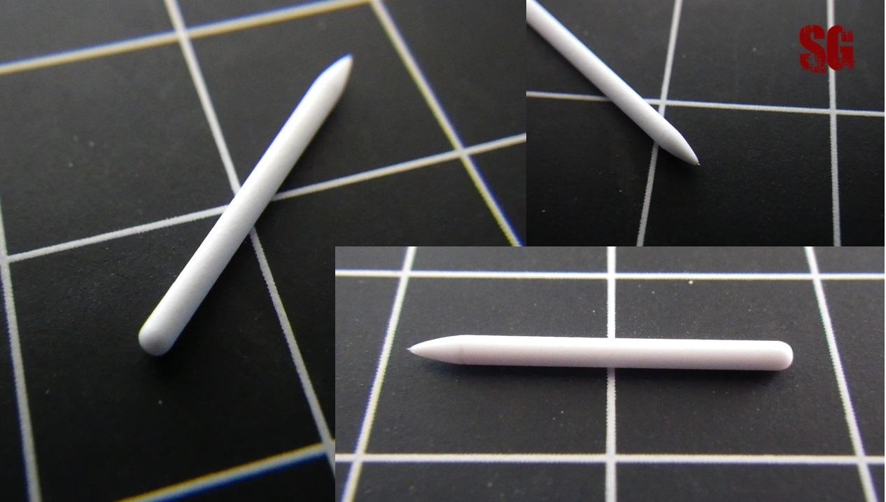

Main body: 1.3 mm diameter styrene rod, tapered at one end and rounded at the opposite end, sanding, sanding..

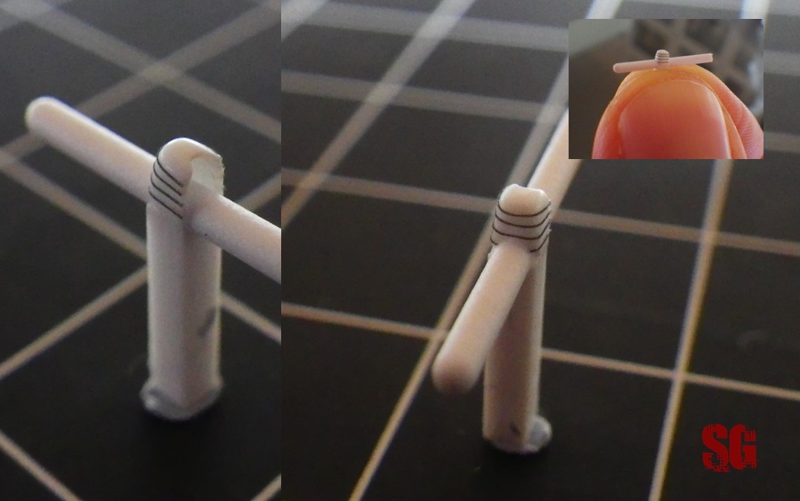

The Fast diving tank was a model in a model that took me a year to complete

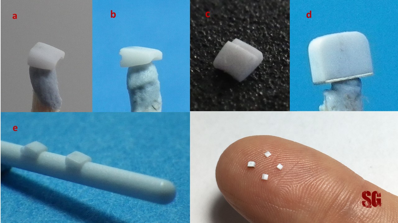

My latest production. Made 2 versions of the front seat (a,b) (one with the slot for the starboard side taps of the fast dive tank-b), the wooden block (d) that counterbalanced the SLC engine weight and the step-shaped rear seat (c).
The shield was carved and shaped from a styrene square rod. Ribbing was done with the thinnest rigging thread from the Uschi range, glued with Ca. I chose a 4-ribbed style

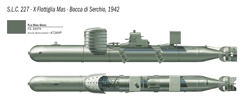

A splendid SLC Maiale artwork taken from the 1/35 Italeri kit for you to get familiar with the engine's main features

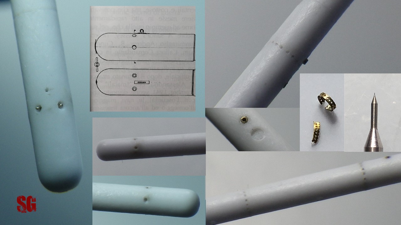

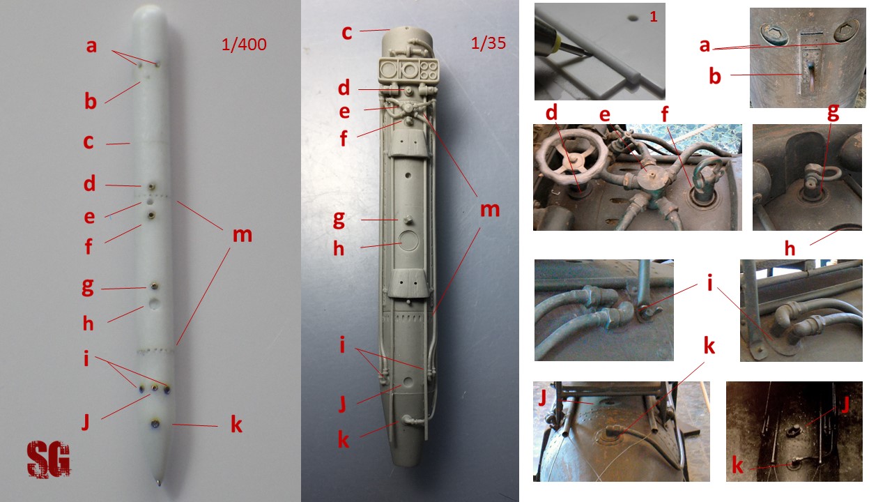

Some more progress. I completed the drilling of the 13 main holes for the housings distributed on the Maiale surface plus 2 more for the pedestal arms at the bottom of the torpedo.
All the main holes are 0.2 mm wide and host sections of brass tubing simulating the housings. Three holes at the stern section are 0,25 mm wide and host stainless steel tubing sections coming from insuline pen needles.
I began with drawing the cardinal midlines on the major axis of the SLC with a bevelled pencil lead and the torpedo body fixed on double-sided adhesive tape, sandwiched between two 0.6 mm plasticard panels. Then marked and drilled the holes and scribed the demarcation line for the warhead (c). Hole (e) was deliberately drilled off-center. (1/35 Model Victoria SLC was used for comparison and reference). I experienced several breakings of the tips resulting in painful dug-outs of the broken tips and the creation of horrific distorted and enlarged holes that had to be repaired (used magic sculpt and/or CA to good effect) or just filled and redrilled.
A special effort was made to recreate the circumferential recesses for the nut rings keeping together the main sections of the SLC body. These are 0.1 mm holes, drilled with a short-tip dril bit on a jig i crafted on purpose from a superfine catwalk PE from the WEM range (spacing between holes should be 0.15-ish mm).
The ring jig was glued temporarily to the torpedo with a droplet of Ca to pin it. Ca was then sanded off after the drilling. I recommend this technique to superdetail any torpedo showing nut ring recesses in the 400th and 350th scales, its easily reproducible. These details add texture to the model and lend themselves to be enhanced with a pin wash at a later stage.
The after ring of holes on the SLC had to be corrected several times with CA, sanded and redrilled, therefore it looks less perfect than the forward one.
The bolted recesses (a) on top of the warhead are 0.2 mm holes hosting a 0.1mm central hole filled with a 0.1mm nickel wire section.

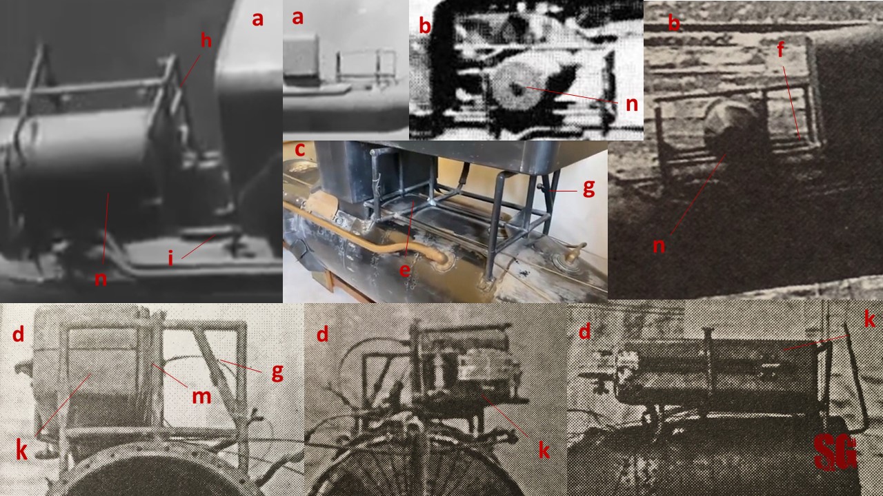

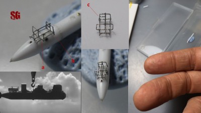

Hi! I completed the SLC's tools bonnet, a cage-like structure that was located aft of the wooden block. Accurate study of the few wartime pictures available revealed the bizarre architecture of the "bonnet" and the existence of minor subvariants.
I prepared some pre-shaped sections from Shelf Oddity 0.06 mm wire and assembled them with CA. The joints were reinforced with diluted acrylic glue applied with a brush, trying to avoid build-ups. The shaping phase was a nightmare because of the stiffness of the wire (probably a molybdenum-based alloy), its shape-memory properties and the very small dimensions of the sub-assemblies. In particular, piece D was hell to shape. It took me nearly a month of miserable work before i got a decent shape :big_grin: . RP Toolz micro-handle bender, Tamiya flat tweezers "for Photo-Etched parts" and a 0.6 mm styrene jig helped a lot.
Bottom pic: the completed "bonnet" dry-fitted to the SLC body and compared with my index finger. It is SMALL :big_grin:

Spent january researching on the tools bonnet. Identified two variants of it, thanks to several Royal Navy declassified pictures that a generous friend sent me. Brought to a late-style status the bonnet i had crafted, detached the sloping section at the "headboard" and glued a horizontal bar instead of it (c, in the first picture). More in line with the late-war SLC version i am trying to represent. Easier said than done, anyways :big_grin:

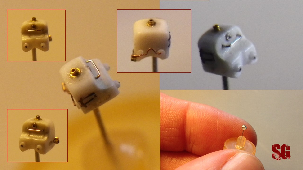

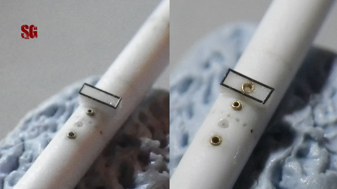

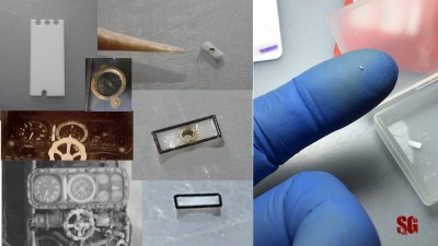

The following month and a half was spent trying to complete the preliminary work on the instrument cluster. The plan was to shape the main body of it and then to add the top frame. The area within the frame should be painted black and then filled with a droplet of Kristal Klear or brushed with some gloss varnish to simulate the glass of the instrument box, at a later stage.
I shaped the cluster base from a 0.5mm-thick styrene panel, drilling a 1.3 cm hole at the edge of it. I left some 0.15 mm distance from the edge of the panel, matching with the height of the cluster and then detached the main body from the carrier.
For the frame, I had originally thought to use a rectangular section from a superfine 1/700 brass ladder/railing PE fret in my stash. But although the PE thickness was fine, the frame didn't look as thin as it would be needed. Opted for a 4-component frame instead, made of 0.046 mm metal (?nitinol) wire sections, assembled with CA.
Did a few feasibility studies on drilling out the various gauges in the box base (2x0.3, and 4x0.15 mm holes :big_grin:) to improve detailing, but achieving a convincing result proved to be beyond my capacity. I finally prepared two versions of the cluster: a "full bodied" one which is probably the one i will choose (less is more in this case i think), and another version sporting the central compass (a section of 0.3 mm brass tubing), basing on the assumption that the brass detail would stand-out somehow, just like it did for the real thing (the brass compass was usually left unpainted and sticked-out pretty much, as photos showed).
A few pics illustrating the progress and showing bonnet and instrument boxes dry-fitting the SLC. Suggestions on what version of instrument cluster to use are most welcome.
