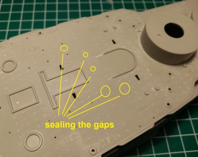

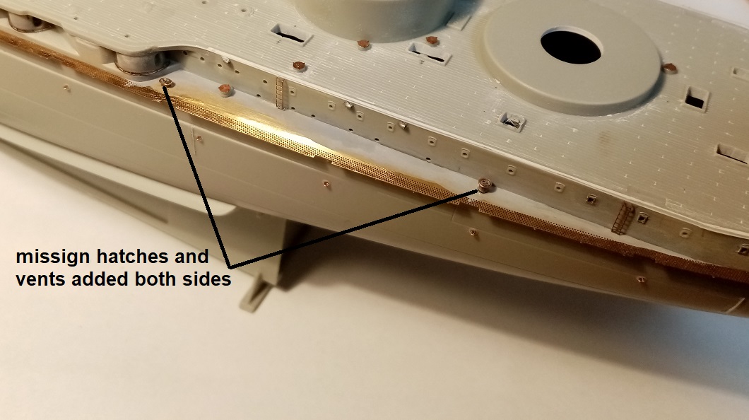

I started with the Viribus Unitis because of the great resources. Based on the drawings and pictures, I have already replaced a few things on the hull: the eaves above the windows, or e.g. those pair of fans on the side of the ship. On board, after I saw that there was also a discourse about this, I sealed all the small joints of the decking as a test, and then scratched again to make the excess disappear. Before gluing the deck, I created the balcony of the admiral's salon. There is a good picture of the museum model showing an armchair and a small flower. I also put a couple of windows and doors on the wall. After final assembly, nothing will be visible from this either, but I like to have fun with such things :D

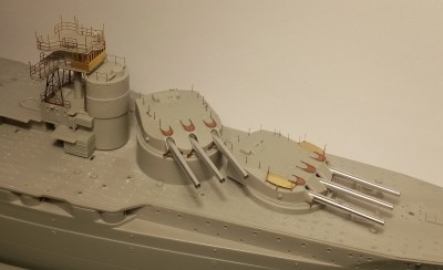

I put on the gun turrets what Eduard offered, but then a few more small things need to be add.

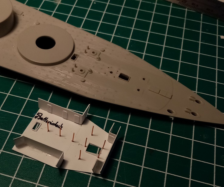

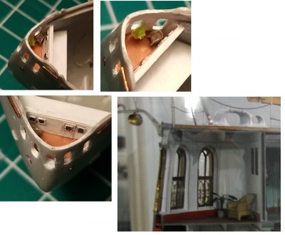

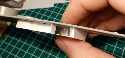

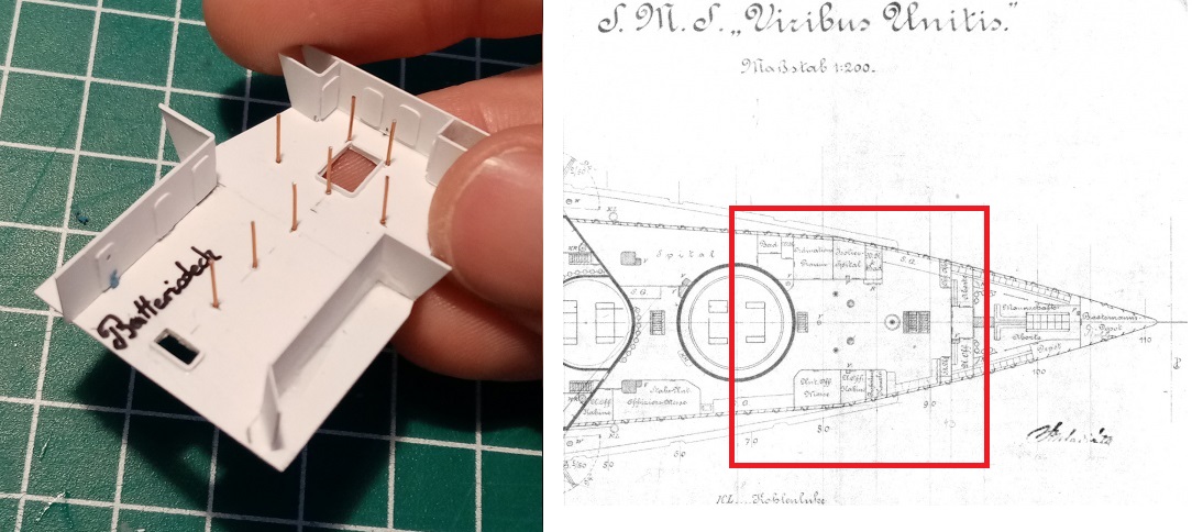

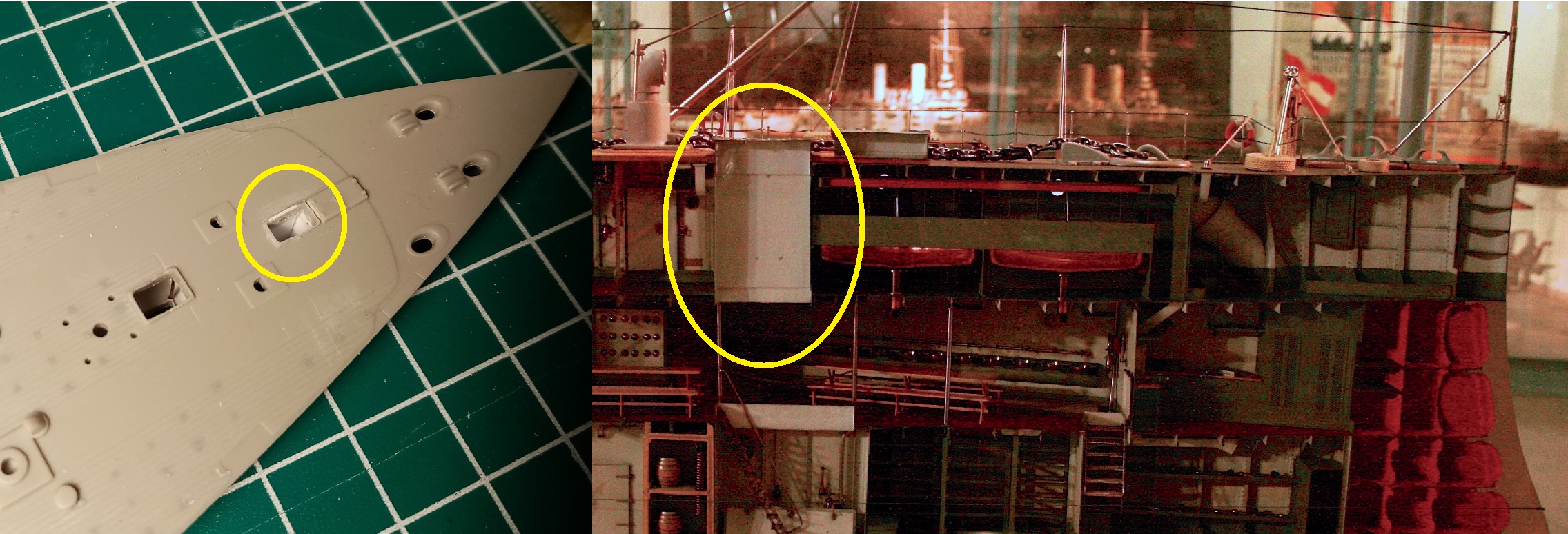

My basic idea is that the ship will be anchored in Pola, so most deck hatches will be open. The first two openings seemed so large that the observer could easily see into the empty hull, so I thought I would add at least 1 deck where needed. This small piece was made based on the drawings and the 1:50 scale model. When I tried it on, however, it turned out that not so much will be visible, so placing many more details after painting will not make sense. I will also install the stairs once the post office finally brings them...

SG1! Fortunately, there will be no problem with the windows, because Trumpeter provides the window frames as etching :cool_1:

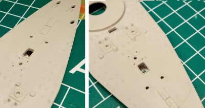

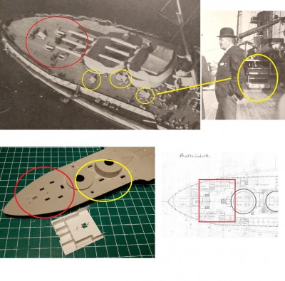

In the meantime, I cut out almost every hatch on the deck. What remained closed I found closed in most of the pictures.
Not all hatches need stairs, and there are places where 1-1 ventilation shafts lead down into the hull (the last and the very first hatches are just like that). I also made the side walls of these, so if someone looks in from the side, they can see this as well.
I made another larger section in the stern, under the deck, but not more, because in the various photos of the ships the hatches are fully opened here, and there are openings around the gun turrets that are only a crack open, so nobody even see anything under them.

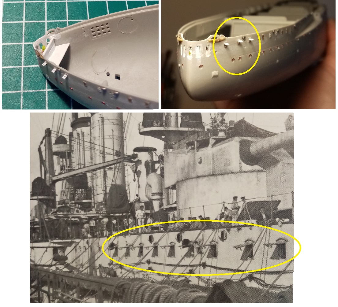

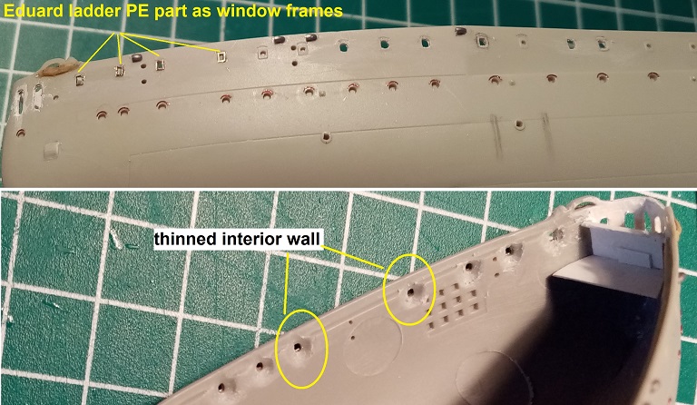

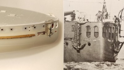

The last few days looking at the photos, and I realized that not just the hatches on the deck were open, but some or almost all of the larger windows on the stern were also open. I didn't open all of them, (because I�m lazy...) I drilled and carved a couple of windows to make them square. For the opening, I cut window frames from the Eduard ladder PE set and made the cover from a thin plastic sheet. I drilled the location of the windows on the covers. Loooong sooo looong work�

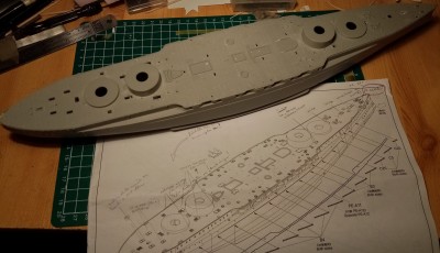

Lately, there have been no spectacular results: I glued the deck in place, sealed the gaps, then sealed a little, and then a little more to seal some more...

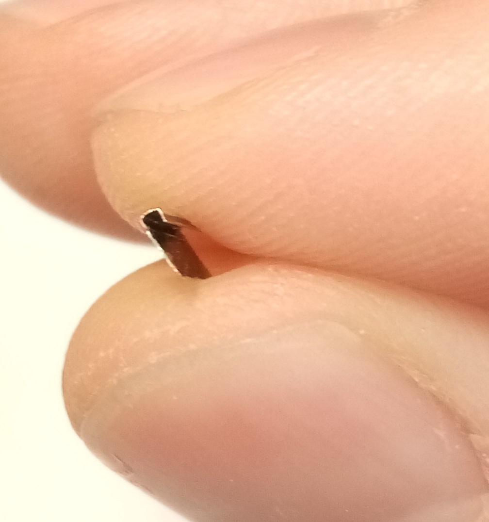

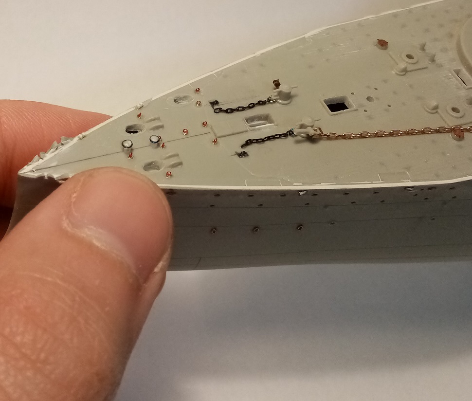

I detailed the bow a bit. Based on pictures and the Prasky blueprint, missing elements were added: rings, fasteners used to fix the anchor chain or other things on board. I tried to bend these rings as finely as possible, this was the thinnest copper wire I could loop around the smallest drill bit...
I did not try to replace the anti-slip plates with copper etching, based on the photos, the pattern is so small that any similar sheet placed on the model would be overscale.
Before priming, I try to glue as much as possible to the hull (although it is more vulnerable this way).

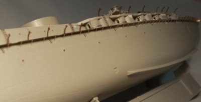

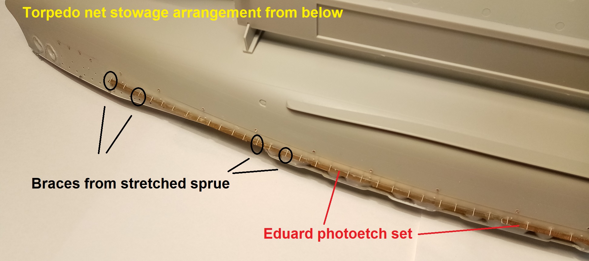

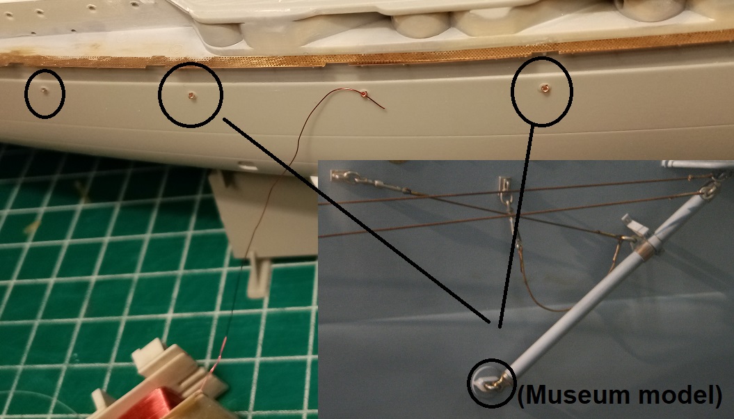

I didn't make much progress in the last few weeks: I glued the connectors of the rods holding the torpedo protection nets and the pavements/sidewalks(?) of the torpedo protection net from the Eduard set, which unfortunately did not match the hull everywhere. There are places where it separated so much that I had to cut it into pieces and glue the smaller part to it. After that, it was quite nerve-wracking to glue the braces of this sidewalk...
I looped the connectors of the support rods from thin wire. I don't know yet, how can I hook the rods into these, but I working on it.

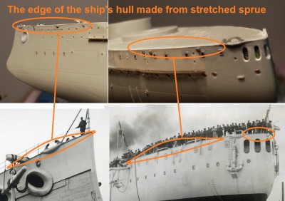

I always find small things on the hull that need to be repaired, so it came up, e.g. that thin little rim that runs around the edges of the hull. I also solved this with stretched sprue. I'm slowly getting to the point where you can stick the little things from the Eduard set.

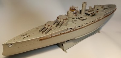

I didn't make much progress (in the meantime, my model railway is also being developed :cool_1: ), but I detailed the 2 anchors on the stern. Curved barriers have also been added around the secondary artillery, although they may be oversized, too high and thick compared to what you see in the pictures, but I haven't found a better solution now, I've run out of usable railing etchings... Plus I added a few missing parts.

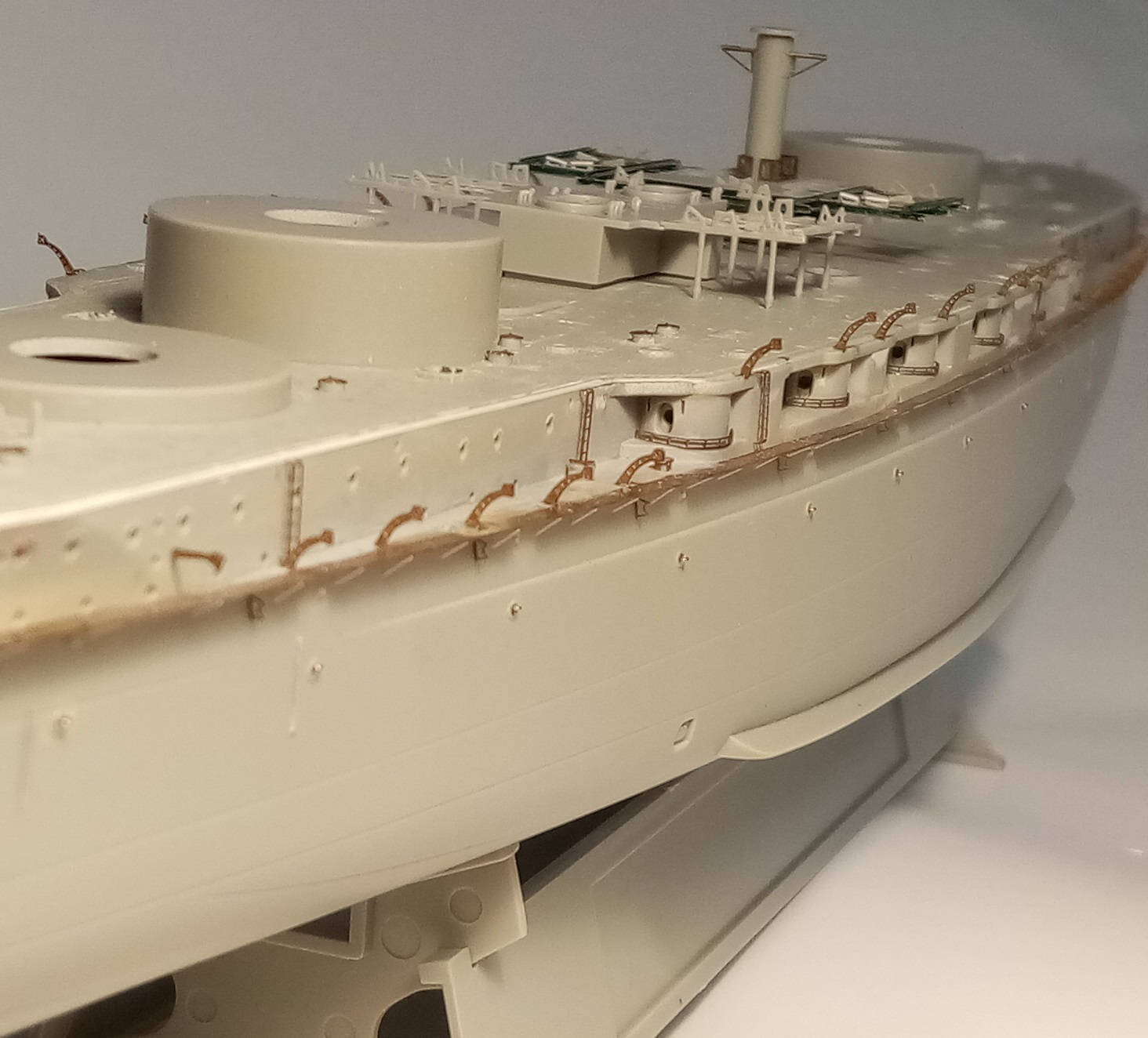

Recently I glued the small holders for the torpedo protection nets and the holders for the rods. There was a bit of a mess here, because the last 4-4 holders on the stern were too long, I had to cut them off. Also, this holders placement wasn't good either, they were placed according to the blueprint, so in theory it's accurate.
The Eduard etching isn't perfect, but I won't buy the Ship Yard Work set, I don't have the money for it (by the way, there are some pretty wild things in it that have nothing to do with reality..).

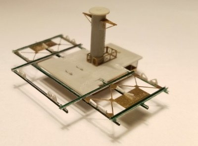

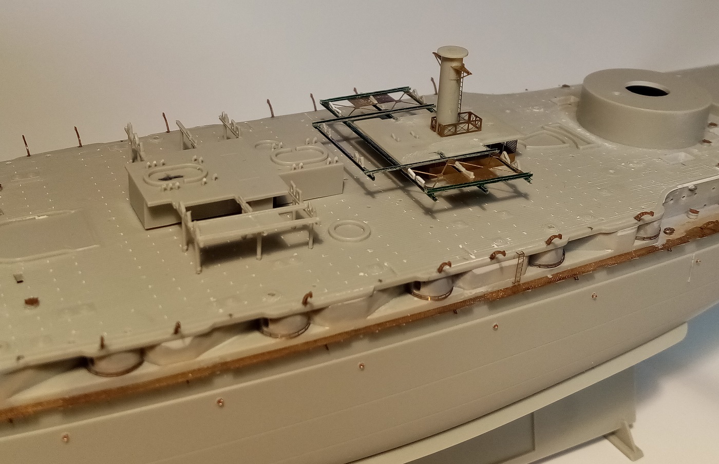

After that, I started assembling the �grid� that holds the boats above the deck. First, I simply glued the model parts together. I wasn't really happy with it... And because I has sick ideas, I started to bent a very thin sheet of metal and cut it to size to form the small beams, which I then glued to the superstructure and to each other with instant glue. Compared to the drawings, these turned out to be a little wider, but I didn't have a thinner, sharp-edged metal template for this operation. I decided to install the support columns only after the final installation, but that's still a long way off...
