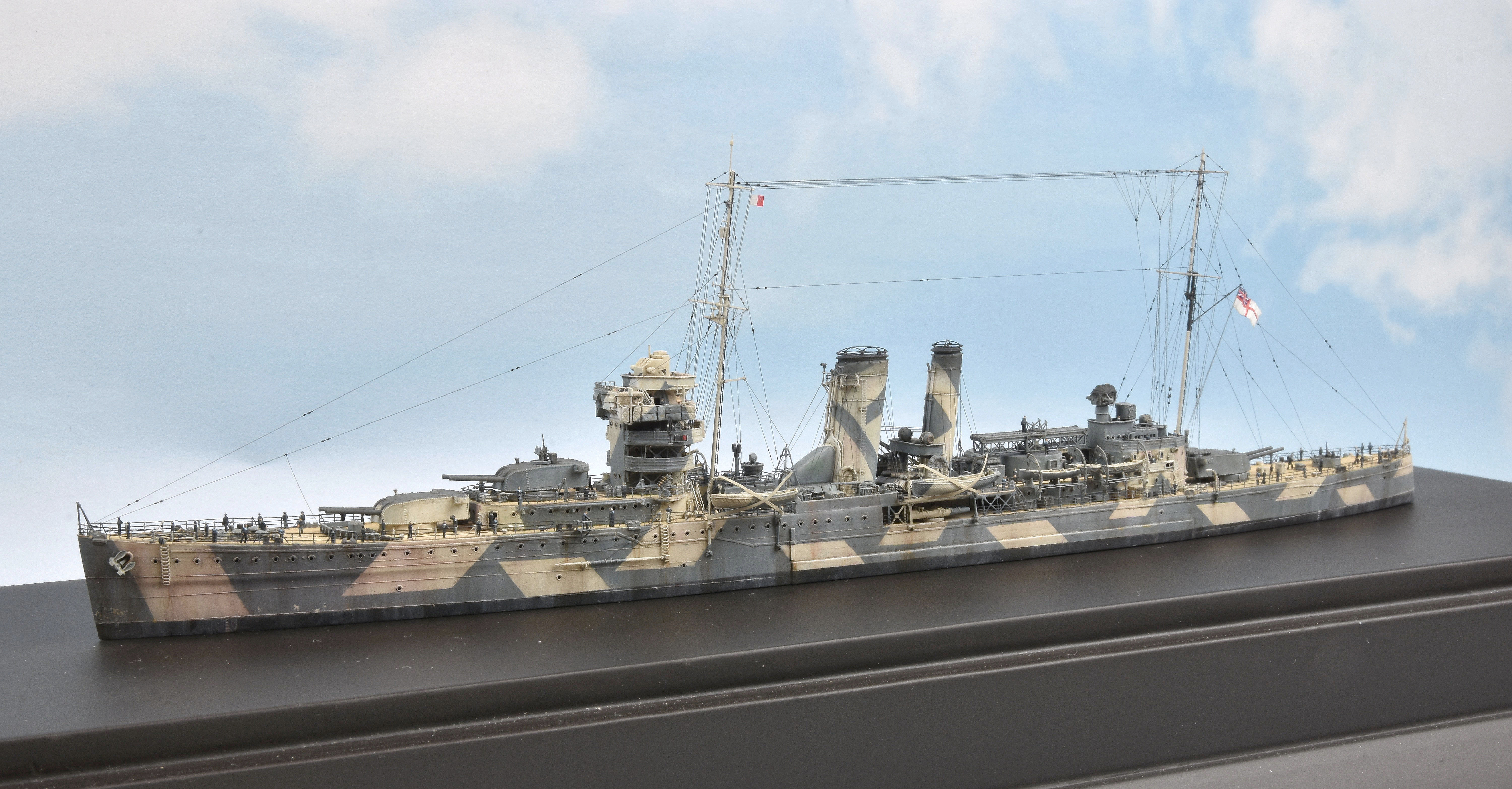

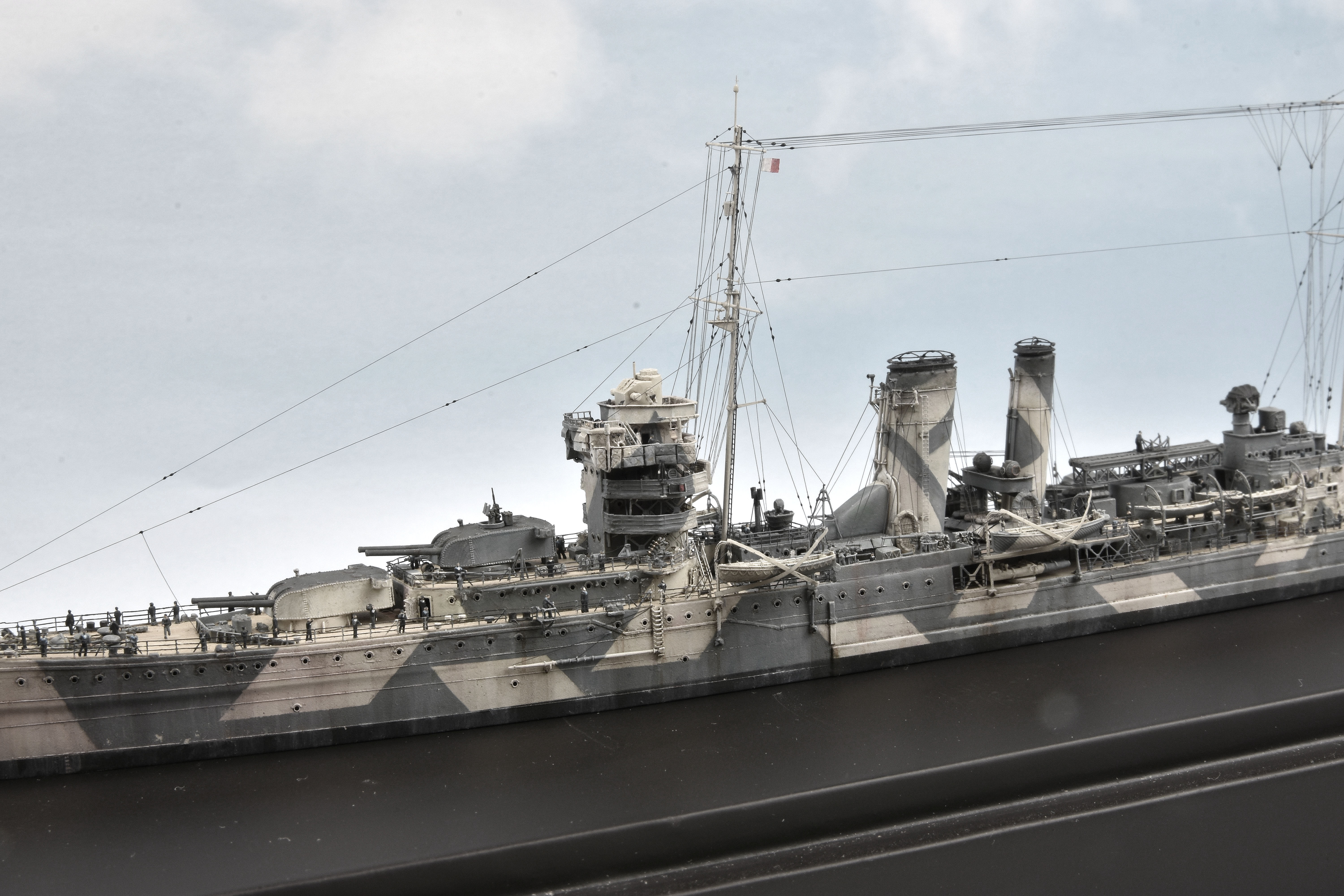

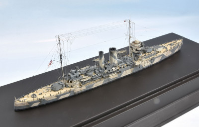

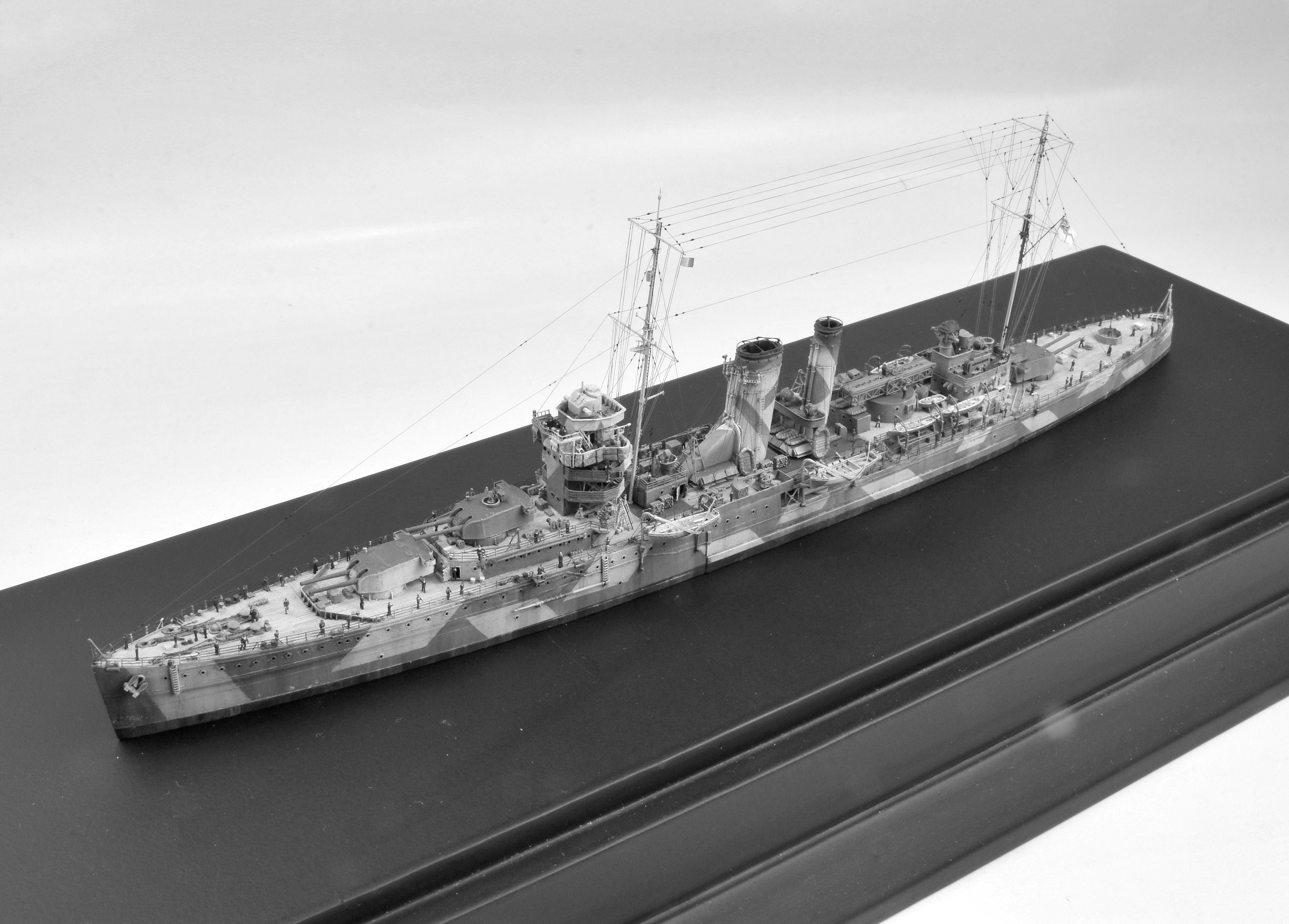

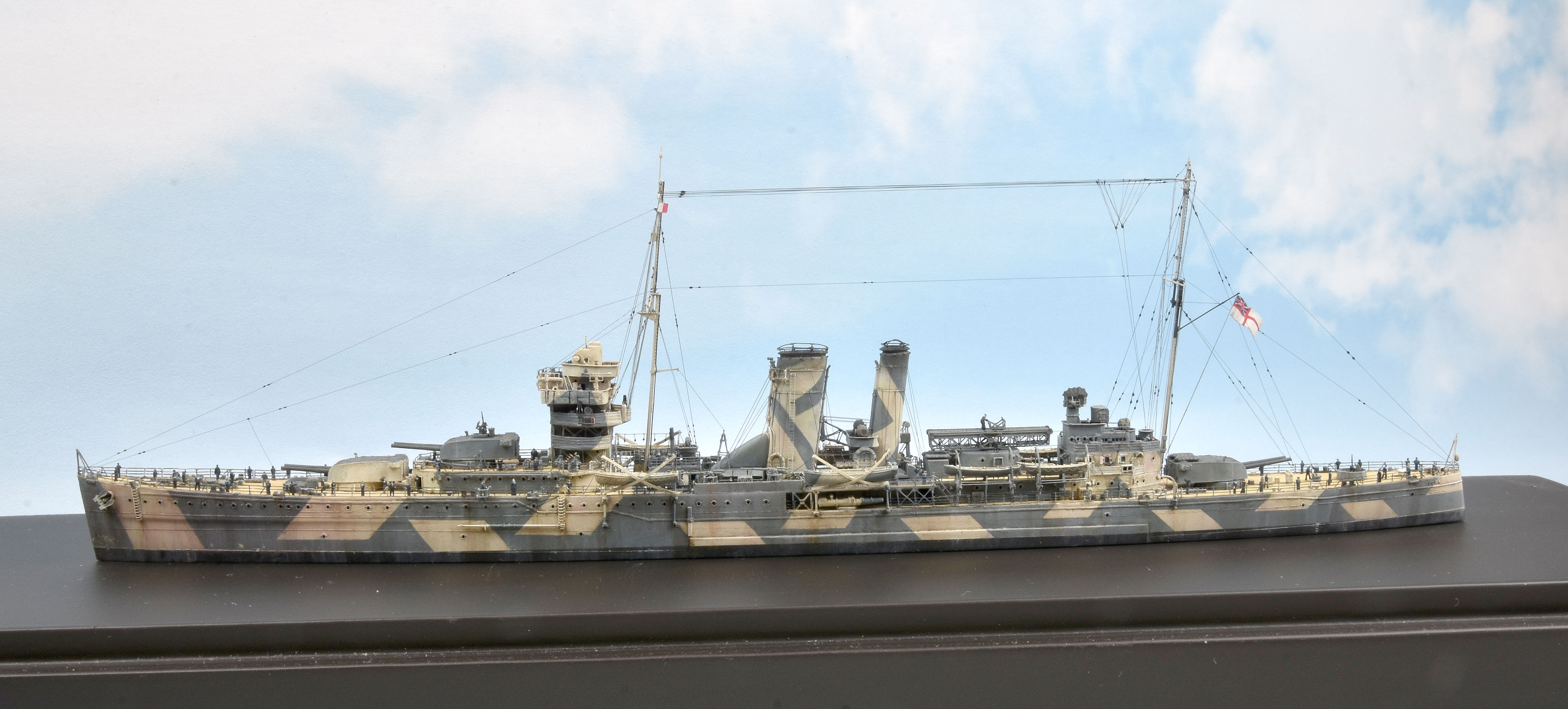

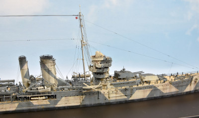

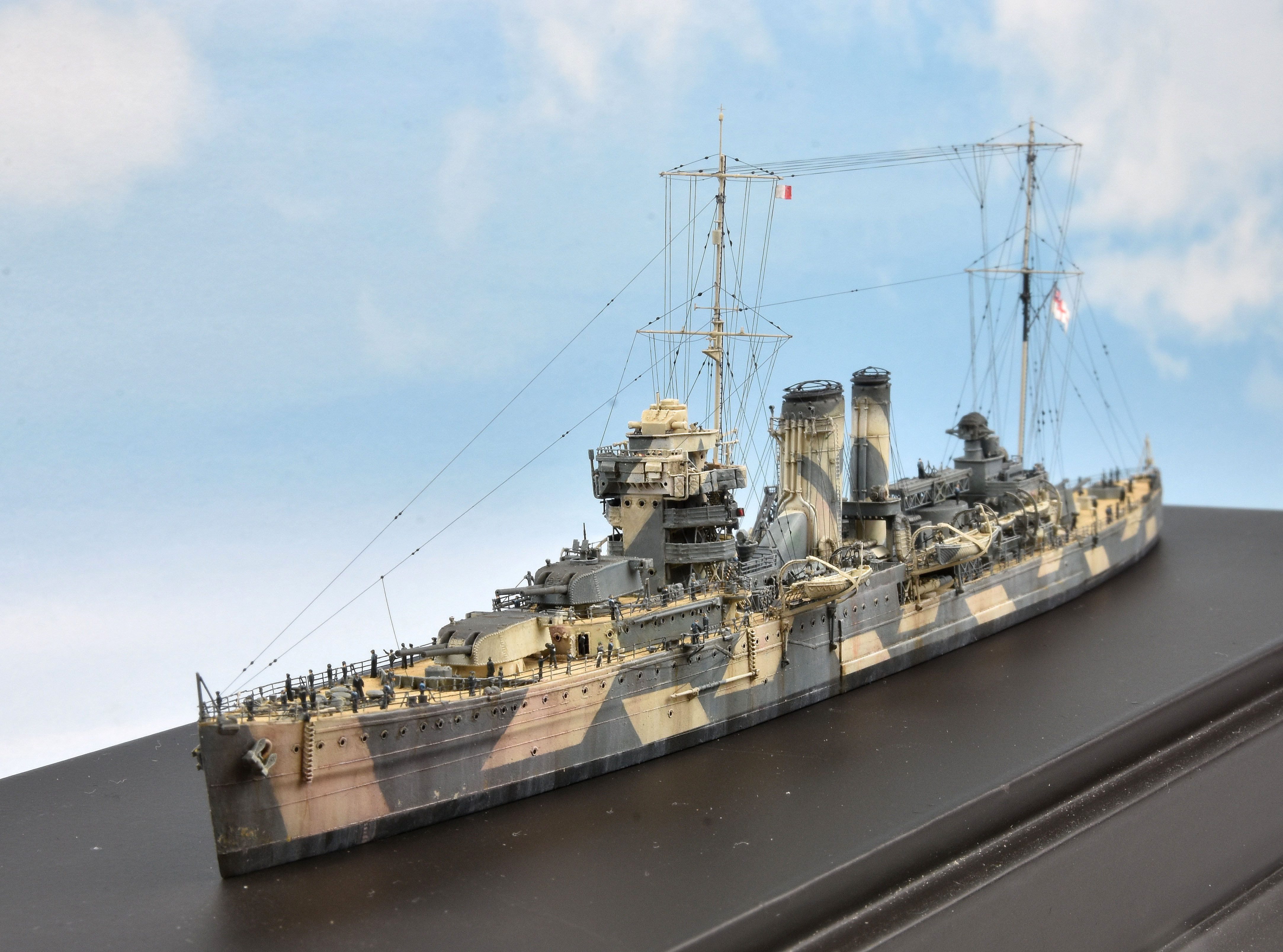

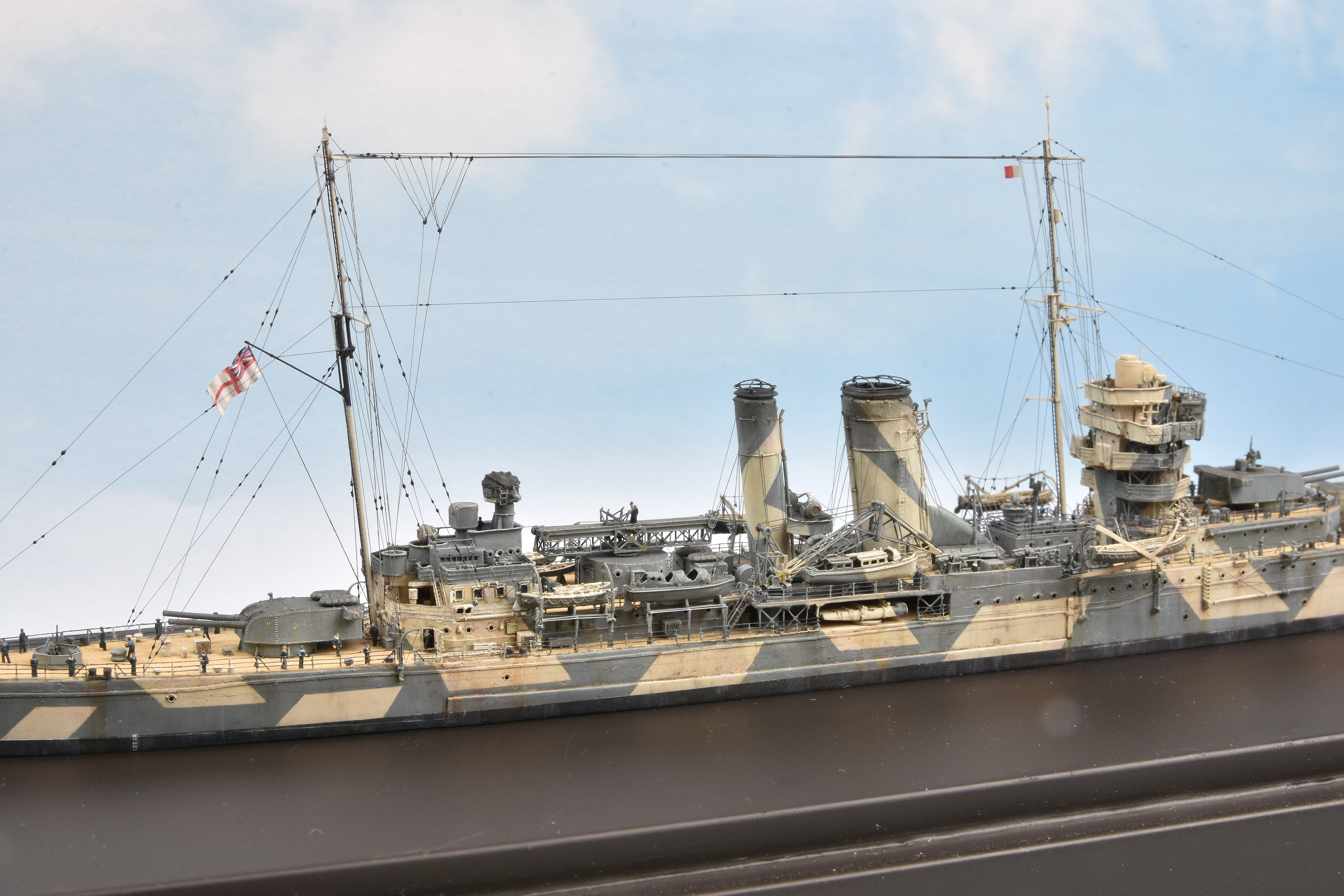

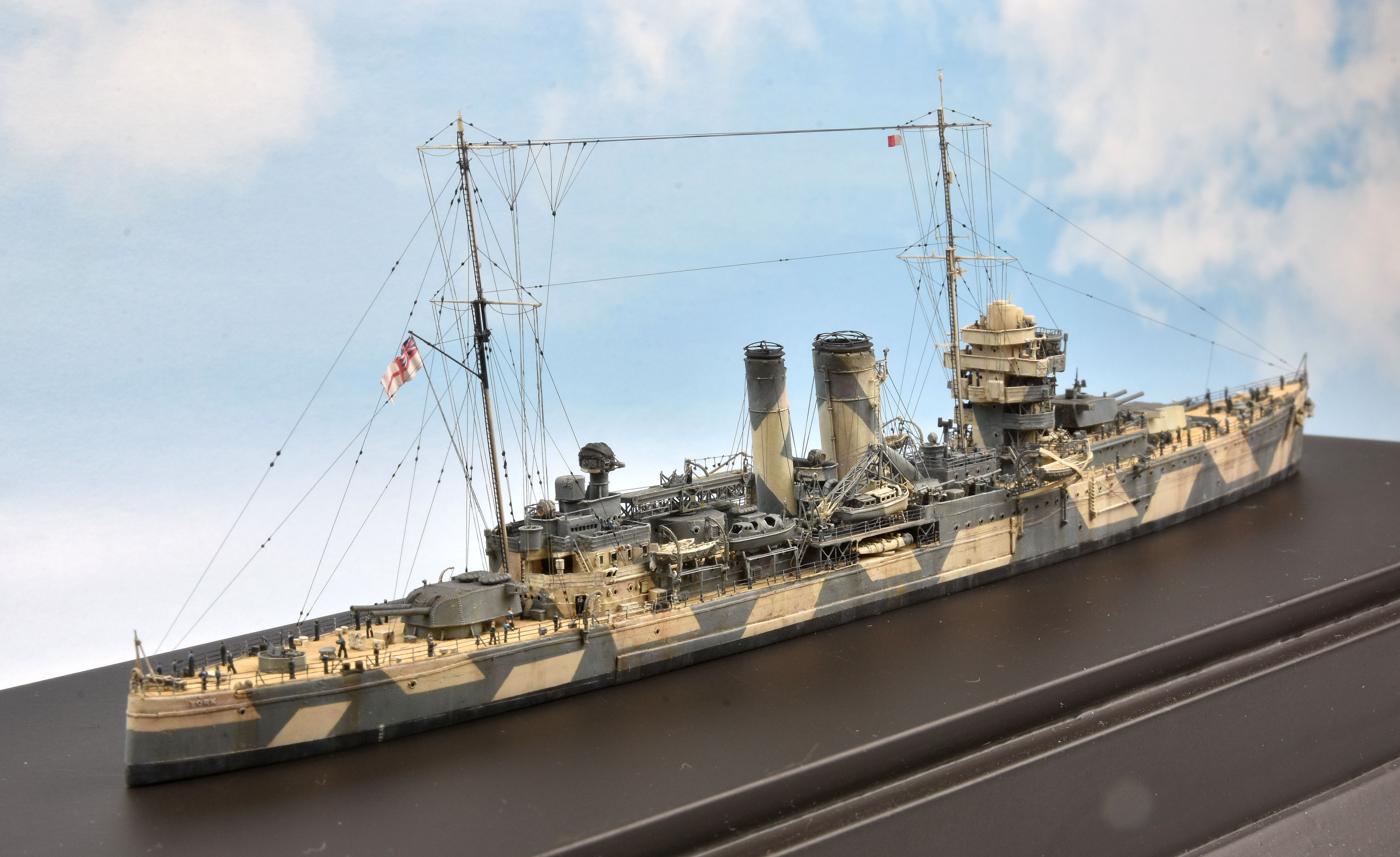

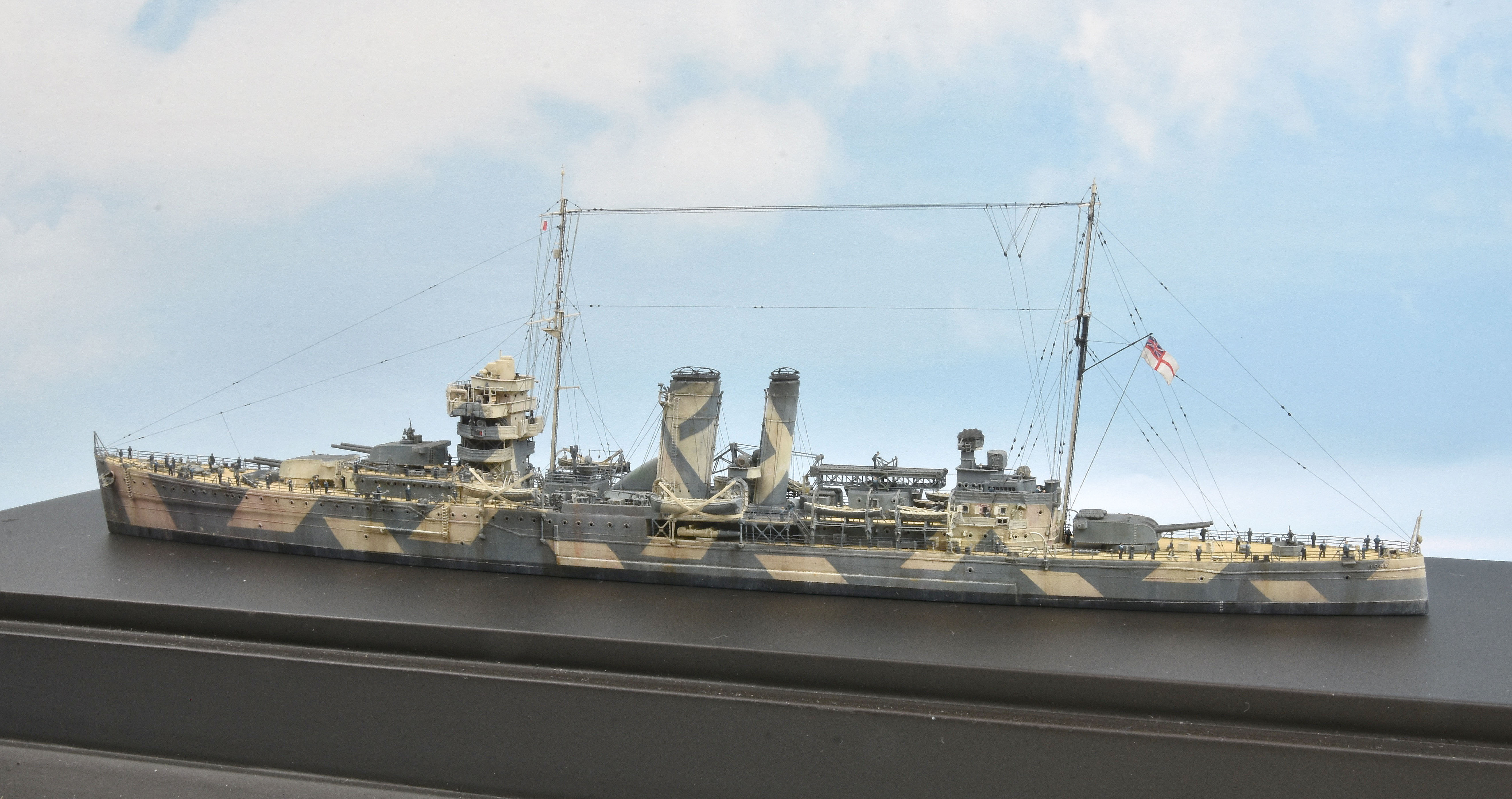

This is my take on Samek’s 1:700 HMS York, a kit bought about twenty years ago.
The ship is shown as she might have appeared in January 1941 prior to her loss.
A lot of additional detail was scratchbuilt and added from WEM, Micro Master, Albion Alloys, etc.
Rigging is a mixture of Caenis, Lycra and stretched sprue elements.
Painting was done mostly using enamels from the Colourcoats range and the model was weathered extensively to reflect a wartime appearance.
A little less than hundred 3D printed crew members from a number of manufacturers populate the decks.
The ship will be a part of a diorama depicting Souda Bay, along with HMS Ajax and a Flower-class corvette.
A detailed build log can be found here: viewtopic.php?t=389657

Brilliant work! She's beautiful. So much to like - the rigging, the weathering, the figures. You've really made the model come alive.

So well done! The rigging especially really brings the ship to life. I have the Trumpeter kit of York and if it turns out even half as good as yours I would be ecstatic!

Incredible work George! The camouflage came out excellent and the highlights look very good, the rigging is very fine and consistent. The crew figures are crazy! I have been following the progress of the build and its great to see it completed!

Absolutely beautiful! Stellar paint and rigging! I just won the Samek Texas on eBay and was pleasantly surprised at the quality of the kit given the age.
