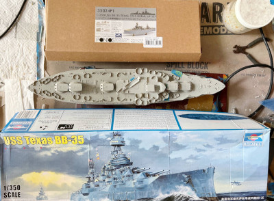

Hello:

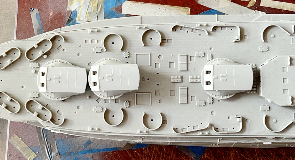

I'm starting to work on the Trumpeter 1/350 USS Texas. Having just built Trumpeter's Enterprise (CV-6) and dealing with those hull issues, now building Trumpeter's F-14 and dealing with those issues, I must be a glutton for punishment. It just wouldn't be a Trumpeter kit if there weren't a few things that really make you scratch your head.
So, to start things off, here's the 'stuff on the bench' photo. The kit took some damage in shipment, the box got pretty beat up and some of the sprinter shields on the decks are bent. I'll have the Pontos detail set, and one of the Eduard PE sets is on its way.
Mike
Mike

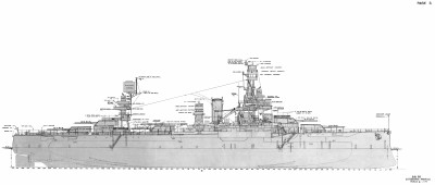

BB-35 USS Texas Booklet of General Plans (1944) https://archive.org/details/bb35bogp1944v2/mode/2up

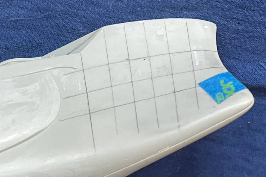

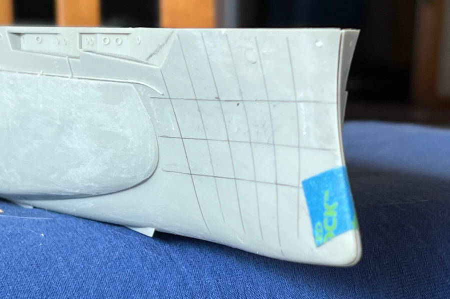

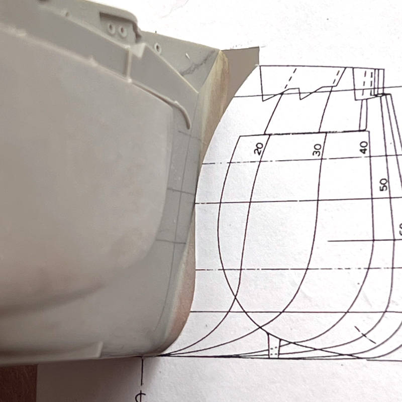

Work on smoothing out the hull is going well (more on that later). Another part of the hull that needs some *cough* help is the bow. Like several other Trumpeter kits, they seem to have taken inspiration from an oil tanker rather than a warship.
I drew a grid of lines on the bow to highlight the contours as they are molded.
There are a few issues here. The biggest is that the sides aren't concave enough. If one were to take a waterline cross section, that cross section would be convex rather than concave, especially right at the bow. From deck to keel, the sides are nearly straight. I printed out the hull plans to scale and cut them out to make templates. Here's how the kit compares to the templates:
In the view from above, we see that there are big gaps at the bow and at the front of the blister, illustrating how much the waterline is too convex. Looking forwards, we see that the kit' profile is too straight with not enough flare near the deck.
Mike
Mike

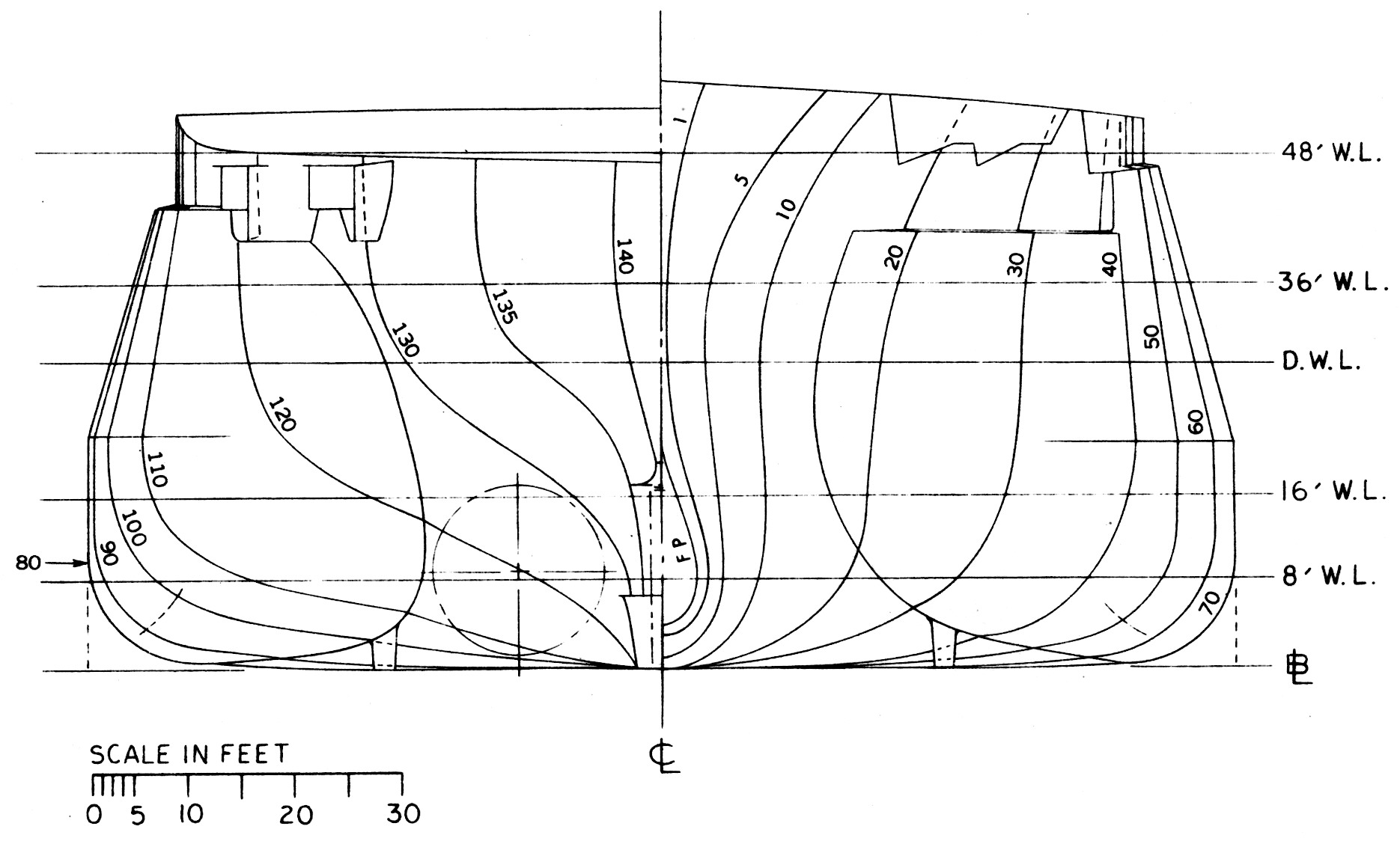

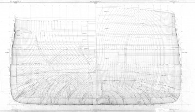

Mike, be careful of that profile morskie drawing as there has been errors found in there drawings. I have the body plan of that class pre-blistered if you need but at 11mb, is to big to post here so can email it if you want.
how thick is the hull plastic & how much does it have to going in to look somewhat correct?

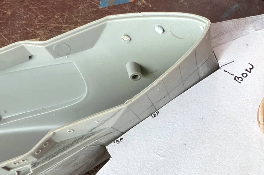

I compared the two sets of hull drawings I have. The bow part is fairly consistent, except that the drawing with the bulges has more flare towards the deck. Below the waterline, they pretty much overlap.
The hull plastic isn't thick enough to accommodate how much material I intend to remove. Anticipating this, I put a wad of milliput between 1/8" and 1/4" thick on the inside of the hull. I have gotten things close to the final shape, and I've ground well through the kit plastic but not (yet) through the milliput backing.
Mike

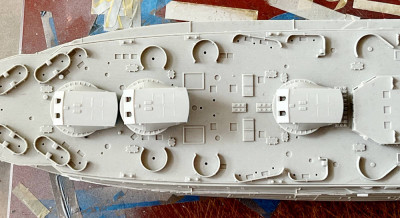

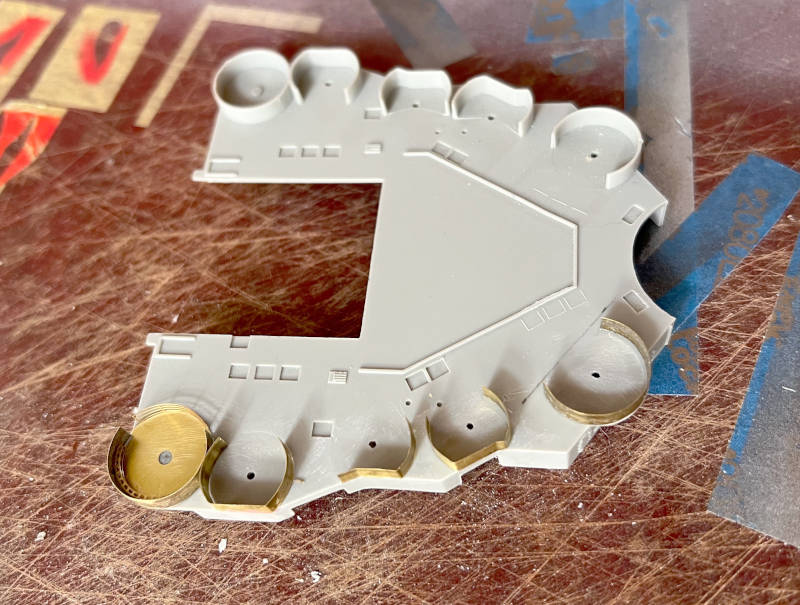

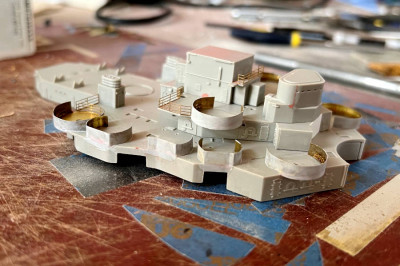

...meanwhile, in the superstructure...
I'll replace all of the gun tubs with brass sheet. The Eduard set for the deck is on order, but that leaves the superstructure up to me. Here's what it looks like with one side of the O1 level done. I was initially copying what was there, but then I noticed that the shield around the middle 3" gun didn't have the aft curved part. While the eagle eyed will no doubt spot a few mistakes, it went pretty well and I'm onto the port side.
Mike
Mike

Where do you source the brass? The shields/tubs look the part.

Mike, what I used to build up the bow area of the hulls of some of my OBB models was 1mm thick plastic before grinding, carving & sanding that area to shape.

I'm using 0.005" thick sheet brass. It's thick enough that it's reasonably stiff and durable, but thin enough to be cut with scissors.Killerbeans wrote: Thu Nov 06, 2025 5:59 pm Where do you source the brass? The shields/tubs look the part.
I've had it for years, so I don't recall where I got it. I think you should be able to find it at a craft or hardware store. They often have a display of K&S brand rods and sheets, made of brass, steel, aluminum, etc. You can also order online.
Mike

Brass sheet is often used as shim stock in manufacturing. If you have a contact at Grainger, McMaster-Carr, MSC, etc, you can get it a hell of a lot cheaper than the stuff sold as craft/hobby.

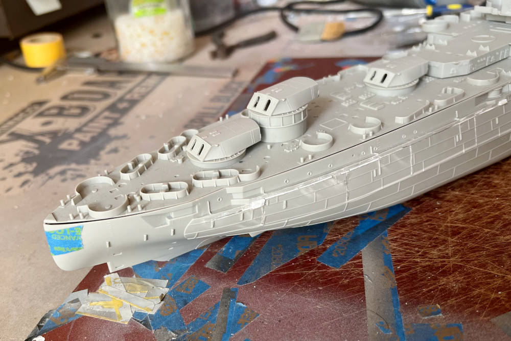

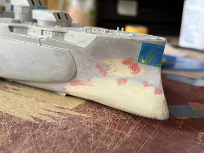

A long time ago I made the old Revell USS Arizona kit, and I built up the side of the hull in just that manner before smoothing things out with milliput. This time, I had made a blob of milliput to smooth out the sides of the hull of Texas, and I had a bunch left over so I just smooshed it into the bow. So far it's worked ok.FFG-7 wrote: Thu Nov 06, 2025 8:09 pm Mike, what I used to build up the bow area of the hulls of some of my OBB models was 1mm thick plastic before grinding, carving & sanding that area to shape.
Here's a picture of the starboard bow with the shaping close to finished. The yellow-ish oval area near the middle is where I ground through the kit plastic to the milliput on the inside. The yellow-ish area below is where I added milliput to the outside to get the shape of the lower hull closer to the template profile. The red spots are the Bondo putty I use for smaller filling jobs. At this point there is still a bit of smoothing to do, but overall the shape is pretty close to where I want it.
Mike

Any chance you have another Texas to illustrate the amount of change to the bow?

Unfortunately, I only have one. I'll do a before-and-after comparison once I finish the shaping and get a layer of primer on the hull.Killerbeans wrote: Sun Nov 09, 2025 6:12 pm Any chance you have another Texas to illustrate the amount of change to the bow?

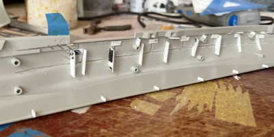

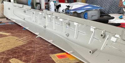

In other news, the shields around the superstructure AA guns are nearly done. They're all in place, I've puttied and sanded the joint, and gave it a first coat of primer to see what it looks like and to look for gaps that I missed. Of course there are a few spots needing a second helping of putty. Some of the railings are also starting to go up.
Mike
