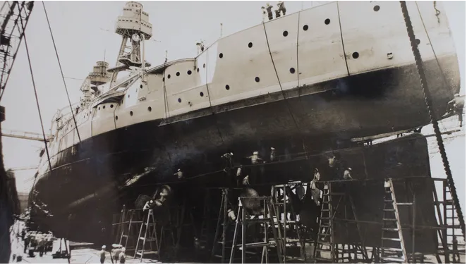

Here is a great look at the area in question.
But maybe I'm mistaken on that ridge. This photo shows one is there.
Notice however in both photos how smooth the hull is at the stern. There is a noticeable lack of hull plating detail. In fact, the hull plating detail terminates here in this photo.

that is the top of the armor belt.

Yeah, I see what you mean. Definitely slightly over scaled armor belt ridge.

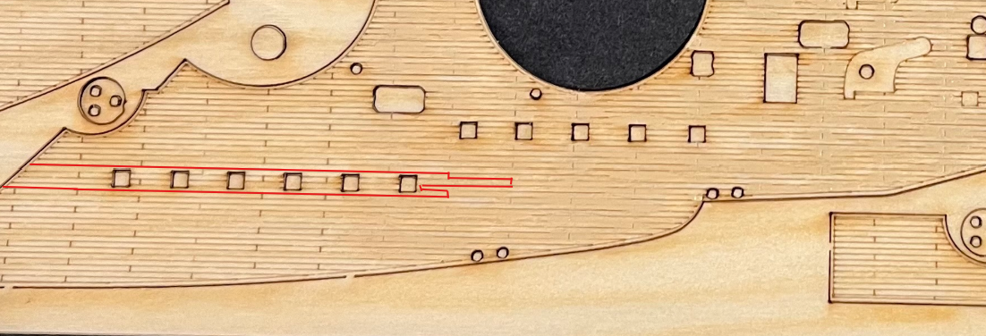

Hmm, and you can't just paint the plastic deck either because there are no planks moulded into it, as it assumes you'd use the wooden laminate! Very annoying, and one of the downsides of make a kit that's "perfectly matched" to account for non-plastic parts.
Short of making a scratchbuilt deck from v-groove plastic card or a generic wood deck sheet, seems like the only path would be to paint over the unwanted skylights, being careful to mask everything else. At least for the buttends, you can drybrush or something less opaque to just tone it down without masking off every single bit of deck around them.

Here is my initial attempt to soften the butt-end using teak paint. The deck light cutouts are just that. They are cut out of the deck so when you peel the backing off the decking, those squares are empty holes. The blanks of the squares are not planked, so if I leave them in place, they still stick out like a sore thumb if I try to soften them with paint. The top row of squares in this photo have been painted over. UGH!

Posts: 12454
Re: 1/350 USS Arizona DaLiGeJian Model
It may also make for a more convincing replacement if you cut out the entire "strip" of lights along the plank lines so you have one long rectangle to replace (perhaps even with the ends cut as steps to match existing buttends), rather than a series of individual squares that could be much harder to blend in with the rest of the deck.

I've decided to not use the deck sheets that come with the kit. Instead, I am going to create my own deck using Artwox Models wooden deck sheets.
Here I've cut out the basic shape of the upper deck. Bye Bye deck lights!
I hope this turns out ok. Have to be pretty precise with my cuts! Unfortunately, just one of these Artwox sheets is not enough to cut out all three decks.
