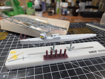

I started Ward a couple of years back. The kit has an issue with the stacks, as the kit has them oval shaped, while Ward and other four-pipers had round stacks. (There's evidence that later in the war when some of the ships were modified to troop transports and mine layers, they may have changed out the stacks to oval). Regardless, I hit that roadblock and put the model aside. Now I've figured out the fix, as I've drawn and printed my own replacements.
As she sits now the forward superstructure is mostly assembled, shown here sitting in place, not attached. Waterline plate and deck have been attached, railings attached to the bridge and aft deck house.
This will be a slow build. Those expecting frequent updates will be disappointed.

marijn van gils wrote: Wed Dec 24, 2025 4:52 am I don't think I have ever used a PE fret, for AFV's or ships, of which I have used more than half of the parts.
I like working with PE, but not to replace plastic with PE only for the sake of replacing it. ;)
Agreed. And whenever I can replace the PE with 3D printing, I'll do that as well. For Ward I added the stack caps to the print, so I don't have to worry with the PE, and I'll likely do the prop guards and depth charge racks the same way.
