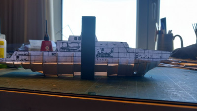

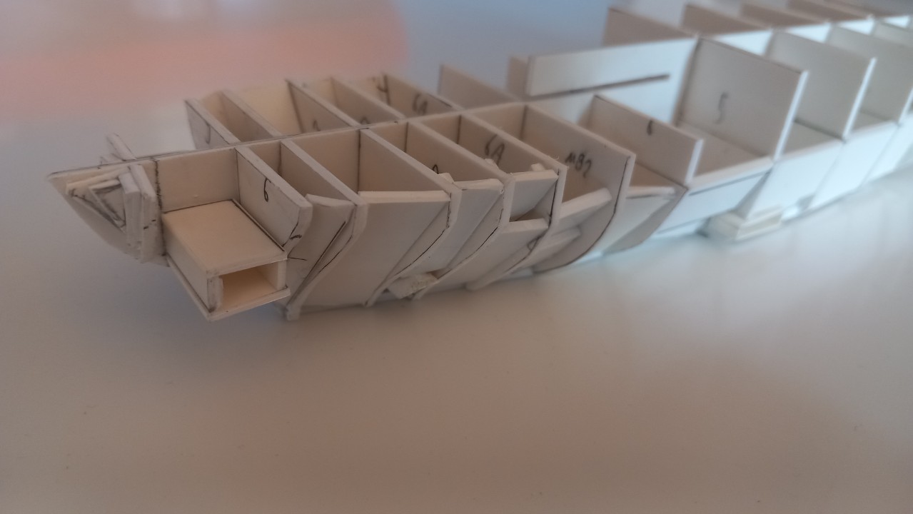

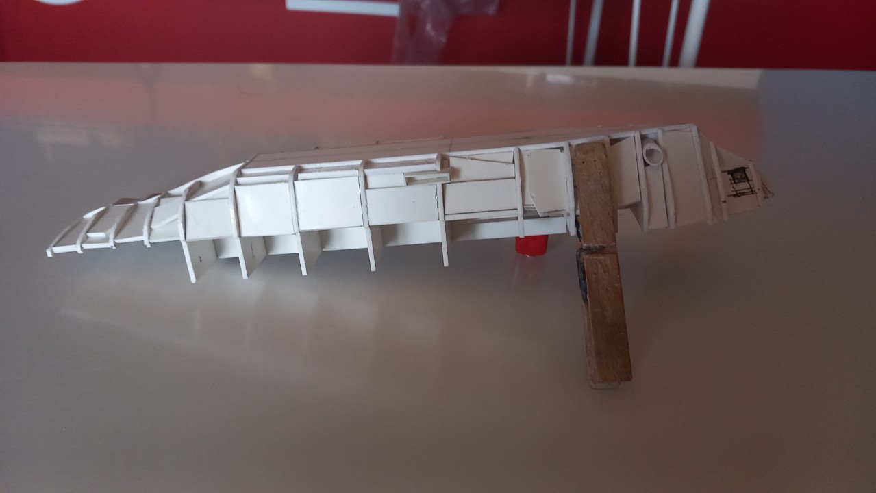

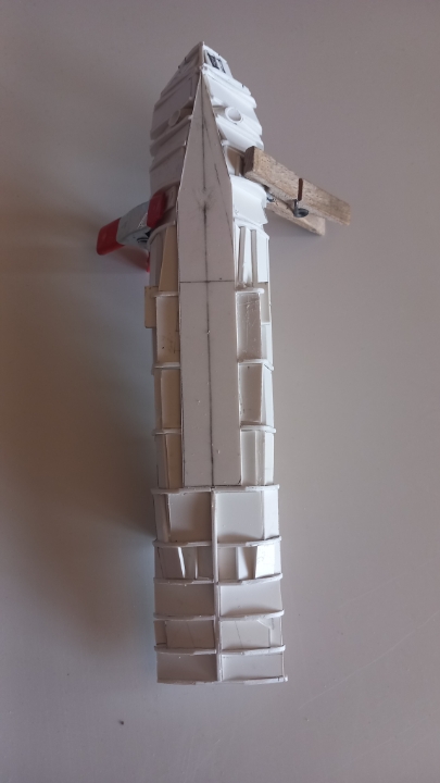

After creating the plans, I decided to create quick 1/400 model to evaluate my drawn frames. I did make my drawings in 1/100 and scaled them down.
First the test model had one frame that looked off, but I wasn't sure which 1 of 2 frames was the odd one.
That's where phase one stopped. I needed to look for a way forward without spending too much time on it.

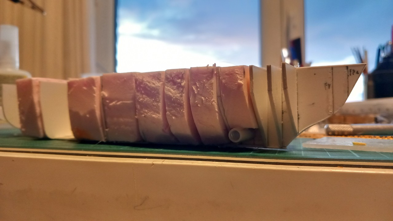

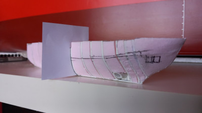

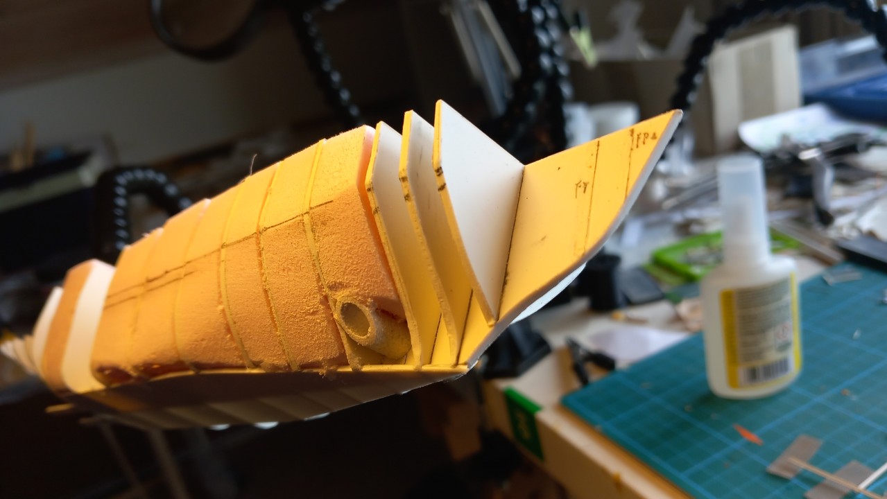

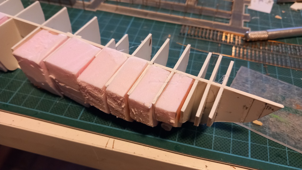

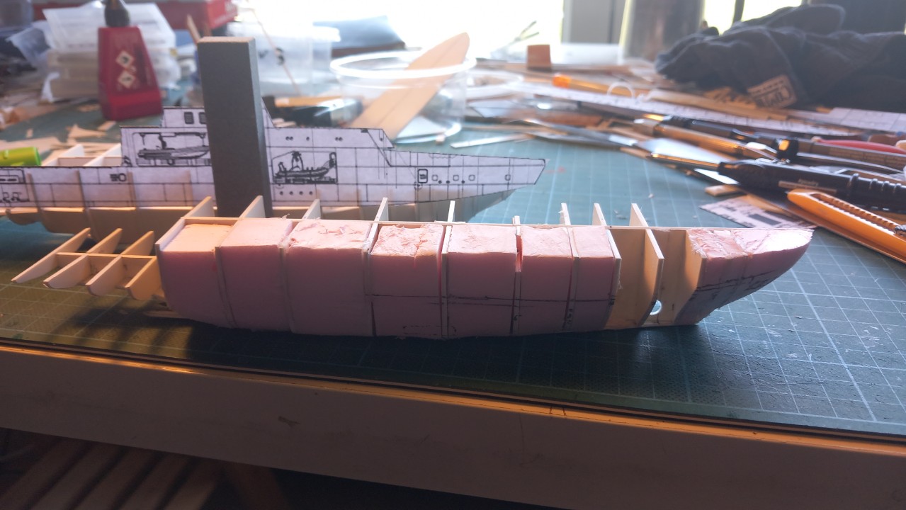

Salvation came when I found some waste insulation board. I decided to cut it up and hot glue it between the frames to get a better view of the frame shapes.

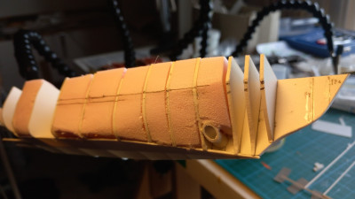

Next step was finding that odd frame, adjust its shape and trace that new outline. I only glued the blocks on the inside, so I could easily put a piece of paper between the frames and blocks.

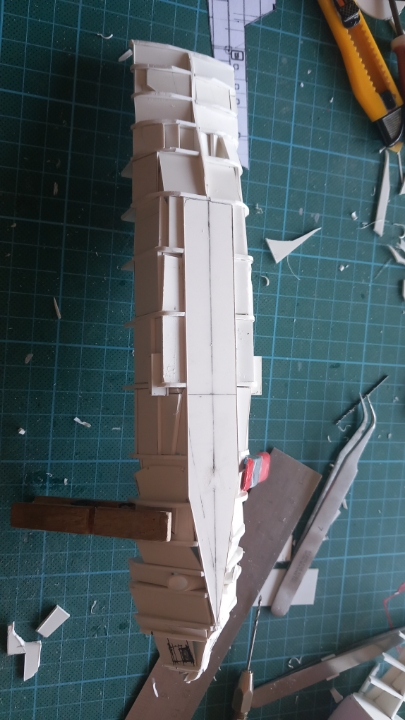

I still wasn't very satisfied with this and wanted to build a complete 1/400 version. This hull wasn't foreseen for that and adjusting it would have been really difficult as those blocks were really well glued and I'd need to adjust all frames to accept the parallel sides.
I therefore decided to build a new hull.
