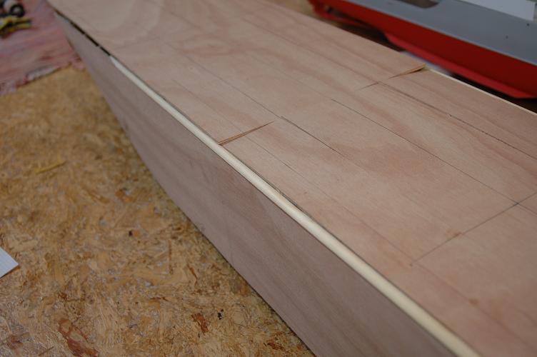

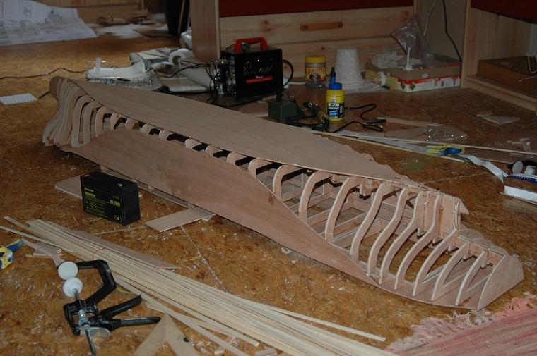

Ok, so I have advanced quite a bit since last post.
The deck has been cut in three parts, the forward area has been glued to the framing and came out quite nice. The centre piece, which is removable, is also partially finished.
The aft part has been cut and the big entry hole below the superstructure has been cut too. I made a mistake there too, but more on that later.
I started planking today, the curves are playing me parts at the moment. The wood is very bendable, but not that bendable! I'm still a little in doubt about this too. Currently I'm planking in a longitudinal way, parallel to the keel, cutting each plank to fit the bottom plate curves. This is also one of the reasons why the curves are so tough. If I'd planking it in an angled way, the curves would be much less troublesome for the wood, but it would be harder to find a good place to start and to fill up the gap between the bottom and side plates and the planks.
I started with the bow, that part is the least troublesome and curved, I hope to learn enough about the planking to afterwards be able to solve the stern as there it is really challenging!

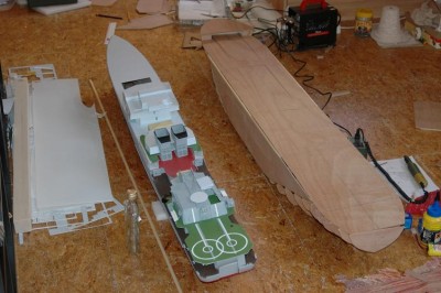

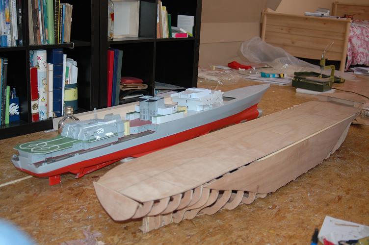

Here are some pictures of her and the Admiral Tributs which I also dedusted and intend to continue :heh: Unfortunately I don't like Electronics so much, so I keep pushing that job ahead of me, pretty much the reason why she's sitting there for half a week without any job done on her.
Cedar quarter of a circle bar as it will be fitted on both sides.
With the Tributs, Chaconia is about 1 inch/2.5cm longer than Tributs
You can see where the displacement difference comes from, Tributs about 9,000t, Chaconia about 32,000t full load!

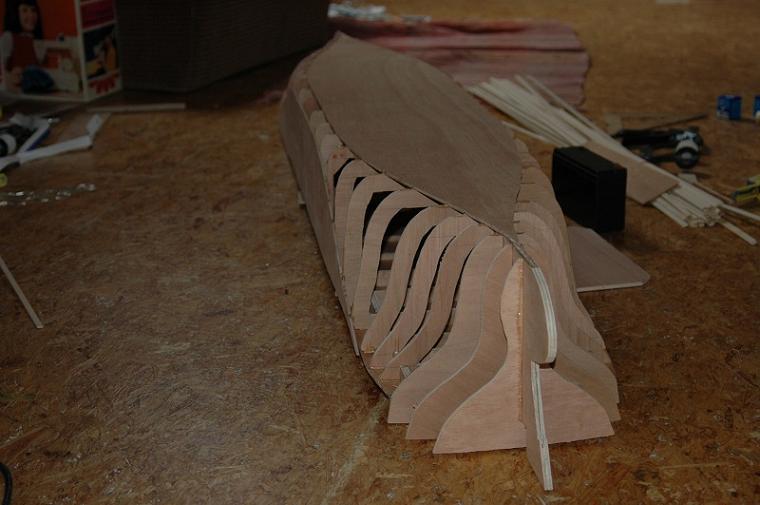

So she was turned around before planking. The only problem now is that the planking is going wider and wider, yet near the bow it's going higher and higher. While on the sides I'm still planking the bottom, near the bow I'm getting more than 1 inch from the keel. I guess I'll have to make some sort of inserted part, I saw this on some builds here too.
If there are any rules regarding this, please tell me. If not, I guess it's all up to people's "feel" with planking to solve this "problem".
Here's the canoe turned around, showing her tanker shape in all glory.
Still thinking about that stern section planking though, I suppose it'll be a chain of "inserts" all together.

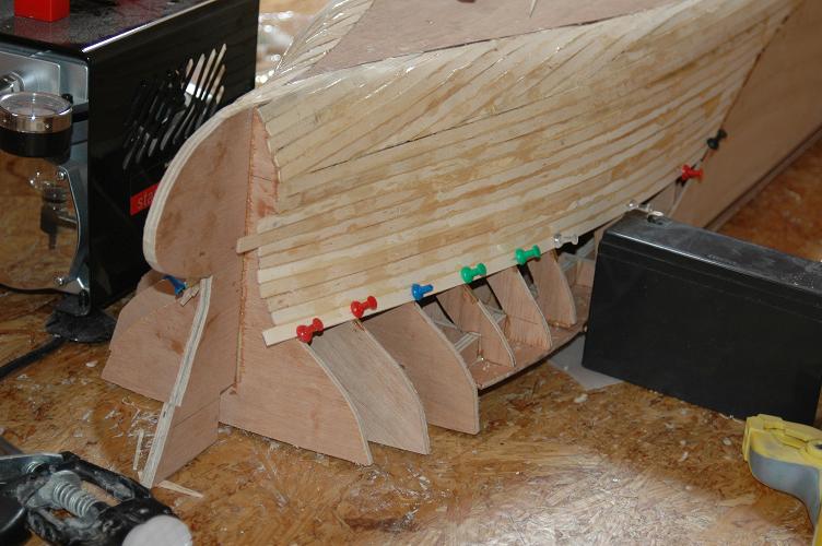

Here is the planking. Dave was of course correct, if you make the planks wet, shape them and let them dry in that position, they stay more or less like that.
the lowest plank has a different colour because it's wet. I let it dry for about 15 minutes because the glue isn't working on humid wood.
This is the result when it's dry, before gluing.
As you can see, near the bow it's going up from the keel, near the bottom plate I'm still planking the bottom...
Overall view of the planking, doesn't look that good, but I guess it's normal for the learning process!

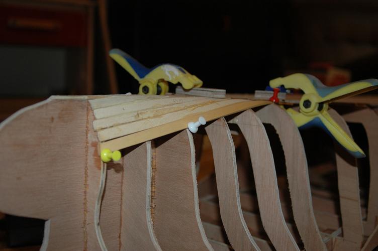

For the stern I decided to take a different approach, I'm putting the horizontal plank first, as the curves were becoming too strong due to the very narrow prop shaft trunk. Then I'll be fitting in the lower planks, more measuring and fitting, but hopefully a better result than forward.
I guess it'll be fibreglassing after all. Going slightly over scale, but I guess that won't be too noticeable at such a beam. I'm not too sure about the fibreglassing and where to find the fine matting as I've never done that before (only experience in that field is part of the pond, but with very rough and heavy matting). I hope I can follow the curves well without too many protrusions of fibreglass etc.
The deck forward has a bent camber rather than an angled and straight one like on the main deck. I doubt I can bend the triplex, so I'm still trying to figure out a way to make this.

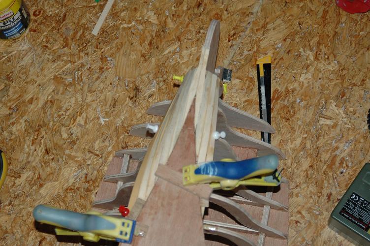

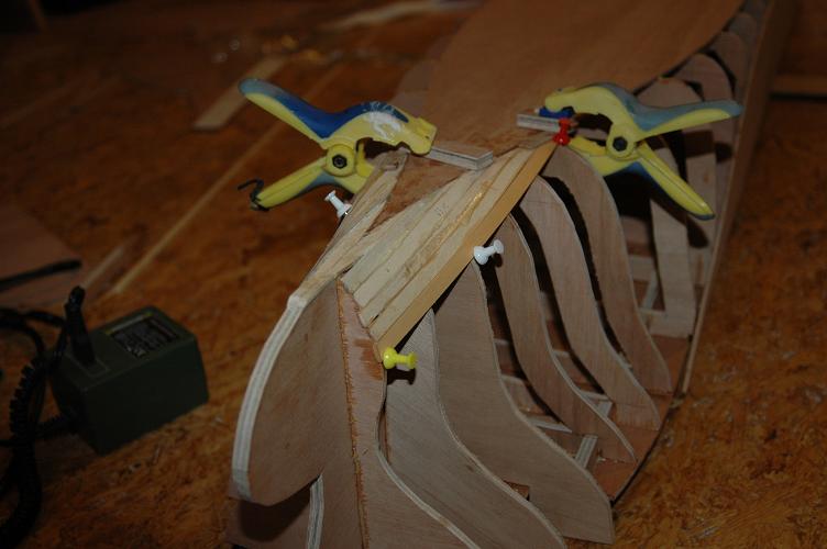

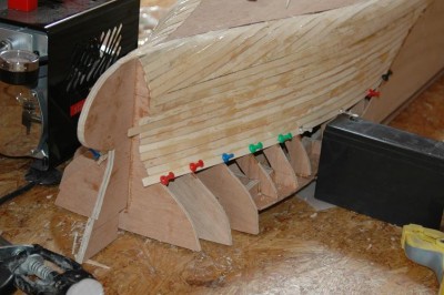

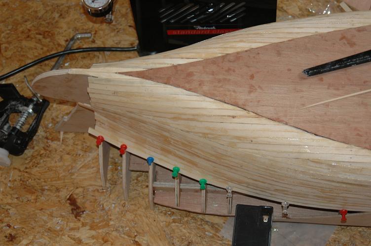

So a small update. Still planking, with a lot of difficulties along the way.
Lessons learned, try to plan the planking better in advance, I had to play around with some plugs to match the forward planking and the aft planking together. Of course, without using the big plates on the side and bottom that problems becomes smaller. I'll need a lot of sanding and filling to make it smooth though.
Furthermore, I've started the most difficult and pronounced curves as you can see in the picture. The basic idea comes from info I gathered from Dave's Rurik hull as shown in his book. I saw he was using this triangular shaped planking, not extending them fully to the ends of the ship, but shaping them against each other not to overstretch the planking in the difficult curves.
That's about it now. I could actually glue two planks, one up and one down of the planks laid, but for now I'll fill up the gap formed by the bottom part of the ship and the curved part. As you can see I'm using a sort of splice shaped planks to fill up the gap between the upper and lower planks. To keep the sharp points of these splices in line with the hull, I have to use clamps and if I continue the planking upwards, I won't have place enough for the clamps...
The merchant shipyard

Timothy, I'm also very curious, I've started on the lower part of the bulb now, but I'm a little lost on how to get the correct shape sanded on the balsa.
Ok then, I'll keep you updated on everything. So here are yet another batch of pictures of the planking process.
As you may have noticed, these ships, like most later Boelwerf ships have this sort of twisting plane on both sides aft, with a distinct edge towards the curved lower aft part of the ship. So I decided to make a flat cut there and glue the planks parallel to the floor in this area.

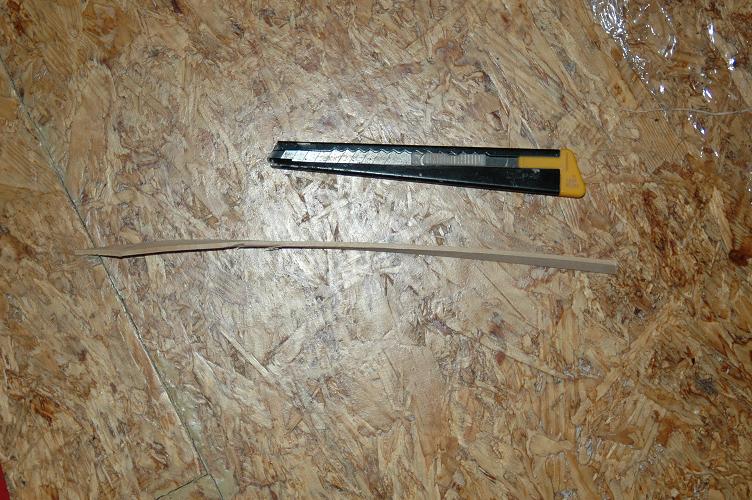

I use Limewood. It's very flexible when made wet. I'm using 2mm thickness, because I tested a 3mm (without making it wet) and thought it would never be able to follow these curves. Now, after my experience with this 2mm and water, I do think 3mm could have done the job too though. For a Bismarck, which is less extensively curved, certainly 3mm would be advisable. Depending also if you want to fibreglass over it or not.
One major drawback I noticed recently is the fact that the aft part, the part with the aft frames starting from around the propellor shaft which was added later, is about 5mm lower than the rest of the ship, that means my deck would curve down, which in reality it does NOT! So I'm off searching for a solution on that matter. I'm thinking of extending my deck over the transom rather than fitting it inside of it. That would make up for at least 3mm of it. I could then use my current deck as a support as the frames are lower than the others.
As you can see, I'm using some kegs to keep the planks with their full beam against the frame to follow the shape as close as possible. The pins are breaking at a very high pace now, very low quality I guess. I have three more planks to go on each side.
