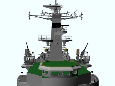

After a long absence I picked up mouse again and resumed my dormant project to build a virtual Leander Frigate, the hull continues to drive me mental but I decided to try some smaller details and was surprised how easy it all became. This is a screen shot of a Mk7 40mm Bofors.

Looks like a good start!
- rtwpsom2
- Posts: 1438
- Joined: Tue Aug 19, 2008 10:15 pm
- Location: State of Denial
Re: Cadding about
The hull is always the hardest part. It usually takes me a solid week of work just to get the hull form done, that isn't counting details like scuttles or props. What CAD software are you using? I might be able to give you some pointers.

I am using 3DS Max, the hull just evades me, there is some knack I am sure.
As to the level, I am simplifying but I have gone down to Upper Decks Comms unit so far

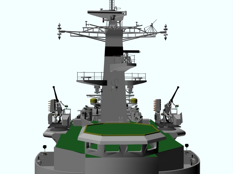

Re: Cadding about
Standing back you can see the imperfections in the hull, it looks okay until rendered then the creases start to show.

Phil describes the approximate method I use as well. I only have a few things to add. First of all, extend your surfaces well past where you need them and trim them all down after the major surfaces are in place. We differ in one aspect. I try to do my major surfaces as a single surface. This is a software thing, however. SolidWorks deals better with single surfaces when doing later operations. On Scharnhorst I had a split in the hull surfaces near the outboard prop shaft fairings and the gusset between the fairing and the hull failed because it had to cross two surfaces. So now I have to spend the extra time to make sure the hull form is a single surface as you can see from Z-39 here:
Like I said, here I have made the surface extend well past the normal borders, it make sit much easier to trim with other surfaces rather than trying to deal with knitting a seam.
Phil talked about the lines of the hull. When you are using the hull lines from a drawing, those contour lines that run vertically top to bottom are called water planes. Here you can see Z-39's water planes.
The lines that run horizonatally front to back are waterlines. These control the smoothness of the hull and define the loft between waterplanes. Here are Z-39's water lines.
If you have ones that run vertically front to back, they are called sheer lines or buttock lines.
Earlier Phil was talking about smoothing the surface. It is pretty complicated to do but usually involves making the waterlines relax. They are defined by the waterplanes and relaxing them allows them to smooth out. Graphical programs make this easy, but in CAD it is a lot more difficult. After you relax the water lines you need to re-attach the waterplanes. I generally have to do this process 2-3 times in order to get a perfectly smooth surface. Like Phil said, if you can get your hands on the table of offsets, it is a lot easier. The only playing around you have to do is with the waterlines to get them to make the program interpret the waterplanes properly. I used the TOO on the last project I did and got the smoothest hull I ever worked with just from using them. Like I said, the only playing around I had to do was with the waterlines because the stern was several feet off the baseline and I wanted to do a single surface.
Notice how I have more waterlines lower down. More waterlines equals tighter control on complex areas. I notice on your upper hull there is a transition area that is creasing. This would be a good spot to add more waterlines to define it better for the computer.
