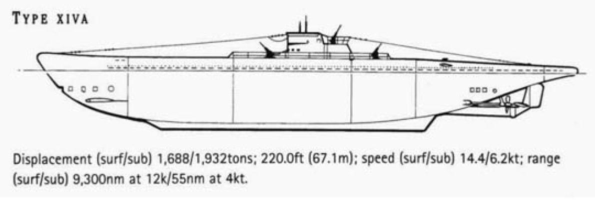

Hi everyone!
now that we have been getting many nice kits in 1:350 scale of various Typ VII and Typ IX subs, I'm getting more appetite for the more obscure types: the Type XIV 'Milk Cow' and Typ X mine layers. I consider building these from scratch, maybe using parts of other kits if possible.

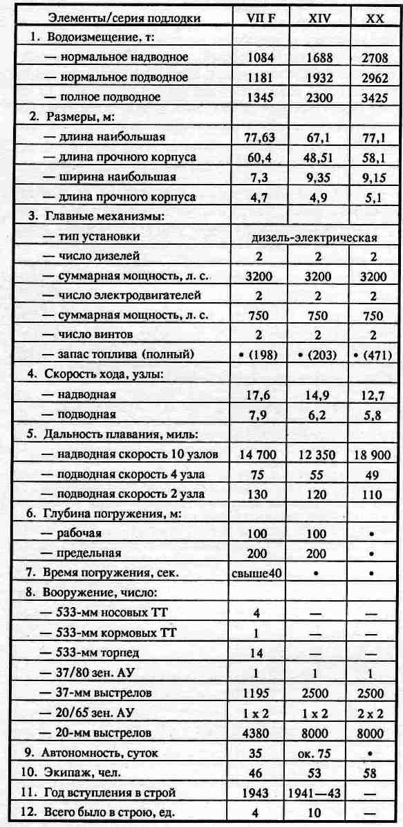

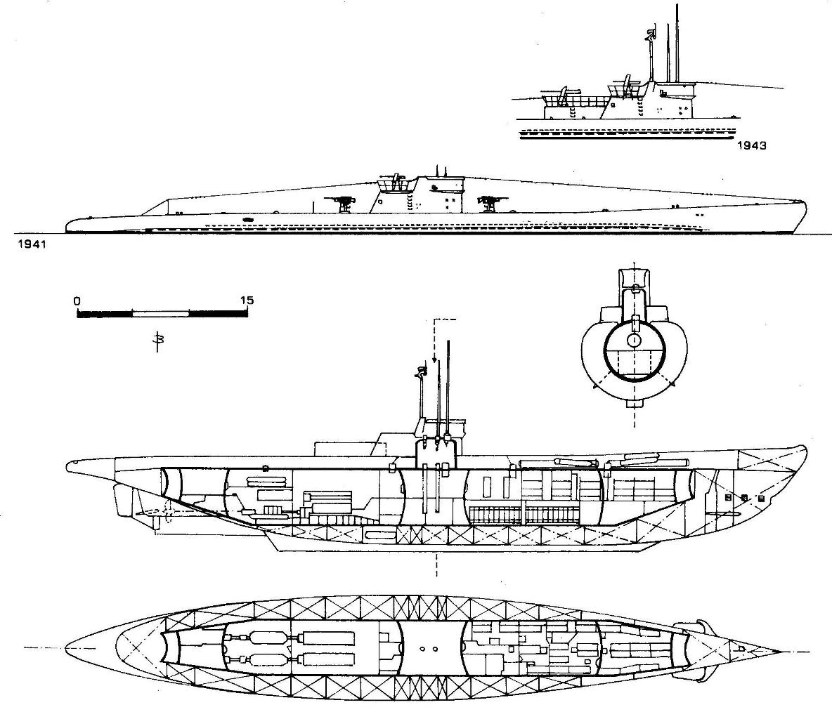

Starting with the Typ XIV first, has anybody some good tech reference info, drawings and other? I already found general drawings on
http://www.heiszwolf.com/subs/plans/plans.html
Studying these drawings closely, and enlarging them using the yardstick, makes me wonder whether the length given as 67.1 m (220 ft) is really correct, although all sources repeat that. By study of the drawings and deducting the frame spaces it seems tjhat 65.1 m should be more correct. Can anyone shed light on this?

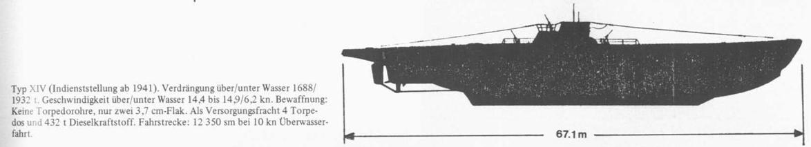

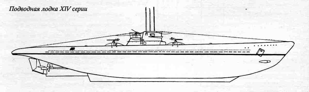

Re: Calling all DKM Typ XIV 'Milchkuh' fans!

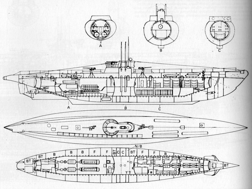

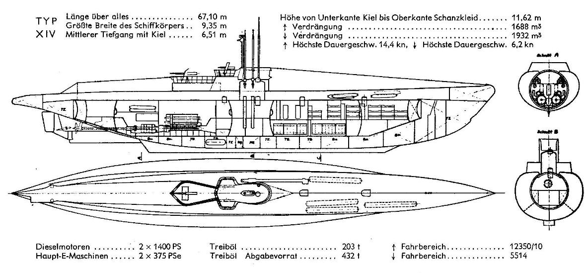

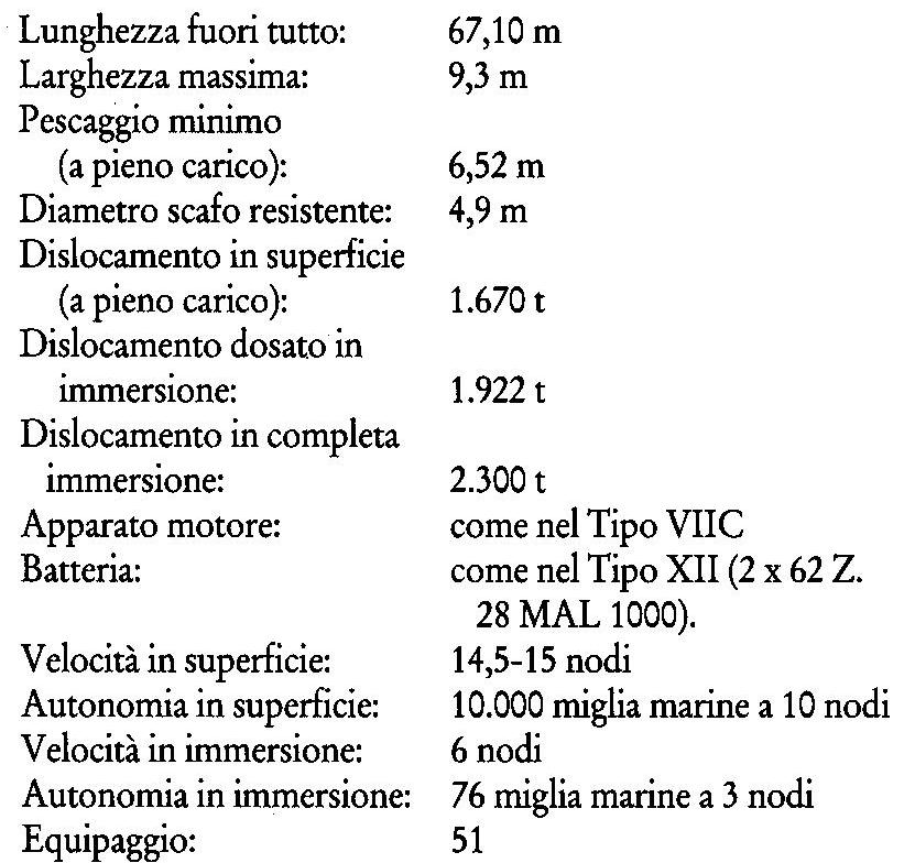

same images and data from various books, groener die deutchen kriegschiffe, roessiter u-boote, d. miller u-boats, bagnasco sommergibili della seconda guerra mondiale
ciao peppe
ciao peppe

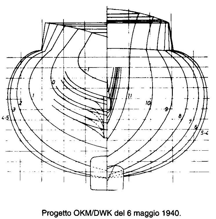

Hi Peppe,
Thanks! Every piece of info helps, in this case in particular the ship's frames diagram 'Progetto'. Super!
It seems that the info about the lenght has come a long way, Groener generally was pretty accurate. However, I had spotted one or two errors in that authoritative work (on other ships that is), so I remain suspicious about that given length.
Hope if anyone else might add some insight. Olaf, maybe?

one more information from jurgen rower u-boote
one from breyer and some from russian sources

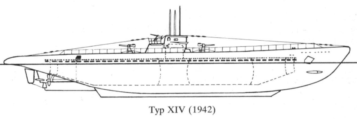

In the meantime I've studied the XB type and others more closely, and I'm coming to the conclusion that the 67.1 m length figure doesn't seem to bad after all. Thanks again for all your references, they really did help!
It seems that the common submarine design practice in the German navy was to have a pressure hull with frames at 800 mm spacing (with some local exceptions) and the outer casing with frames at 500 mm (again with some exceptions). Thins means that at every fifth frame of the pressure hull aligns with every eighth frame of the casing.
Our drawings show only the pressure hull frames, but as there are some bulkheads of the casing shown too, this can be checked very well. The bulkhead between the E-motor room and the engine room seems to such a frame that aligns totally. When we work forward and rearward from there, it works out pretty well with the figures above.
Having scaled the drawing that it aligns with these assumed frame spaces then the 67.1 m figure must be very close, so I think I go for that.

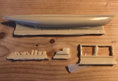

Finally some news on this: I have sent the masters to be cast in resin, wait on this for further announcements.

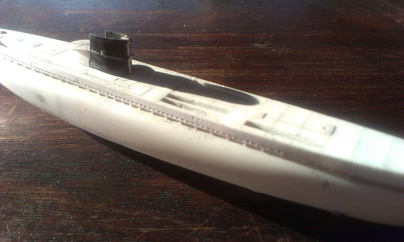

And now I can even show the first casting! To me it looks pretty good...
When I can tell more about availabilty and price I'll let you know.
