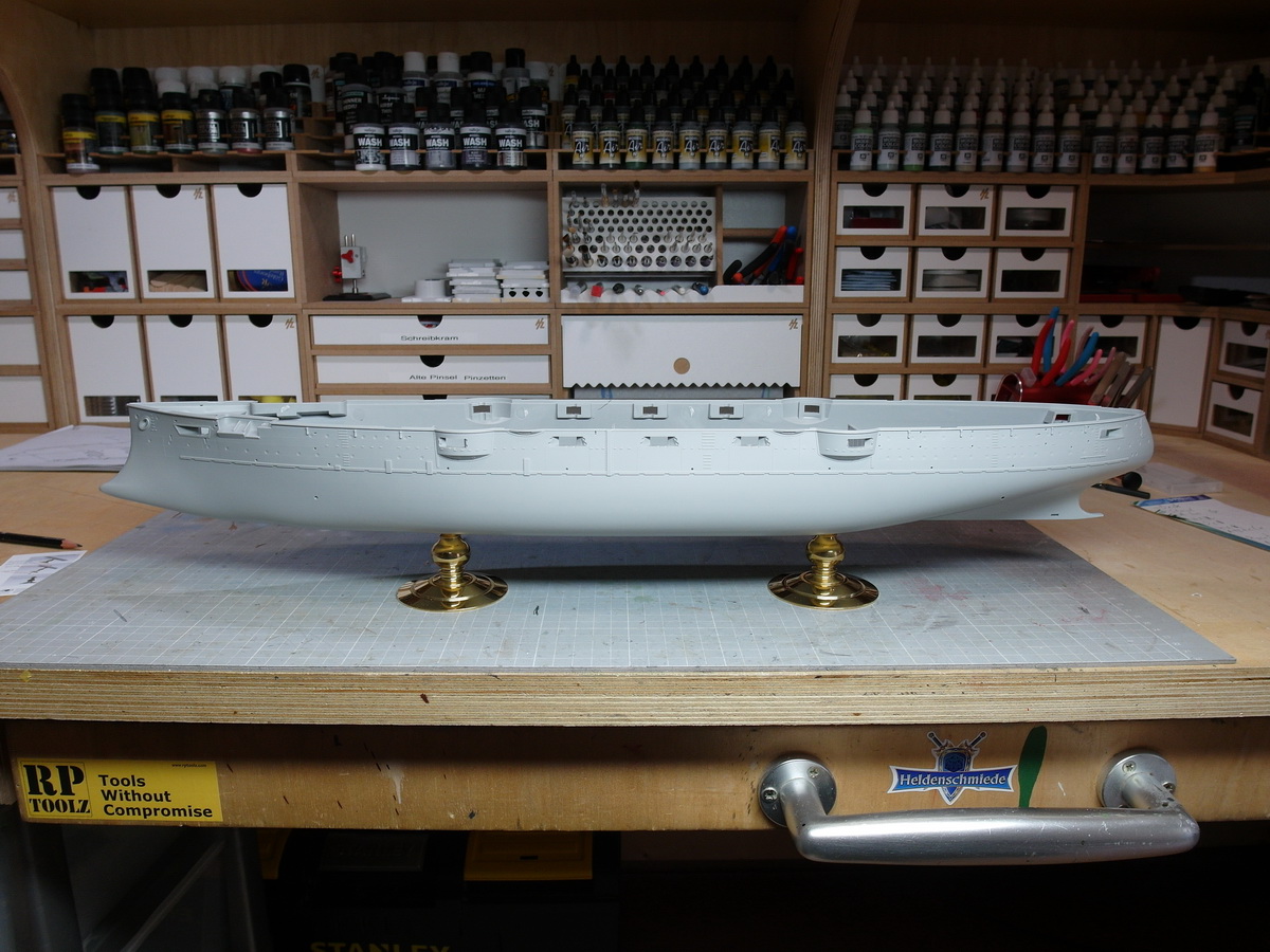

This time I treated myself to the elegant stands from Pontos. Look really great.

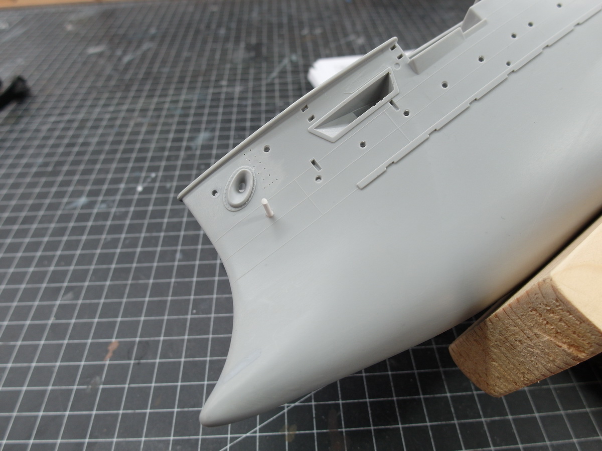

Next, the holes for the crampons. Nice straight through the drilling templates from Pontos and the usual drilling out of the portholes. After researching the few images available, I noticed that the porthole that sits on the model below the anchor hawse did not exist.
This was then closed with a round styrene profile.

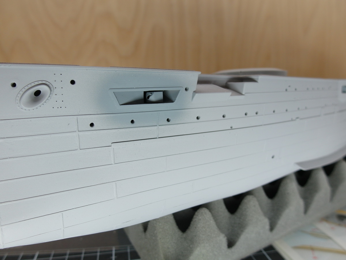

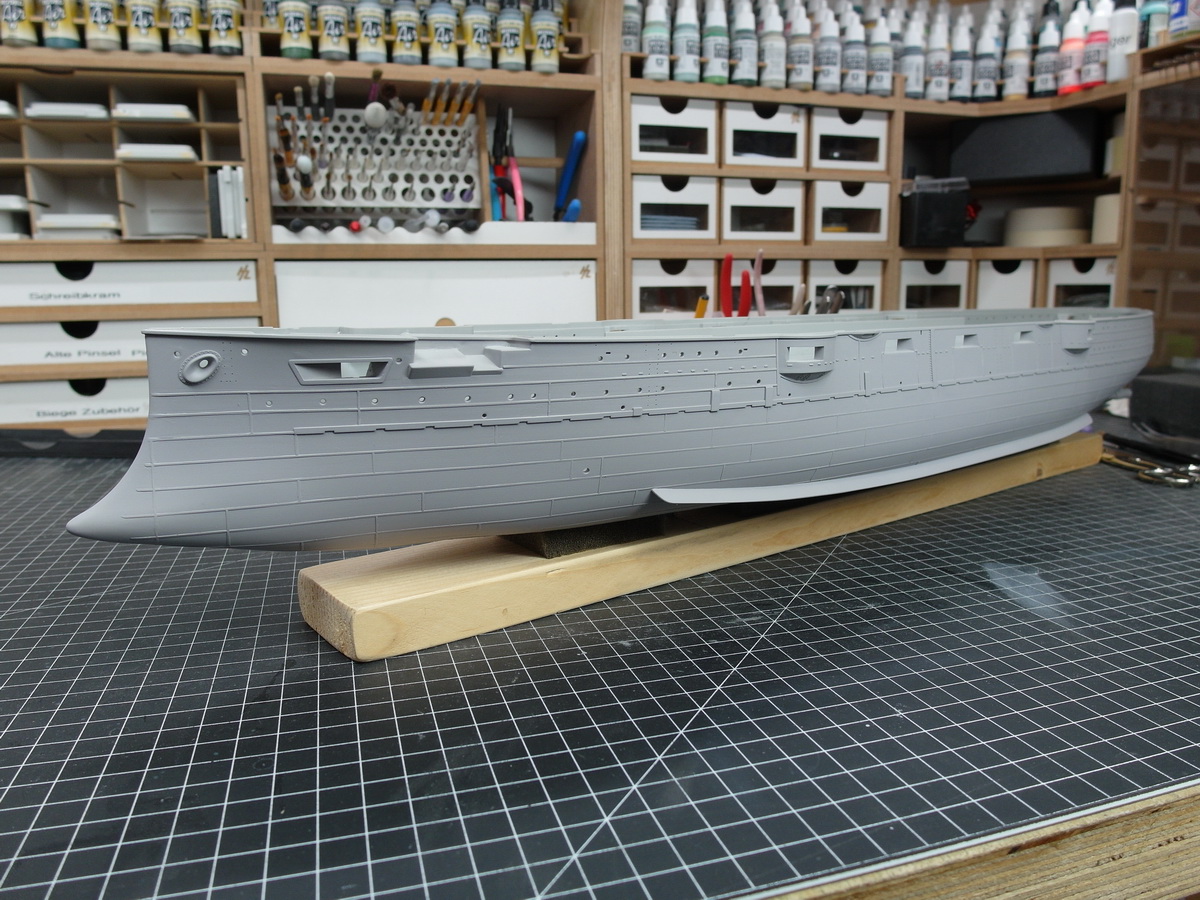

I use styrene profiles to imitate the seams of the armor plates. Back then, people still riveted, not welded. However, the rivets can hardly be seen under the paint on the original. So that's enough for me.

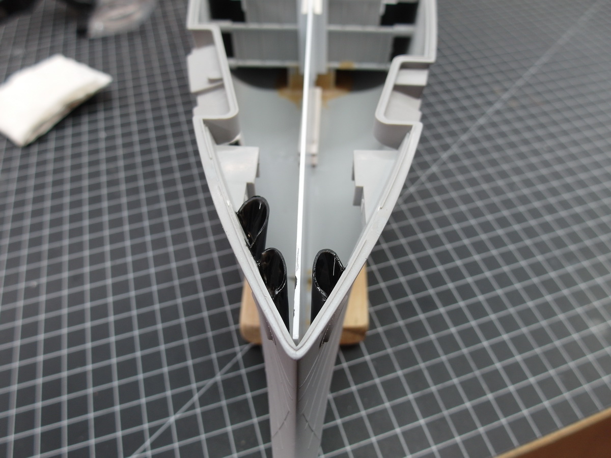

The tubes for the anchor hawse were still missing.

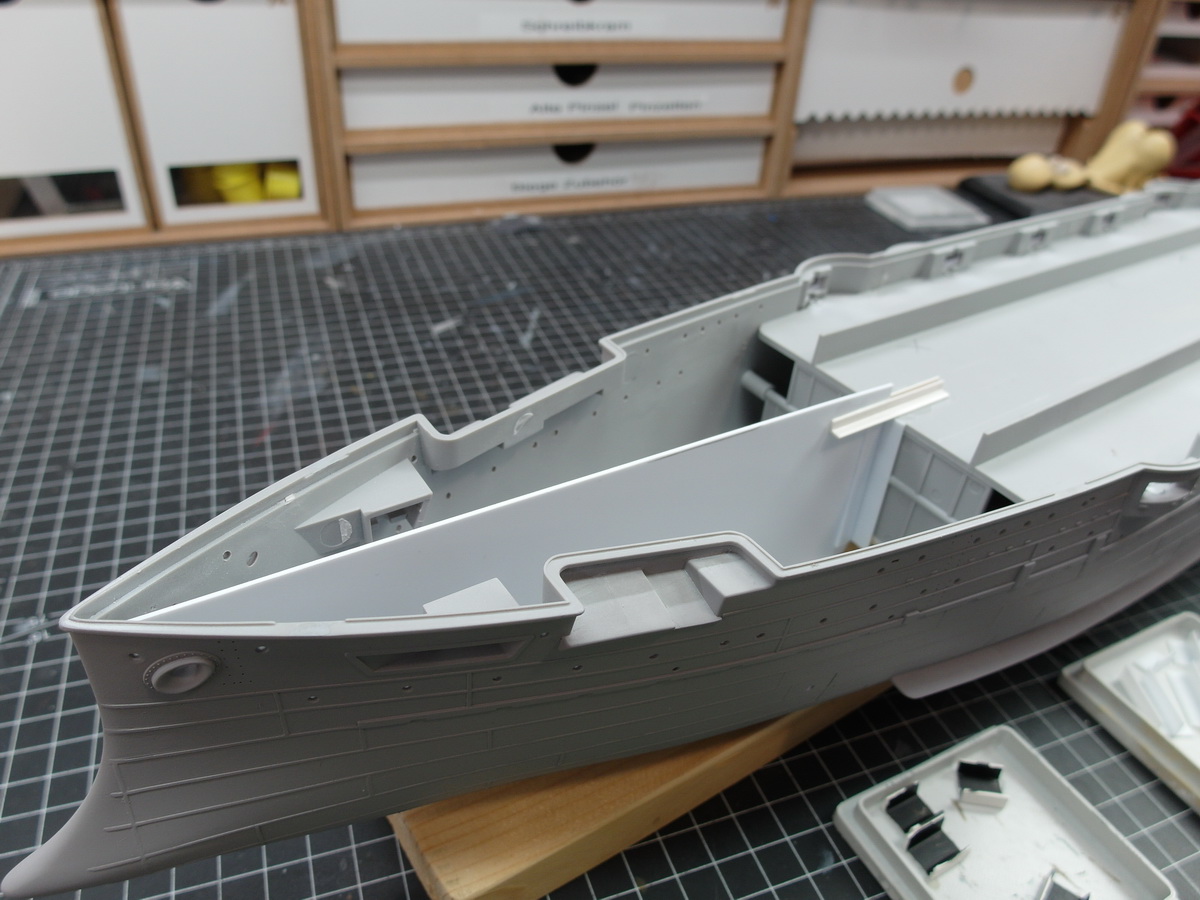

I will also raise the hull to the next level earlier than usual. It’s about the upper row of casemates.
If you glue this fuselage part later, which is actually logical and intended, you can get to the internal structures much better.
But you also end up with a very unsightly slot that can no longer be removed.
More on that later.

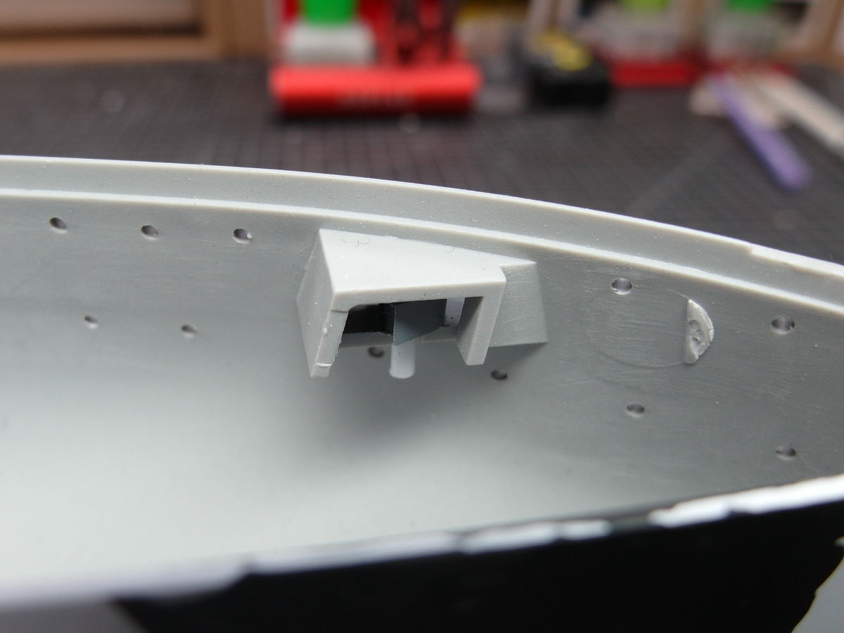

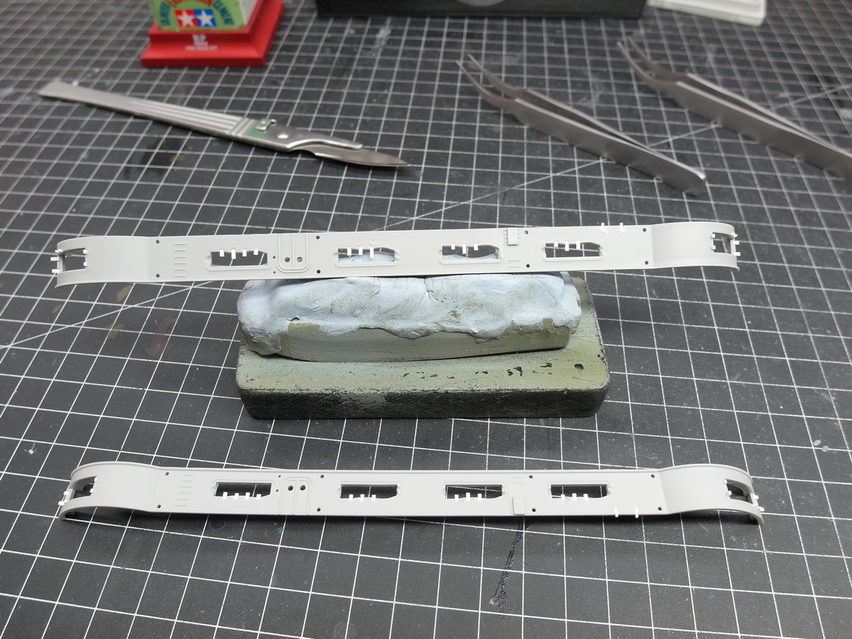

First I soldered the shields of the cannons on the bow and stern.

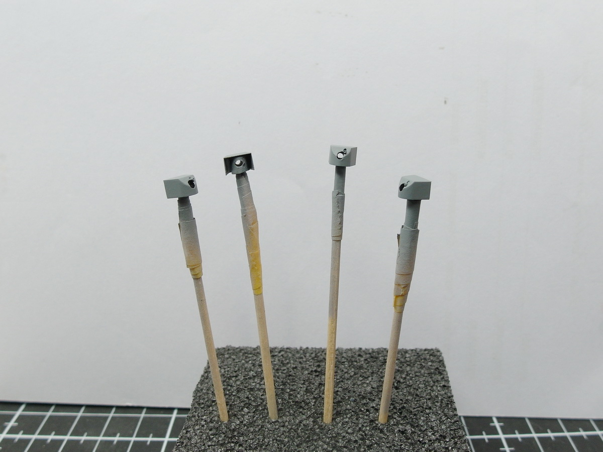

Then, since you can’t see anything behind the shields anyway, I simply replaced the cannon body with a small piece of styrene pipe.
This was then glued in…
…and I’ll simply put the barrel of the cannon through the hole later.

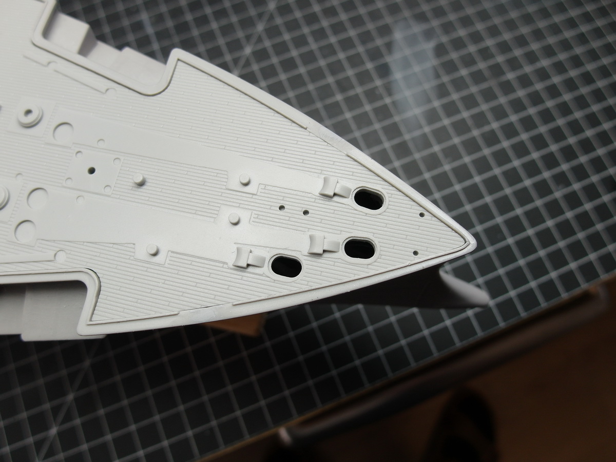

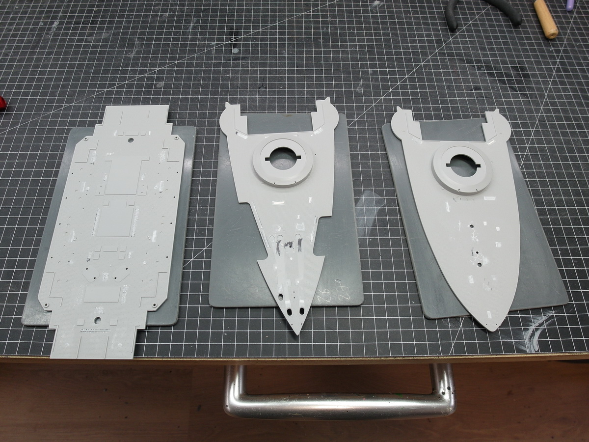

Now that all the cannons in the hull are installed, I can prepare the deck.
First say goodbye to unnecessary details. I got a small electric chisel, it simplifies things a lot.
Great, deck ready.

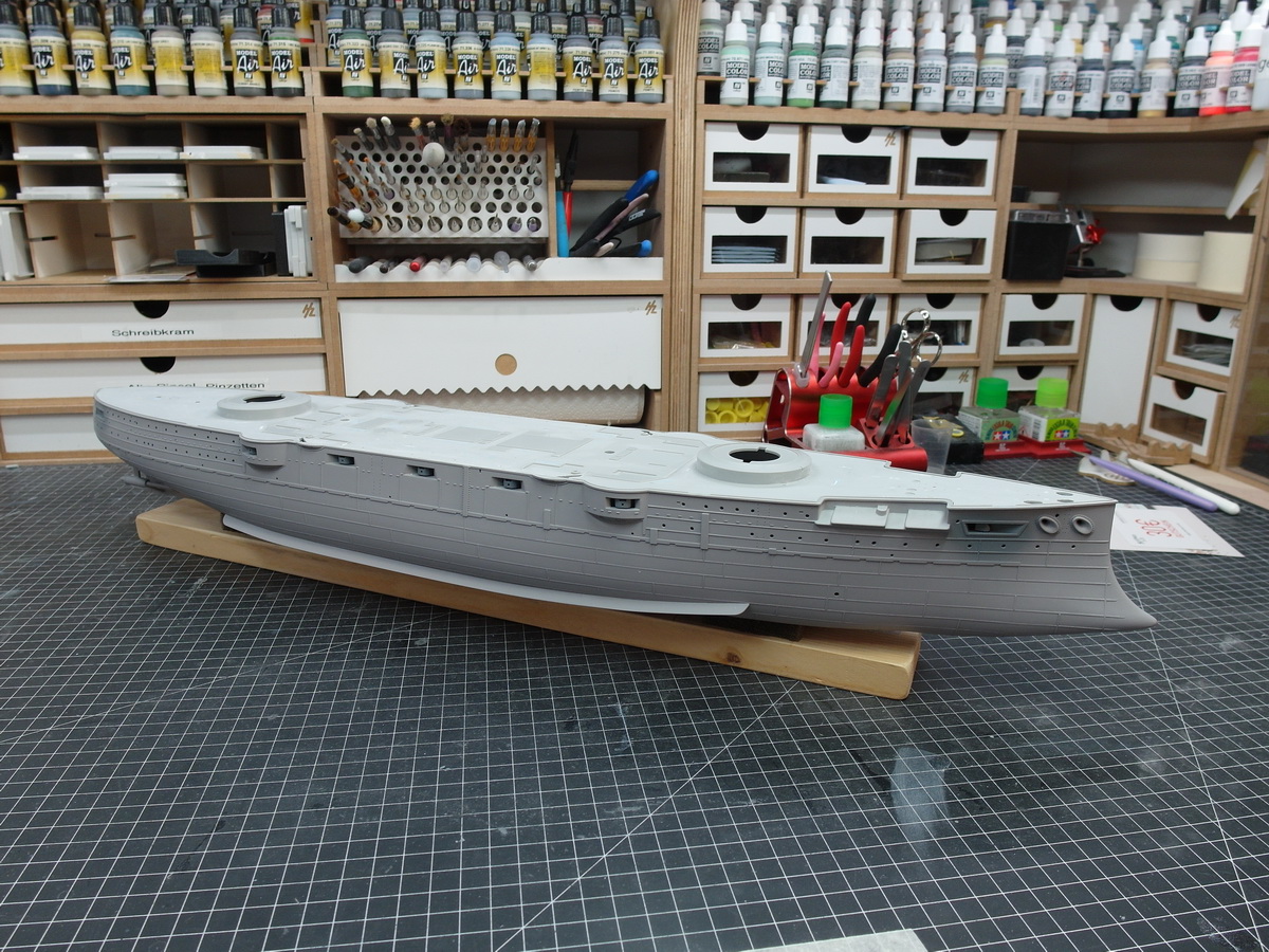

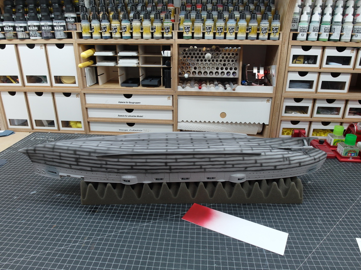

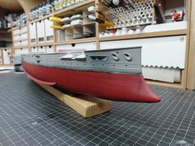

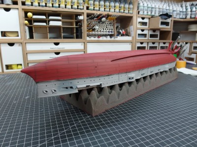

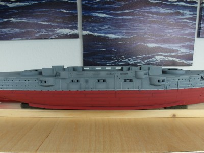

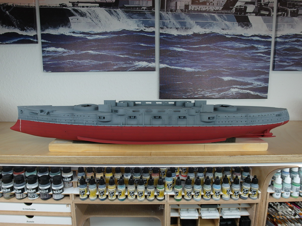

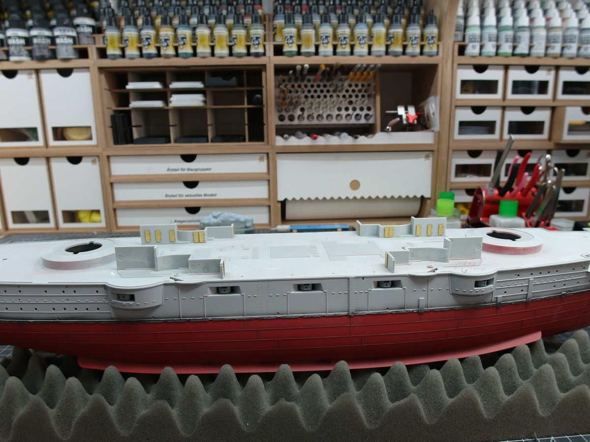

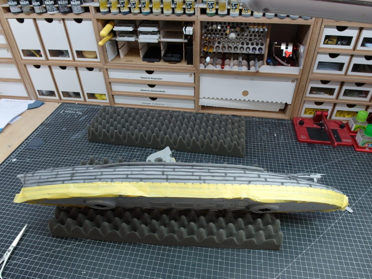

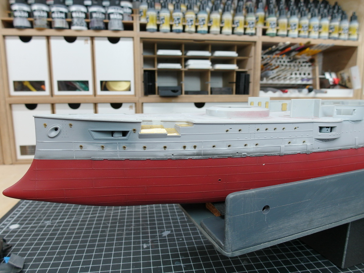

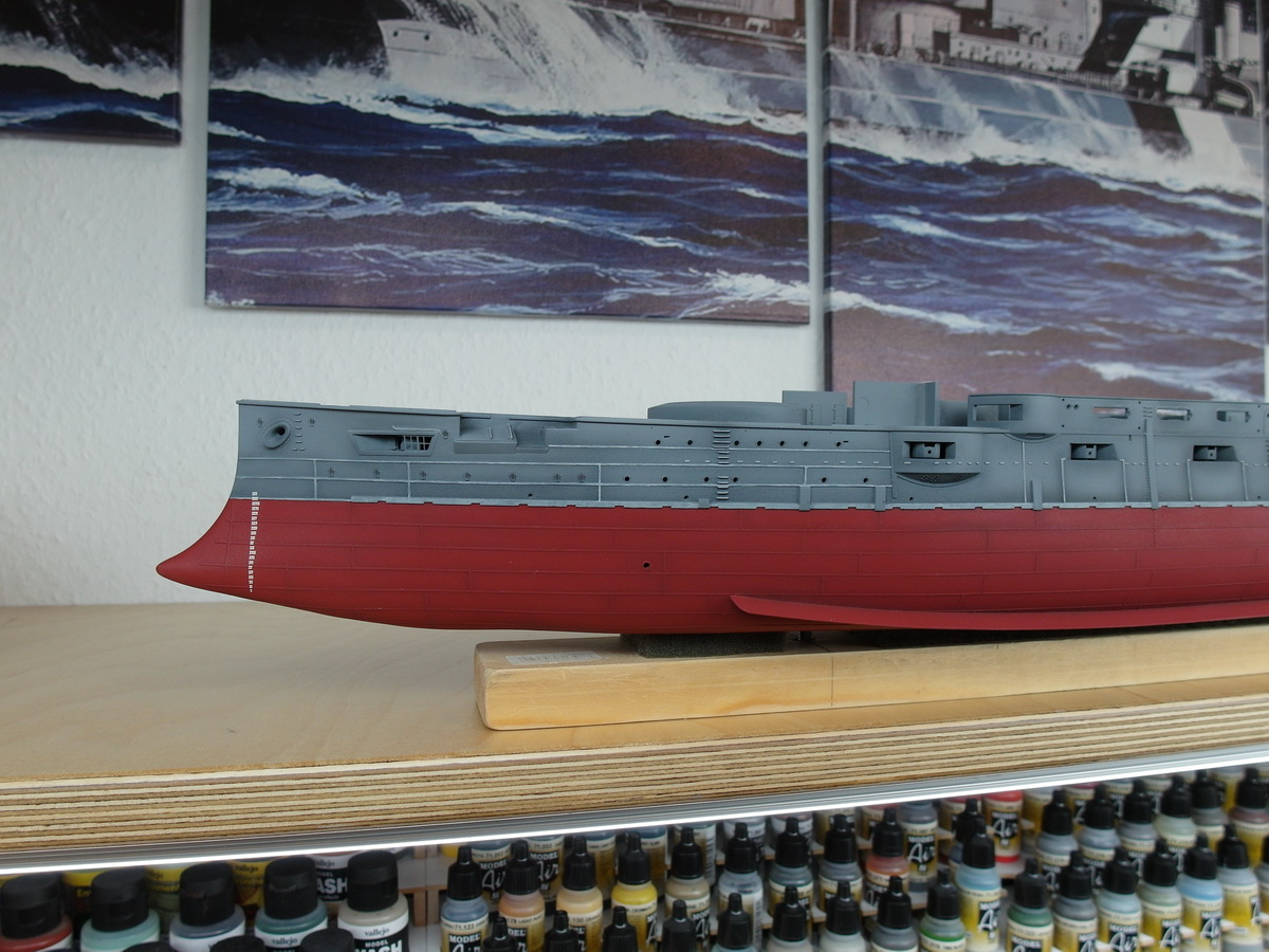

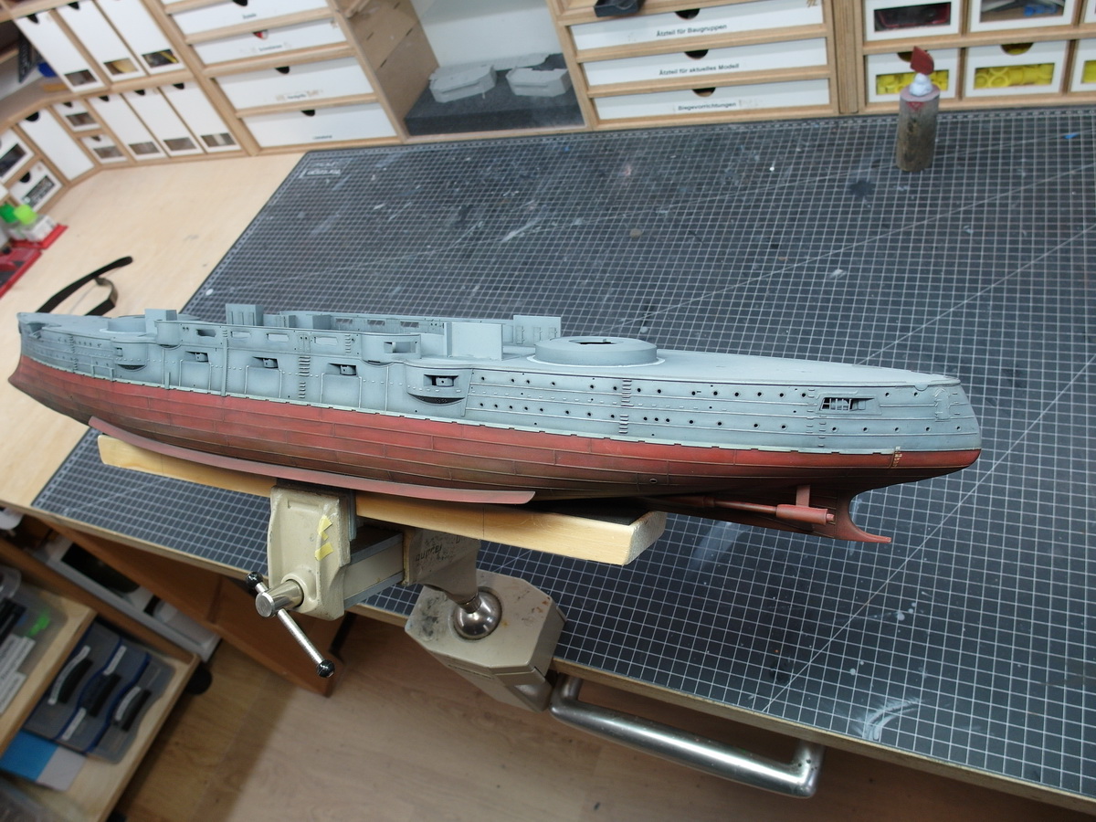

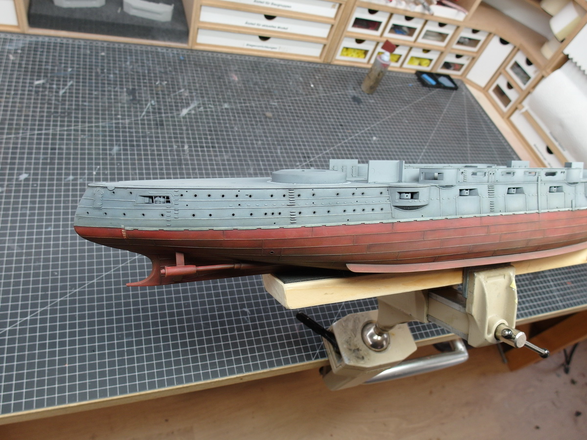

Let's start by painting the lower hull. First the preshading.
And then tape it off. I’m doing this relatively precisely, even though I’m only in the basic color.
Of course I could spray the red without masking it off, but then too many layers would overlap afterwards and the whole thing would be too thick for me.
And now the antifouling paint is on the underwater hull.
The waterline is running great. Profiles attached at the correct height. I really like the structure I made from the styrene profiles, and the preshading also comes into its own.

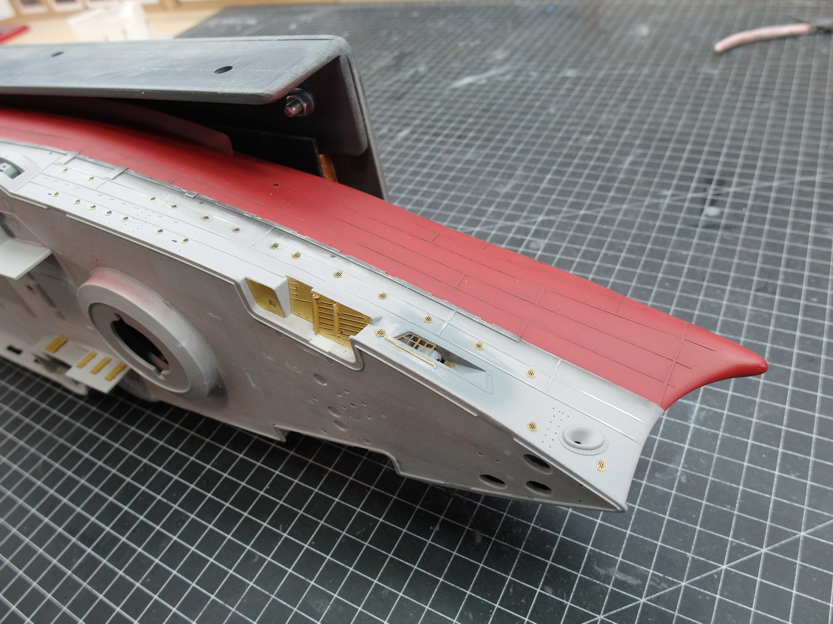

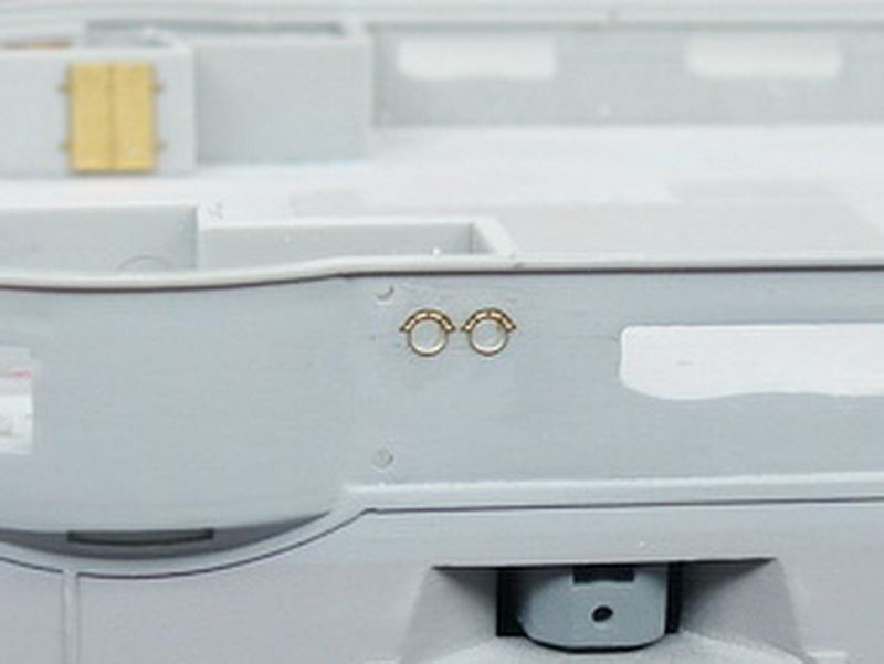

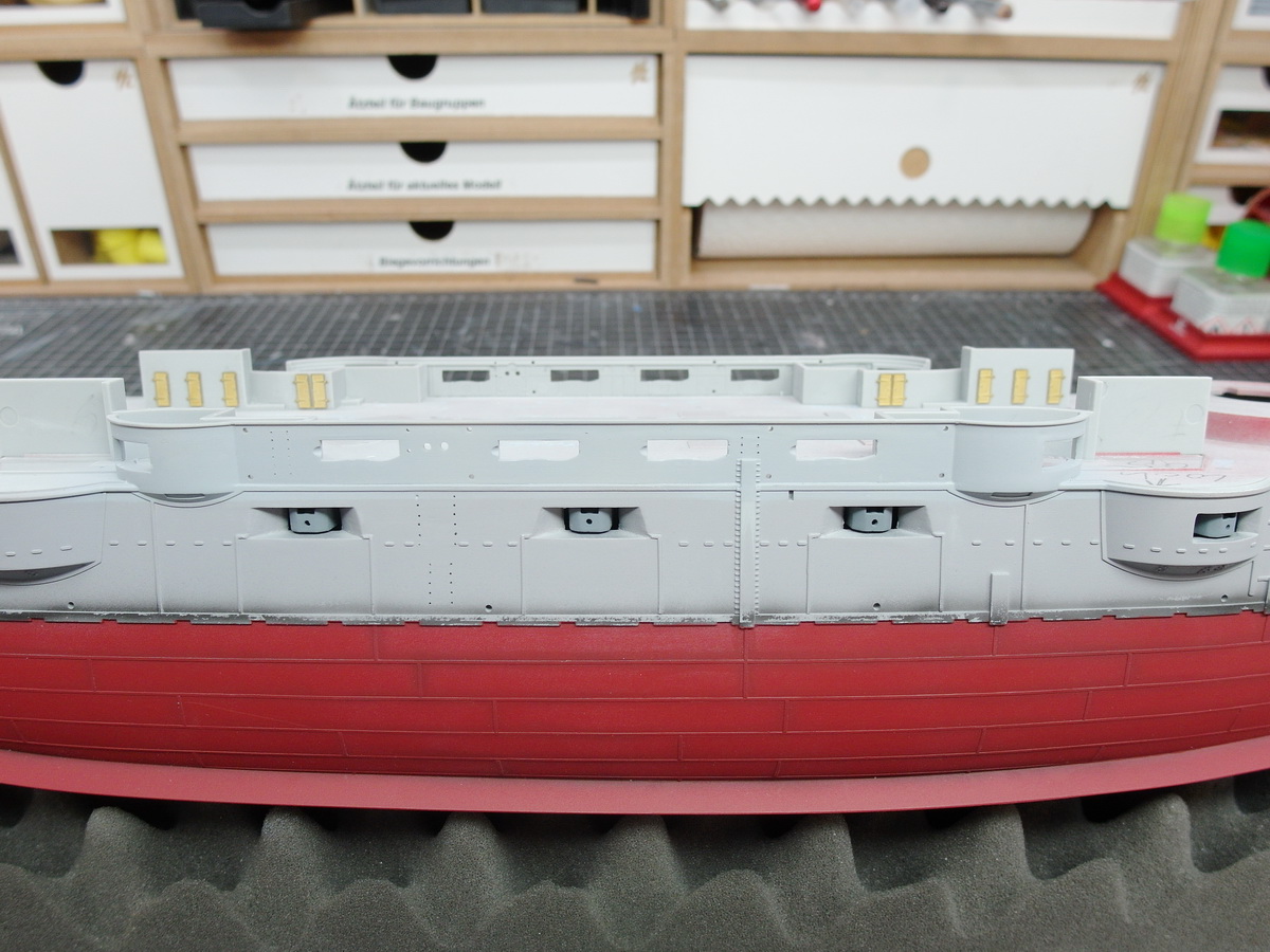

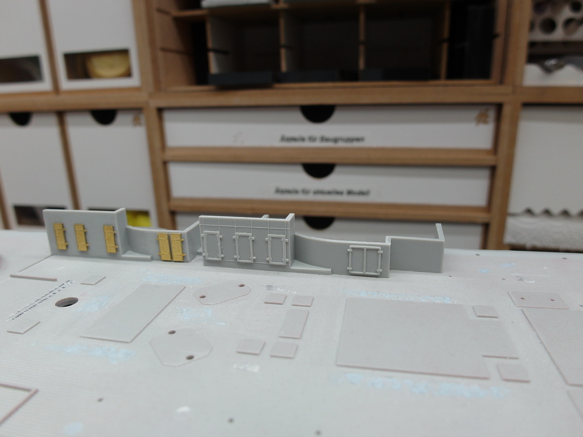

And it goes on to the upper casemates. Unnecessary holes closed again.

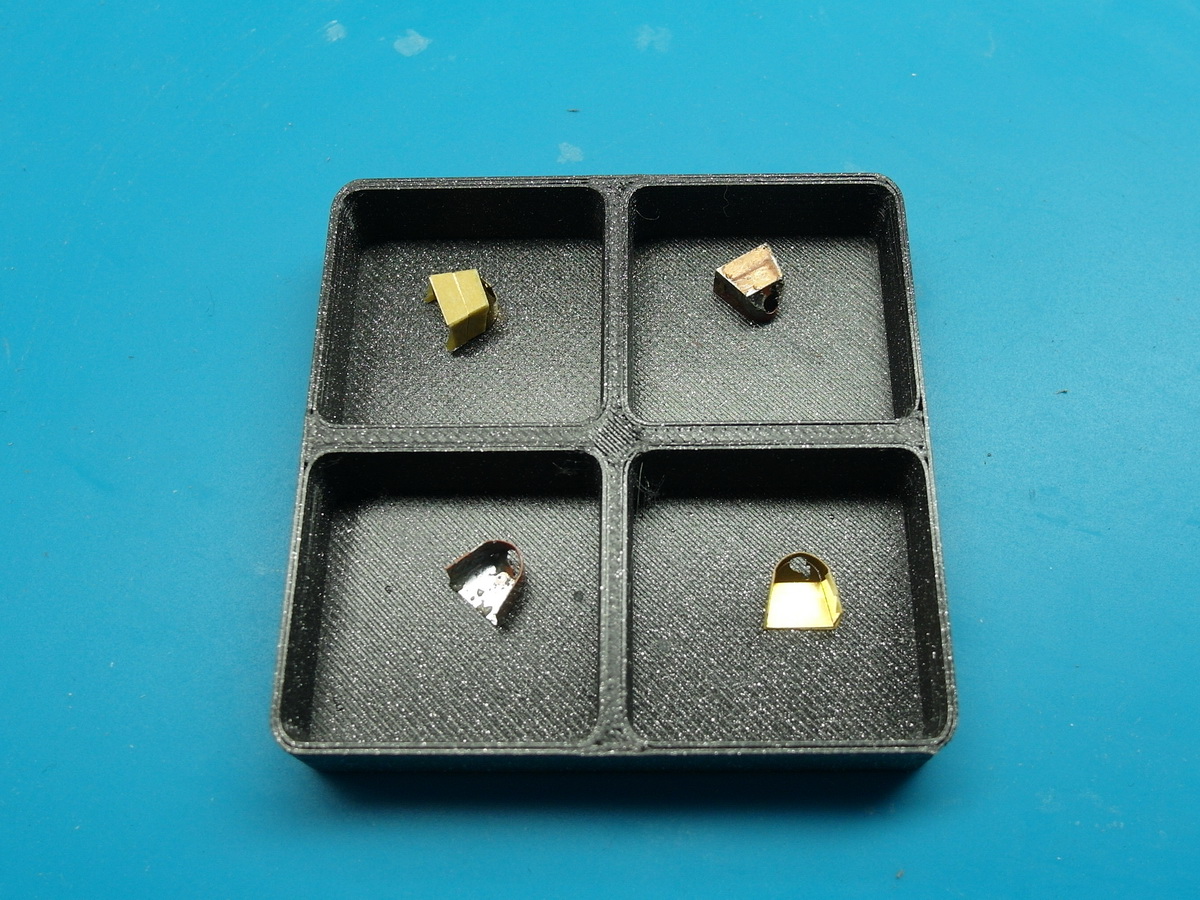

So the etched parts battle could finally begin. The MK1 set has already scored its first points.
Shortly before I had sanded away the rather rough details, I thought about taking a quick photo of them. Pontus had not planned anything here. Incomprehensible, even if you can hardly see it on the finished model.
So, one to zero for KA Models. Still processing the remaining door. Then the first superstructures can go on the deck.

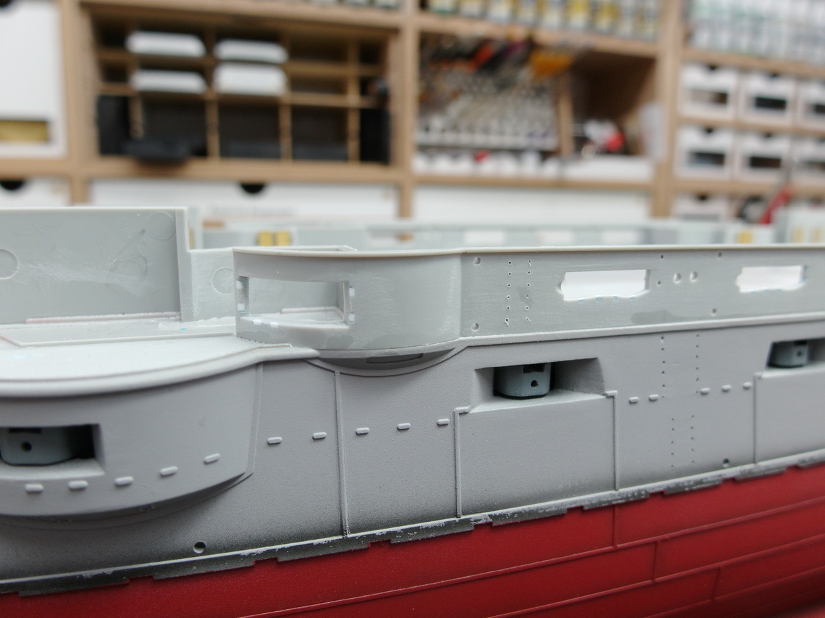

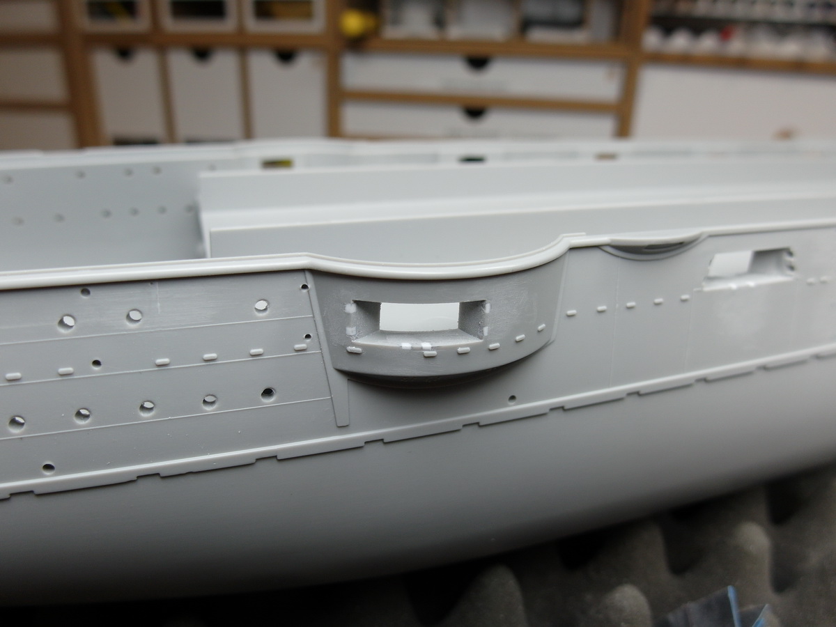

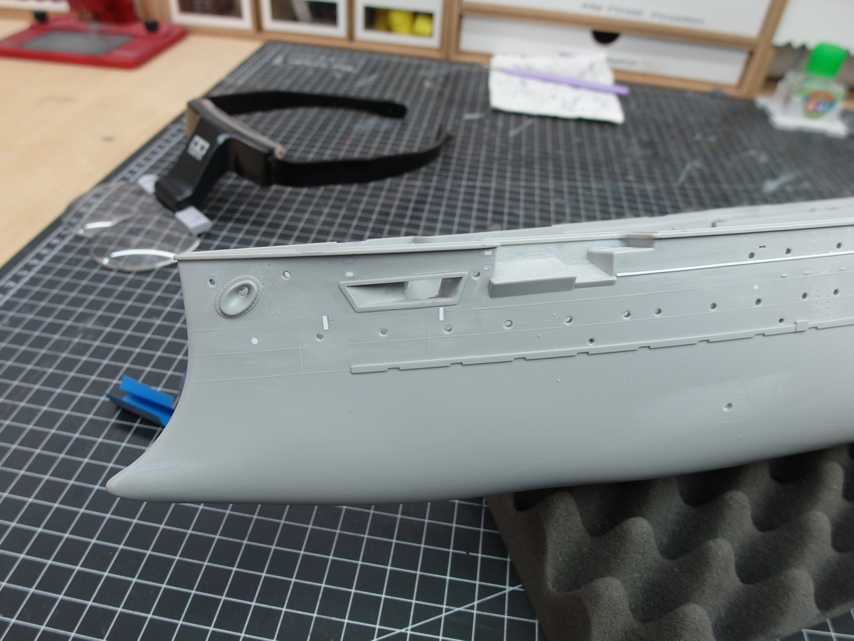

So I was able to add the next floor. Here are the pictures to show why I go to this length.
The slits in the four round casemates would still be manageable.
But this one isn’t very nice.
I think this is better.
After sanding three times and prime, I am very satisfied.

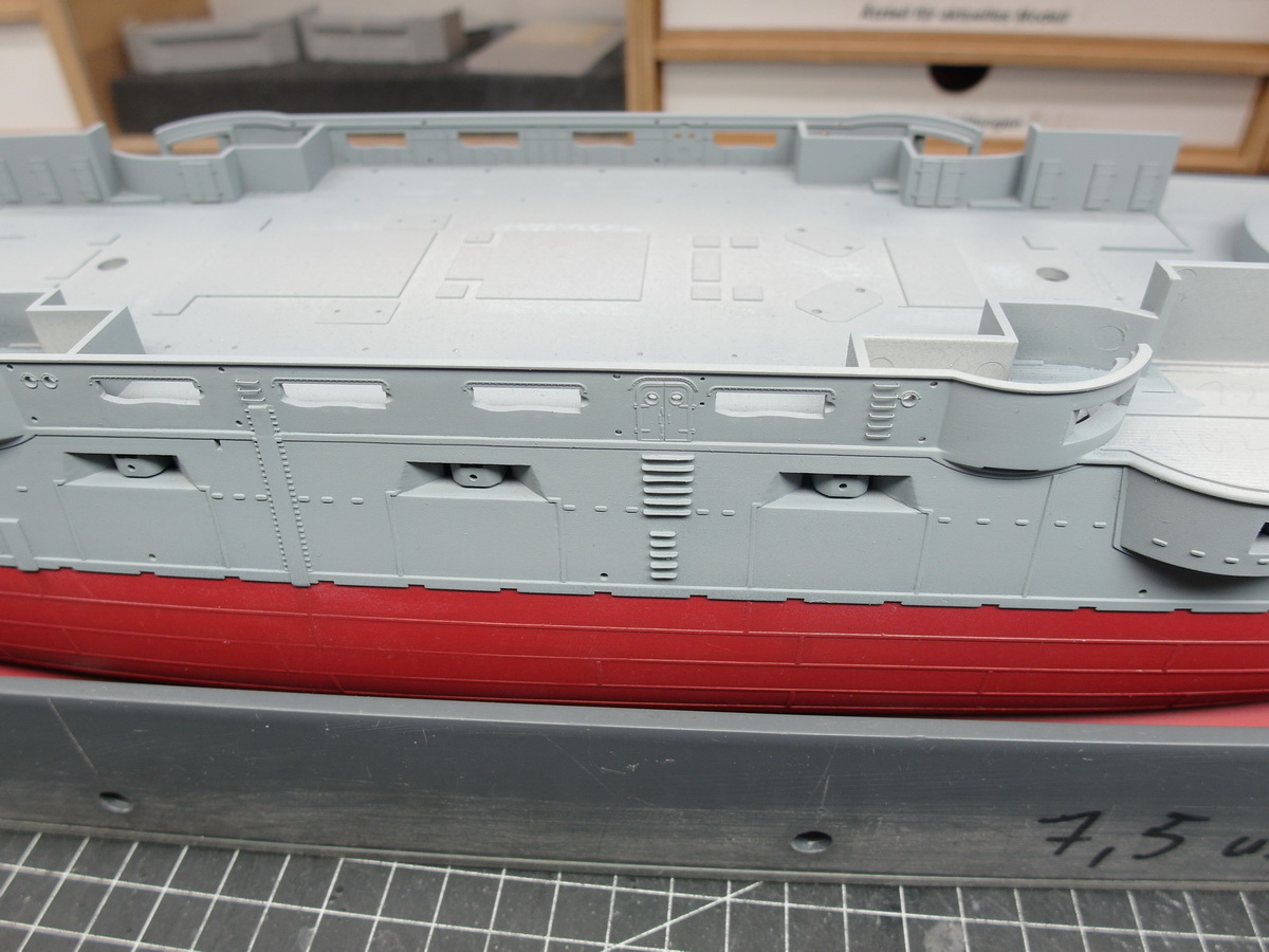

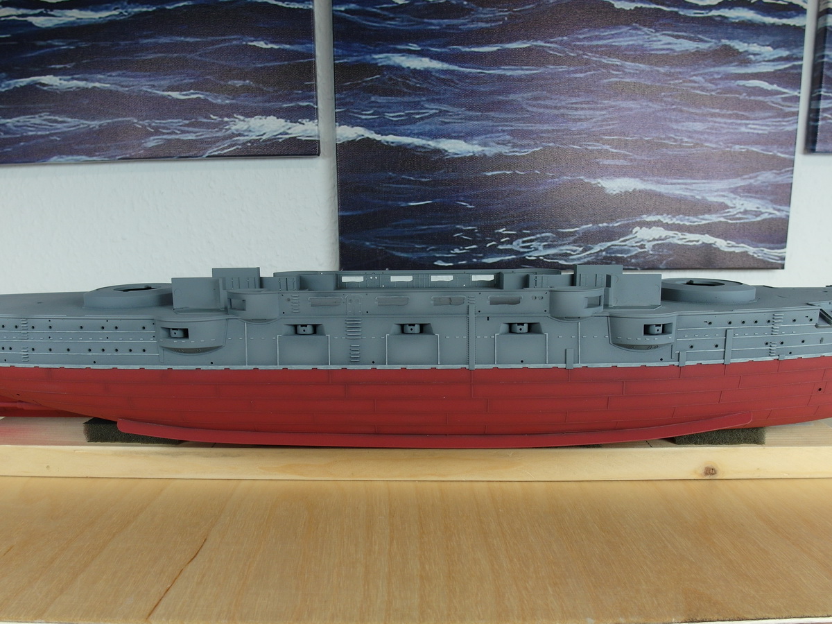

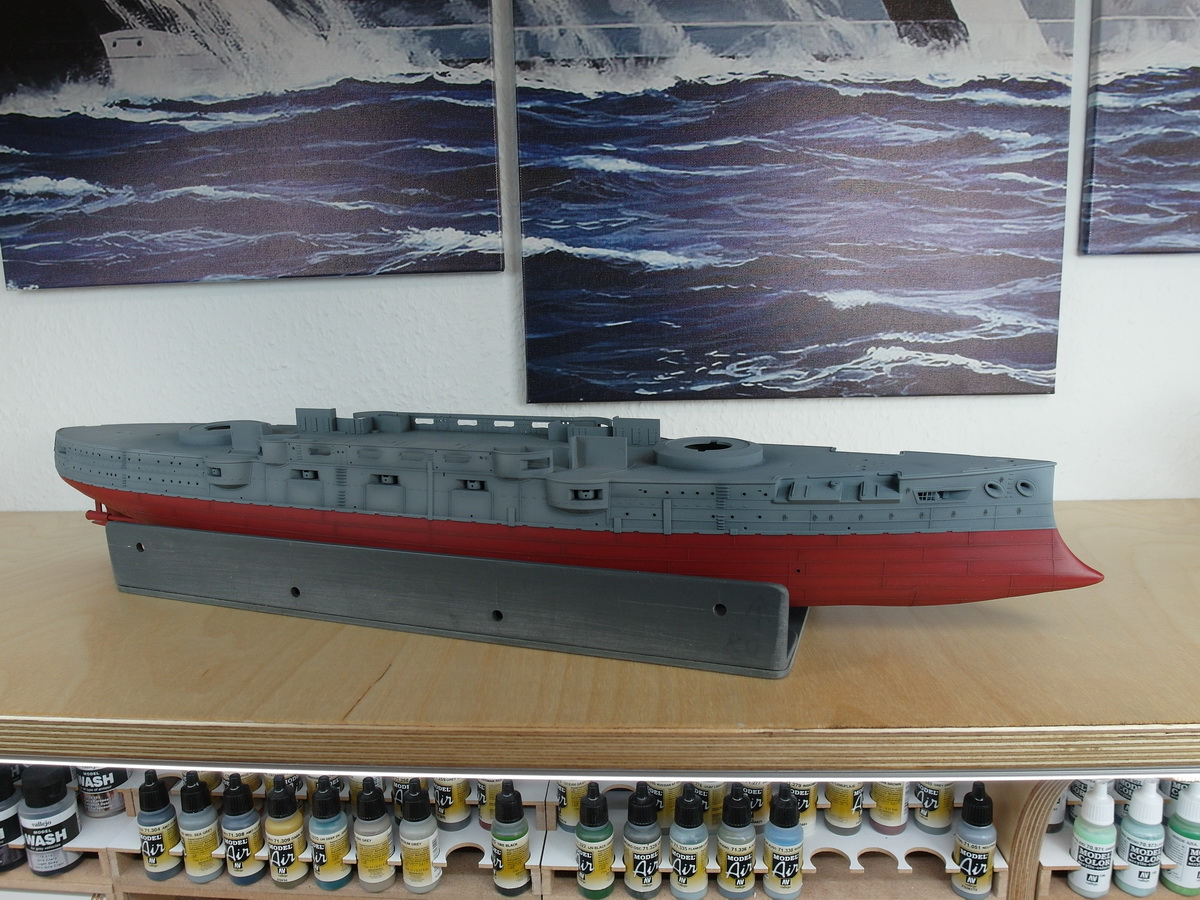

Then I built a dry dock for the Mikasa.
This means it can be safely laid on its side, for example to work on the portholes.
I can also attach sheet pile walls of different heights to further increase the protection at the top.

PostPosted: Wed Apr 17, 2024 3:44 am
Posts: 2588
That is a great start Jörg! :thumbs_up_1: :thumbs_up_1: :thumbs_up_1:
I learned to use such a 'drydock' workbase from the books of Philip Reed, and I'm a big fan! Much less risk of damage during the build, and the sides are very convenient hand-rests too.

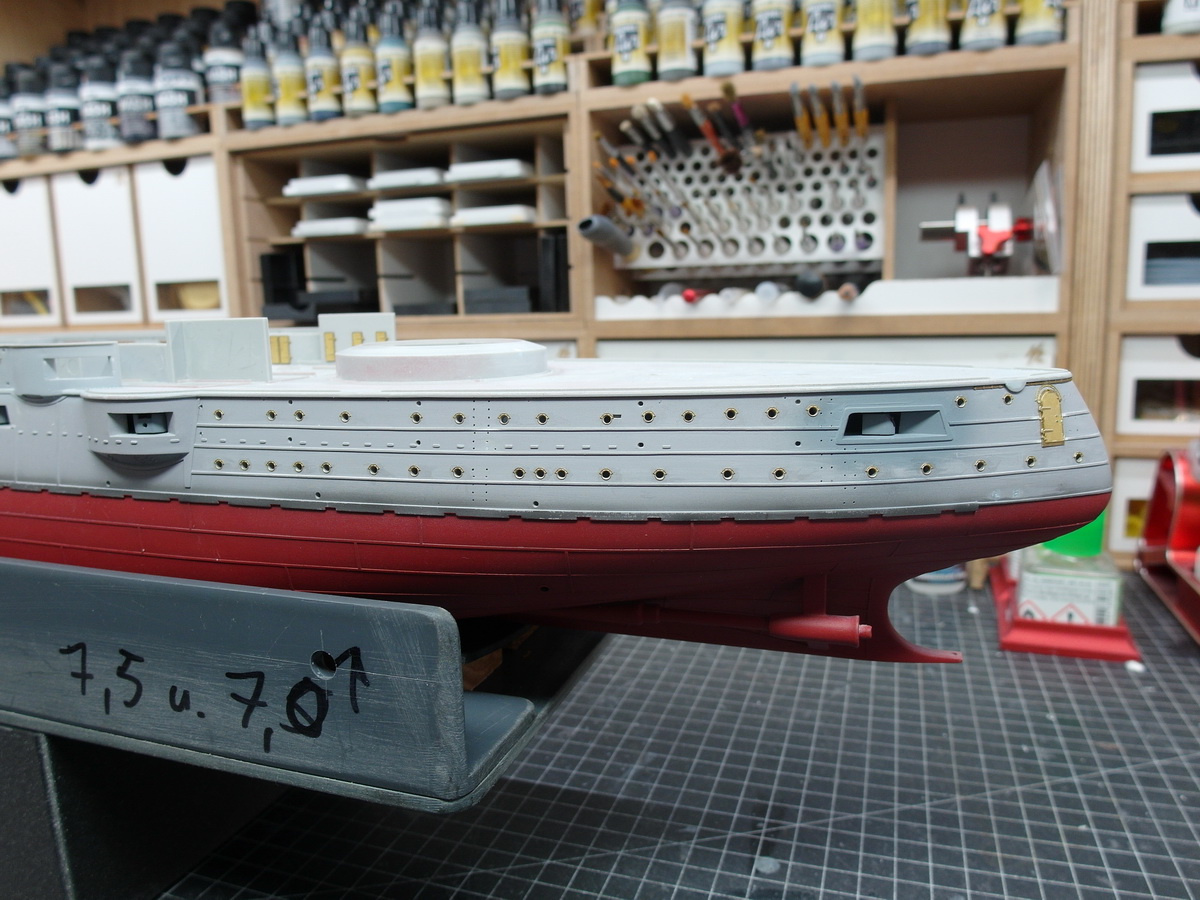

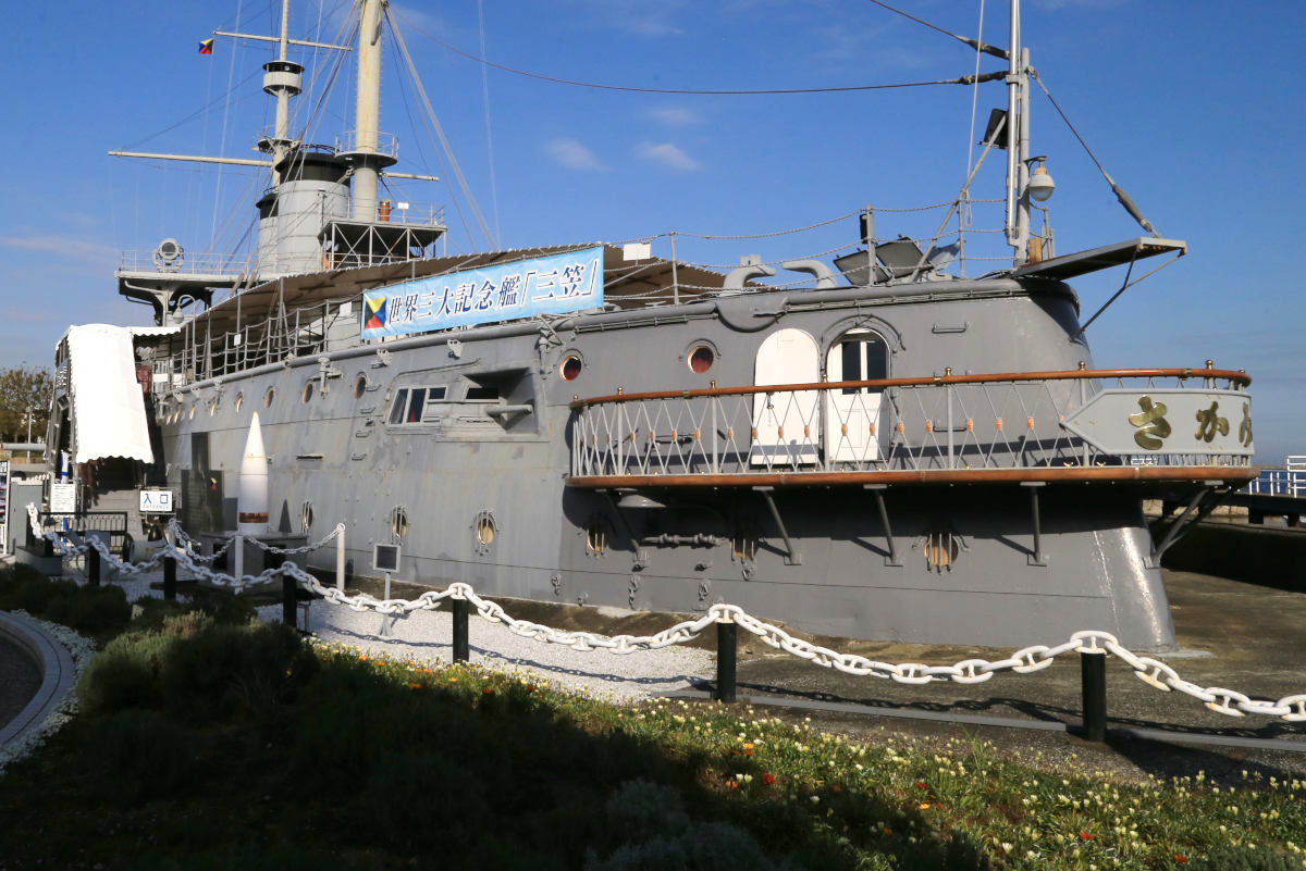

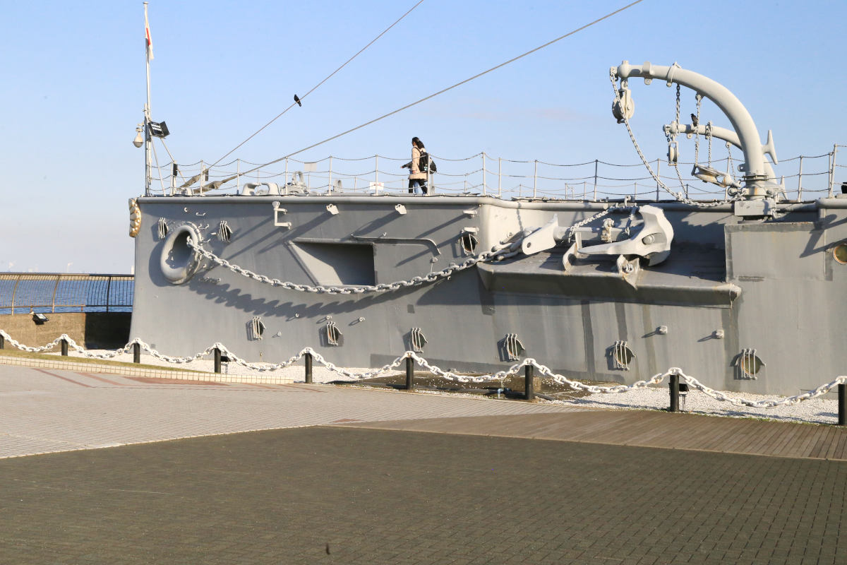

Next, onto the portholes. Some of them have grids and I had to find out exactly which ones are true.
The grid would only have had a right to exist at the height of the anchors. On this ship, the anchors were pulled back on board with the davits and an anchor could have hit the hull or the porthole. In addition, the anchor chains ran past the portholes.
So I looked at everything I had in detail again.
The fact is that during active service, here in 1921, the front portholes were barred. You can see this in the following and best quality picture of the ship that I have. It was taken in Vladivostok in 1921.
Here the section is enlarged. So there were bars, but you can’t really tell whether all the lower portholes on the bow were barred.
Then this picture of the stern, also taken in Vladivostok in 1921. So quite late in their active service. She was in this dry dock for repairs.
Here the enlarged and brightened section shows that there were definitely no grilles in front of the portholes at the rear.
So the question arises as to where this protective measure went. The anchor area would be logical. I found the solution in the following picture.
The white arrow points to the same porthole in both photos. You can clearly see here that the portholes were protected with grilles right up to the anchor storage areas.
And this is how I implemented this on my model.

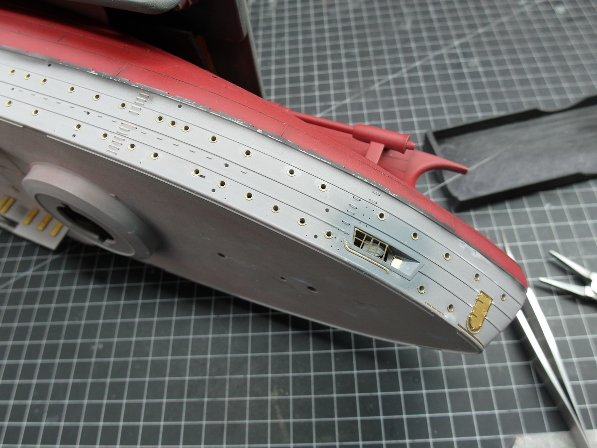

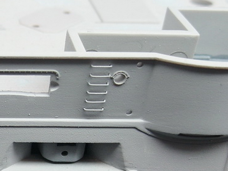

It was time for the final details to be added before painting. For me there are always very few. Most of it is only processed towards the end. This includes the grilles in front of the bow and stern cannons and of course the crampons.
I don’t use the crampons on the etched part boards. I don’t like these one hundred percent because they are of course flat. So I prefer to take thin wire and bend it to size.
In addition, crampons and steps were probably installed on the Mikasa.
Documented here in this old photo. The arrows point to the two species.
And I would like to represent this with 0.2 or 0.3 mm thick wire. The thick wire is then filled with Micro Kristal Klear and I have a step.

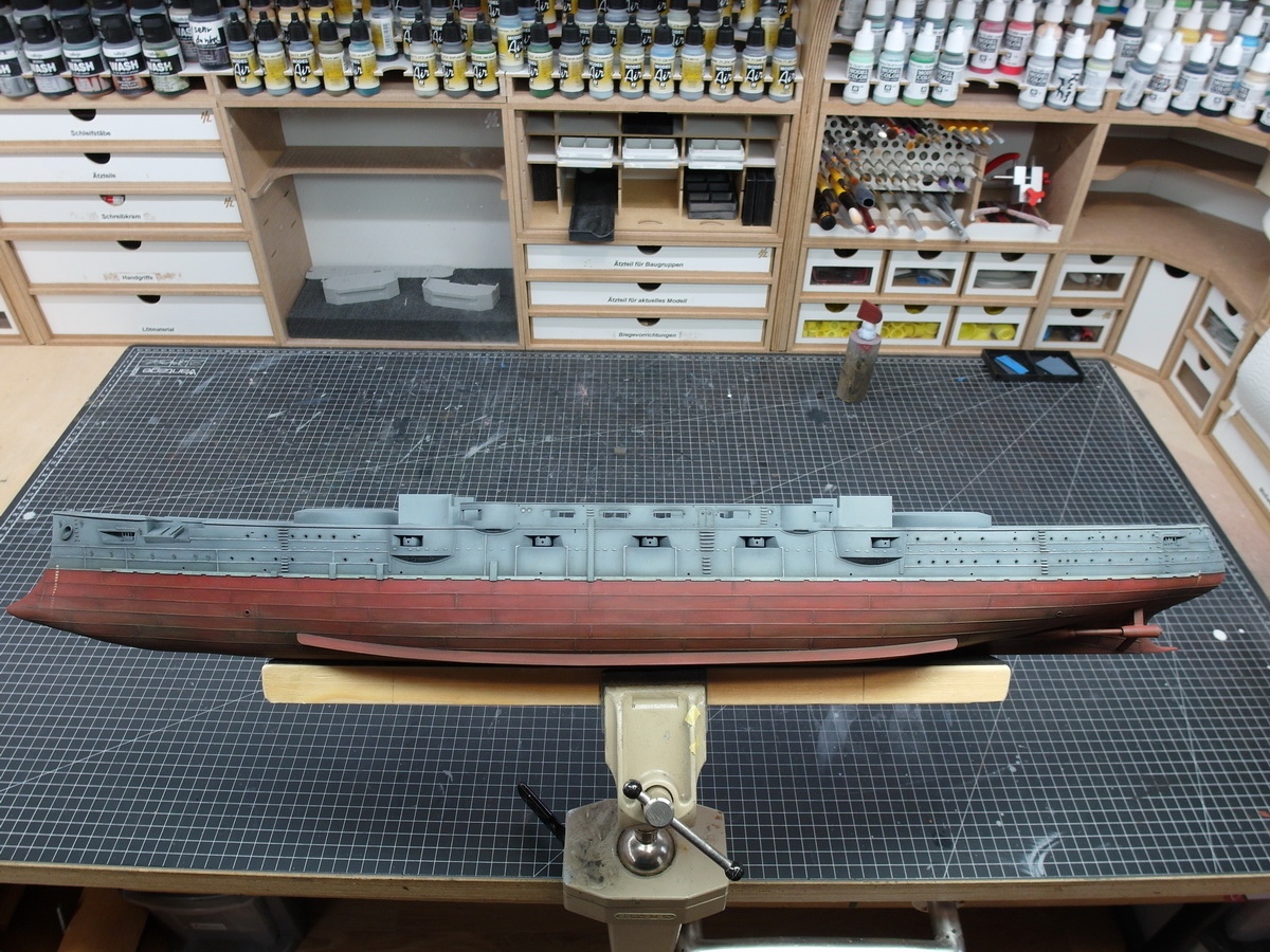

I finished all the rough work on the fuselage and was finally able to finish painting it.
After a proper preshading the whole thing now looks like this.

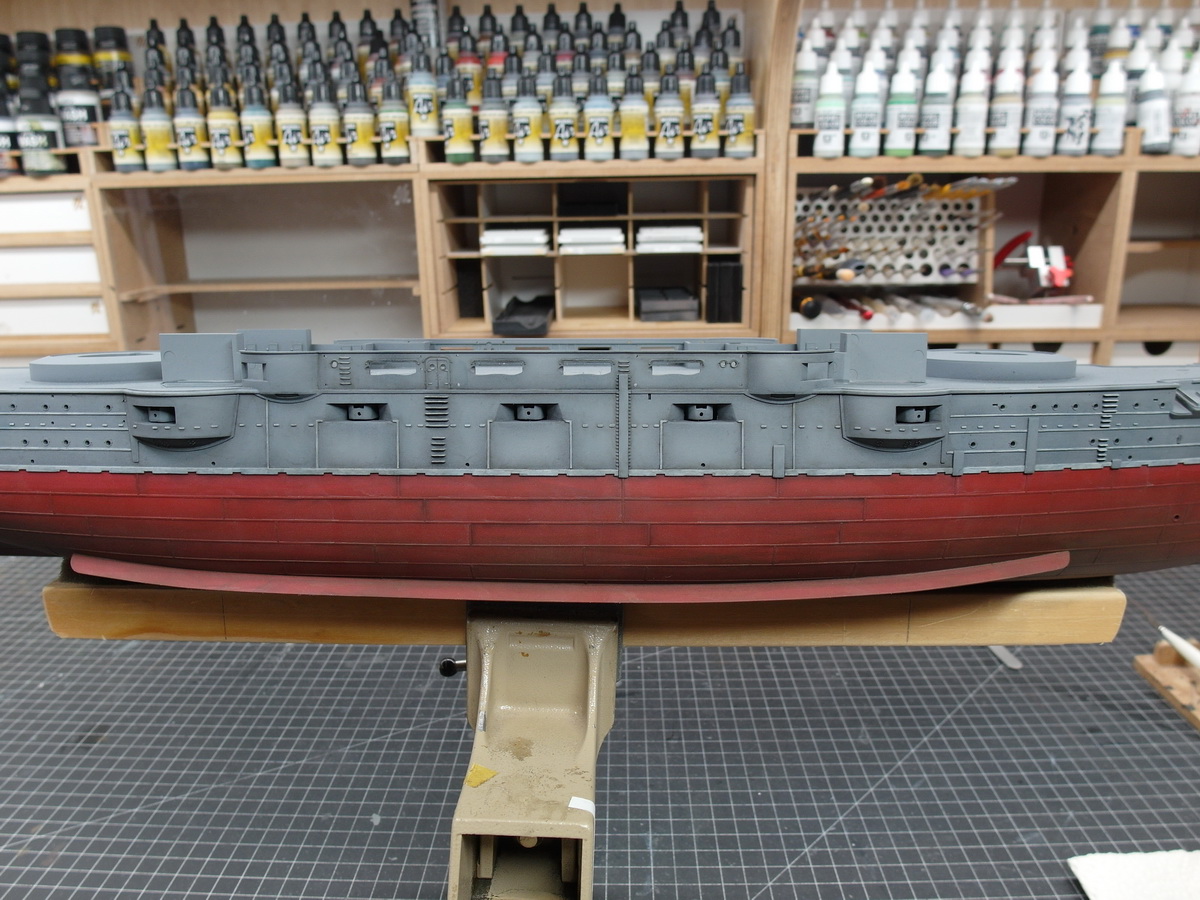

What followed was an accentuation. Which means nothing other than that I painted fine details in a lighter gray.
Which was a real fiddly job. The dry decals from Pontos are really impressive. The depth marks are razor sharp.
Here too, water-soluble acrylic paints have a big advantage. Small slips can be removed immediately with water without leaving any residue.
This gives a decent contrast to the preshading areas.

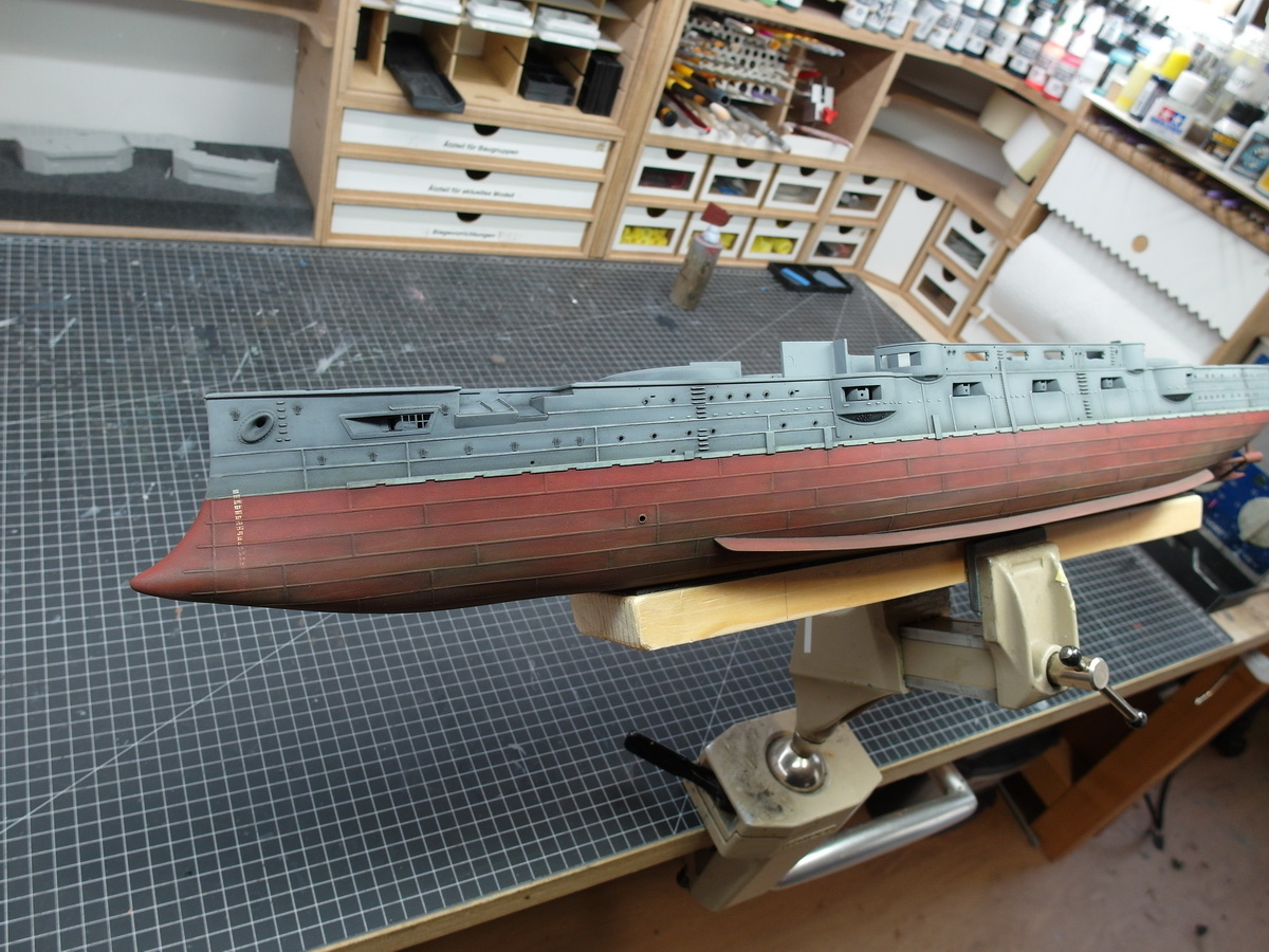

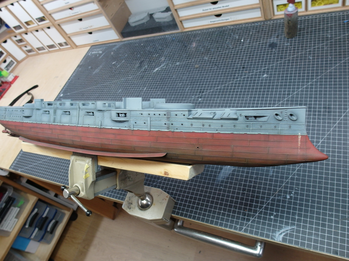

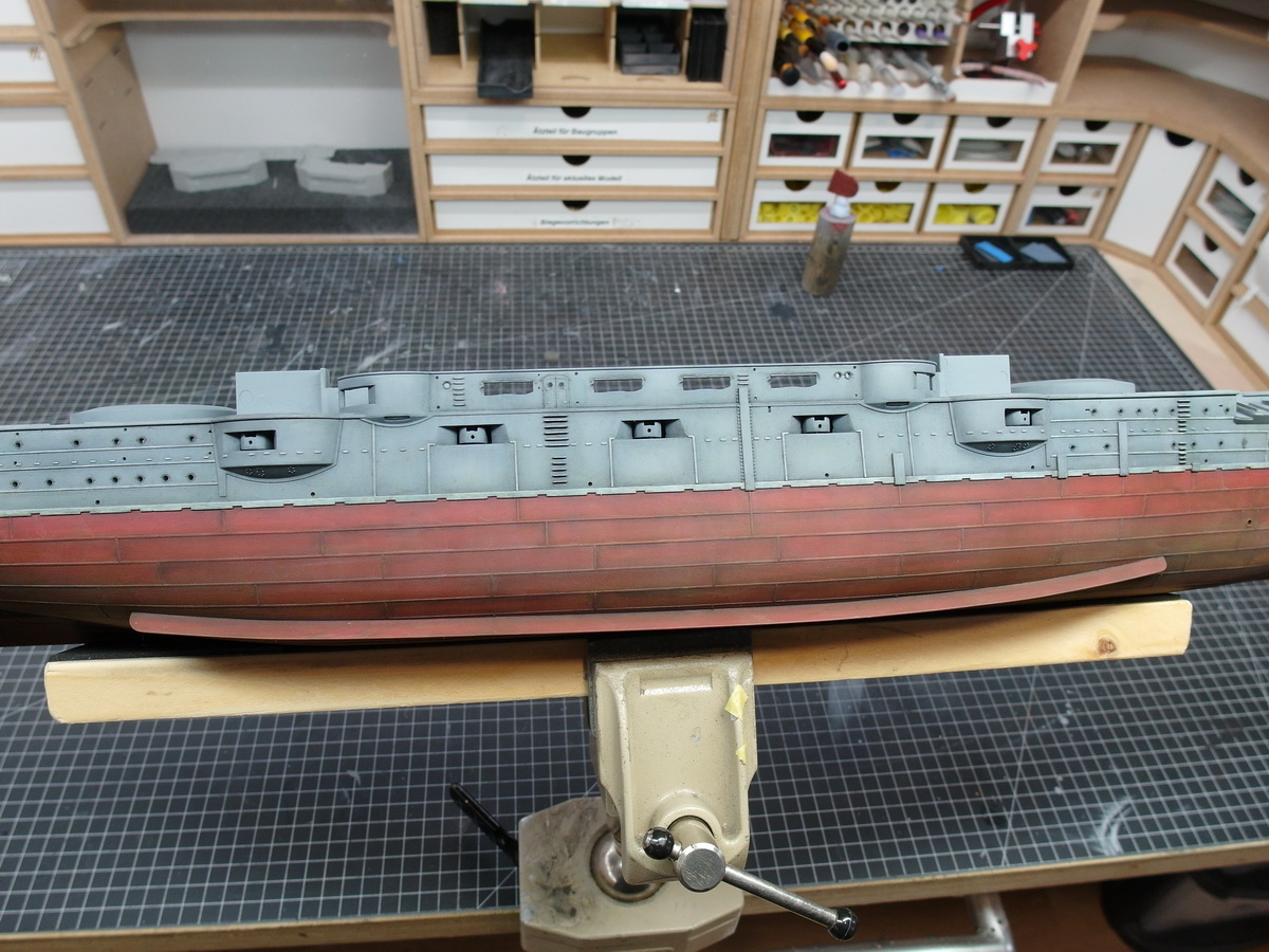

But I’ve already started aging.

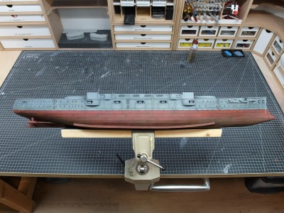

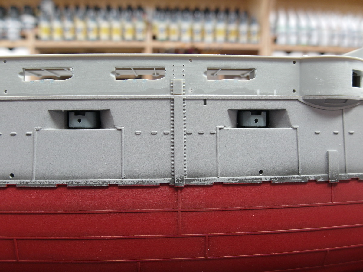

As always, very tedious. But the result that a little diluted dark gray paint leaves on a painted surface still amazes and fascinates me. Even after all the years I’ve been doing this.
A little every day and I’ll report back when it’s done. :wave_1:

Hello Jim.
Thanks for the great trick.
I used the porthole rings from the Pontos Set, which I think give a good look.
They look really good painted.
Greetings from Germany.
Jörg

Here is a photo of the bow of Mikasa that I took in 2018. I agree that it's hard to find photos of the Mikasa online, so I took LOTS of pictures of her. If people would like to see photos of other areas, please let me know. However, a lot of the ship above the main deck is no longer original...even the main turrets and guns are reproductions.
Mike

Thank you drdoom1337. That is exactly the problem with the museum ship, that the information is not reliable. I also got some pictures of her through a friend. Maybe I'll get in touch again if I'm looking for something specific.
I’m a little further along.
The first round of aging is complete.
There are three filters on the underwater hull.

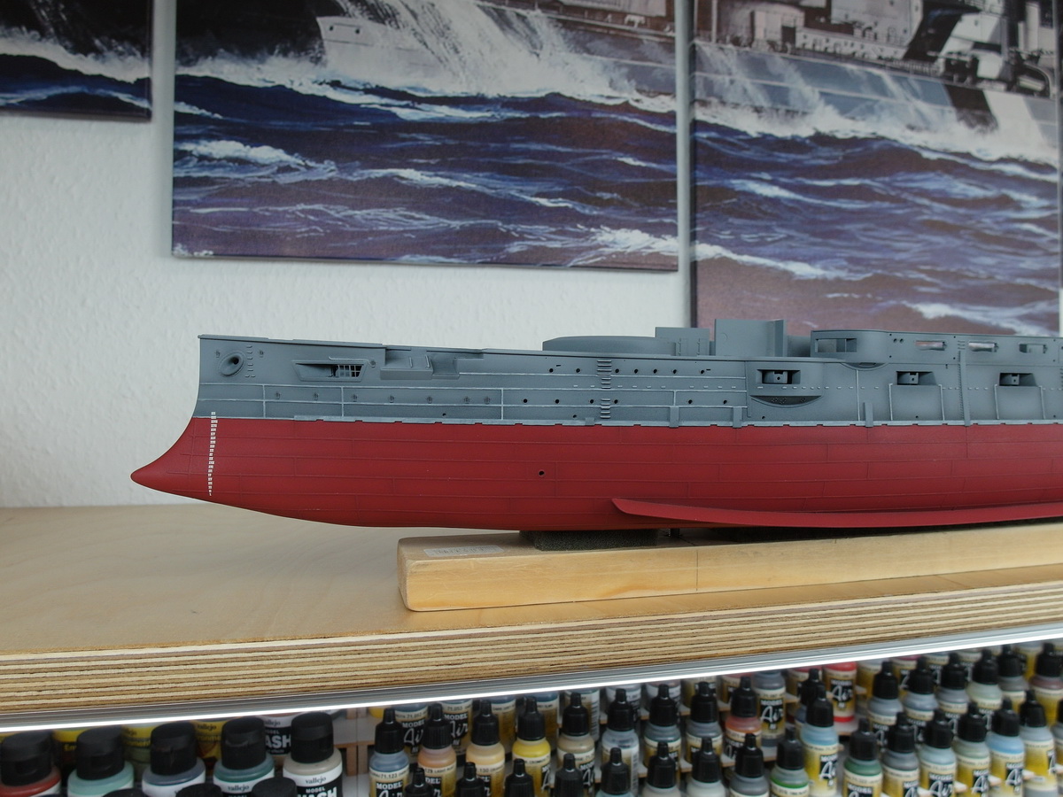

On the gray two.
Also a first washing.

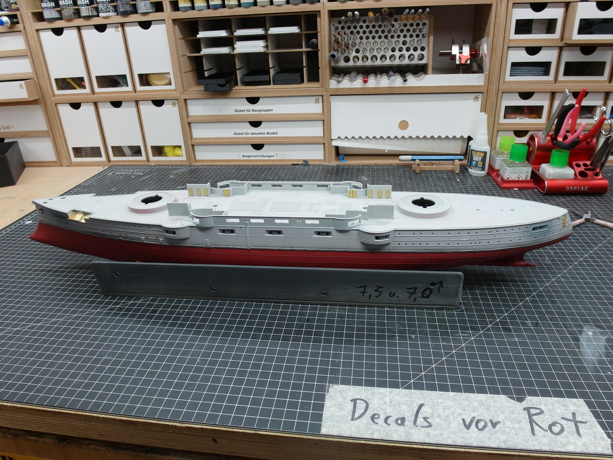

Above and below.
I’m quite happy with it.
Jörg
