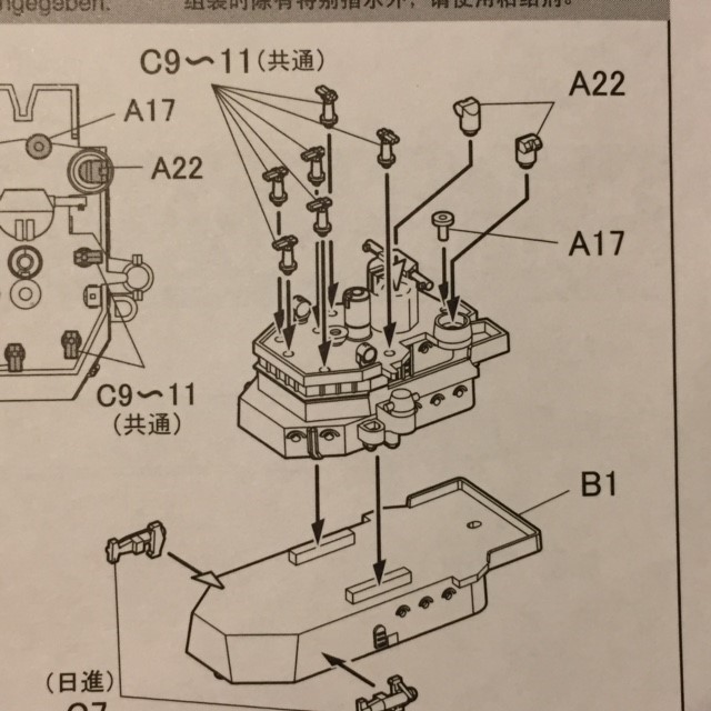

So, I've lost a couple of parts on my Nisshin and I don't know what they are. They are part A22 in the kit if you have it. It's the thing on the round platform on the top level of the forward superstructure. I got two in there, but two more are needed amidships. I really can't figure out what it is. Looking at superstructure diagrams in my Lacroix and Wells cruiser book, I *think* it may be a 1.5m navigation rangefinder but I honestly don't know what it is.
I imagine after I put on most of the other small parts I'll see what else I've lost and order some appropriate parts from Shapeways.....

I don't have the kit, so I am referencing the instructions online. Parts C15 are 1.5m navigation rangefinders. Parts A22 appear to be the 25mm MG directors. See Finemolds NanoDread set WA29. I think there are some covered versions in PitRoad set NE03.

Thanks Dan. The part in the kit doesn't look much like the 25mm directors I can see pictures of in my Lacroix and Wells book but I'm not sure that means anything. I see the shelf oddities also makes some directors for those.

Theses little guys? I can see how they could escape.
Four options come to mind:
1) Fabricate replacements out of styrene rod or stretched sprue. The kit parts are just about .04" which is a standard Evergreen rod size. Not sure what the parts actually represent so it's possible you may actually create a better depiction of the real thing if you have a photo reference.
2) Use some similar replacement "eye candy" the scrap box, or what have you.
3) Use after market replacements from Shapeways, Nano Dread, etc: https://hlj.com/product/VTMW70010
https://www.shapeways.com/product/DW7ZA ... d=59071860
https://www.shapeways.com/product/CE6DZ ... d=59128159
4) It's a cheap and available kit. If it bugs you, pick up a spare for extra parts, future conversion, give to the kids, etc. (which would be cheaper perhaps than after market replacements). https://hlj.com/product/AOS00844
I'd go Shapeways myself since 3d printing is amazing and their service is good.
Thanks -

Oh - and then there's the armor trick:
5) Put a tarp over it and ignore the error.
--SDR

Re: the shapeways stuff. Does that work with plastic cement or do you need to use CA for it?

CA glue - and splurge for the Frosted Ultra Detail, if available. Same material as Frosted Extreme, just better resolution.
