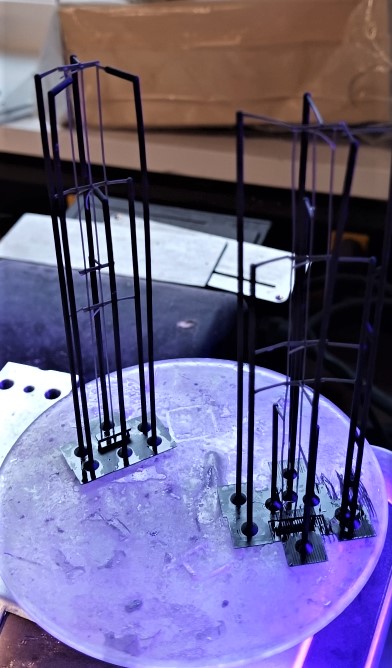

Thanks, things are moving along slowly at the moment, working on main deck liflines, etc. In this effort, I've found that horizontal printing, while much less time consuming, is not producing the correct result, so I have printed my last 2 sections of railings in a vertical orientation. This now takes anywhere from 12 to 15+ hours BUT, I can get quite a few sections printed at one time. So, this will be the effort - to get these all printed in one final print session; I usually print 2 pieces of each as a rule of thumb. Here's a recent example -
A bit hard to figure out with the supports still attached to the printing raft, but the railing section is in there, just difficult to discern.

Glad that technique is working out. When I printed masts vertically the attached ladders generally came out very well. I'm still using the printed stanchions and sprue lifelines, which are quite invisible as they should be, but very fragile. Once you get those on then the segments you have sitting on the shelf can be added, which will be exciting! Another masterpiece in the offing!

Thanks! Printing lifelines, etc. upright seems to be the best way, but NOT a certainty every time.
While working on the parts for the New Bern model group's BB-55 restoration project, I'm having to try various orientations to get a decent print - of course the much smaller size doesn't help, but I know from my earlier test print last week that it can be done - the full-length parts simply require time & effort to come out correct.

I successfully printed some very nice vertical ladders fro masts etc at smaller than 1:500, but they are very fragile and overly floppy. Perhaps since the print time is so long vertically print a bunch of them, increasing the likely hood of survivors. Sometimes 3D seems to be dependent on the alignment of the stars and moon.
Looking forward to the installation! Tom

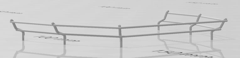

Last night printed again the 01 Level (Hedgehog Deck) railings and orientation was the key to a successful outcome. Took overnight (9+ hours) but worth the time/effort -

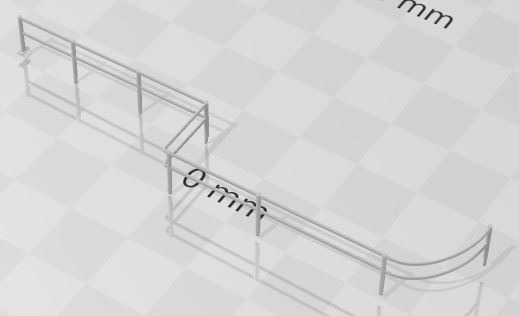

Today, after getting another run of my BB-55 restoration parts printed, I'll also reprint the main deck Hedgehog Deck X Bracing & Railings in a horizontal orientation as this seems to give much better results -
144 scaled DD566 Hedgehog Deck X Bracing & Railing.JPG [ 18.32 KiB | Viewed 697 times ]
Once again, this part has been eluding me as to getting a successful printing - I've had to alter size & height to what the model is, not the plans as they don't show true 3D depth and slight angling of posts or stanchions.

The Hedge Hog rail is geometrically challenging. I have such a rail to do for Alaska’s 56 mount and have been avoiding it. Sometimes I have taken card stock and made patterns to figure out the geometry of your forward deck support stancions or constructed them by piece work.
