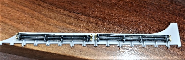

Here's the hoses installed on the bulwark -

I LOVE the Fuel Oil Hoses! :woo_hoo:

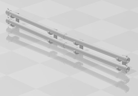

Thanks, SG1!!! It was a fairly simple 3D design - there IS a slight curve to the hoses, but hard to see. Thought that length needed a slight sag in them. Here's the design picture of that part -
Appreciate your interest! :thumbs_up_1:

Are those two connected 10' sections? Good way to print and install, otherwise quite difficult to paint!

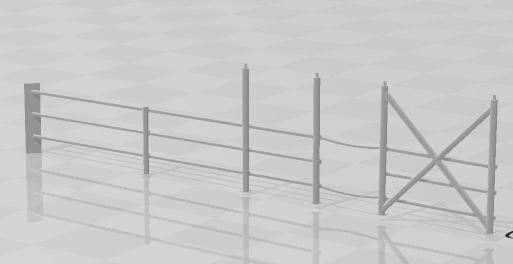

Today, after getting another run of my BB-55 restoration parts printed, I'll also reprint the main deck Hedgehog Deck X Bracing & Railings in a horizontal orientation as this seems to give much better results -
144 scaled DD566 Hedgehog Deck X Bracing & Railing.JPG [ 18.32 KiB | Viewed 712 times ]
Once again, this part has been eluding me as to getting a successful printing - I've had to alter size & height to what the model is, not the plans as they don't show true 3D depth and slight angling of posts or stanchions.

The Hedge Hog rail is geometrically challenging. I have such a rail to do for Alaska’s 56 mount and have been avoiding it. Sometimes I have taken card stock and made patterns to figure out the geometry of your forward deck support stancions or constructed them by piece work.
Lookin good! Tom

Tom,
Thanks! I'm guessing your last comment referred to the railing around the Hedgehog Launchers and not the forwardmost railing that goes around the deck where Mount 52 is located. Yes, this railing for the model has more to do with the model and not the plans as my 01 Level decking may/may not be 100% in alignment with those on the plans (although my intentions were to do just that!) and as such, the railing had to be modified a few times to fit. I'm hoping my current printed ones fit, but if not I will eliminate the shrinkage factor (Kastanza knows Shrinkage!!) to compensate for this.
The railings around Mount 52 are not a std set found on all (or many) of the modernized FLETCHER class DDs. STODDARD's was (once again) unique in that the stanchions were a bent & angled lot so that the railing still provided some protection, but did not interfere with the training of Mt. 52. Not a common piece of work; I wonder if this too was a ShipAlt by local yard engineers as opposed to a class modification. My guess would be a local ShipAlt at some point in her carreer.
Never a dull moment in the shipyard. :doh_1:
