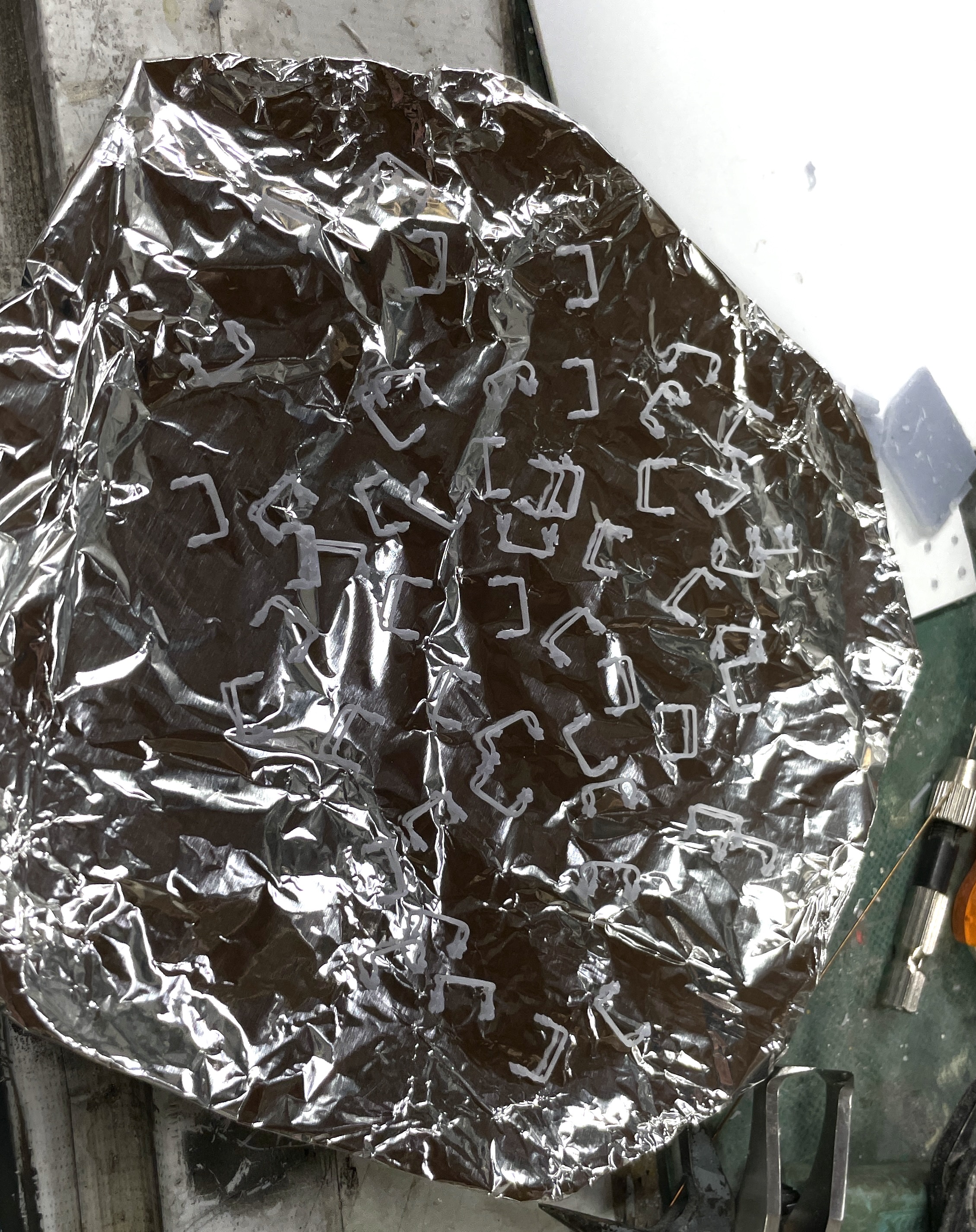

Spent a lot of time without much to show for it. Most of it was wrestling with the ladder rung prints, both in trying to separate them from the supports and backing piece, and then drilling out the jig to use when mounting them. They are too darn thin... scale, but thin. Removing them was quite painstaking and a bunch failed that had to be repaired with Bondic. There was another problem. I made some very tiny drawing errors that prevented the part from being structurally sound. One small face on the mounting lug was reversed and therefore, didn't print. This lead to the failure of the bolt head to print that was attached to this now-missing face. Also, the rung mounting point was weak and failed many times.
I stopped messing with it and went back to the drawing board, fixed that reversed face, increased the rung diamter by 30% ]and strengthened the mounting point. It's printing now and I'll get them tomorrow.
I aslo tried the drill jig idea and it worked. Only problem was some of the holes were into that chamfer area. I also changed this part too for the next print. I'm using a #57 drill, but a #56 would be better since I had to push too hard to get the lugs to seat and that leads to distortion and breakage.

Not sure what kind of printer/resin you're using but I've had similar issues printing parts that "seem" like there would be no problem and end up getting nothing as a result. Usually, the orientation and supports are what will need improving.
In the case of your access panels, I would have printed them upright (perhaps you did, you didn't specify) using Medium supports along the bottom edge in an even pattern. A Light support under the lower corner of your hand grab should have been sufficient for that. I have a tendency to over support items and then end up cutting stuff off that is not a support. Using lighter supports at the top of the part is a good idea also, as you have done.
I came up with a more or less "standard" hand rung design a year or so ago and have used it pretty much on all my newer parts where req'd. You simply scale it to the size you need and if there are issues printing, a very slight increase in diameter usually solves this problem. I am going to attempt 1/200 scale grabs to see if they will print and maybe add a support bar centered on the grab to align the parts and hold them in place for mounting. Your method of making a jig is very much like the PE plates that came with the Pontos Detail Up kit for the MISSOURI - I found them very hard at that size to properly align on the part, esp. the hull. I ended up using clear tape to hold the plate in place. A larger model such as your 1/48 gun mount shouldn't be that difficult to work with except perhaps on curved surfaces. You could draw up the pattern and print on paper which could then be taped in place for drilling your mounting holes.

I printed the more robust ladder rungs and I'm pleased with the result.
This shot was taken during the removal process. I've found that using the flush cut tweezers thing that MicroMark sells seems to work pretty well in snipping tiny supports. I also used a very sharp #11 blade. The blade only works on parts that ARE NOT post-cured.

And here they all are ready to go under the UV lights for post-curing. In their native state, they were too flexible to be useful. That flexiblility is imparted by the Siraya Tenacious flexible resin in the mix. The extra girth really added survivability to these delicate parts.
