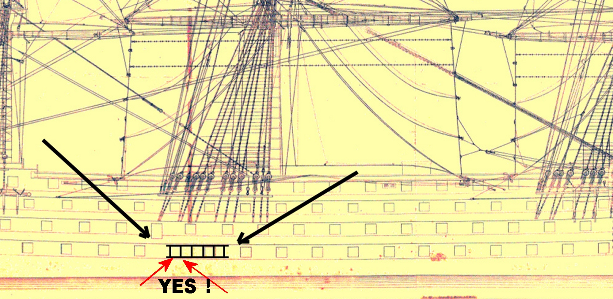

Fortunately there are some EXCELLENT plan resources on the internet-- giving reproductions of the original drawings, sail plan and deck layouts etc
I have the drawings at near full size... 15000 pix across
and now also and scaled to 1/700! == giving an ON-DECK length of 12 cm = 120 mm or 4.74 inches :big_grin:

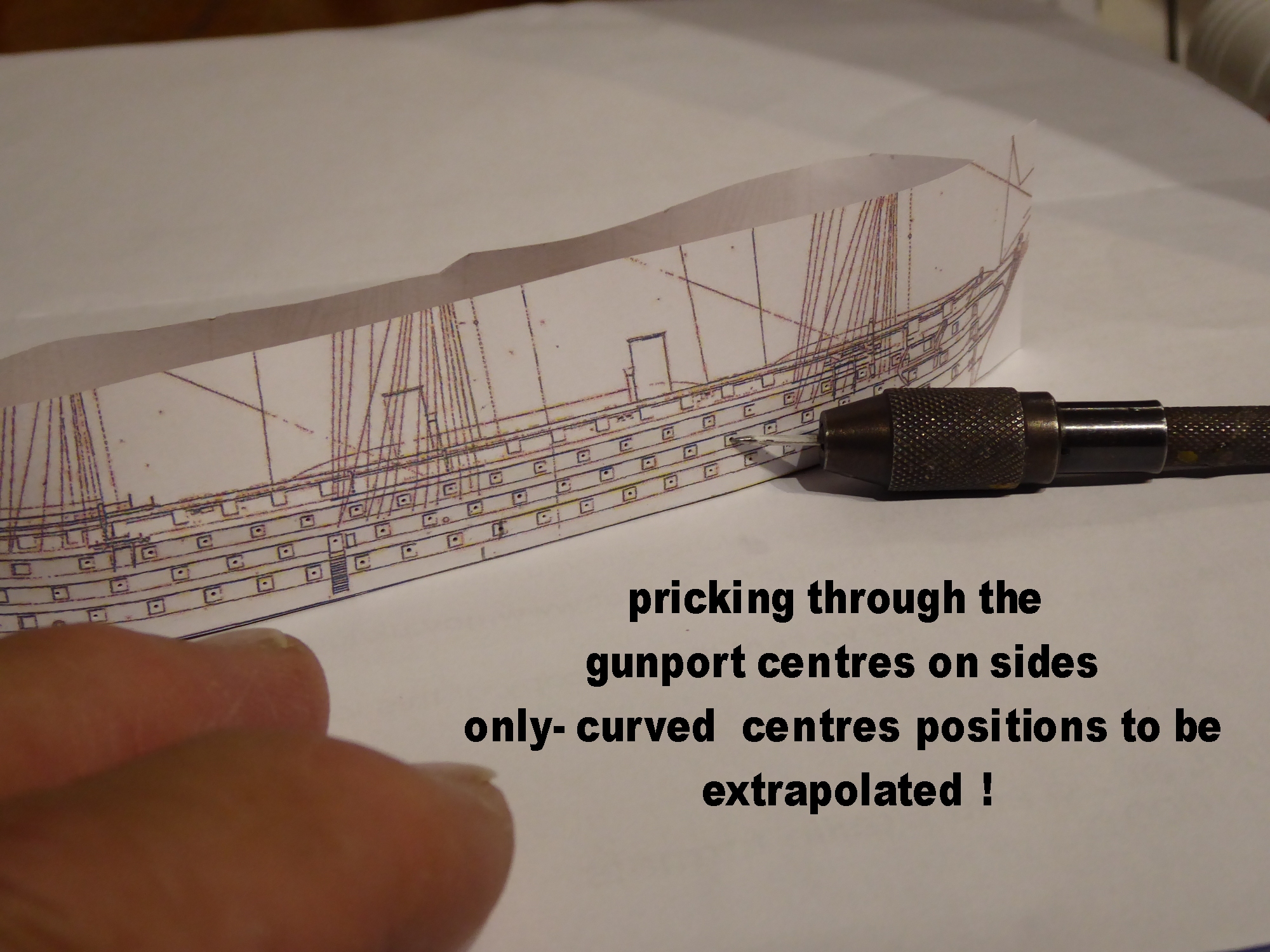

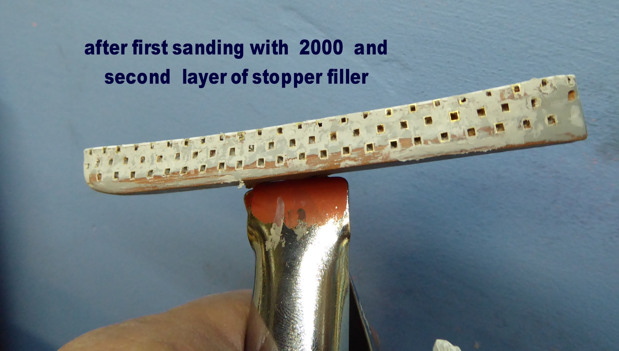

So my plan of construction is outlined below... please comment if you see a flaw in my thinking! :wave_1:
cut hull blank in Jarrah , fore and aft , sheerline to weather deck & waterline width only
Bretagne dimensions are given as WATERLINE length-- ergo
120 mm on deck( allow extra 0 .5 mm for additional sanding )
Sstick on ( Pritt!) printed scale side elevations ( as per plan and flipped)
Centre-mark/prick all the gunport centres on the ( near parallel ) sides
(but not yet extrapolate around the curves bow and stern! )

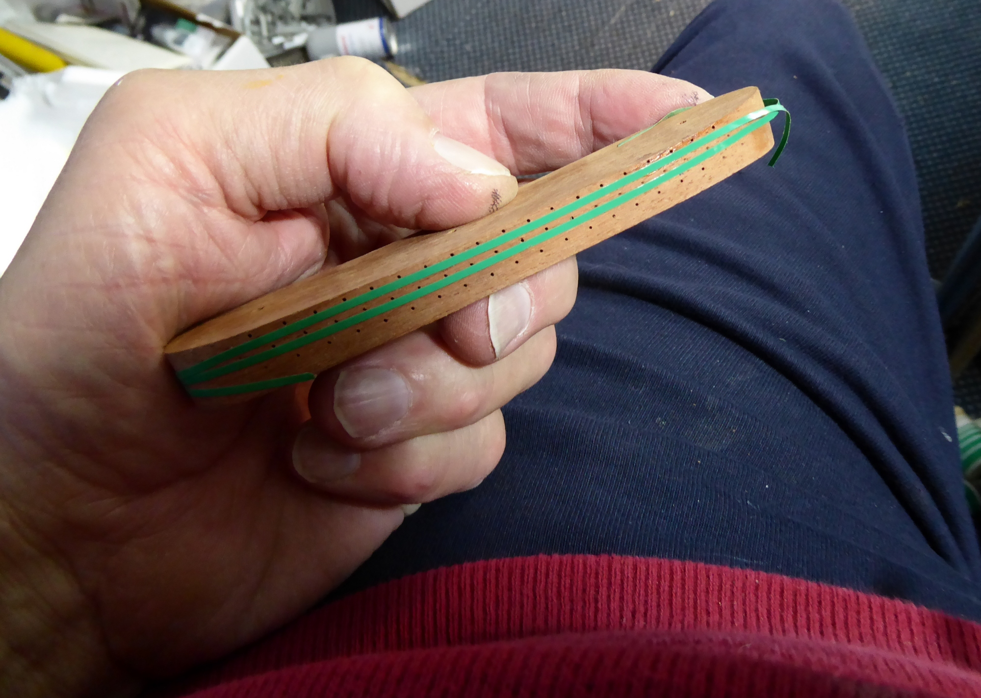

Drill through 5mm DEEP with a thin pilot drill. ( I bought a fine miniaturised Pillar drill
and adjustable machining table clamp to place the model under the drill ( more ) PRECISELY!
Create the tumble homed hull and undercut bow using negative athwart-ships templates
Form the bow and stern - and extrapolate the positions of the apertures fore and aft using photos and plans

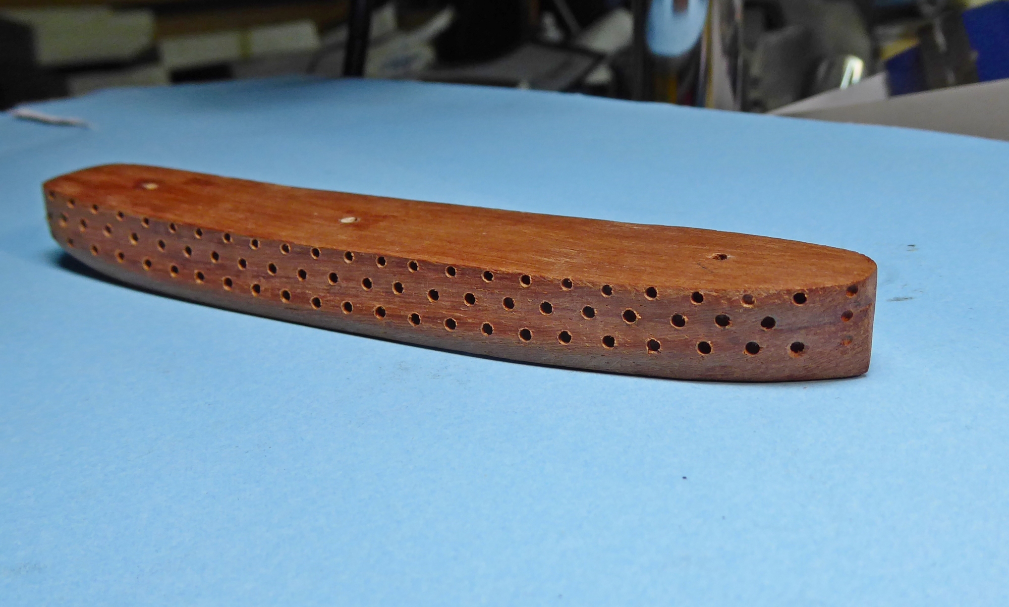

Drill open the small pilot holes to the diameter of the gunport OUTER frame sizes 1.5 mm deep
( each row is different size gunport! )

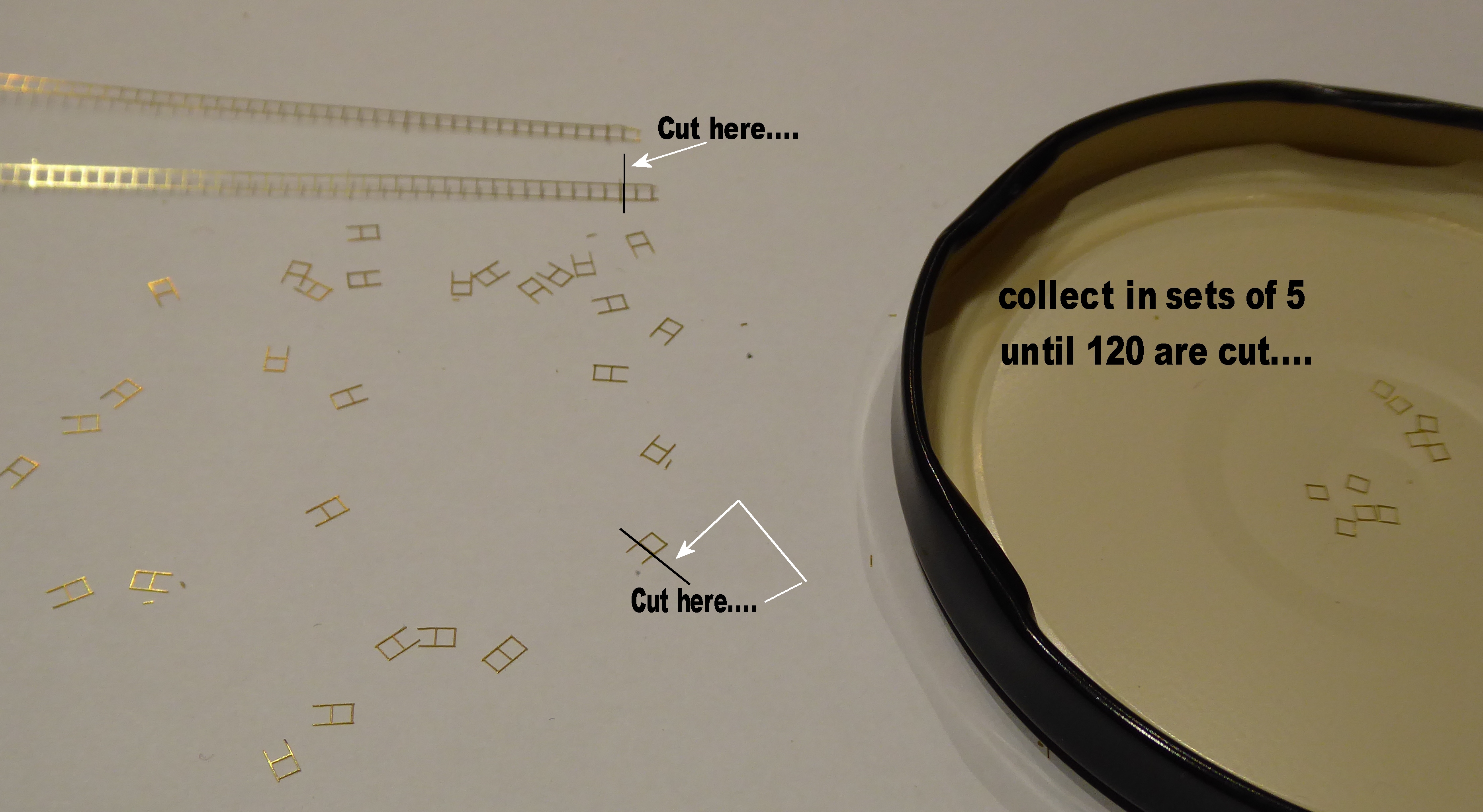

Cut and form square-ish corners with a No 11p scalpel -- insert brass squares cut from my huge stocks of
old-overscale-square-aperture-ladders PE glue in and secure with CA
( as done before on 1/700 Jeanne d'Arc--except this time it will be much better! )
Run automotive stopper ( ultrafine filler as used on classic cars! ) over the gunport rows
Fine-sand until the brass , wood and filler are uniformly smooth
Form decks, bulwarks , gratings , Fore and aft raised decks, hammock stores funnels, bridges, stern walks, masts, spars and sails
this should see me through to March.... :big_grin: :big_grin: :big_grin: :big_grin: :big_grin:

Note, the hull currently extends up the weather deck only, the installation of the tall bulwarks around the weather deck and the poop deck will change the appearance considerably!
I have been busy on the Hull of Bretagne... see the results below
@ Pieter @ WeFalck
What you guys said about the changing angle of incidence is absolutely true and correct!
However-- I only pricked the centres and drilled the ' locater ' holes down the near parallel sides; only
that way the deep pilot holes--relative to the sheer-line and deck-levels was correct,
==> regardless of how much of the hull sides was removed :thumbs_up_1:
( I checked the with green tape )
I subsequently shaped the plan profile, ( significantly narrower on the deck than waterline )
by taking the broad angle off on the beltsander ( crude-- but very fast! :big_grin: )

a light sanding and then white tape was applied below the pilot holes of all three rows of gunports and the
continuation lines thereof, allowing accurate marking off with dividers for the remaining pilot holes.
Then large enough drill bits ( different size for lower 2 x rows than the upper)
to cut holes big enough for the brass squares to be inserted
( This looks crude and brutal at the moment ) but the holes follow the lines sweetly!
The shape of the hull is hard to see in naked wood...
hence a helpful line superimposed on the photo...
The installation of the gunport brass square frames will follow shortly!

I tried out for size all the ladderstock-in various scales as well as some types of mesh grill and handrails etc that I could cut out
the required size squares for the gunport frames
I found some that were of use for the upper row as well as the weather deck
but nothing for the 2 lower rows...
Peter Hall of Atlantic models came up trumps from the 2 x lower rows of gunports...
1/600 Atlantic Models Liner rails-- single bar--
I now have 3 frets and 3 lengths of rail and I need around 120 plus to allow for mis-cuts, losses and mistakes....
my eyes are going square....
more soon
JB :wave_1:

The brass squares are tacked on with CA at the lower datum edges and the tuned for alignment.
Small blobs of white glue then locate the upper corners so that the
brass square cannot ' fall in ' . I then fill in between the blobs with CA gel
Ugly huh!!
But with the addition of the ' Stopper filler ' things look much improved :wave_1: :big_grin:
The sanding vindicates that the gun-port apertures
are level in plane to the surface of the hull sides
More sanding with 2000 and more filling
