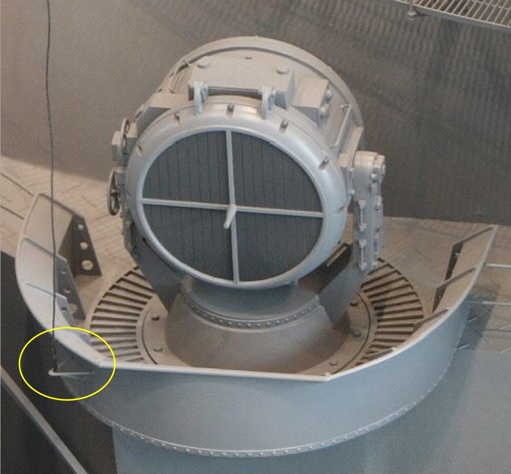

Kantana wrote:
In pic 06 you see that the 2 wirings are attached to the vertical bridge wall with a bottlescrew. The 2 bottlescrews are attached to a bracket. Please use your zoom.
From the bracket , you see the wirings going straight upwards , on the OUTside of the bridge wall, passing through a massive eyelet, aside the first window on the right and aside the second window on the left. Then both cables are going higher than the windows, through a similar solid steel eyelet where they bend over, inwards. From there , they go to the window edge were they disappear in the left and the right upper window corner.
Strange construction, you say ? I fully agree .
Maybe some expert can clarify , why the cables first make a loop UPwards before they disappear in the window corners ? I would have made the loop UNDER the windows , simply to prevent rain pouring from the cable –holes.
But I guess , for one or more obscure reasons, the cables should be placed like we all can see now .
OK. We know where the cables start . But where do they go ??
I am going to make a guess thinking that the 2 cables needed to be attached at that point to clear other structures around that area. They obviously were done as a retrofit to add additional equipment to the bridge, but it must have been too labor intensive to breach the wall to run cables through, so why not go through the corner of the window instead. Looping it over the windows prevents it from tearing away from the weight of the wire taking pressure off of the entry point. To me it looks jerry rigged (makeshifted), like running an extension cord up a wall and fasting it down in spots to keep it neat. I guess maybe they didn't have the right parts so someone was told to make it up as they go along, so that's just what they did! I notice maybe a little pipe was used to guide the wire in a specific direction to the window.

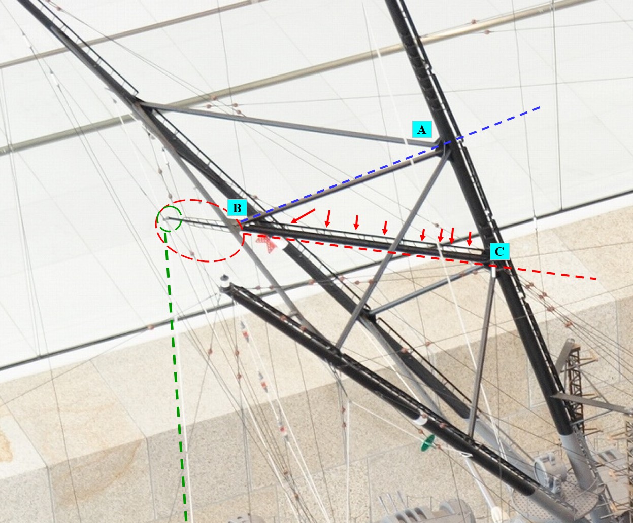

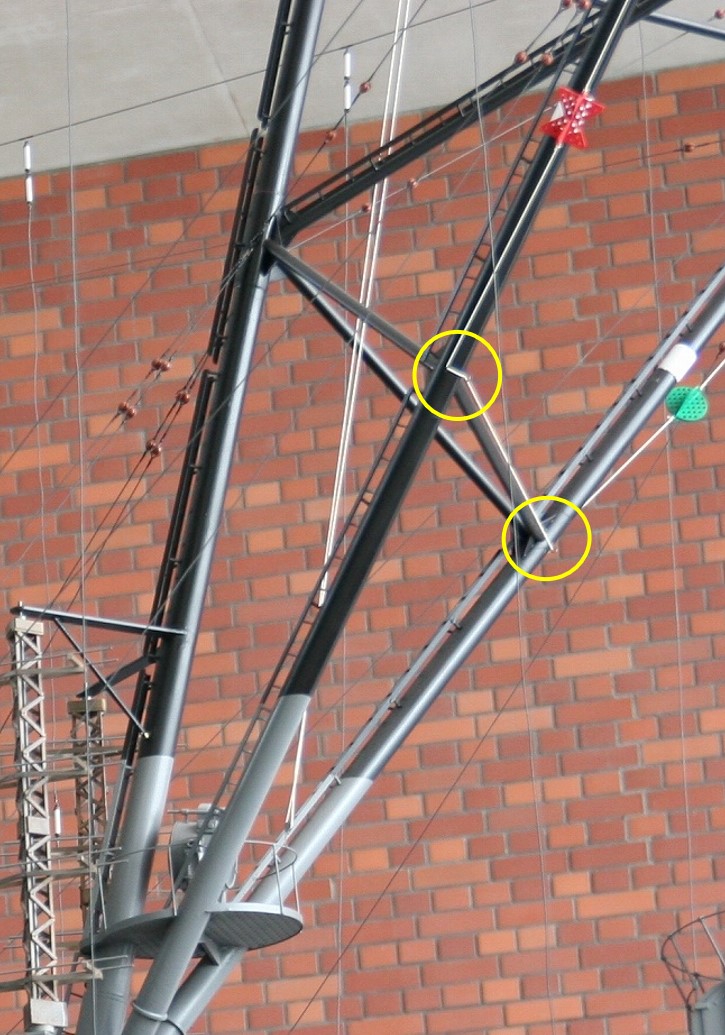

today we will talk about the 2 White Cords that are hanging under the port and starboard Main Yards.
The pictures.
Notice :
In previous rigging step (02.05. Rigging of the Signal Deck to the Main Yards and back) you have already seen plenty of pictures on these 2 White Cords, without knowing it.
Are you surprised ? You should be ! They don’t stand out because they are hanging between all the pulleys at the underside of the Main Yards. They get a little “lost” between all those pulleys , no ?
So it will not be a surprise that, beside several new pictures, I used some of the previous rigging step 02.05. Just because they are very suitable for this subject.
The White Cords.
These White cords are hanging over the full length of the 2 Main Yards, at their underside. See all Pictures.
Let Us just note that we are talking about White Cords. They are not cables. Cables are black and often they wear Insulators.
White Cords on Yamato never wear Insulators.
The Cords in this rigging step are attached to 4 Lug Rings, installed at the underside of the Main Yards. See Pic 001-002-003-004-005-006-007-008-009-010.
The Lug Rings & Rods.
From the 4 Lug Rings under each Main Yard, only the 3 outer ones (Nr 1-2-3) are installed on a solid metallic rod. See Pic 001-002-003-004-005-006-007-008-009-010.
Presumably this was done the avoid interference with the White Cords in all the pulleys.
The most Inner Lug Ring (Nr 4) is not installed on a rod. See green arrows in all pictures.
It is directly attached to the base-bottom of the searchlight platform where the Main Yard shape starts. See Pic 001-002-003-004-005-006.
All rods are pointing downwards but they are not equally spaced between each other. See Pic 001-002-003-004-005 for more detail.The distance between rod Nr 3 and Lug Ring Nr 4 is longer than between rod Nr 2 and Nr 3. See Pic 007-009-010.

katana wrote:
CHAPTER 02 - BRIDGE
Step 06- Rigging Cables on the underside of the Main Yards.
Description :
We are going to talk about the 2 cables that are hanging under the left and right Main Yards.
These 2 cables are placed on the underside of each Main Yard by means of 4 eyelets on top of 4 solid rods.
The rods are pointing downwards and they are not equally spaced between each other. See pic 01 for more detail.
The most INNER rods , right under the edge of the searchlight platform , have almost no length. It seems there is only an eyelet attached to the bottom of the searchlight platform without any rod.
I guess this is done to compensate the thickness of the searchlight platform versus the much thinner structure of the Main Yards at their end. See pic 01 , 02 & 03 for more detail.
The way the cables are hanging differs between the rods. Under each Main Yard , there are 4 attachment points and 3 fexions in this rigging step.
The first flex , between the most outer rod ( Nr1 ) and the next one( Nr 2) , is rather long and hangs at a certain distance from the Yard underside.
The second flex is between the 2nd rod and 3rd rod inwards , is shorter. The distance between the Yard underside and the cable is almost equal to the first flex.
But the third flex , between the 3rd and 4th rod , is different from the two previous ones : the cable shows almost NO flex : it looks like it is almost stretched between the 2 last eyelets. See pic 04 & 05 for more detail. Please note also that the distance between rod nr 3 and 4 seems to be longer than between rod nr 2 and 3.
Pic 06 gives you a clear view on the outer flex and in pic 07 and 08 you can see that the most outer rod is
installed OUTwards from the the first pulley that holds the flag line of the signal deck.
In fact , pic 01 is a total view : it shows:
a) The different distances between the rods
b) The different kind of fexions between the different rods
c) The position of the first rod (Nr 1) at the end of the Right Main Yard underside, left and next to the first pulley for the signal deck flag lines.
INSULATORS USED IN THIS RIGGING STEP :

See pic 02 . It shows the left side of the bridge , front view. You see MC Nr 1 above in this picture.
It leads to the outer tip of the Bridge LEFT Yard ( middle right position in the picture).
Take a closer look to the area in FRONT ( left upper corner) of the black illumination strip in the ceiling, in front of the bridge : MC Nr 1 features , in chronological order : 1 bifurcation downwards with a White Cylinder Insulator , followed by 1 brown ball insulator. Then you see : 1 bifurcation downwards with a White Cylinder Insulator , and finally : 1 White Cylinder Insulator, attached in line on MC Nr 1.
Notice 2 : The 2 White Cylindrical Insulators that are attached to this bifurcation downwards will be discussed later :
they are NO part of this rigging chapter and will be discussed in rigging step “MC Nr 1 & 4 split
to 155mmFront Antenna”.
The brown ball insulator between the 2 downward bifurcations is the LAST brown ball insulator of the series of 10. I here you thinking ……. WHERE exactly is that ?
Ref : Jan Skulski’s AOTS page 37 : this location is at length station Nr 111 or 112, above the back slope of the
Front 155mm Gun .

1. Mast Base Support : See Pic 001: Mast Assy Overview
The Mast Base is a tripod. The triangular shape formed by this tripod is located behind the Funnel. The FLAT side of the triangle is facing the bow side of the ship while the triangle-tip is facing the AFT ship (stern side). All 3 big support beams (420 mm diameter) are connected to the ships deck with 3 gigantic braces. See Pic 002: yellow circle
The rear base support beam is not inclined and goes vertically up to the unison sleeve. The 2 front support beams are tilted backwards and come together with the rear support under the unison sleeve. These 3 big beams together form the base support of the Mast Assembly.
2. The Unison Sleeve :
The 3 support beams come together at a height of +/- 7,00m and disappear under a triangular steel casing: the unison sleeve. See Pic 004: yellow circle
The contact area between the 3 supports is not visible because it is hidden under the unison sleeve outer skin.
The sleeve is a construction of metal sheet that surrounds completely the upper part of the 3 support legs and the Underside of the 3 Mast Arms.
It has 3 flat sides with 3 round corners, perfectly surrounding the structural shape of the round base tubes and it is closed at the top and at the bottom.
3. The 3 Mast Units “above” the unison sleeve.
ABOVE the unison sleeve, the Main Mast and the 2 Side Mast Arms rise upwards, forming (again) a tripod shape: the Main Mast at the front and the 2 Side Mast Arms to the aft sides.
One may think that the 3 upper masts will follow the same angle and centerline as the 3 base support legs underneath, but: No ! It’s not the case. Look at Pic 005: Rear view, Pic 006: Upper view & Pic 007: Side view.
In the side view, you see that the (front) Main Mast above the unison sleeve has the same angle (and centerline) as the 2 Front legs of the Base Support Unit under the sleeve.
But the 2 Side Mast Arms above the unison sleeve are tilted slightly backwards to an angle that has not the same centerline of the lower support legs. See pic 007 : The inclination of the the 2 Side Mast Arms above the sleeve is bigger than the angle of the 2 lower front beams, installed on the deck.
All 3 Mast-Units above the unison sleeve have a tapered shape towards their end. At the unison sleeve, the Main Mast beam has a diameter of 360mm and at the end it is only 210mm.
From the Main mast tip to the deck, it is 27meters long, (inclined position) from which 20 meters extend ABOVE the sleeve.
Both Side Mast Arms have a diameter of 220mm near the unison sleeve and at their tip they have a diameter of 160mm.

See Pic 015 Upper & Lower Junction Beams.
Blue line : Upper Junction Beam
Red line : Lower Junction Beam
Red Circle : the strange “ladder’with the Cylindrical Rod
Red arrows : ladder on Upper Junction Beam
Green line : white cord for Japanese Navy Ensign & Samurai Banner.
Green circle : Pulley for white Ensign & Banner cord.
Beside the 3 big Masts and the 2 Reinforcement Triangles we see on Yamato’s Mast Assy, 2 additional structure-components :
The Upper Junction beam (Blue line) connects the Upper Triangle tip at the Main Mast (A) with the front center of the Upper Triangle AFT Beam (B) via a big connection plate.
Remark: the 3 beams of the Upper triangle & the Upper Junction Beam are installed in the same horizontal plane.
See also pic 013(Blue line)
The Lower (inclined) junction beam connects the Lower Triangle tip at the Main Mast (C )with the Underside of the reinforcement plate(not visible in this picture), in the center of the Upper triangle AFT beam. (B )
What is also special on the lower junction beam : on its upper side there is a ladder installed. See Red arrows : ladder trajectory.
And on the location where the lower junction beam is attached to the Underside of the Upper Triangle aft beam(B ), the shape of the junction beam changes into a small diameter rod which extends in the same line as the lower the junction beam. See Red Circle.
Around the small diameter rod you see a sort of “ screen”. That screen is what I call : the “strange” ladder.
For God’s sake, why do they need a ladder, in THAT location ?
Very simple : at the end of the rod ( Pic 015: green circle ) you can see a small pulley hanging straight down, above the Aft Rangefinder. From the Aft Rangefinder platform, a white cord is coming up, running through the pulley and going back down.
And the white cord in that pully, is the line that carries the Imperial Japanese Navy Ensign & Samurai Banner.
See Pic 016:
Red circle : ladder
Blue circle : Pulley for white cord
Yellow line : white Ensign & Banner cord , hanging down to the Aft Range Finder Front Side ( stern side ship)
See also Pic 017 : schematic view with white cord holding the Japanese Navy Ensign & Samurai Banner.

See Pic 018 :
White arrow at mast tip (A): White Cord pulley at Mast tip.
White arrow at Searchlight Platform (B) : White Cord pulley attached to the Searchlight Platform Railing ( stern side).
Blue arrows : trajectory of White Flag Cord.
See Pic 019 :
Yellow arrow at mast tip (A) & Yellow circle : White Cord pulley at Mast tip.
See Pic 020 :
Big White arrow : Pulley at front railing of searchlight platform.
Green arrow : Pulley bracket at front railing of searchlight platform.
The Vice-Admirals White Flag Cord is a double white cord. It runs through a pulley on the back of the Main Mast -tip ( Pic 019 yellow circle) at the bottom of the Lower lantern on the aft side of the mast, downwards to the Searchlight Platform Railing. See Pic 020.
At the searchlight platform, The White Cord is contained in a pulley (Pic 020 white arrow) that is attached with a bracket to the SLPF railing (Pic 020 green arrow).

See Pic 034 : Lower Triangle Aft Beam.
Yellow circles : Lugs for White Cord, coming from both Triangles on the Side Mast Arms.

2.1. FRONT Searchlicht Platforms
See pic 005 - 006 - 008
Both Front Searchlight Platforms are located aside & at the front of the Funnel base and their floor is 1 level LOWER than the other Searchlight Platforms and also 1 level lower than the Funnel walkway…See Pic 005 -006
Detail: Both Front SLPF’s have only ONE rigging bracket. see pic 005 - 006 – 007 : yellow circles
The bracket is a triangular shaped rod, with 1 support rod in the middle, welded to the outer front (bow) side of the Platform Wall.
Via Branch Nr 1, Cable Nr 1 is attached to this bracket. See pic 001
MIRROR VIEW effect when talking about rigging .
On starboard side, the bracket is located at the Right side of the SL platform.
On the Port side, this bracket is located at the Left side of the SL platform.
But nevertheless that obvious difference : both times the bracket is located at the Bow-side of the platform wall.
THAT is what I call : the mirror-effect. See pic 005-006-007

See also Pic 011. Yellow circle = the Range Finder itself and blue circle is the cable-eye where Cable Nr 6 is attached.

Right next to the aft side of the Midship Aft Range Finders (stern side), we see a triple 23mm AAA Platform surrounded by its protection wall. At the front side (bow-side) of the wall there is a cable-eye installed just under the upper wall edge.
See Pic 001 : Via Branch Nr 5, Cable Nr 7 is attached to this cable-eye.
See also Pic 012. Yellow circle = the Aft AAA Platform and the blue circle is the cable-eye where Cable Nr 7 is attached.
