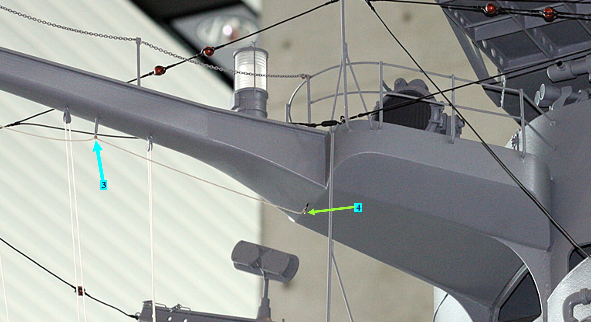

The Cords in this rigging step are attached to 4 Lug Rings, installed at the underside of the Main Yards. See Pic 001-002-003-004-005-006-007-008-009-010.
The Lug Rings & Rods.
From the 4 Lug Rings under each Main Yard, only the 3 outer ones (Nr 1-2-3) are installed on a solid metallic rod. See Pic 001-002-003-004-005-006-007-008-009-010.
Presumably this was done the avoid interference with the White Cords in all the pulleys.
The most Inner Lug Ring (Nr 4) is not installed on a rod. See green arrows in all pictures.
It is directly attached to the base-bottom of the searchlight platform where the Main Yard shape starts. See Pic 001-002-003-004-005-006.
All rods are pointing downwards but they are not equally spaced between each other. See Pic 001-002-003-004-005 for more detail.The distance between rod Nr 3 and Lug Ring Nr 4 is longer than between rod Nr 2 and Nr 3. See Pic 007-009-010.

Step 02.07. Rigging 2 Connecting Cables from the Main Yards to the Mid Yard.
Gentlemen ,
today we will talk about the Connecting Cables from the Main Yard tips to the Mid Yard Lug Ring
The pictures.
For convenience, the same colour code for arrows was used in all the pictures.
Blue arrows : Connecting Cable on Port side.
Green arrows : Connecting Cable on Starboard side.
Orange arrow : Connection of Port side Cable to Mid Yard Lug.
Pink arrow: Connection of Starboard side Cable to Mid Yard Lug.
Red arrow : Mid Yard Lug Ring.
White arrows : Main Yard Lugs, port & starboard side.
Black arrows : Main Cable Nr 1&4 Side Lugs.
Yellow ovals : Brown Ball Insulators on Connecting Cables.
Rigging Procedure: See all pictures
The port & starboard connecting cables depart from a Lug Ring at the base of the big lantern on the Main Yard tips. See Pic 003-004-005-006 and white arrows in Pic 001-002-003-004 -005-006 for detail.
Please note that none of these Lug -Rings make contact with the Main Cable 1&4 Lug Rings. The Main Cable Lug Rings are located at OUTER side of the Main Yard tips. See black arrows in Pic 001-002-003-004 -005-006 for detail. The black arrows were introduced to show that all Main Cable Lugs are maybe close near the Connecting Cable Lugs, but they do NOT connect. Main Cables and Connecting Cables have separate Lug Rings. See Pic 003-004-005-006.
The 2 connecting cables meet each other at the Mid Yard Lug,(Red arrow). Both cables are attached with their own loop (Orange and Pink arrow). See Pic 007-008 for detail.
In Pic 008 you can clearly see that the 2 connecting cables are attached with a loop to a small common ring. This small common ring is connected to the Mid Yard Lug Ring.( Red arrow)
The philosophy in this rigging step is :
Both connecting cables run from a Lug ring on the inner side of both Main Yards towards the Mid Yard Lug ring, to which both cable loops are connected with a smaller common ring.
Insulator count :
Each of the connecting cables contain 2 brown ball-insulators: one near the Mid-Yard tip (port and starboard side) and one near the Main Yard-tips (port and starboard side). See all pictures, yellow ovals.
But definitely check Pic 001: this is the only place on which you will find the 4 brown ball-insulators in 1 same picture. All the other pictures lack at least 1 insulator in their view.
Total amount of insulators used in this rigging step : qty = 4 brown ball-insulators.
This is the end of step 02.07. Rigging of 2 Connecting Cables from the Main Yard tips to the Mid Yard Lug Ring.
This is also the end of CHAPTER 02 - BRIDGE
Next Main Chapter : CHAPTER 03 - MIDSHIP
Next rigging step : 03.00. Mast Assembly Part 1.
Gentlemen,
have a nice day.

The White Cord, coming from the RRF Brackets and going up to the Side Mast Arms Triangles, comes down to the point were the Lower Triangle Aft Beam is connected to the Side Mast Arms. Then it follows a vertical trajectory down from the Side Mast Arms Triangles and when it arrives at the Lower Triangle Aft beam, it makes a horizontal turn of 90° and follows its way all over the back side of the Lower Triangle Aft Beam to the other Side Mast where it makes another turn of 90° upwards to the starboard Side Mast Triangle.
See Pic 035 : Blue arrows : Lugs for the White Cord on Aft Triangle beam ( only 3 are visible in this picture). Yellow line : Aft Lower Triangle Beam.
Remark : The reason why the White Cord can make a turn of 90° is because it passes through 2 Lugs : 1 Lug is installed on the Side Mast Arm while the other one is installed on the Aft Lower Triangle Beam with the Lug-holes 90° inclined from each other. The same procedure applies to the equivalent Lugs on the starboard side of the Side Mast Arm.

See Pic 001: Via Branch Nr 4, Cable Nr 6 is attached to this cable-eye.
See also Pic 011. Yellow circle = the Range Finder itself and blue circle is the cable-eye where Cable Nr 6 is attached.
4. Midship Aft AAA Platforms
Right next to the aft side of the Midship Aft Range Finders (stern side), we see a triple 23mm AAA Platform surrounded by its protection wall. At the front side (bow-side) of the wall there is a cable-eye installed just under the upper wall edge.
See Pic 001 : Via Branch Nr 5, Cable Nr 7 is attached to this cable-eye.
See also Pic 012. Yellow circle = the Aft AAA Platform and the blue circle is the cable-eye where Cable Nr 7 is attached.
5. Midship Aft AAA Platform Structure Support
The Mid Ship Aft AAA Platform Support is in fact a part of the Aft Ship and although it is really a metal structure with 3 windows, it literally supports the stern side of the Aft AAA Platform. Hence the name : Structure Support.
See Pic 001 : Via Branch Nr 6 , Cable Nr 8 is attached to the cable-eye of the AAA-platform support.
See also Pic 013. The yellow circle is the platform support structure and the red circle is the cable-eye at the stern side of the structure.
