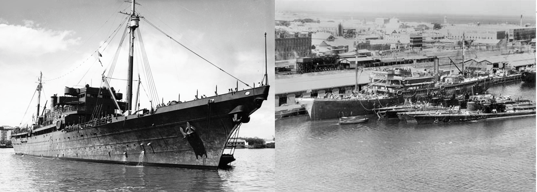

Old image acquired years ago--don't know the source--but relevant perhaps. Never been v. convinced myself about any wartime camo painting on STEWART, though.
