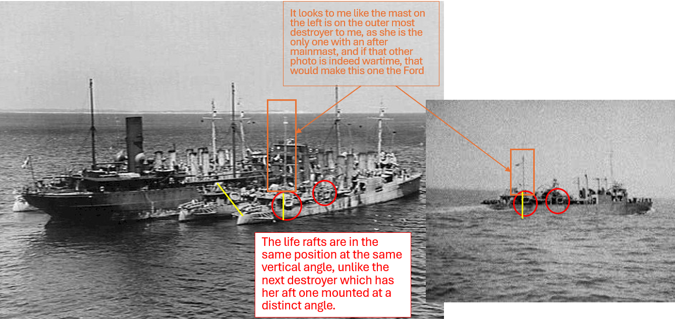

Lastly, do you think that ID on the Ford from the Kookaburra photo is correct? Because if it is, I think it IDs her in the photo of the four Java Sea survivors around the George G Henry, as the aft mast and life rafts seem to line up perfectly, where as they don't with the next in board destroyer. If the Kookaburra photo is indeed a wartime picture, then Ford is the outmost DD in that other photo. I think this would make her not the destroyer with the Black Hawk in that other photo as the Ford does not seem to have the platform and the ship next to the Black Hawk has it but no main mast, making it one of the other AF DDs.
Thanks again for all that info, and the photo of the other .50 cal position is exactly what I needed even if it is off of a lend lease DD!

From the inimitable Dan Mullin's book, ANOTHER SIX HUNDRED:
"There was on board [JOHN D. FORD], a spare 50 Cal. machine gun. Mullin had figured out a way to mount it on a 30 cal. Lewis gun mount and also mount two Lewis guns, side by side on a single stand...[with permission of their Gunnery Officer, LT Wm Mack]..."had worked to accomplish same while in Kupang Bay [Timor]. Some welding was necessary...The guns in their new mounts were functionable" (p. 115)
"...the makeshift, jury-rigged 50 cal. machine gun on the galley deck house joined in..." (p. 175)
So, those additions ought to be visible in any photos of JD FORD, I would think.

That good to know about the Ford and would definitely help identify her. I am always impressed by the ingenuity of the Asiatic fleet sailors. Unfortunately, I don't think either image has enough resolution in the deckhouse area to confirm if those ships have the said mounting. The image of her next to the George G Henry seems to come from a film, but I can't find it on the AWM and I've been digging for it there for a bit today. HMAS Kanimbla was operating off Java during this period, so in absence of other information, I would tentatively say its the Ford, but a better photo would be great.
