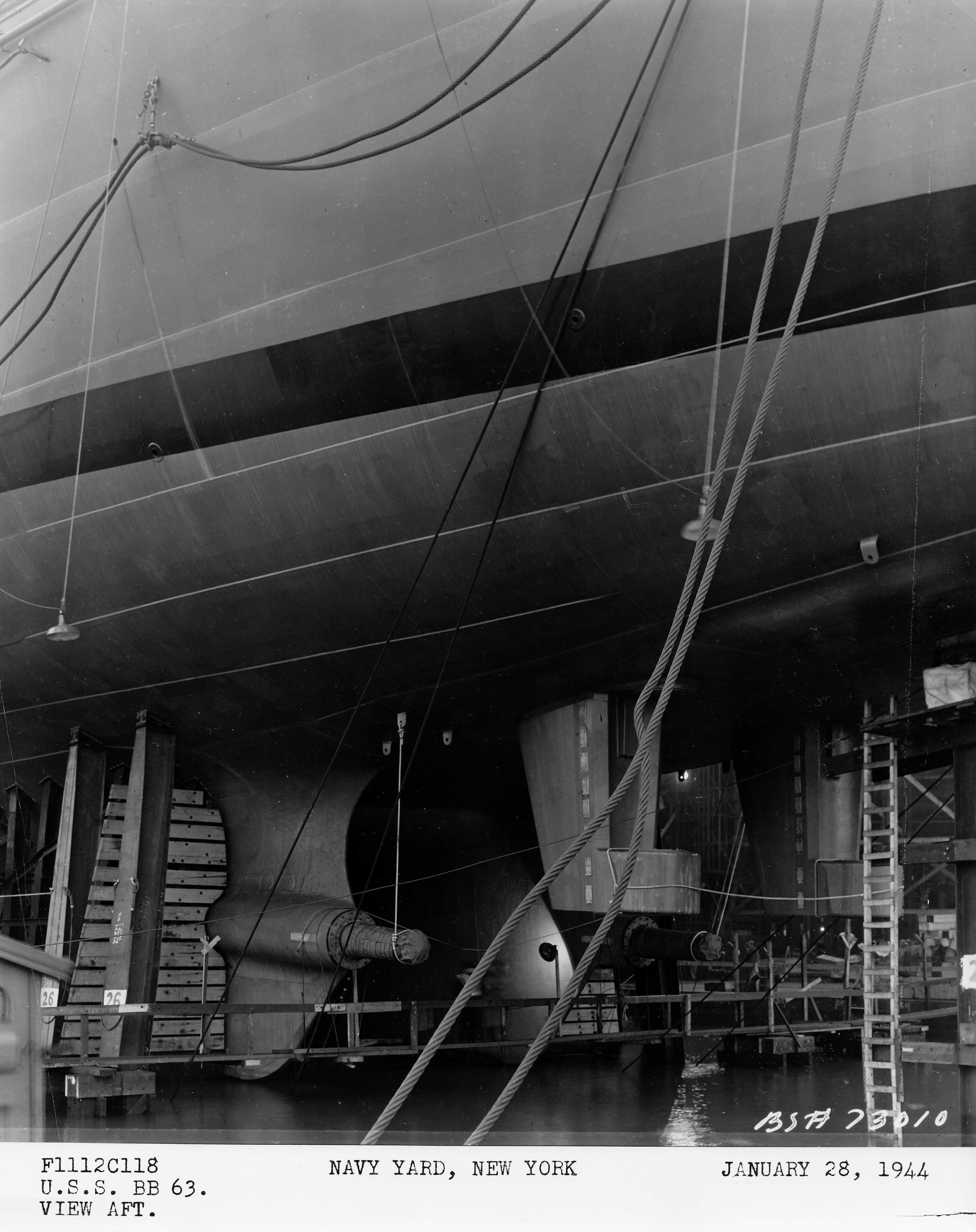

The small items are tie off points put there when the ship was built - here's a shot of MISSOURI under construction showing those same steel tie-offs -
See the small holes in the top of the rudders??? Those are used by Snipes at low tide for attaching tow ropes for water skiing - GM's would ride shotgun in the whaleboat behind and keep an eye out for sneaky snakes! :heh:
