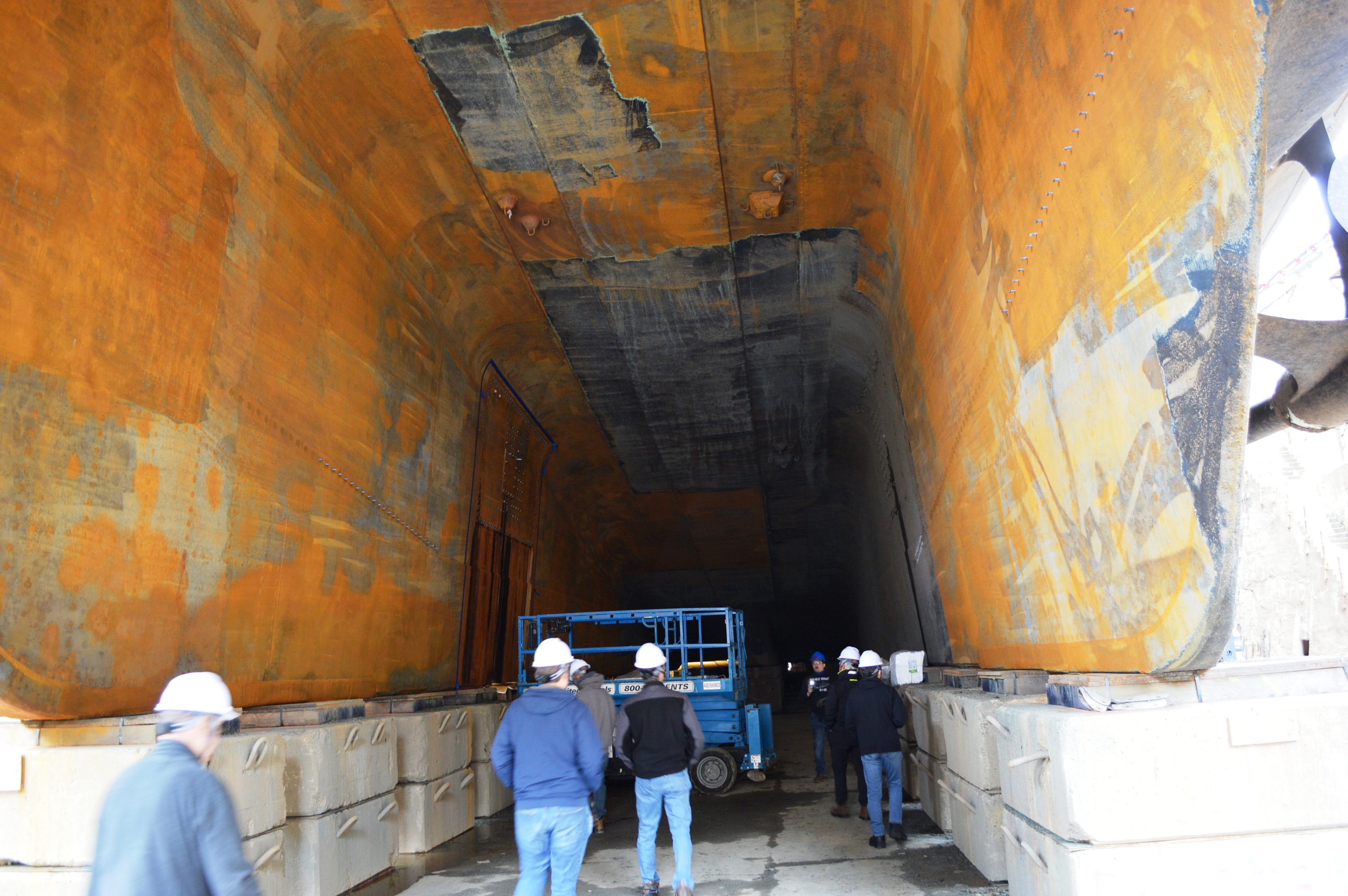

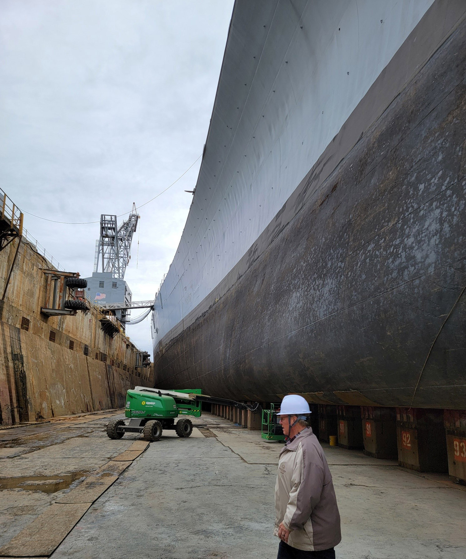

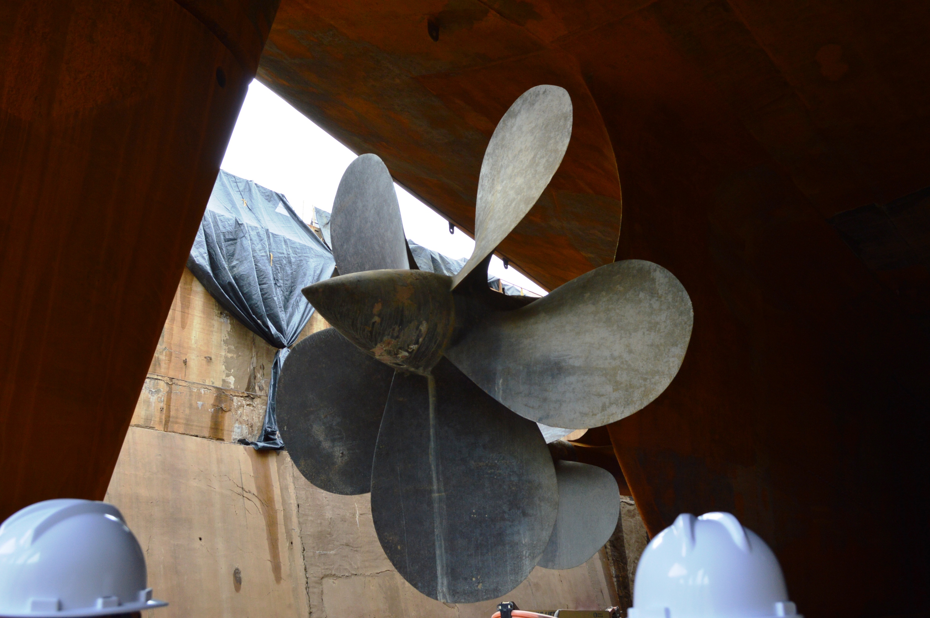

Drydock tour photos posted on the MW FB page. Here's a few of the photos:
If you can get to the Philadelphia Naval Yard, the tour is well worth it!

Thanks for sharing!! Great Photos! I'm glad you included a shot of the ever elusive Docking Keel - that obscure item that befuddles most modelers. :doh_1:

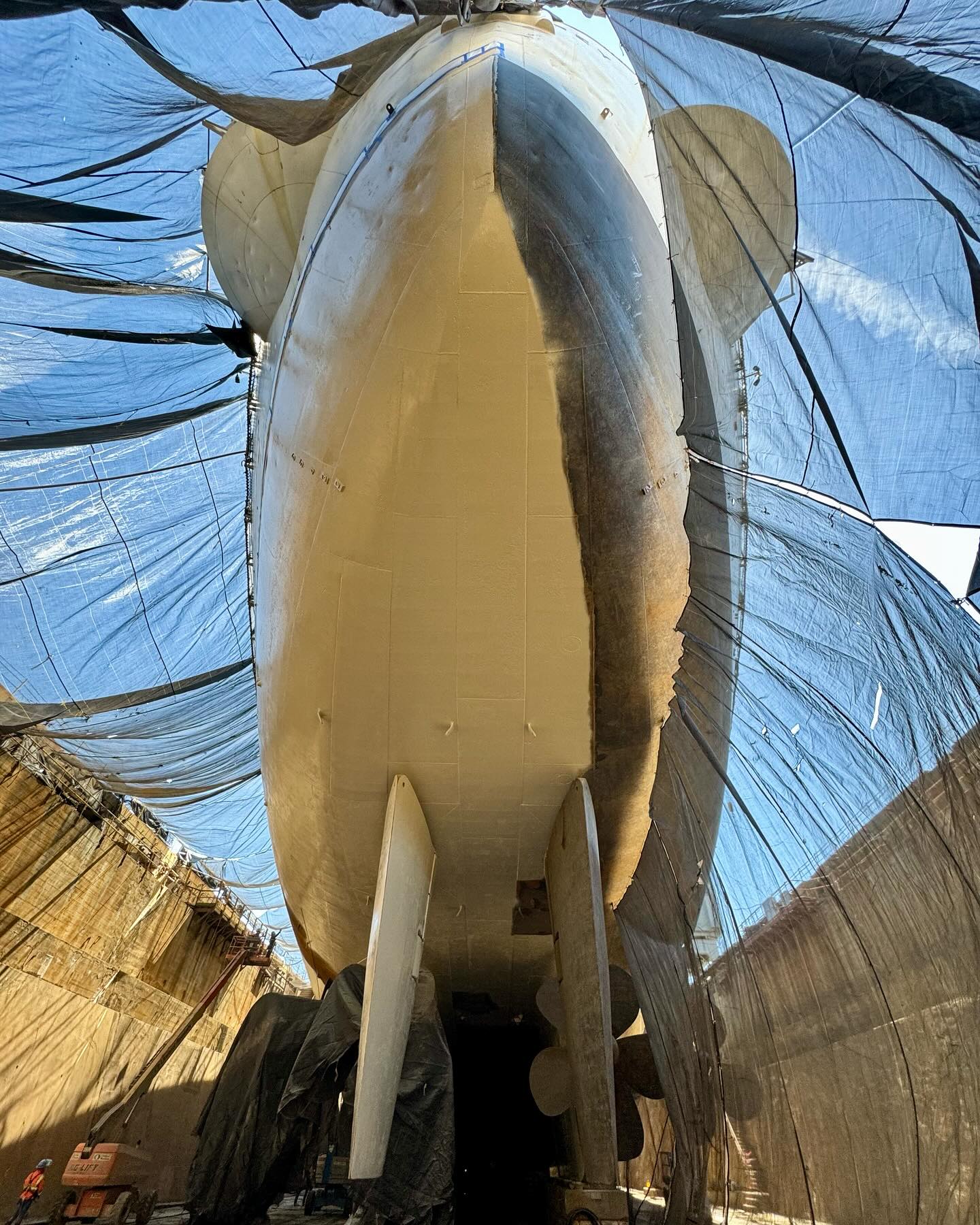

Here are the latest photos of NEW JERSEY's hull with the first new coatings being applied -
File comment: BB-62 stern with new bottom hull coating
File comment: BB-62 Stern with rudders after hull coating applied
File comment: Close up of port rudder with new hull coating applied
I'm sure that Ryan Syzmanski (curator) can better explain what this coating is and why it was chosen. Unless, of course, they got a deal on surplus M1 Abrams Tank Desert Tan from the U.S. Army paint depot..... :doh_1:

It's a primer coat. Each layer is a different color so that the painters can see where they missed. The last coat is anti-fouling red.
Oddly, there was no anti-fouling paint perviously. They had just taken the boot stripe all the way down so the bottom was black.

Prop shafts are covered with a four layer system that includes fiberglass as the final layer.
These coatings are best applied on a lathe in a machine shop, facilitated by the removal of the shafts.
They are designed to last 15 years, so may not be applied at every drydocking.
Anti Fouling and Anti Corrosion coatings are multiple layers as well and consist of grey, black and red coats.
The first coat you see above is very close to a light ghost grey. I've seen it in person. The photos are not showing the true color.
Everything you ever wanted to know about USN ship preservation is available in the following, (try everyspec.com)
NAVAL SHIPS’ TECHNICAL MANUAL, CHAPTER 631, PRESERVATION OF SHIPS IN SERVICE - GENERAL
MIL-STD-2199 COVERINGS FOR WATERBORNE MAIN PROPULSION SHAFTING ON U.S. NAVAL SURFACE SHIPS AND SUBMARINES

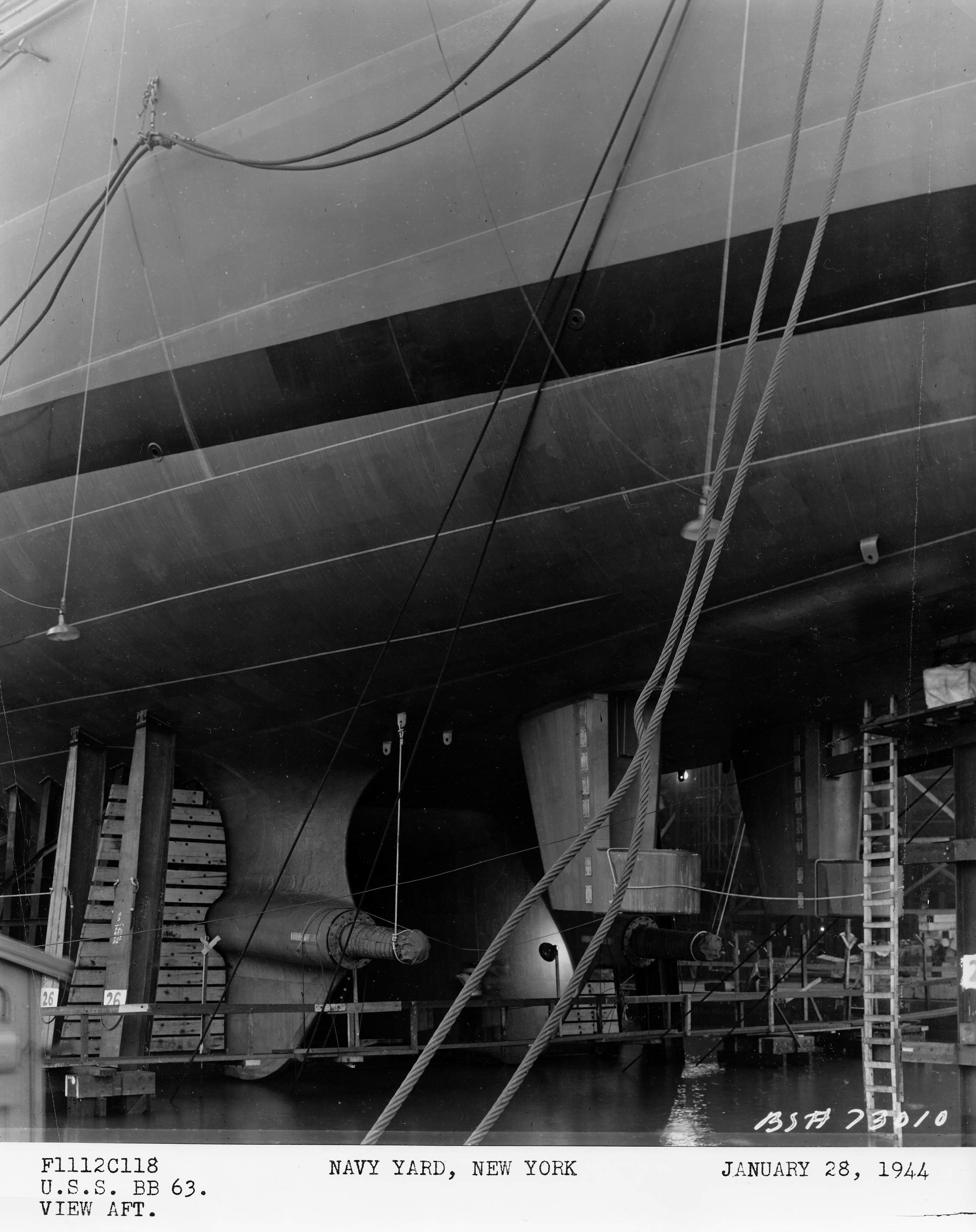

what are those small fin like things pointing down from the hull just forward & back of the rudders?

The small items are tie off points put there when the ship was built - here's a shot of MISSOURI under construction showing those same steel tie-offs -
See the small holes in the top of the rudders??? Those are used by Snipes at low tide for attaching tow ropes for water skiing - GM's would ride shotgun in the whaleboat behind and keep an eye out for sneaky snakes! :heh:

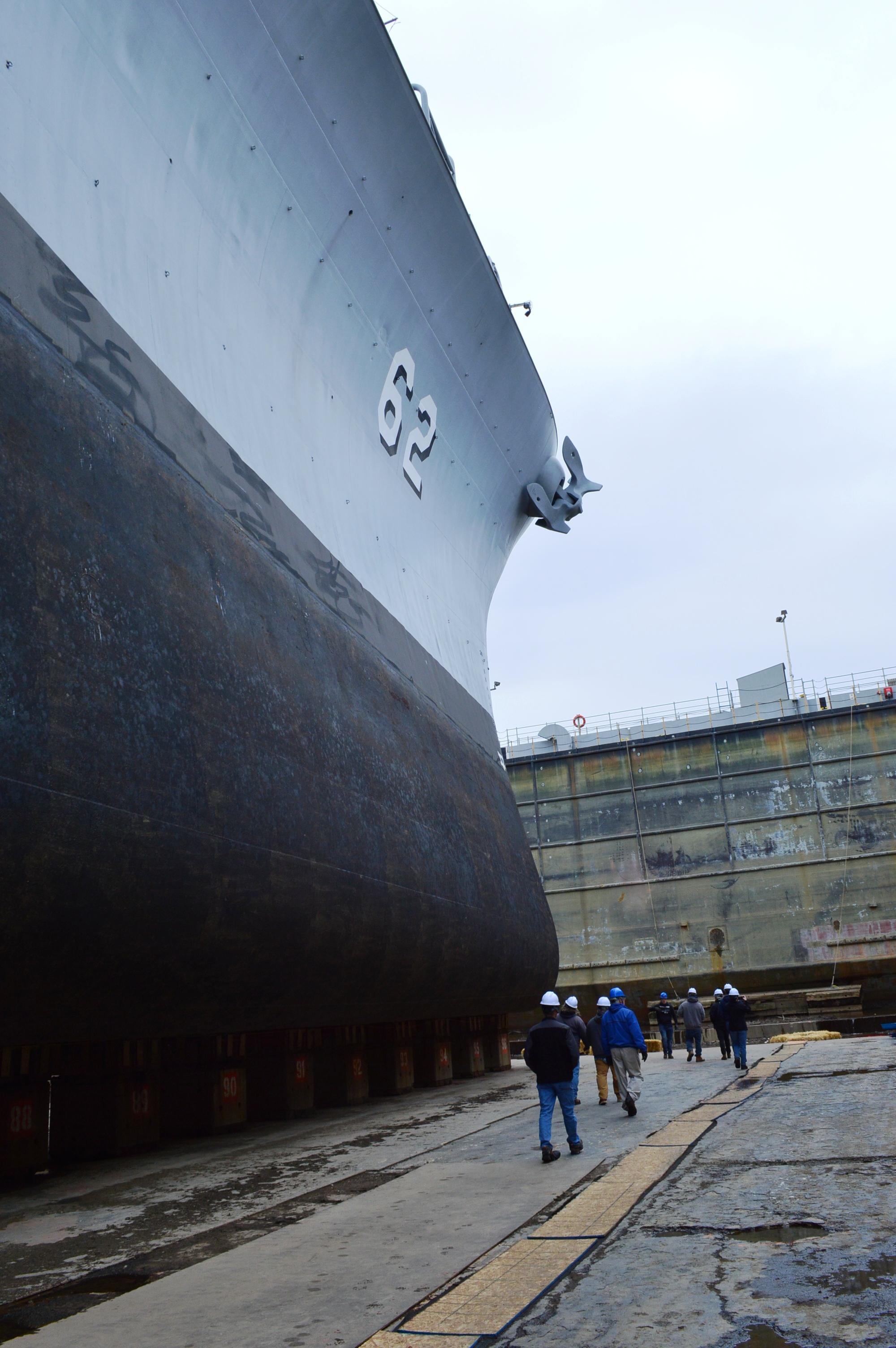

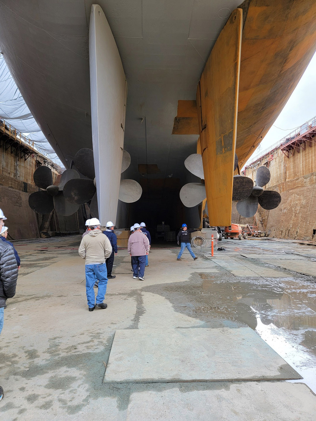

I found the visit well worth it. Certainly unique. The ship is in surprisingly good shape, and the work is proceeding quickly. If I understood our guide ( a very knowledgeable member of the museum staff) correctly, the boot line is being lowered 5 feet to reflect her current, lighter displacement.
It's not easy balancing a 45,000 ton on one's forefinger. Took some practice.
