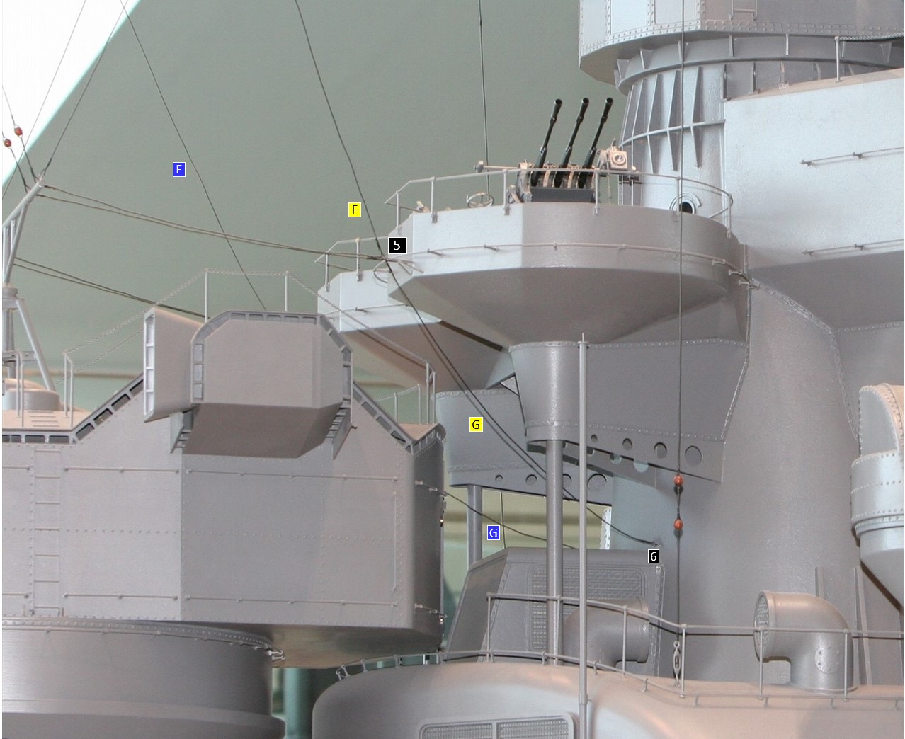

CHAPTER 05. AFT SHIP
Step 05.04. Rigging Loose Cable from AAA platform bracket Nr 5 to Structure Wall Lug Ring Nr 6
Gentlemen,
Today we will talk about about the 2 single, loose cables that run from the port and starboard AAA platform Brackets Nr 5 to Lug Ring Nr 6 that is attached to the vertical structure wall under each AAA Platform.
Take a look at the pictures : they give you details from different angles.
Pic 001: this is the schematic drawing used in all previous rigging steps of the Aft Ship. For this rigging step the next items are of interest : Cable “F”&”G” , bracket Nr 5 and lug Ring Nr 6. All on port and on starboard side.
Pic 002: Is a Port Side detail view of the loose wire trajectory from Bracket Nr 5 to the ring Lug Nr 6, in the structure wall, under the port and starboard AAA platforms.
Pic 003: Starboard side view with detail of the starboard trajectory of the loose cable.
Pic 004: General starboard view that gives you a good idea about dimensions and proportions of the cables and AAA platforms.
Pic 005: Angle-view with starboard detail of the loose cable.
Pic 006: Port side view with detail of the loose cable trajectory.
Pic 007: Close -up of the starboard loose cable.
Pic 008: Port side view with detail of the loose cable trajectory
Pic 009: Starboard side view with detail of the starboard trajectory of the loose cable.
Rigging procedure
This rigging step will be a simple one.
On both Brackets nr 5, cable “G” is attached and from there it goes under the port and starboard platforms where it is attached with a Lug Ring Nr 6 to a ring on the vertical structure wall.
The lug ring is located quite high above a vent. See Pic 007 for detail and the other pictures for general view.
Although Cable “F”, coming from the Side Mast tips is present on all pictures I would like to note that Cable “G” is certainly not an extension from Cable “F”. Bracket Nr 5 is the end station of Cable “F” and also the place where the new Cable “G” starts.
This chapter received its name because the 2 cables in this rigging step are really hanging “ loose”.
When you observe these cables you will see that they are not attached to any other station on the aft ship and they have no insulators installed. One may wonder what the added value is to install a short, loose cable without insulators and which makes no contact with any other rigging device.
Another subject for the long list of Yamato’s rigging mysteries….
Insulator Count
All the pictures show you clearly that in this rigging step, no insulators are used.
This is the end of step 05.04. Rigging LOOSE Cable from AAA platform bracket to lug in Structure Wall

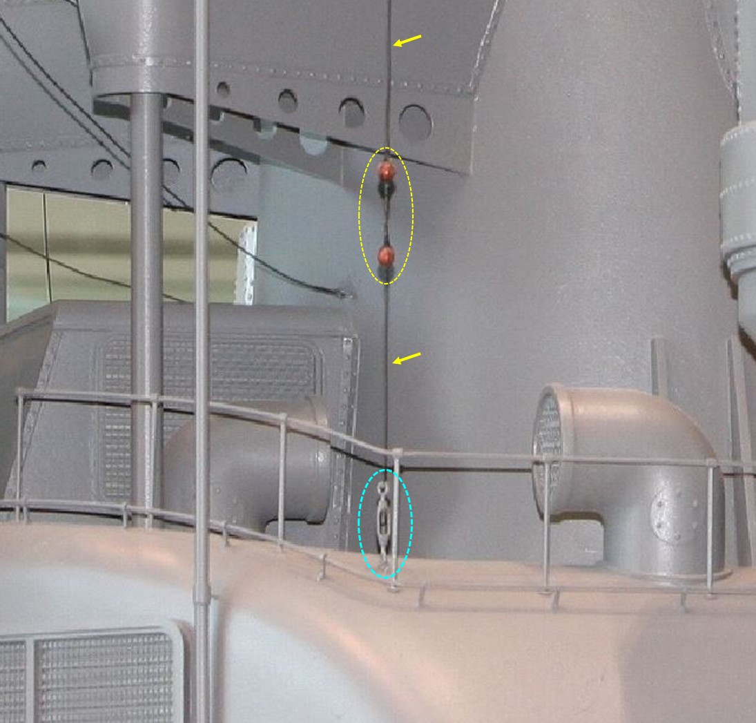

Step 05.05. Rigging Cable from Side Mast tips to Second Level Deck
Gentlemen,
Today we will talk about Cable”C” that comes down from the port and starboard Side Mast tip Lugs Nr 0 to the attachment Lug Nr 7 on the second level deck of the Aft-Ship.
Let’s take a look at the pictures :
Pic 001 : this is the schematic drawing used in all the rigging steps of the Aft Ship. In this step, the next items are of interest : Startpoint Nr 0 at the Side Mast tip Lugs, Cable “C” and lug Ring Nr 7 on the second level Deck. All on port and on starboard side.
Pic 002 : this is a general overview of starboard Cable “C”( yellow arrows), from startpoint Nr 0 ( blue arrow) at the Side Mast tip Lug, almost vertically down to the second level Deck, where it’s attached to Lug Ring Nr 6 ( light blue oval) with a bottlescrew. Also note the 2 black ovals near the Side Mast Tips and near the second level Deck. They each contain 2 Brown Ball Insulators that are installed on Cable “C”.
Pic 003 : Detail picture of Cable “C” where it arrives on the second level deck. Please note the detail of the bottlescrew and the 2 Brown Ball Insulators.
Pic 004 : View of the same area on Port side.
Pic 005 : general overview on starboard side of a big part of the rigging cables of the Aft Ship. Not only Cable “C” with the Bottlescrew and Insulators is visible but also the 155mm Gun antenna Brackets with all their incoming cables, the connection cables to the AAA Front Brackets and the “Loose Cable G “ that ends on the vertical wall under the starboard AAA platform.
Pic 006 : Detail view of the same area. Please note the location of the 2 Brown Ball Insulators and the Bottlescrew that is attached to Lug Ring Nr 2 on the second level Deck.
Rigging procedure .
Let’s start. Take Pic 002 as a reference.
At startpoint Nr 0, Cable “C” departs from the 2 Side Mast tip Lugs. A little bit further on the cable, we meet 2 Brown Ball Insulators. From there, cable “C” proceeds towards the second level Deck. Before it arrives there, we meet another 2 Brown Ball Insulators. Little after the Insulators, Cable “C” is attached with a Bottlescrew to the Lug Ring on the second level Deck.
Details of the Starboard Bottlescrew and the Lower Brown Ball Insulators are emphasized in Pic 003.
Insulator Count
In Pic 002, you notice there are qty = 4 Brown Ball Insulators installed on the starboard Cable “C”.
This means that on the Port Side Cable C there are also qty = 4 Brown Ball Insulators installed.
Total of insulators used in this rigging step : qty = 8 Brown Ball Insulators.
