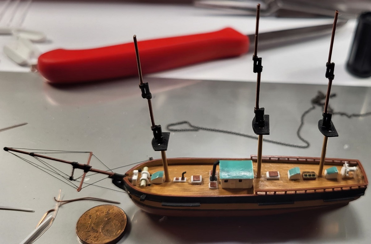

PostPosted: Fri Feb 21, 2025 8:18 am
Posts: 1125
the lines are made of 0.1mm Cu, I decided to use Cu and not stretched sprue to give extra strenght
PostPosted: Sat Feb 22, 2025 4:19 am
Posts: 2432
Looks good, however, for future reference I'd recommend Fly-tying thread for fly fishing (different thicknesses) . They are thinner than the copper, but more importantly, easier to get tight.
I once used copper wire for mooring lines and you always seem to get some twist/bend in it. It's never 100% straight.
After using fly tying thread for bottle builds, I regret not using it for those mooring lines.
Difficult to see, but the crane wire on this one is done with fly tying thread.
In any case, a remarkable and unique build. Where did you find plans or drawings of the old Savannah?

PostPosted: Sat Feb 22, 2025 4:44 am
Posts: 1125
yes, true Cu wire is always difficult to straiten, but in this case I used it to give extra strenght to the bowsprite making it a little more stabile on its own and also for futur wiring to masts.
