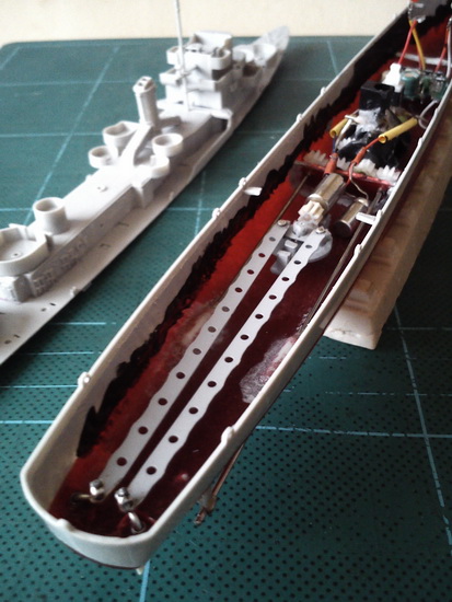

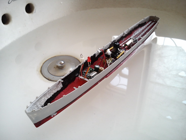

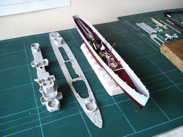

This's part 1 of 2, I've built it in part 1 assembly until this ship model can be buoyancy test in water & stable.
In part 2 about install all small parts & PE, painting my friend mr. Pek from modelivery.com (Thailand) he'll be do it later.

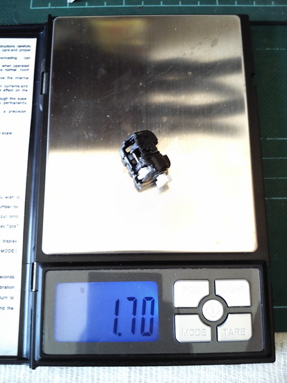

A Diet hull
A1 Check raw weight (6 pics)

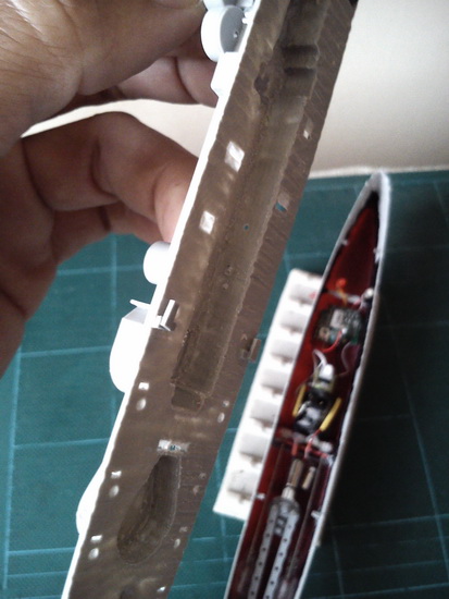

A Diet hull
A3 Shafts install (20 pics.)

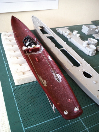

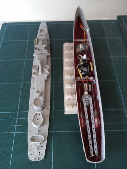

F Hull assembly (20 pics.)

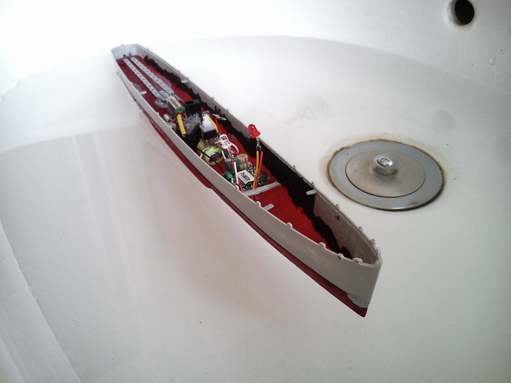

G Buoyancy test (8 pics.)

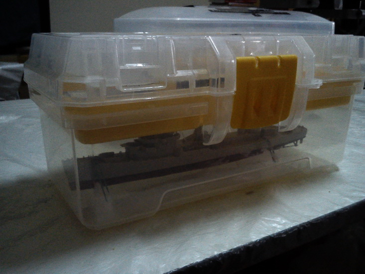

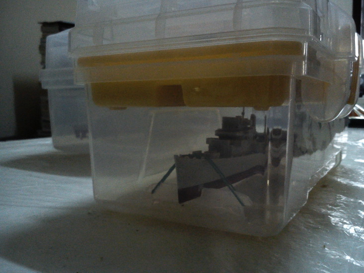

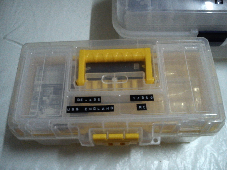

H Ship in the toolbox (9 pics.)

I see that you have carefully weighed all the parts. For such small models the top weight of the thicker plastic components tends to give a lot of top weight and have poor stability in the water. Have you had any trouble with this?
Cheers! Tom
