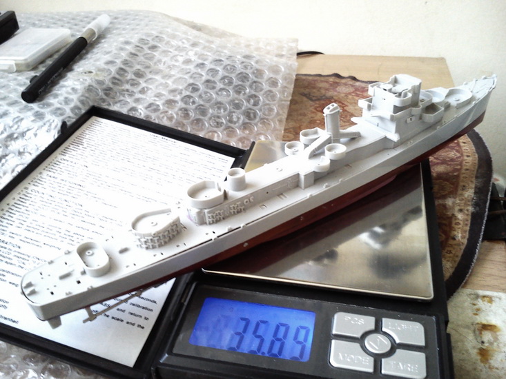

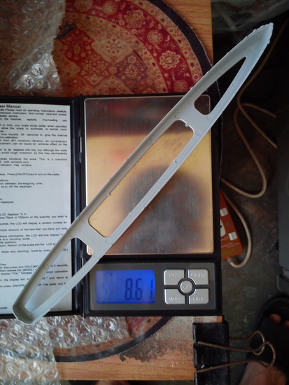

Hello all,
This's part 1 of 2, I've built it in part 1 assembly until this ship model can be buoyancy test in water & stable.
In part 2 about install all small parts & PE, painting my friend mr. Pek from modelivery.com (Thailand) he'll be do it later.
And last step we'll be fix the propellers & trial in water that'll be post pics again, hope you like it, enjoy. :big_grin:
Thanks
mws (modifyworkshop)
Part 1
A Diet hull
B Diet deck&superstructure
C Accessories
D Rudders
E Propellers
F Hull assembly
G Buoyancy test
H Ship in the toolbox
I Acc testing in mp4
File comment: Part 1
A Diet hull
A1 Check raw weight (6 pics)

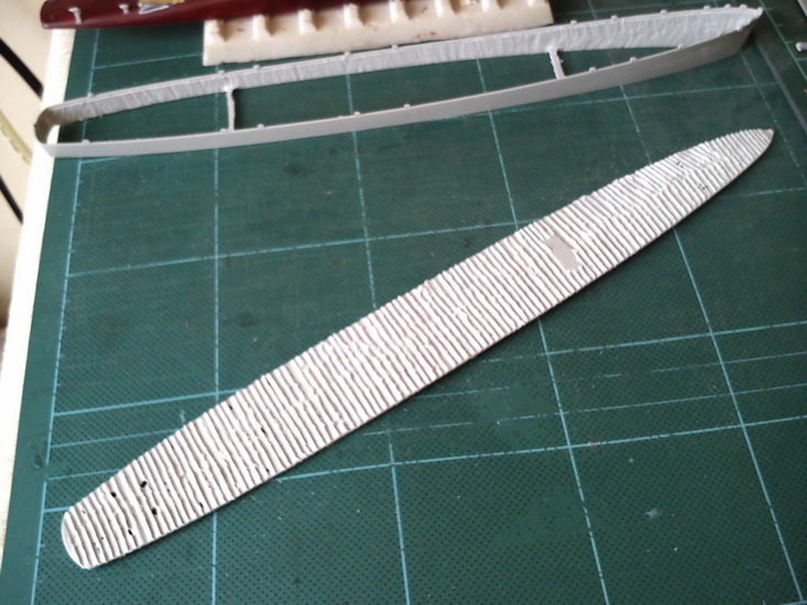

A Diet hull
A2 Diet process (10 pics)

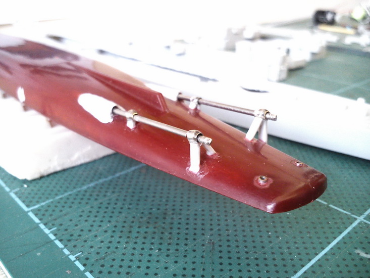

A Diet hull
A3 Shafts install (20 pics.)
