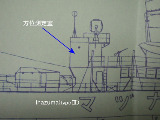

Was it the same on other Japanese destroyers, or did they have single 13.2 guns?
Assuming that I understand your question correctly -
At the outset of the war, only the classes prior to the Fubukis carried any single 13.2mm guns, IIRC. The exception was the Type III Fubukis; they had two single 13mm guns mounted midships, on either side of the deckhouse, inbetween #2 funnel and the RDF/searchlight compartment.
During the war, there were undoubtedly many adhoc instances of DDs carrying single 7.7mm or 13.2mm guns. For instance, there is that well-known photo of Shirayuki at the Bismarck Sea with a 13mm atop a TT mount, surrounded by sandbags.
Shirayuki also shows that many of the Type Is were modified either immediately pre-war or early on to carry two twin 13mm mounts on a revised platform in front of #1 funnel.
Late in the war, destroyers across all classes could carry a mix of 13.2mm and 25mm single mounts.

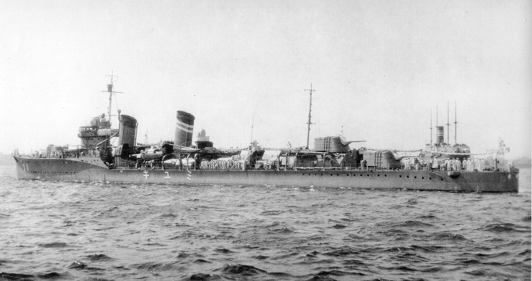

Posts: 9063
Re: Calling all IJN Fubuki-class (吹雪) fans
Post by Dan K »
Ah. Well, the IJN installed single 40mm mounts (Vickers design) on the Hatsuharu, Shiratsuyu, and some Asashio class ships as built. Almost all were replaced by wartime, though some ships retained theirs for a few months into the war. Those were all replaced by 25mm twins.
Confused yet, Mike? :smallsmile:

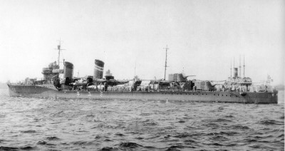

Posts: 9063
Post by Dan K »
This is an FYI - In researching roll-off depth charge racks at the stern for the Kagero class, I realized that the FineMolds kits for the late war Ushio and Akebono are in error. The kits retain the original tracks for dropping mines, and then later, single depth charges when, in fact, there should be roll-off depth charge racks in their place.
There are aftermarket d-c rack sets available. Rainbow comes to mind for one.

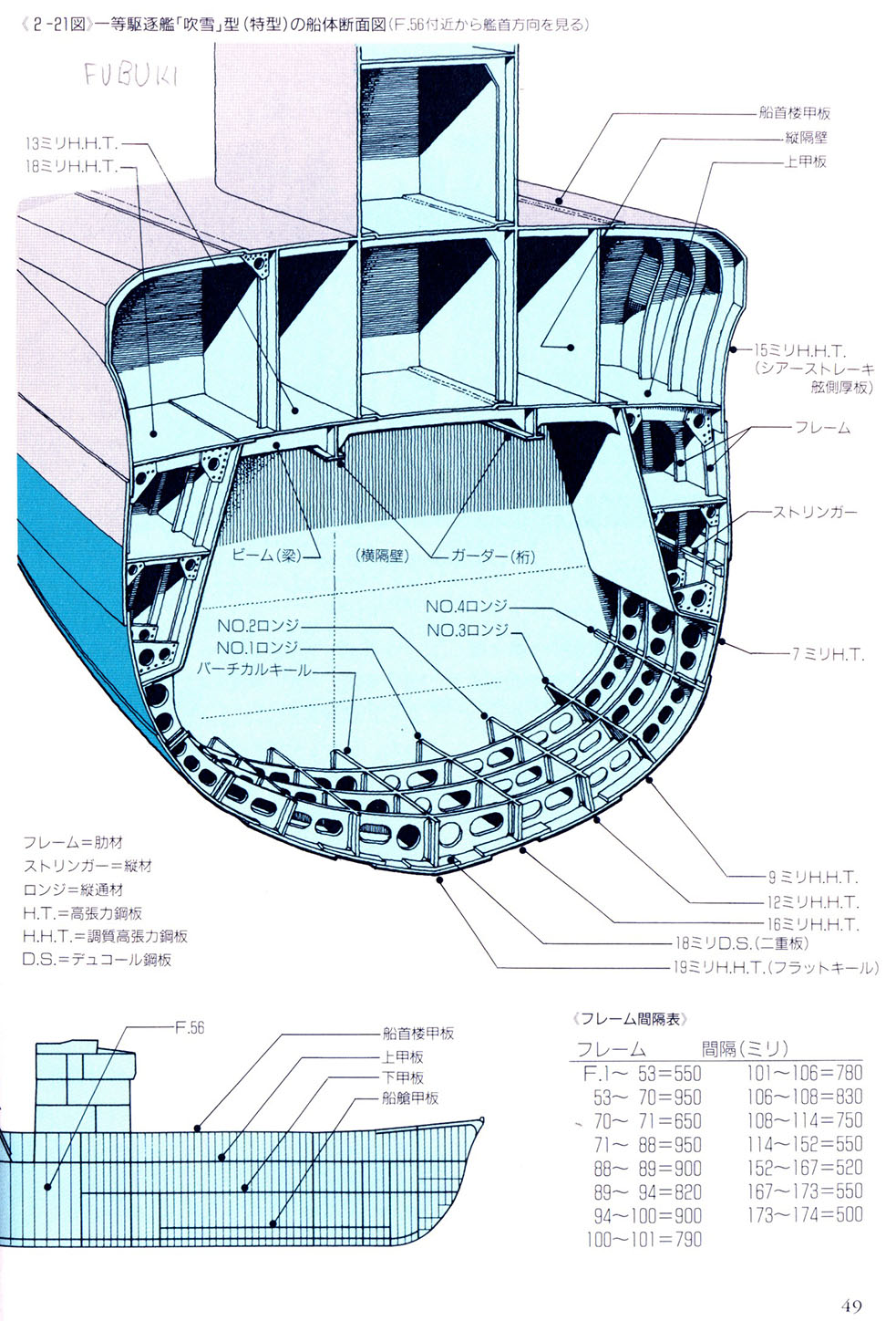

Posts: 9063
Post by Dan K »
The overscale plating is highly annoying, but perhaps not reason enough to avoid the kit. Particularly if it's as nice as the Mutsuki kit. Obviously, the plating will be less pronounced in the waterline version.

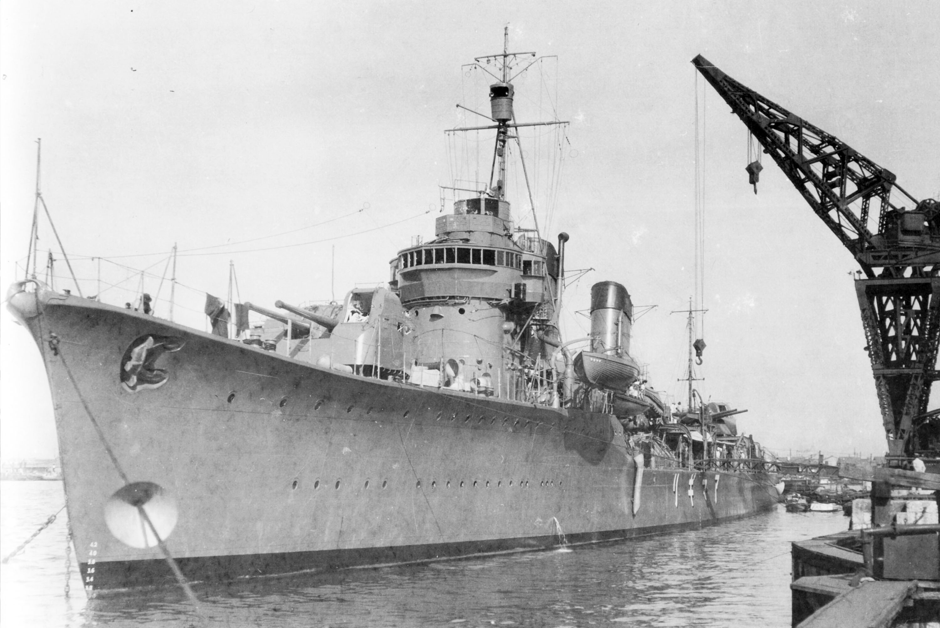

Accuracy will have to wait for an actual kit. We didn't get a Shiratsuyu class kit for review, and it's not clear as of now that we'll get a Fubuki for review.
Compare the kit to the actual hull plating.

Yeah. I really don't understand this desire for thick hull plating. Particularly how every other plate strake stands out from the hull more than the hull plates above and below. When looking at any high res photo, they clearly show that the prototype had flush hull plating
Erik
Posts: 9063
Post by Dan K »
Well, if you want to be specific, the strakes did overlap, but nothing like the Triumph kits. :smallsmile:

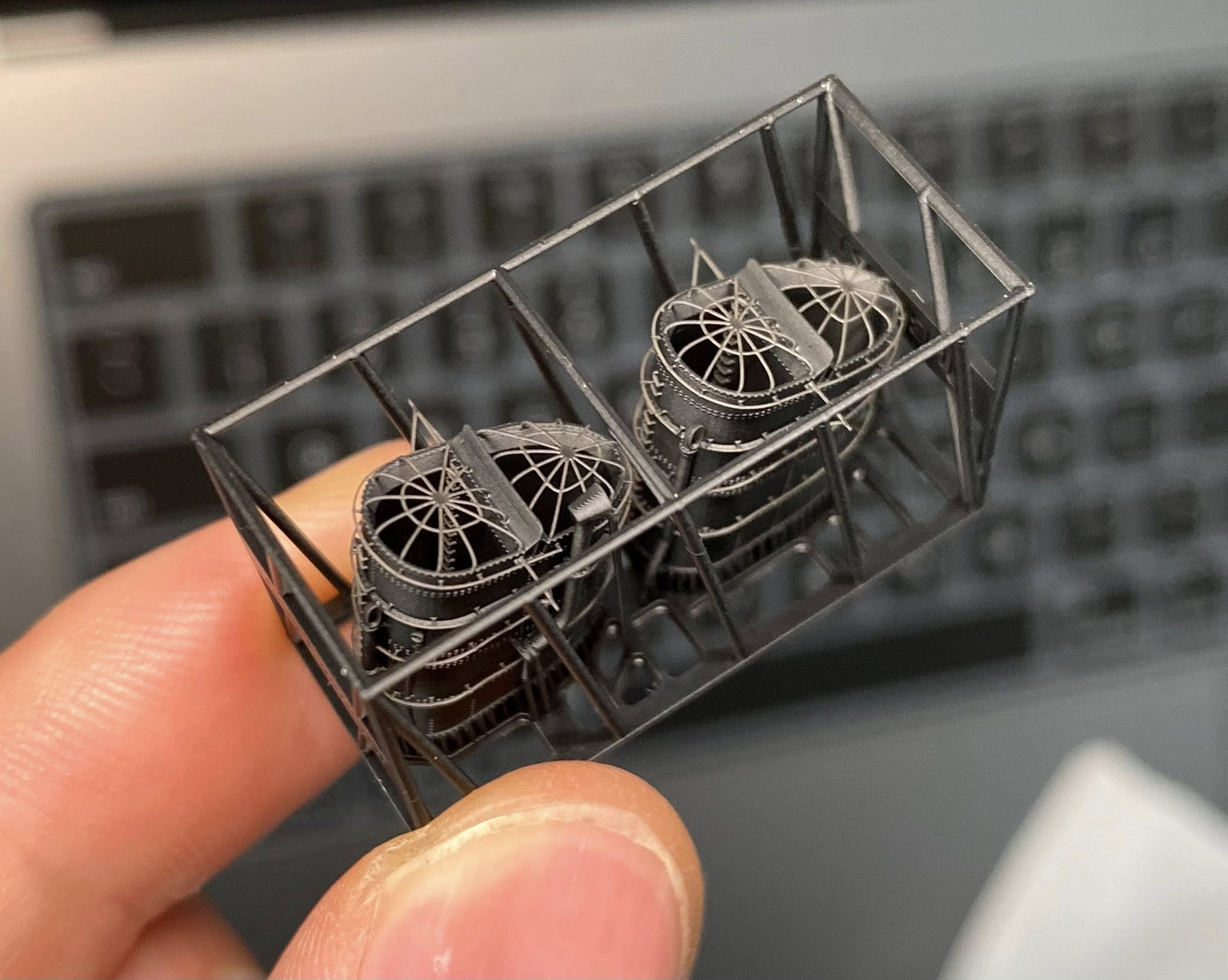

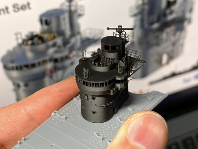

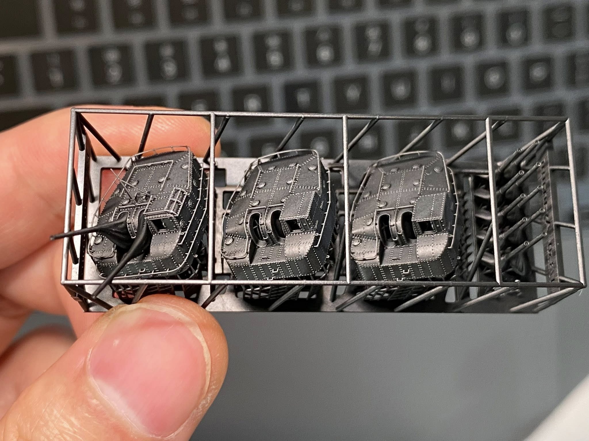

Posts: 9063
Post by Dan K »
FYI, Bunker Studios is releasing 3D printed torpedo tube mounts, main battery mounts, funnels, and bridge for early war Ayanami/Type II Fubukis in both 1/350 and 1/700 scale. The 1/350 parts apply to the FineMolds kit(s) while I'm assuming the 1/700 parts will work with both the Yamashita Hobby and Pit-road kits. Possibly the old Tamiya kits as well, but that's not a certainty.
There are two main battery sets: one for early war with 3 turrets, and a late war with 2 turrets. (Keep in mind that #1 mount is configured differently than mount #s 2 & 3.)
Easier to post a general link that one can click through for more images: https://www.hobbyeasy.com/en/category/S ... %22_top%22

Posts: 9063
Post by Dan K »
Keep us posted.
As I think you know, this new Bunker Studio bridge and funnels really apply to the Type IIs. BUT, if some enterprising modeler was looking to make a Uranami (the transition ship betwenn Type I & II) in 1/350, one could swap out the Triumph Type I bridge and funnels for these. Though, you would have to eliminate all the Type I ductwork for the ventilators. Which could be done because those are separate pieces in the Triumph kit. One would just have to recreate the bases for the new funnels. Hmmm. I might have a new future project.
