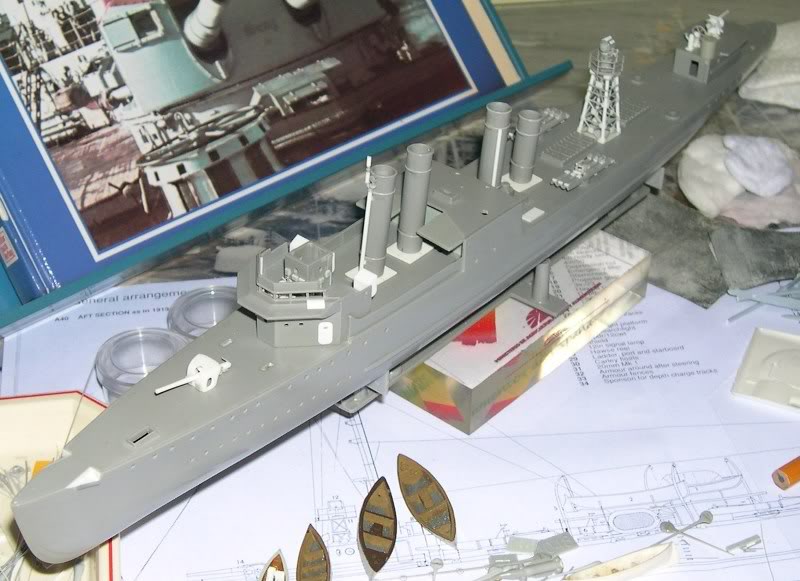

The match stick and pencil references really shows your talent, great job on the detail can't wait to see the sub assemblies all together. Your use of stretched sprue and plastic forming is very nice. Thanks for posting the pictures.

Thanks you all for your kind remarks.
Here you are a couple of pics more and a pic of the whole thing together in the shipyard, laking some elements that for some reason cannot be put in place yet.
I hope you like it.
Any advice will be more than welcome.

Splendid work
it's really coming on
Keep it up

willie, i think your work is great i would like you to provide some info on the main guns . that is the best example i have seen in a while. i have a revell kit i am wamting to start ,after seeing this man i am ready to go. you ought to do a article on the whole project. jimt

Hey Willie,
I was just wondering what modification did you have to make to the area where the anchors lie? I see in the picture you have added some styrene and I was just curious.

Jamey,
The building of these guns is the easiest thing ever.
You simply have to take some styrene rod and shape it with the point of your X-acto, first the tube part, then the breechblock part, until it is more or less the shape you want it, making it a bit too long, so that you can cut the excess of tube if necessary -- adding would be MUCH more difficult.
Then sand it until it is perfectly smoothly, and cut it to the necessary lenght.
All the rest is only stretched sprue, in different shapes, calibers and lenghts.
The AA gun is the same, but parting from a thinner styrene rod.
The most difficult thing was the No.1 gun shield, which was made building the sides and the frame with styrere strip (6 pieces), and covering it with thin plastic from a yogourt container (1 piece). The hole on the middle for allowing the elevation of the guns was hand made with the point of the X-acto (I was sweating for 15 minutes), and filed to shape with a mouse tail file.
The Revell kit is of awful quality, but is right regarding the basic structures, and this scale allows you lots of margin for good scratch-building work.
Good luck with your construction, and let me know if there is something else I can help you with.

Hi Jep1267,
I simply glued together the two halves of the hull to the main deck, and filed down the deck and hull sides at the same time, to the adecuate depth.
Then I put in place two pieces -- more or less triangular -- of yogourt container, vertical and oblique, let it dry very well, and sanded the until they were straight in line with deck and hull sides.
As you can see, it is very very easy.

willy, could you put some pics of the guns with somthing to give an idea for measuring or idea for proportion ect. thanks. i agree the revell kit leaves alot to be desired but with some work as you have shown it can be done. jameyt
