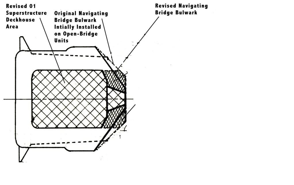

Pete,
Dick is right. Here is a drawing showing the rough angle changes to the NAV bridge and to the 01 deckhouse. Below the drawing is an image of HAZELWOOD in the process of having her bridge modified. The bridge/pilothouse was not altered, but equipment on the NAV bridge was rearranged to make room for the Mk 51 directors.

Rick E Davis wrote:
Pete,
Did USS Irwin DD 794 suffer this mod in the bridge too? I mean about Original and Revised Navigating Bridge Bulwark......
Does anybody know any about it?
Thanks: Jimmy

Considering the timeframe for Irwin's (DD-794) commissioning, she almost certainly completed with the bridge already modified. In lengthy building programs like the Fletcher's (commissioned over a couple of years rather than a couple of months), features that were mods on earlier ships were built-in on the later models. This was especially true for the 40MM upgrades. Ships completing in the latter months of 1943 already had the 5 twin 40MM. Irwin commissioned in early '44.

Dick is correct, Irwin was completed with the final Square-Bridge configuration. The break-even point for when ALL Square-Bridge Fletchers were completed with the final bridge, was ROUGHLY in the September-October 1943 period (for some reason Federal SB&DD was slower at transiting to the new configuration). Most of the units completed by the builders with the first style Square-Bridge as far back as in May 1943 were modified with the forward twin 40-mm mounts PRIOR to seeing operational service (normally by a Navy Yard). I have found photos of several Fletchers being modified AFTER they had already received the earlier Square-Bridge style during construction, but well before they were delivered. Irwin was launched on 31 October 1943, so she more than likely always had the final style Square-Bridge. There is a good chance that roughly half of all the Square-Bridge Fletchers started out during construction with the earlier Square-Bridge style before modification for two forward twin 40-mm mounts. I don't have exact numbers or which units were modified when. It really didn't matter prior to the ship being delivered.
