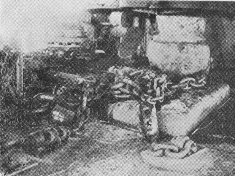

Also, Fujimi's depiction of Shokaku's anchor capstans is not only without any detail whatsoever, but is also impossibly located since the capstan does not line up with the anchor chain chaffing plate on the f'c'stle deck. There is also no opening into the chain locker beneath.
Fujimi calls for a third full sized anchor stowed in the stern hawse pipe. Is this correct? Is the stern anchor as large as the bow anchors? Did the Shokaku carry 1-2 compact stream anchor stowed against hull side like other large Japanese warships? If the stern anchor is full sized, how come its capstan is so tiny?

There are no photos but plans show a folding paravane davit on that same platform, both sides, placed just about in line with the forward edge of the the #2 & 4 12.7cm mounts.
The only photo of the capstans that I know of was taken after Coral Sea - below - not sure that this very helpful.
I'm not certain but I do not believe it was a full size anchor. I thnk there's a photo - will try to check tonite.
