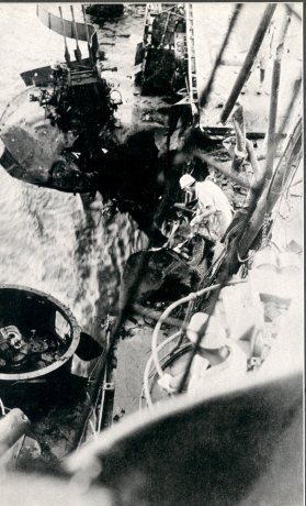

To Chuck #2: Lower, main gun decks appear to be solid. Below is a photo of a damaged 25mm gallery on Shokaku post Coral Sea and you can see the treading between the mount postions. OTOH, the forward catwalks leading from the forwardmost 12.7cm mounts to the forecastle are mesh. This was done on all IJN CVs to minimize wave action damage. Sorry to say that I don;t have a photo showing the landing light array. There may be one around.
Damaged boat deck photo below as well - solid.
Shokaku boat deck damage #3, Coral Sea, May 1942.jpg [ 121.41 KiB | Viewed 14793 times ]

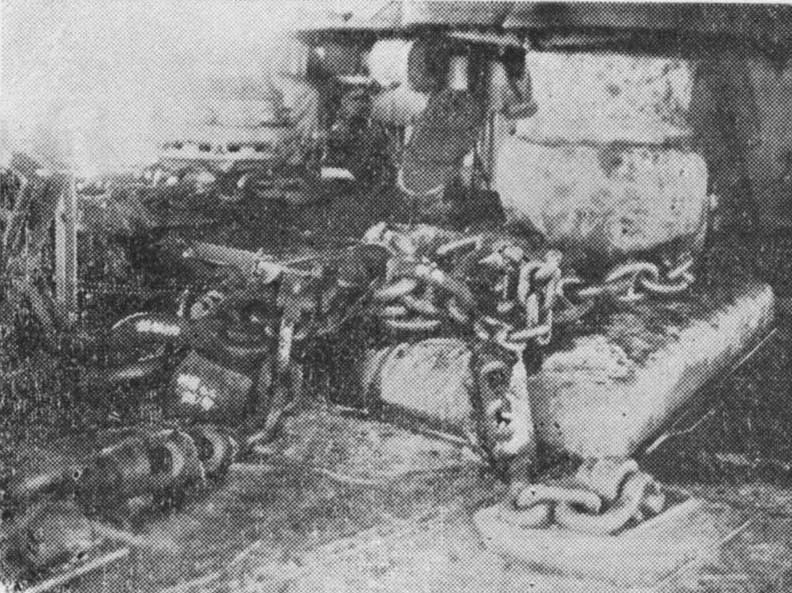

This might be nitpicking, but on the Shokaku, the paravanes are stowed on a platform underneath the forward AA battery where no easy run of cable exist from the f'c'stle. Fujimi depicts no discernable mechanical aid anywhere near by. How does the crew handle the paravane without any appearent mechanical aid nearby?
Also, Fujimi's depiction of Shokaku's anchor capstans is not only without any detail whatsoever, but is also impossibly located since the capstan does not line up with the anchor chain chaffing plate on the f'c'stle deck. There is also no opening into the chain locker beneath.
Fujimi calls for a third full sized anchor stowed in the stern hawse pipe. Is this correct? Is the stern anchor as large as the bow anchors? Did the Shokaku carry 1-2 compact stream anchor stowed against hull side like other large Japanese warships? If the stern anchor is full sized, how come its capstan is so tiny?
PostPosted: Tue Sep 21, 2010 1:06 pm
Posts: 8832
There are no photos but plans show a folding paravane davit on that same platform, both sides, placed just about in line with the forward edge of the the #2 & 4 12.7cm mounts.
The only photo of the capstans that I know of was taken after Coral Sea - below - not sure that this very helpful.
I'm not certain but I do not believe it was a full size anchor. I thnk there's a photo - will try to check tonite.
