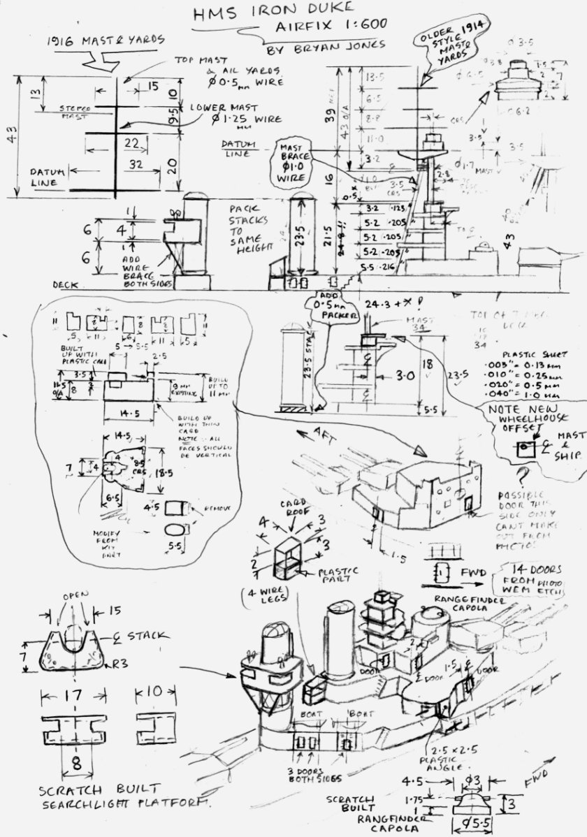

Hi this is my first effort at super detailing a kit although I have been making models off and on for many years. These notes that may be of interest for anyone contemplating super detailing HMS Iron Duke.

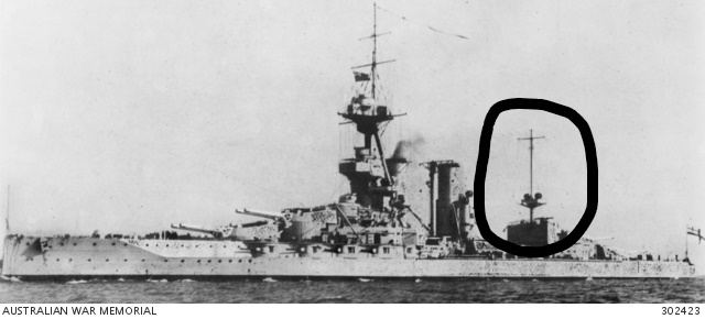

Generally this kit appears accurate in most details, however it does not represent any particular era of HMS Iron Dukes long carrier.
Following the instructions one would create a model with the following.
The eight 3 pounder guns on the lower superstructures for and aft were all removed by 1915.
Two hull mounted 6� casemate aft were found to be too exposed to the sea were relocated to forecastle amidships by 1916. (The kit shows guns in both locations)
The bridge superstructure, mast, rangefinders, searchlights and searchlight platform structure around the after funnel represents late war early 1920�s modifications.
The ship is also festooned with extra ships boats added in the 1930�s.
I decided to build my model as she would have appeared during her last refit prior to the battle of Jutland in 1916. For my references I used my copy of British Battleships of World War One by Bart and every image I could find on the internet including a magnificent Scratch built HMS IRON DUKE 1916 in1:96 scale on this website.

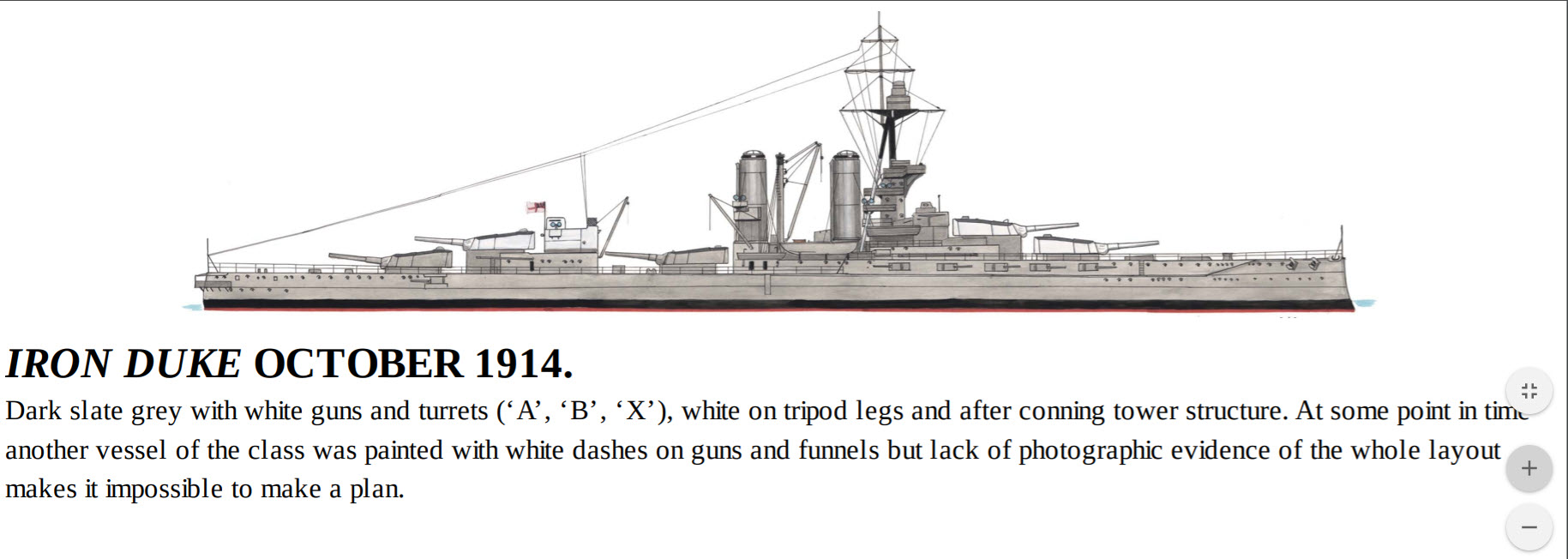

The 1916 paint scheme for the Grand Fleet was a monochrome gloss grey (matt paint was note invented at this time) made from 20 parts white and one part black.
I painted the upper hull, all vertical surfaces, turrets, guns, mast and booms etc with mix of Humbrol 130 satin white with Humbrol matt black to give a scale effect. I am happy with the result the model mimics old photos of world War 1 battleships with the light subtly picking up the gun turrets reflections.

At this point it was necessary to scratch build the armored cupola and remake the enclosed compartments on wings on the forecastle deck. The aft shelter decks were also modified with plastic sheet. Fore the two 3� AA guns no aftermarket was available so I used: White Ensign: 1:700 scale 4�single QF Mk HA mounts, these were ok for length, profile and diameter but slightly under scale for the mount.
All these decks were painted with Tamiya XF-54, this I felt looked right for a polished and oiled or tarred deck.
The ships boats lacked detail so I added some detail with plastic sheet and brass tube on the two steam Pinnaces and the Admirals steam Barge. For the other eleven boats I either covered with super glued paper towel or hollowed out the hulls and used White Ensign�s Ships Boats Fittings set.
There is a lot of door detail missing on the kit, for these I used White Ensign Iron Duke set positioned the parts using a vacuum suction pen.
The searchlight platform on the after funnel I had to scratch build from plastic sheet and also the hut between the funnels.
The worst part of Airfix�s Iron Duke is the parts that make up the upper superstructure not only are these needlessly complicated they are inaccurate. What has apparently happened is that no allowance for the thickness of the three decks up to the top of the navigation bridge, consequently it is over 3 millimeter to high this is noticeable because this level should be slightly below the top of the forward funnel.
So after a lot trimming to height in three places I still had to pack the funnels up by .5 mm. I filled of the three moulded on gussets under the navigation bridge and replaced them with the correct five gussets.
All these decks I painted using White Ensign RN19 Corticene.
Parts on the star platform and compass platform had to modified, deleted or relocated to backdate to 1916.
I scratch built the mast, yards and bipod braces from wire of 1.5, 0.5. and 1.0 mm diameter.
White Ensign Iron Duke 1:600 set was used for all the railings, boat davits, funnel caps etc.
Lastly for rigging I used the smallest very hard to find nylon fishing line: Varivas Midge Super Tippet 12x.
This is 0.067 mm diameter looks about right even though scaled up it would be 40 mm diameter on my Iron Duke.
For those that are interested I have attached some rough sketches of my build.

When did the Iron Duke get the mast on the aft superstructure (circled, below)?
The Combrig kit alleges to be 1918, but Burt (British Battleships of WW!) says the aft mast wasn't added until 1920-21. I can't find any good photos of Iron Duke in 1918, only her sisters. Marlborough seems to have a smaller mast on the aft superstructure in 1918 (no searchlight platform) and Emperor of India has no mast. Trying to find out which is correct for Iron Duke before going too much further.

Maritimequest has a photo of her which the caption says was taken at Malta in September 1919, and she has no aft mast, so if accurate it means she didn't have it in 1918. Hope that helps.

Thanks. I knew I had seen that picture somewhere, but kept looking through Burt's books trying to find it!

in Perking's book on identificatiion of british warships vol 1 mast was added in 1929
