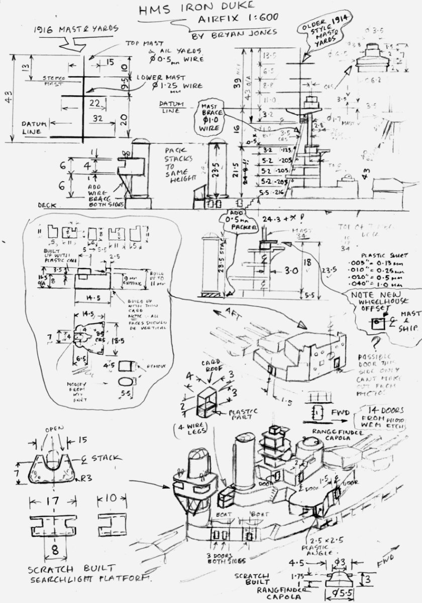

Building the Airfix 1:600 scale HMS Iron Duke.
By Bryan Jones.
Hi this is my first effort at super detailing a kit although I have been making models off and on for many years. These notes that may be of interest for anyone contemplating super detailing HMS Iron Duke.
Generally this kit appears accurate in most details, however it does not represent any particular era of HMS Iron Dukes long carrier.
Following the instructions one would create a model with the following.
The eight 3 pounder guns on the lower superstructures for and aft were all removed by 1915.
Two hull mounted 6� casemate aft were found to be too exposed to the sea were relocated to forecastle amidships by 1916. (The kit shows guns in both locations)
The bridge superstructure, mast, rangefinders, searchlights and searchlight platform structure around the after funnel represents late war early 1920�s modifications.
The ship is also festooned with extra ships boats added in the 1930�s.
I decided to build my model as she would have appeared during her last refit prior to the battle of Jutland in 1916. For my references I used my copy of British Battleships of World War One by Bart and every image I could find on the internet including a magnificent Scratch built HMS IRON DUKE 1916 in1:96 scale on this website.
First off starting from the base.
The floor of the dock was made from Evergreen: 4517 side walk 3/8� squares 9.5mm.
This approximates the size of the concrete slabs of a drydock at Portsmouth Dockyard.
Concrete supports made from chopped up timber moldings.
For the lower hull I used: White Ensign Colourcoat RN19 RN Anti Fouling Red.
For the prop shafts I used 1mm dia steel rod. (Easier and better results than the kit parts).
The 1916 paint scheme for the Grand Fleet was a monochrome gloss grey (matt paint was note invented at this time) made from 20 parts white and one part black.
I painted the upper hull, all vertical surfaces, turrets, guns, mast and booms etc with mix of Humbrol 130 satin white with Humbrol matt black to give a scale effect. I am happy with the result the model mimics old photos of world War 1 battleships with the light subtly picking up the gun turrets reflections.
For the 6� casement guns I used Modellmarine: SM-400-002 brass barrels. These are 4� 1:400 scale guns that give the correct length, profile and diameter to represent my 1:600 scale 6� guns.
The area around the casements is a poorly designed, too many parts have to align the up stands that are supposed to fit in rings that form the casements are oversize and a lot of filling and sanding is required to hide the joins were the hull parts met.
My solution was glue the casements to a piece of scrap by the existing molded on barrel, cut a section out of the ring and fit and superglue the new brass barrel in position, then cut the old barrel away releasing the new assembly. I cut the up stands flush then glued my new casement gun assemblies in position.
There is another omission I discovered late in my build was that the wall forward of the 6�forcastle guns should jut out to follow line of the deck above. This was resolved using 2.5mm plastic equal angle.
I purchased a second Airfix Iron Duke kit for use as spare parts for $20. This was because I was short of the correct ships boats, old style rangefinders, twin searchlights and correct unmodified main turrets for my 1916 build. (I still had modify one turret)
Next I filed off the moulded on anchor chains then I fitted the Artwox wooden deck for HMS Iron Duke in place. (This looks great; it really sets off my model)
The Artwox brass anchor chain I painted and cut to the four lengths required along with very thin plastic sheet strips to be fitted between the anchor chains and the timber decks.
For the admirals stern walk I used the existing Airfix floor filled flat and covered with an off cut of Artwox timber floor and the parts from White Ensign Iron Duke brass photo etch after first removing the roof from the airfix deck.
For the main gun turrets I superglued Bruce Buchner�s BDB60001 13.5� Iron Duke brass barrels in position. Blast bags were made from one ply of two ply kitchen paper towel cut to 3 mm strips one end poked in recess and rapped around each barrel add a bit of super glue (this soaks all around) then mould to shape with a tooth pick.
I was happy with the result.
At this point it was necessary to scratch build the armored cupola and remake the enclosed compartments on wings on the forecastle deck. The aft shelter decks were also modified with plastic sheet. Fore the two 3� AA guns no aftermarket was available so I used: White Ensign: 1:700 scale 4�single QF Mk HA mounts, these were ok for length, profile and diameter but slightly under scale for the mount.
All these decks were painted with Tamiya XF-54, this I felt looked right for a polished and oiled or tarred deck.
The ships boats lacked detail so I added some detail with plastic sheet and brass tube on the two steam Pinnaces and the Admirals steam Barge. For the other eleven boats I either covered with super glued paper towel or hollowed out the hulls and used White Ensign�s Ships Boats Fittings set.
There is a lot of door detail missing on the kit, for these I used White Ensign Iron Duke set positioned the parts using a vacuum suction pen.
The searchlight platform on the after funnel I had to scratch build from plastic sheet and also the hut between the funnels.
The worst part of Airfix�s Iron Duke is the parts that make up the upper superstructure not only are these needlessly complicated they are inaccurate. What has apparently happened is that no allowance for the thickness of the three decks up to the top of the navigation bridge, consequently it is over 3 millimeter to high this is noticeable because this level should be slightly below the top of the forward funnel.
So after a lot trimming to height in three places I still had to pack the funnels up by .5 mm. I filled of the three moulded on gussets under the navigation bridge and replaced them with the correct five gussets.
All these decks I painted using White Ensign RN19 Corticene.
Parts on the star platform and compass platform had to modified, deleted or relocated to backdate to 1916.
I scratch built the mast, yards and bipod braces from wire of 1.5, 0.5. and 1.0 mm diameter.
White Ensign Iron Duke 1:600 set was used for all the railings, boat davits, funnel caps etc.
Lastly for rigging I used the smallest very hard to find nylon fishing line: Varivas Midge Super Tippet 12x.
This is 0.067 mm diameter looks about right even though scaled up it would be 40 mm diameter on my Iron Duke.
For those that are interested I have attached some rough sketches of my build.

Bryan that's awesome info! Thanks!

Anyone know if there is photographic evidence of the attached image? It mentions there is no evidence of another schema, sort of implying there is for the below.
